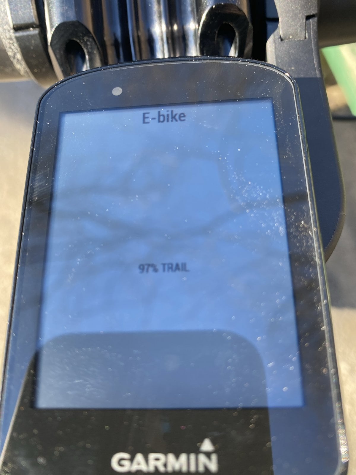

This is all I get in Ebike Field
salko
Aug 29, 2019
1,274
865
SLO
Because this is all Ebike field will show you (apart from different display options of displaying % charge and mode you are in). For showing other data (speed, cadence, pedal power) you must add Levo sensors to show as data fields ...

ugh, I thought I added all the sensors

You might have added and connected other sensors, but you have to change the data screen layout on your Edge.
The above picture shows a „1 field layout“.
You can set up to 10 data fields - and then you can set different data to each of them.
Home -> Profile -> Data screens (select one) - > Layout and datafields
