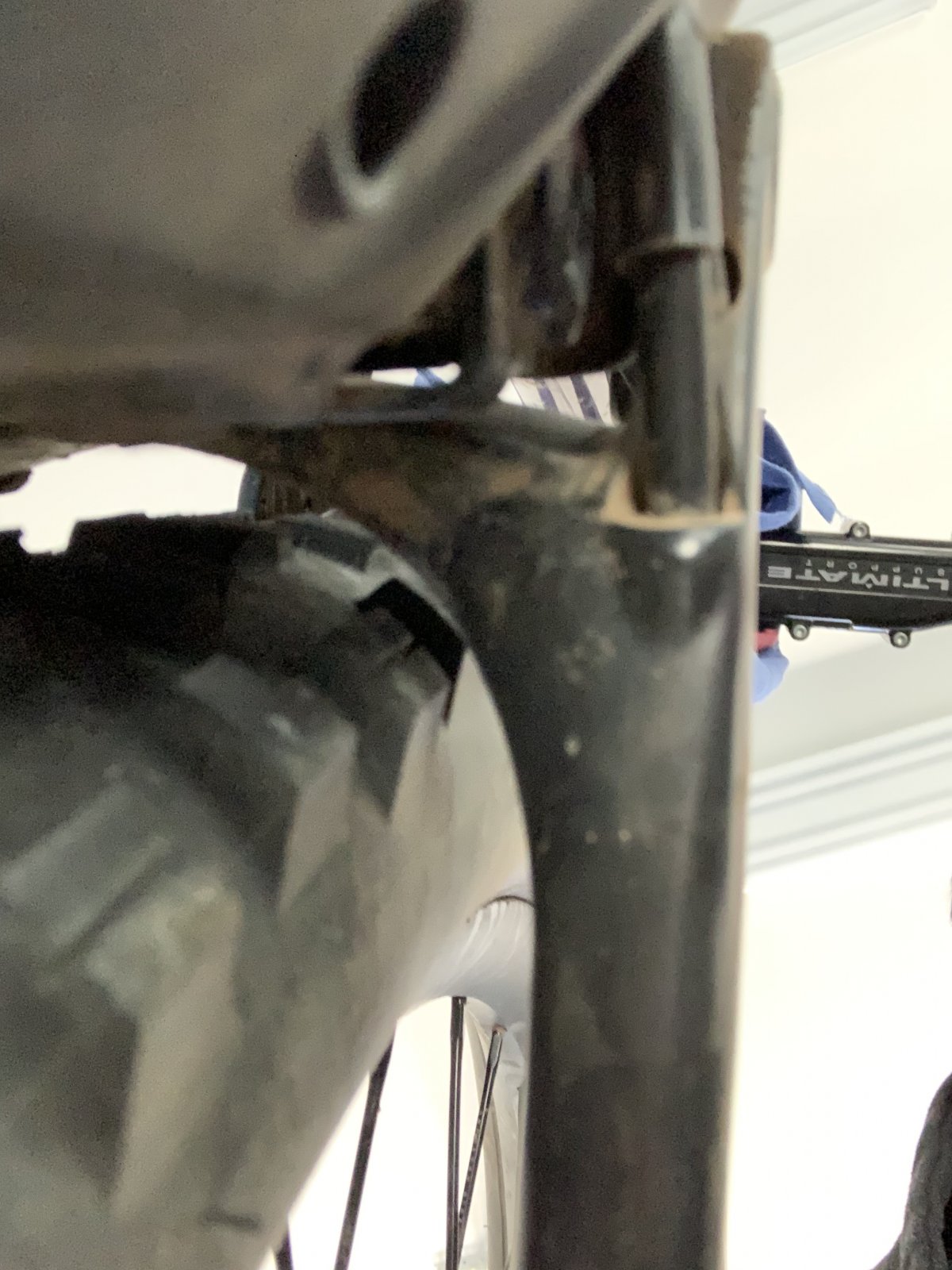

Levo Gen 2 Frame pretty damaged, cable rub, Levo 2020

Mine was spotted by my local mechanic. He says its more than cosmetic & if left as it is it will continue to wear away the frame and eventually to the point where it will fail.
Sad to say, I agree — not safe and the only way to prove who’s correct is a bit dangerous, depending on what you ride.
But you’re in a such tough place just now with choosing what to do about that — feel for you mate. I speak from experience — although not with a Levo on this occasion (am a Levo owner).

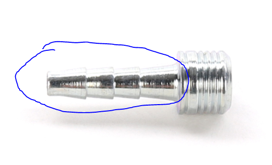

Same here. Just fed it in slowly from the bottom and used that cool little connector thing (can't remember who makes it or what it's called) threaded to the old hose to feed, push/pull the new hose through
Rockshox Stealth Barb Connector :
You can also use a small screw, cut the head off and use it as a barb screwed into the ends of the new and old cable.

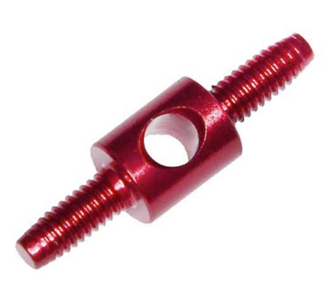

Hey, the way i did it was to cut the old brake hose at the caliper side, take the new hose that was cut at the brake lever side and mate it with the old hose( i cut the ridged part of the barb
that goes inside the hydraulic line and put it half inside the new hose and half inside the old hose because i didn't have access to one of this bad boys
) and then slowly pulled on the old hydraulic line from the brake lever side until i had the new line all the way through the frame.
Just be careful to do this in one go without forcing it as to separate the two lines because than it might happen that the plastic hydraulic line guide inside your chain stay or frame to dislodged itself and then you have 10x more work to do to put it back in place so the line can smoothly pass through

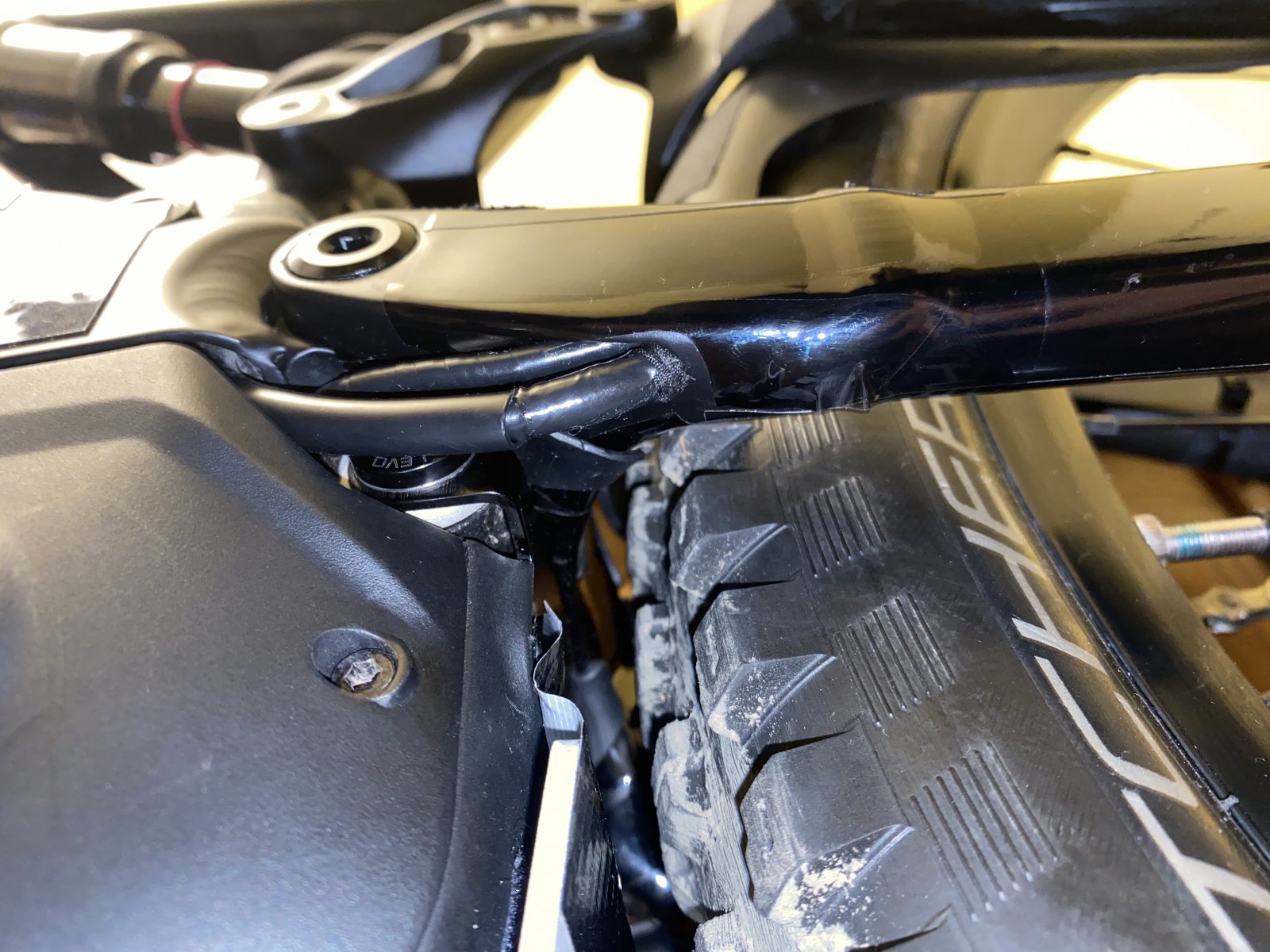

I am pretty amazed this is the only case reported.
I marked this as a major issue the first day I got the bike, so I wrapped the cables with some thin silicone tape and covered the chainstay entry hole with mastik tape.
Its a bad design with no protection to the cables or frame, easily prevented, its a shame.
Ask for a replacement under warranty.

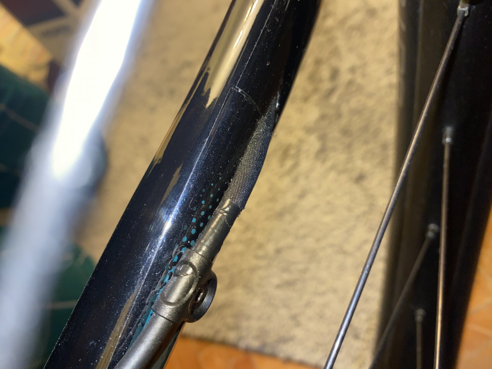

UPDATE
After 6 months the bike shop replaced the chainstay by warranty but put no protection in place to prevent this from happening again
I bought one of those Rubber U Challels (Black Rubber U Channel Edging Trim Seal 10mm x 4mm fits 0.5mm - 2mm | eBay)
I have just checked the bike again recently. It looks like a level of cable rub has happened again! The replacement chain stay is getting worn again by the cable. The same thing is going on again FFS

Just had this issue in mine last week. Was aware of the risk and was checking it on occasion and all seemed fine. One day my rear brake felt a bit mushy. Thought maybe a recent bleed I did had left a bit of air in the system. Rebled and seemed good but when riding and warming up the brakes, they felt mushy again. It was when cleaning the bike I noticed the small bit of fluid at the chainstay.
Apparently a tiny pinhole had started in the line. Replaced it without pulling the motor, using the little SRAM tool to pull the new line thru the frame. Added a short piece of vinyl tubing as future protection over the brake line at the chainstay port.
