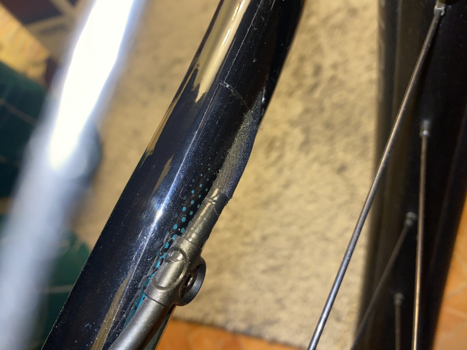

After just 2200 miles I've noticed the frame is pretty much damaged on the chainstay - cable rub. The hole where the brake hose go through should be about 5mm but cable rub has made it 10mm damaging this part of the frame.
If left alone I believe it could get even worse. Has anyone found a solution to stop the rub ?
All I could think of was a cable tie to stop the movement of the cables against the frame but it simply just does not fit due to the position.
Note - to add confusion the bike is turned upside down in the pics

I am pretty amazed this is the only case reported.
I marked this as a major issue the first day I got the bike, so I wrapped the cables with some thin silicone tape and covered the chainstay entry hole with mastik tape.
Its a bad design with no protection to the cables or frame, easily prevented, its a shame.
Ask for a replacement under warranty.

Good spot, yeah that’s shoddy, should be a rubber plug etc to protect edge of hole.
Ive cut a strip of innertube and managed to wedge it about 2cm into the arm via the hole underneath the cable and the rear end ofthe hole and then fold the other bit back along the arm and fixed it with a loop of insulating tape around the arm. (So tube between cable and extended hole in above photos), will be keeping an eye on that
i might try a bit of fuel hose (or camelback water tube etc) a few cm long with a side split so I can tape round wiring But suspect that still will rub* or maybe try to clip it round edge of hole to protect the edge

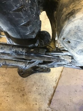

It’s just cosmetic till the sharp edge that is forming on the frame cuts into your brake hose...
I have seen this on 4 bikes now. Chainstay replaced under warranty
I'm not seeing any cutting into the hose, but I'll swing by my LBS and see what they say.

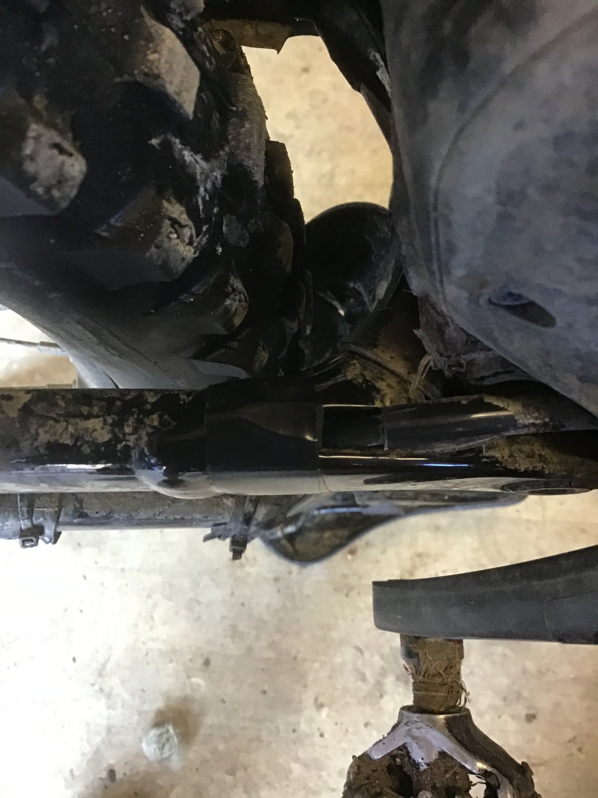

I’m going to try a bit of this
That looks like it could be the solution. Let me know how it goes then I might buy some.
Until then, I've got some 3M Mastic tape that I will probably try first

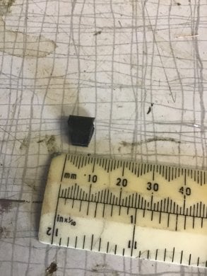

*edited, bodge below survived a 22 Mile xc(doddering old ecoplodder) ride. So for 2.99£ Inc postage for a metre of beading (see link a few posts above) you can’t really fault the vfm.

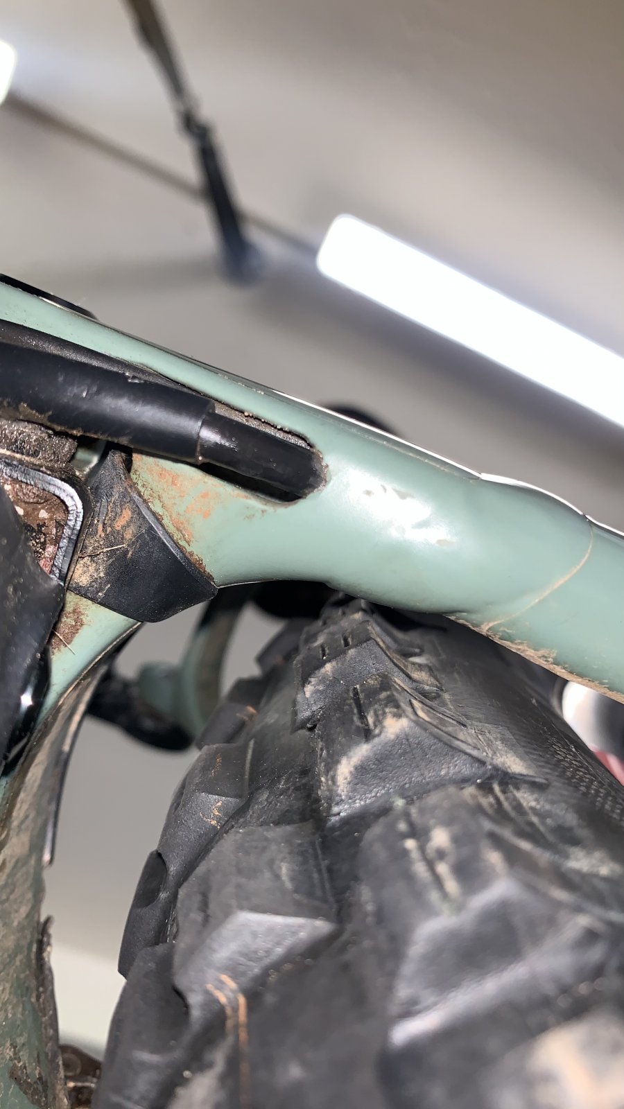

That dosnt look too good.
Judging from the picture i am unsure if i would still ride that but that depends on your riding style. Atleast it seems to be more than 5 mm?
The problem with aluminium is that it has a pretty bad fracture behavior. It dosnt bent like steel before it breaks or starts to crack open like carbon fibre. Aluminium just breaks abruptly. And usually that happens in situations when the frame has to take a lot of force.
Id recommend to put some thick tape over your break house(and check if it got damaged before you do so).
Dont add tape on that part of the frame because then you wont see when the frame starts to crack. And keep an eye on that spot. (y)
Quite aggressive and fast. I'm going to ride it still, ask the bike shop for a replacement chainstay next time I'm there for whatever other reason. If they don't warranty it then I'll just ride it as it is but check it doesn't get any worse every so often.

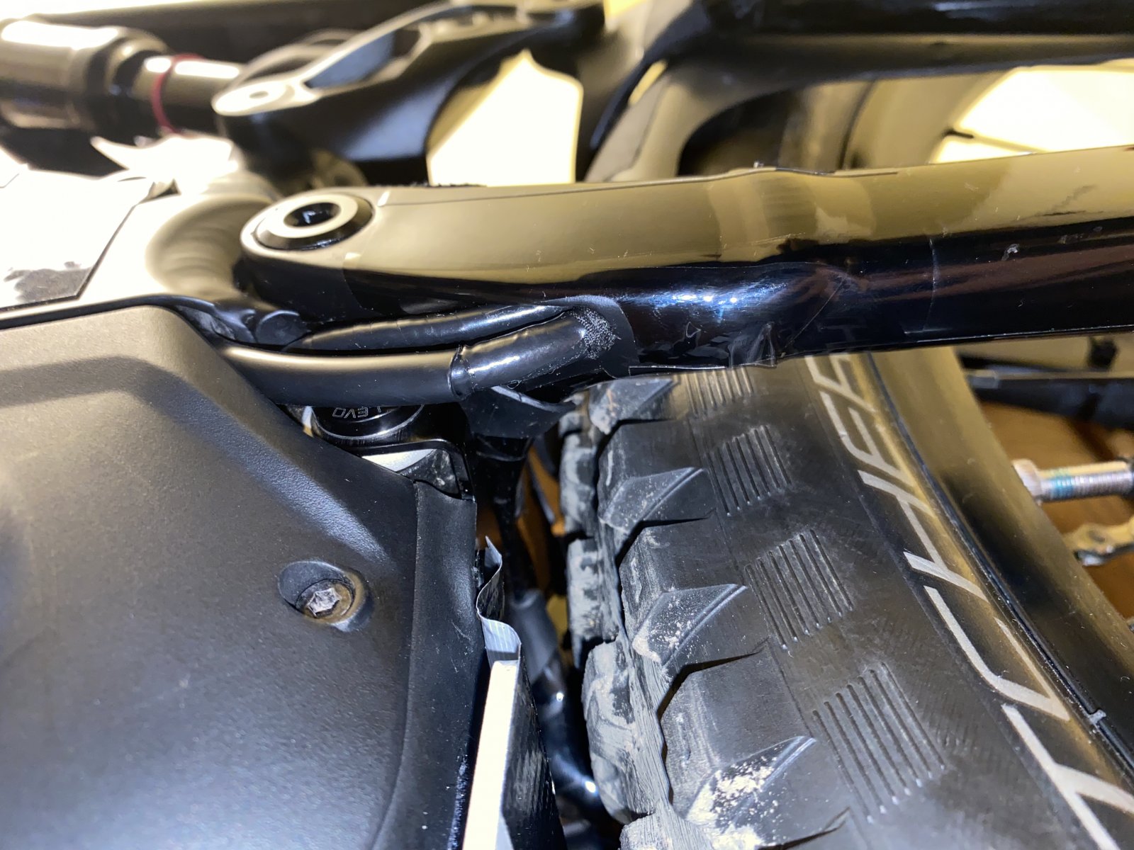

Cleaning my bike after yesterdays ride I took a closer look at the brake cable entry into the chain stay. As I said before I have absolutely no wear there. What I noticed compared to some of the photos a bove is that my brake cable loops down quite a bit before entering the motor casing and the speed sensor cable is not underneath it but rather to the side of it out of the way. There is no wear on the chainstay and no sign of rubbing on the cable itself. If I press the cable where it enters the chainstay there is plenty of room for it to move so it is not tight against the chainstay entry point edge.
So my suspicion is that the damage on some bikes is due to the brake cable being run too tight and possible the speed sensor cable not being tucked out of the way on the chainstay entry point. That could be just how it was originally assembled or possibly due to the cable being run too tight when either the brake cable or speed sensor cable ( or perhaps motor) was replaced for whatever reason. I know none of those have occured on my mates bike which has just a small amount of wear, so his was obviously build like that.
I decided against trying to insert anything between the cable and the chainstay entry point since it just jammed the cable.
