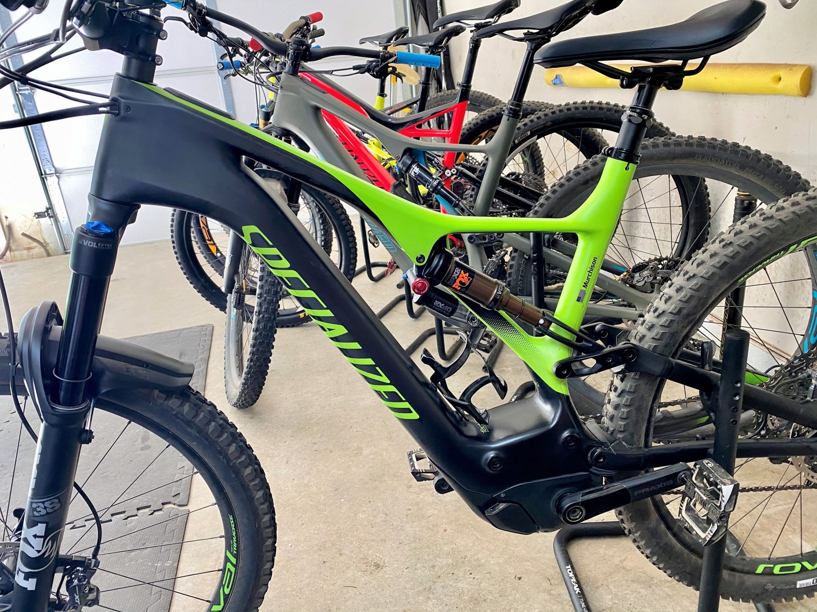

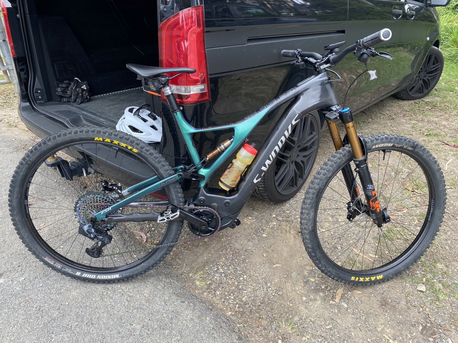

I am waiting for a Float X2 to come in stock but in the meantime I was able to get a Float DPX2 and installed it tonight. What a difference from the stock Rock Shox, the bike feels much more balanced front and back now. Before the front felt great with the 38 but the back was just slamming through things. Now it's much more controlled and bottomless feeling.
RickBullotta
Jun 5, 2019
1,867
1,594
Just wait until the X2 arrives! Same advice as with the 38 Grip 2 - start with very little compression damping (1-2 clicks from wide open), and set sag and rebound to spec (sag on the high side of the range - 30%).

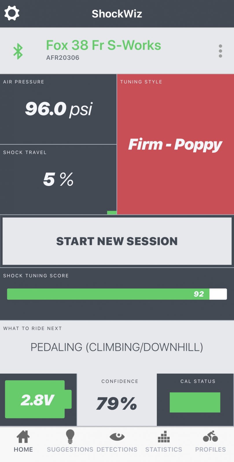

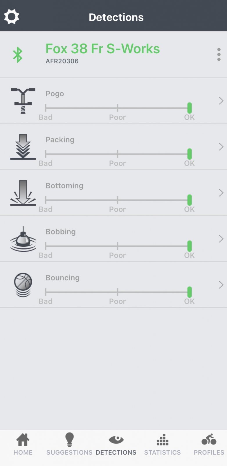

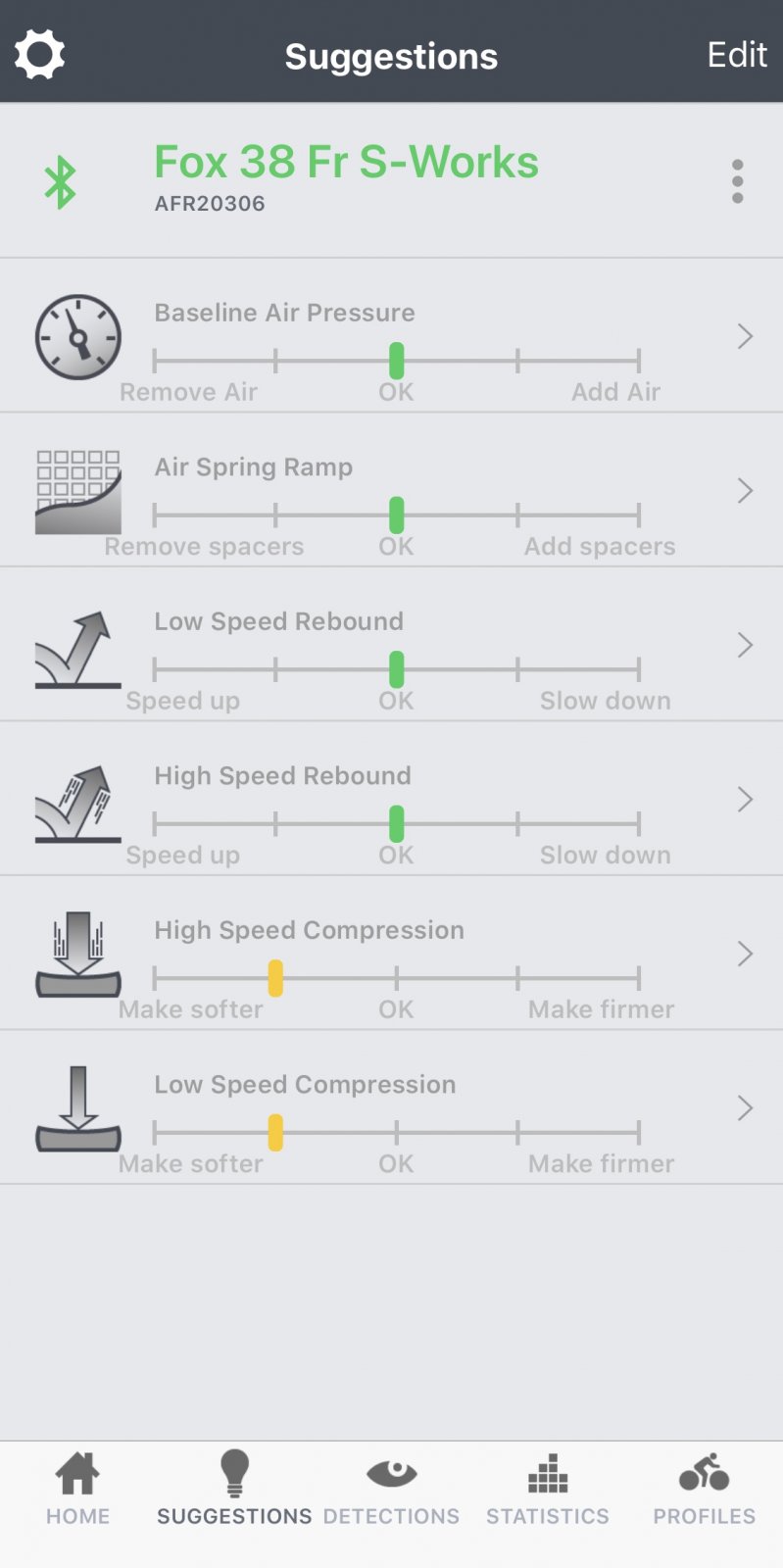

My LBS fitted the 38s (160 with 44 offset) a week ago in direct replacment for 36's with the same travel and offset. I wasnt expecting to even notice much difference as I had spent a few weeks (6 rides) setting those up (with ShockWiz) and they felt good. I set the 38's up with stock settings from the Fox manual and fitted the ShockWiz again. The difference was noticeable immediately, the small bumb sensitivity was much better than the previous 36's. they absorbed every hit, big or small with control and plushness more like a motocross fork. The first MTB forks I have ridden on that were even comparable. Definately increased confidence with the added stiffness too. I set a number of Strava Pb's first time out on them, so thats the true test hey!? Checking the ShockWiz data when I got back showed the settings were close to perfect with only a couple of clicks softer on low and high speed compression (next ride they were perfect) I am on an XL Turbo Levo and I am 192cm tall and 98kg. Will they change your life? Probably not, will they let you go harder for longer, I think so. Thats what E-bikes are all about arent they?
