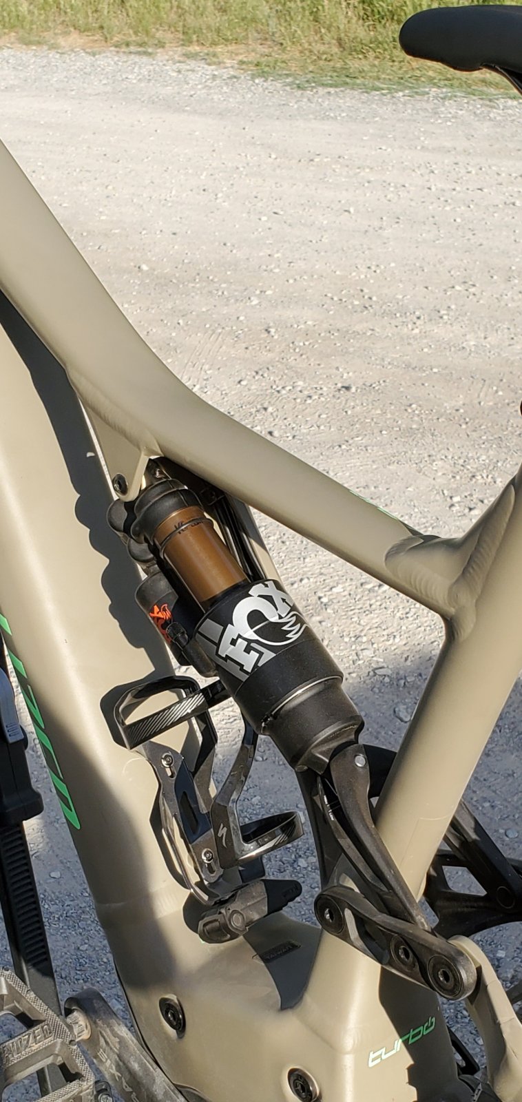

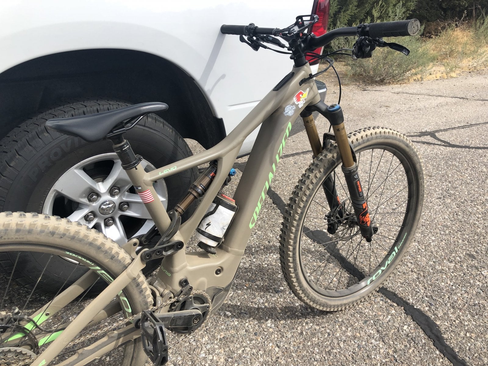

Fox Factory Float 36 e-bike, everything bolts right up. I added 5mm to the stem.
Fox DPX2, 220psi.
Stuff works so good, insane.
