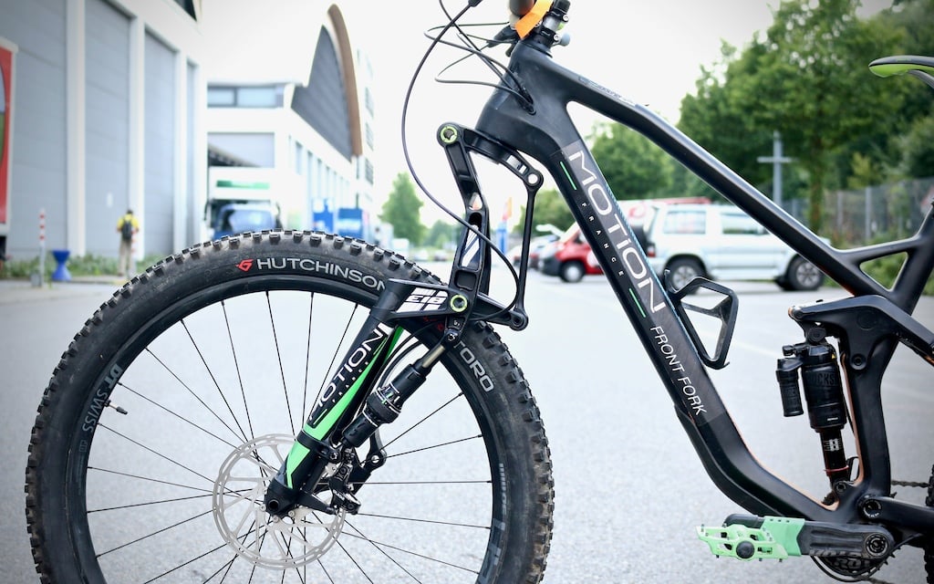

I also have one of these to test:

ooo.. Leading link forks... nice.. Should stop the dive/compression under braking. I look forward to the review... (y)
Hate to think how much a set costs though, they look expensive!

I dont see how adding a bunch of extra levers will change the physics of de-acceleration. When your body moves forward, the amount of the vertical down component is determined only by the angle the fork makes with the horizontal. Consider if the fork were totally vertical- hitting the brakes would create horizontal negative acceleration. Through the magic of trigonometry sin 0 = 0 so no force would be transmitted vertically. (Please dont make me draw the vector decomposition diagram). When the fork is at a 45 degree angle, half the acceleration is vertical (your front end drops) and half is horizontal. Having more linkages only adds friction (increased damping)
Wow, OMG, I'm obviously in the presence of a greater mind so, I'll go punish myself by drinking more beer...
However...
Go here: Motion Ride's 170mm Linkage Fork - Eurobike 2018 - Pinkbike
I'll quote for you:
"The big promise with linkage forks is the anti-dive characteristics that, in brief, keep the fork from blowing through its travel due to weight transfer when you grab the front brake.............. "
This type of fork has been tried (and is in use) for around 20-30 years by the motorcycle industry. I've used them on both Road Race and MX sidecars and they do make a difference.
Please don't take offence and send Mr.Trump after me, I'm enjoying my Friday night with a few beers...:)
/MuddyFunster

Looks like a Lauf fork I’m thinking of putting on my next gravel bike. I bumped into a guy in the lakes who was test riding a lauf he wasn’t impressed though.
It's not a Lauf.
It's a motion, a French brand. The spring is a pulled bent strut, very interesting with it s low histeresis and progressive nature.
There is also an hydraulic damper.
Did a lot of testing on linkage type forks when I was doing motocross and have a yes/no opinion. While I found them good in many circumstances where I had real issues with them was that I could not hit a berm, preloading with my front brake and then use the released energy to allow me to cut back from the berm instead of railing it.
Not quite the same on a MTB, but I did ride a few new tracks locally last weekend that the ability to do this was helpful as the turns were so tight even a conventional 29er would struggle to get around at any pace.
