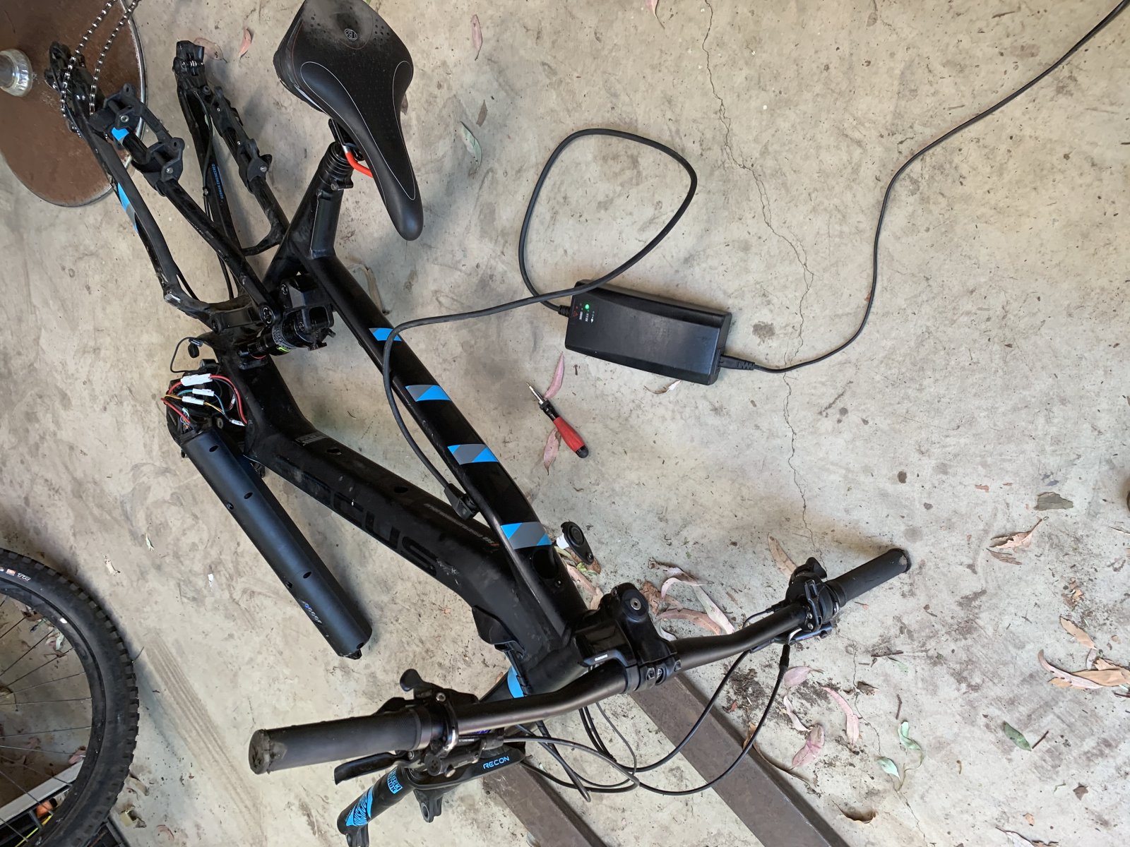

hi Bissona,
jam2 2018 not turning on, so I decided to take apart and now have NFI(no idea)
1. charger flashes green for 30 sec then goes into Red led( which says serious problem) ok i gathered that but is that a serious problem with the charger or ebike battery or motor
2. battery - i have taken battery out of tube and shows some light cracking, The battery has a health percentage blue light and it’s flashing 80% health, not 100% as it says on stunlocker
3.motor looks ok from outside but am curious on the inside
4. Loom this looks as normal, though havent tested
5. Display- worked fine then switched off and never turned on
