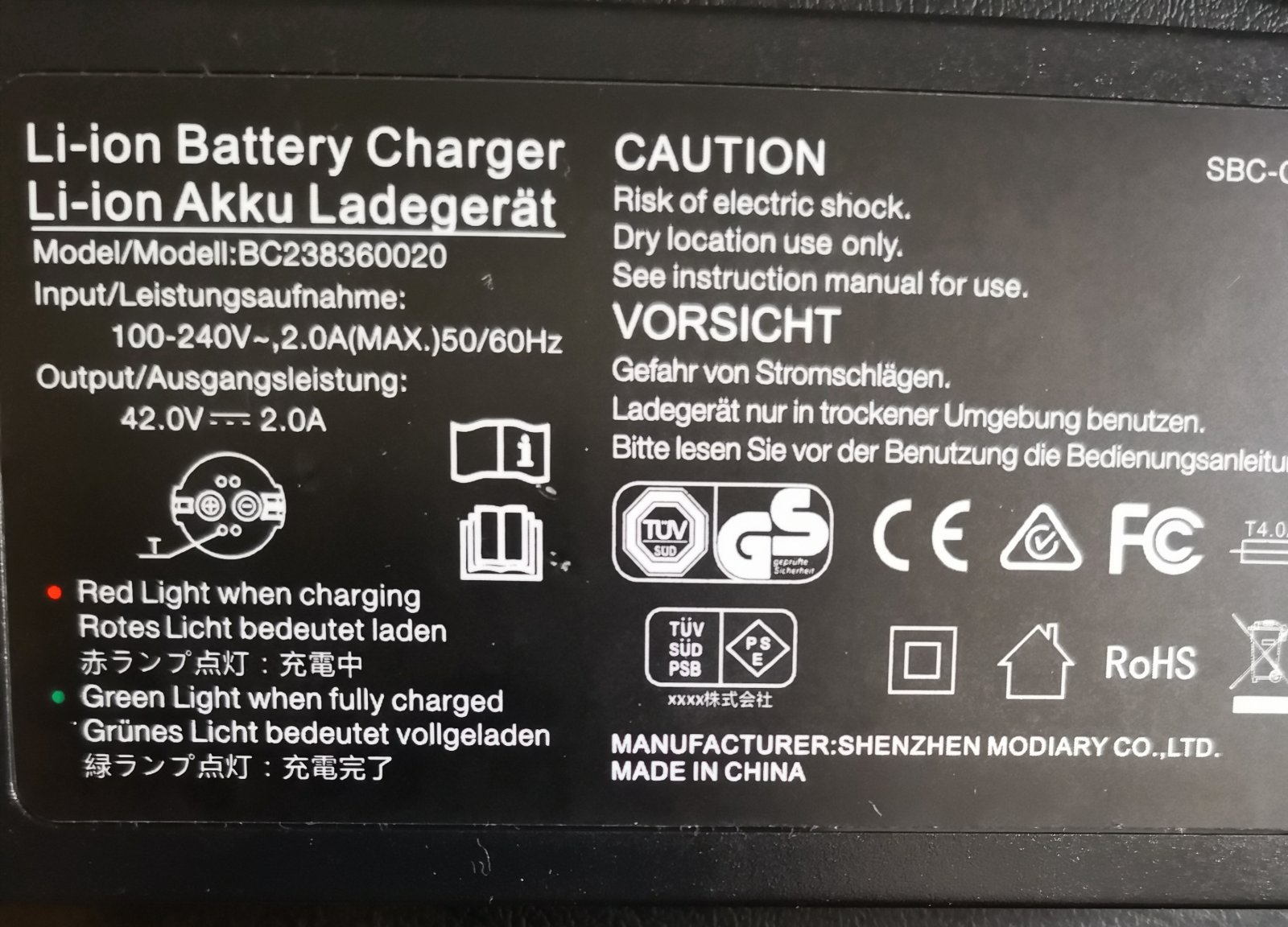

Just bought a FOCUS BOLD2 with no charger? It was a deal and assumed my shimano charger would work. I could remove the motor and integrated battery to charge with the shimano charger?Does the TEC Pack include a charger? Anyone try a LEVO charger on a FOCUS? Possible?
9,302
9,856
The TEC pack does not come with a charger, but you can buy a charger separately.
The connector on my Focus Jam2 is a Rosenberger connector, like this:
https://www.rosenberger.com/0_documents/de/catalogs/ba_automotive/AUTO_RoPD_Flyer_2016.pdf
If the Levo uses them , you are probably in business. I'd look out for the voltage and current limitations.

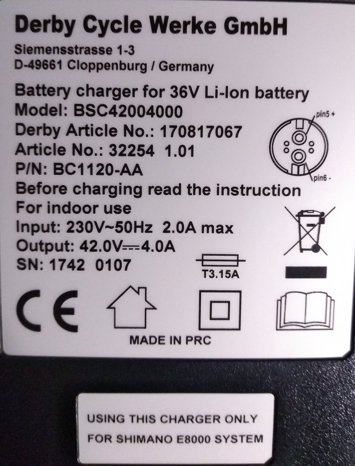

I can only tell you what is on the charger I have for my Focus Jam2.
I used to have the 4.5A charger, but it gave problems in cold weather, so I switched to a 4A. Here's a pic. The key info is the input and output figures.

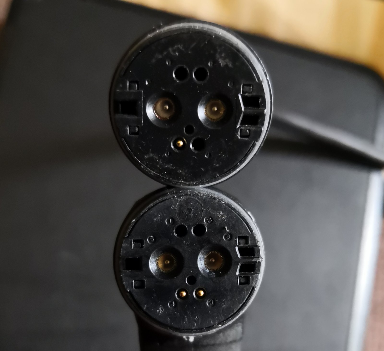

The only physical difference I can see is the Focus charger has two small pins whereas the Levo only has one...
I haven't actually tried either charger on a different bike :eek:

Yes, the 4Amp charger instead of the 4.5Amp sorted the problem, in my opinion. All the evidence said the 4.5Amp charger was the problem. I won't have 100% proof until the cold weather returns.
Despite the urgings of the dealer and the evidence from us both, Focus insisted on changing the frame battery (£600 ish) instead of just swapping the charger (£60 ish). Despite me losing the bike for two weeks, I went along with it to avoid them refusing any further cooperation this coming winter.
I had the same problem with the TEC pack when I let that get cold and low charge, but Focus never offered to replace it. The fact that I had problems with both said to me that it was the charger that was the problem. That and other evidence.
