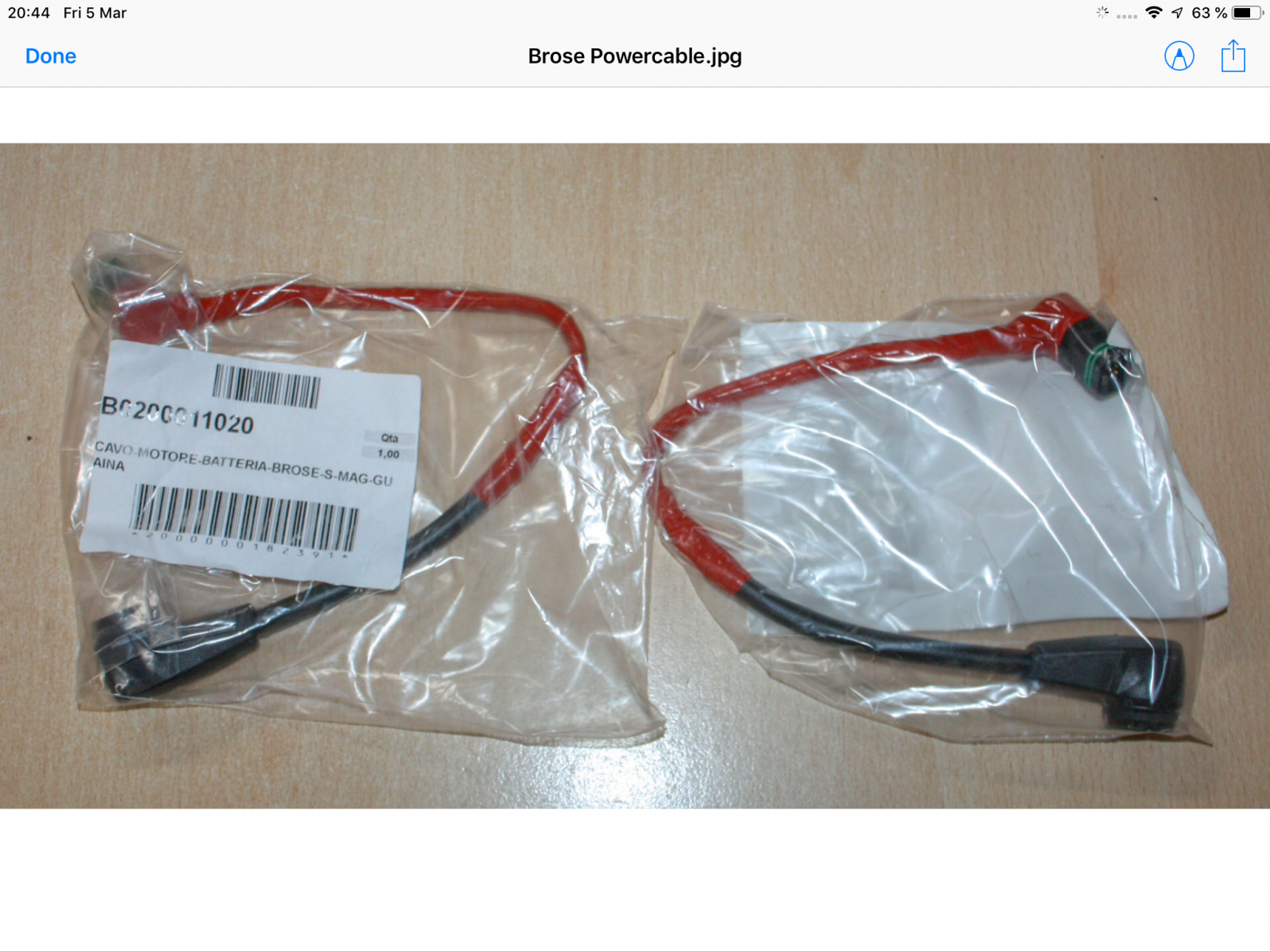

Hi there, I too had a nightmare with the fantic and in particular the bike shop where I bought the bike.. DAMIAN harris Cycles refused to accept any responsibility. I went through a new motor, 3 power cables, bofore I eventually stripped the bike down dried the motor and coated the electrics and seals in xcf. In addition I wrapped the power lead in self emalgimating silicon tape and this allowed me to ride in the wet without the motor shutting down. Anyhow I still wasnt impressed and took the bike shop to court for a full refund. It took me 4 months from the initial claim until I received my £5k back.... There is no excuse for piss poor customer service... Take the bike shop to court.. You will win.

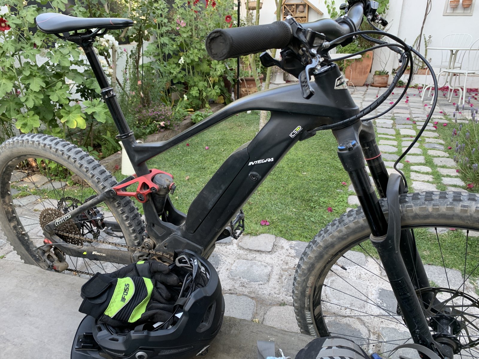

I've had my Fantic Integra 160 Carbon Enduro ebike for close to two years now with more than 2800k on the clock. I upgraded a lot on it mainly with Hope e4 brakes, Hope wheels, sram x01 groupset and carbon here and there. But the bike has delivered with no problem whatsoever except the usual wear and 4 derailleur hangers (...that probably saved my expensive x01 derailleur and my rear triangle of course). Integration of the Brose elements is excellent, the frame is very well balanced and with excellent geometry. The only part I would change is the lower carbon motor protection that lasted only two months and was replaced by the standard version, much more durable. I would also replace the cheap Fantic plastic covers on the sides of the Brose motor which amplify all the gear changes and noises of the crankset and chain (but maybe Fantic has solved this in the later models). I'm certainly not a Fantic fanboy as I "accidently" bought mine because of a end of season rebate. I'm not new to the mtb sport in general as I've done xc competetion for more than 6 years in the south of France. But this is a very good ebike that I believe is mainly underrated because it is Italian and a small manufacturer.

Hi @Geffro , did changing the cable fix your issue? i am facing same issue with my bike and took it to a shop here in California and they said everything look good. every time i go through little bit of water, the electronics stops working, and after about 10 hrs, it starts working again..
Hi , yes the cable replacement fixed the issue , the damp seems to get in lower down and gets through the plug into the motor , probably a good idea to unplug the cable and let the motor socket area dry out for a few days in the warm
Thank you.. kind of pain to reach the connector as the crank has to come off... at atleast know why it's happening....

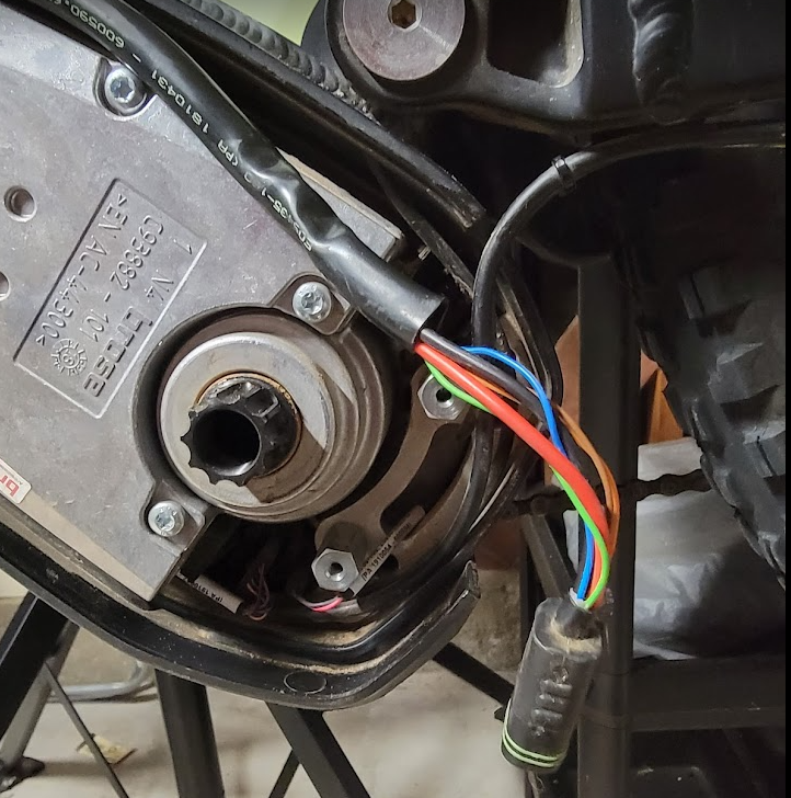

could finally open up the motor cover and could see that the cable don't even have sleeves all the way. the contacts were looking ok. for now taped up the cable and hopefully will hold. I couldn't find the cable in US to replace. will replace once i could find it...
