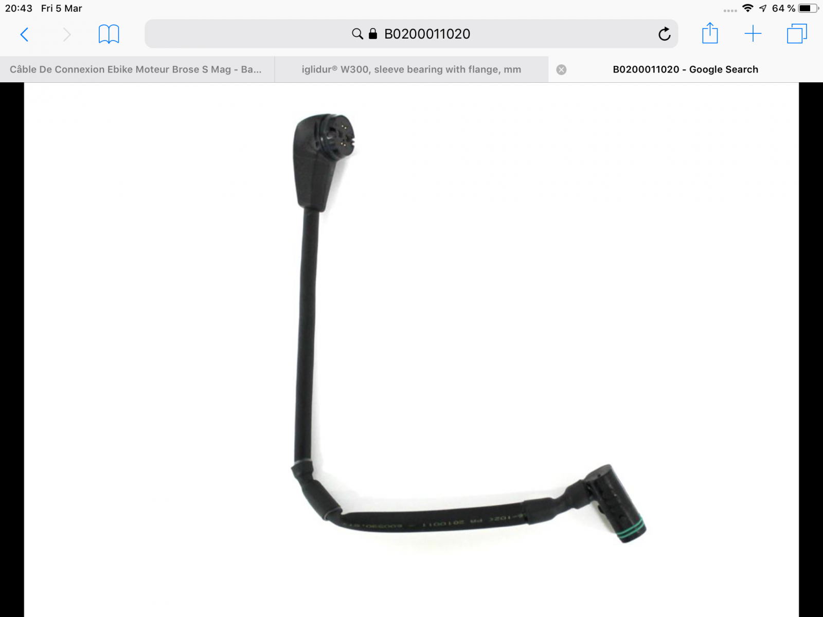

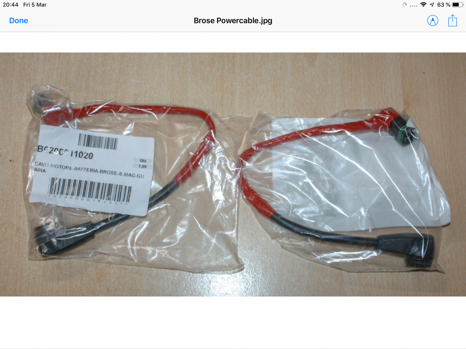

Black modified Brose update cable , red old cable wrapped in tape by Fantic I think to get shot of old stock crap , the one fitted to my bike failed after the first wash
