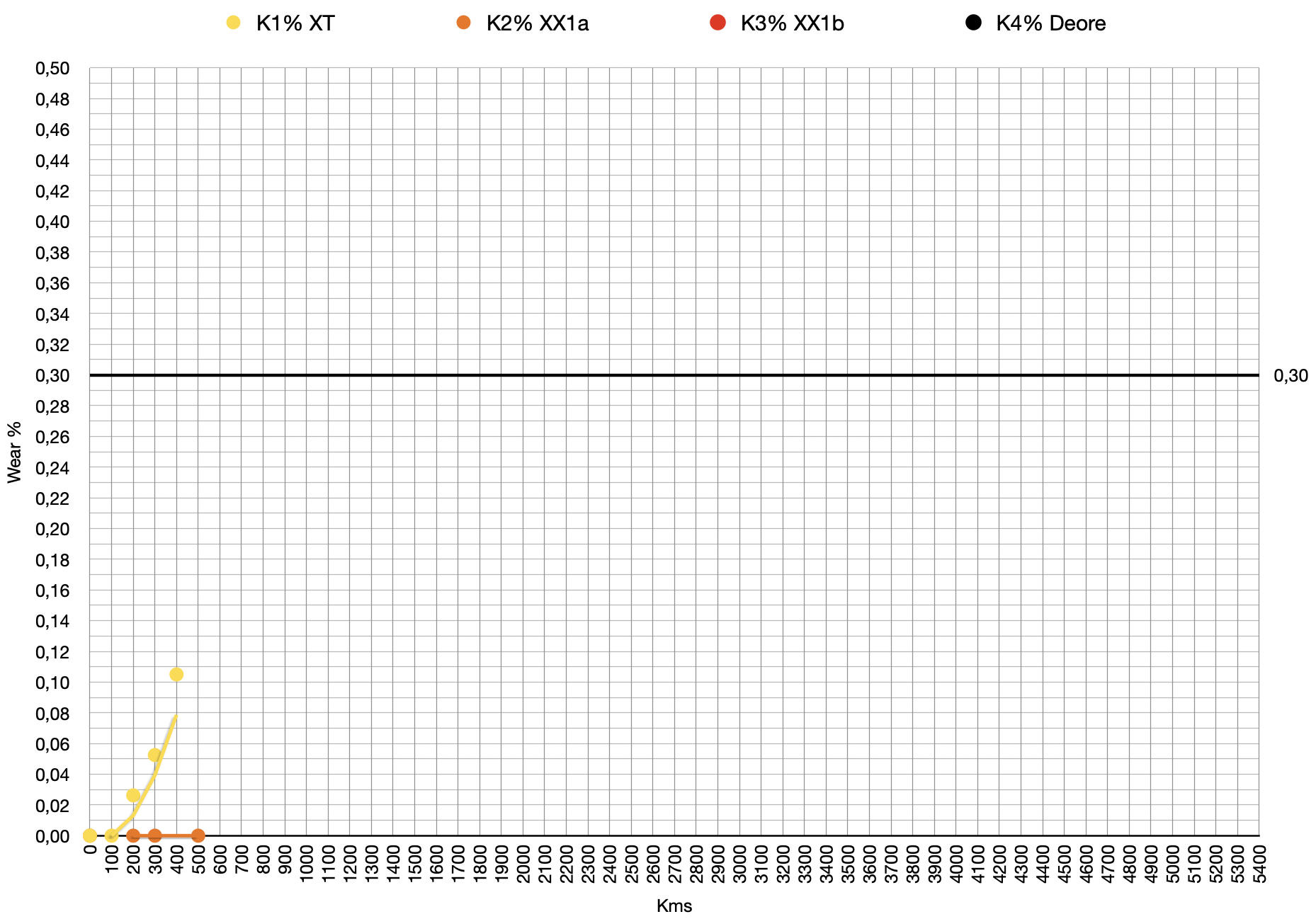

I've started a small experiment on my Cube Stereo Hybrid, Bosch CX Performance gen4.
Wanna find out how many kms to get from a chainring/cassette and 4 chains on rotation.
Silca hot wax after every ride of 40-100kms
I started with a new set of:
  • SLX cassette with XT cogs on 5 highest gears.
  • RaceFace chainring 34t.
4 chains:
  • 1x Shimano XT M8100
  • 1x Shimano Deore M6100 (OEM standard for this bike)
  • 2x SRAM XX1
Initially started with 1x XT and an XX1 but I noticed a fast wear of the XT. I deliberately let it wear for a couple of rides to confirm it really was wearing more and more. I measured after every ride. The XX1 isn't giving an inch, it remains dead on at 0% wear.
That triggered me to compare with a Deore, just for the fun of it (and on sale for just €10). But also looking to get the most out of cassette/chainring so bought an additional XX1. So this is where I'm at now regarding kms:
  • XT: 400km = 0.10% wear
  • XX1: 500km = 0.00% wear
  • Deore: 0km
  • XX1: 0km
Motor use is by average 75% eMTB, 15% Turbo, and pretty wet and dirty mud conditions in the last months.
Will keep posted how things progress. Some things I want to learn from this:
  • Chain longevity per type?
  • Will cassette/chainring last the 4 chains?
  • Total set milage?
Chain wear data, 900km total:

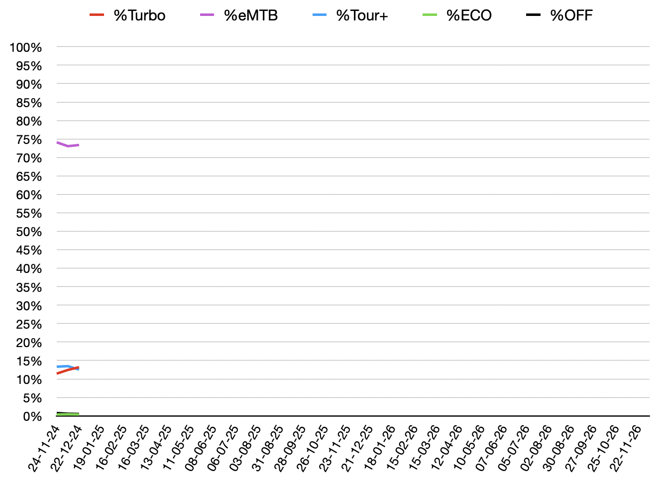

Motor driving mode usage data:
(* data shown at 24-11-24 are averages as from start of measurement at 1 nov 24)
What I'm hoping to confirm is cassette/chainring can last pretty long, given I swap chains based on equal wear% so the whole set wears out evenly. I've put the XT chain on ice for now to let the others catch up on it.
I am just very curious what the optimal amount of chains per cassette/chainring is for myself for my specific conditions.
I'm well aware that I could run 10x Deore chains for the same price as 2x XX1. But that might be another experiment. Which I will not attempt btw.

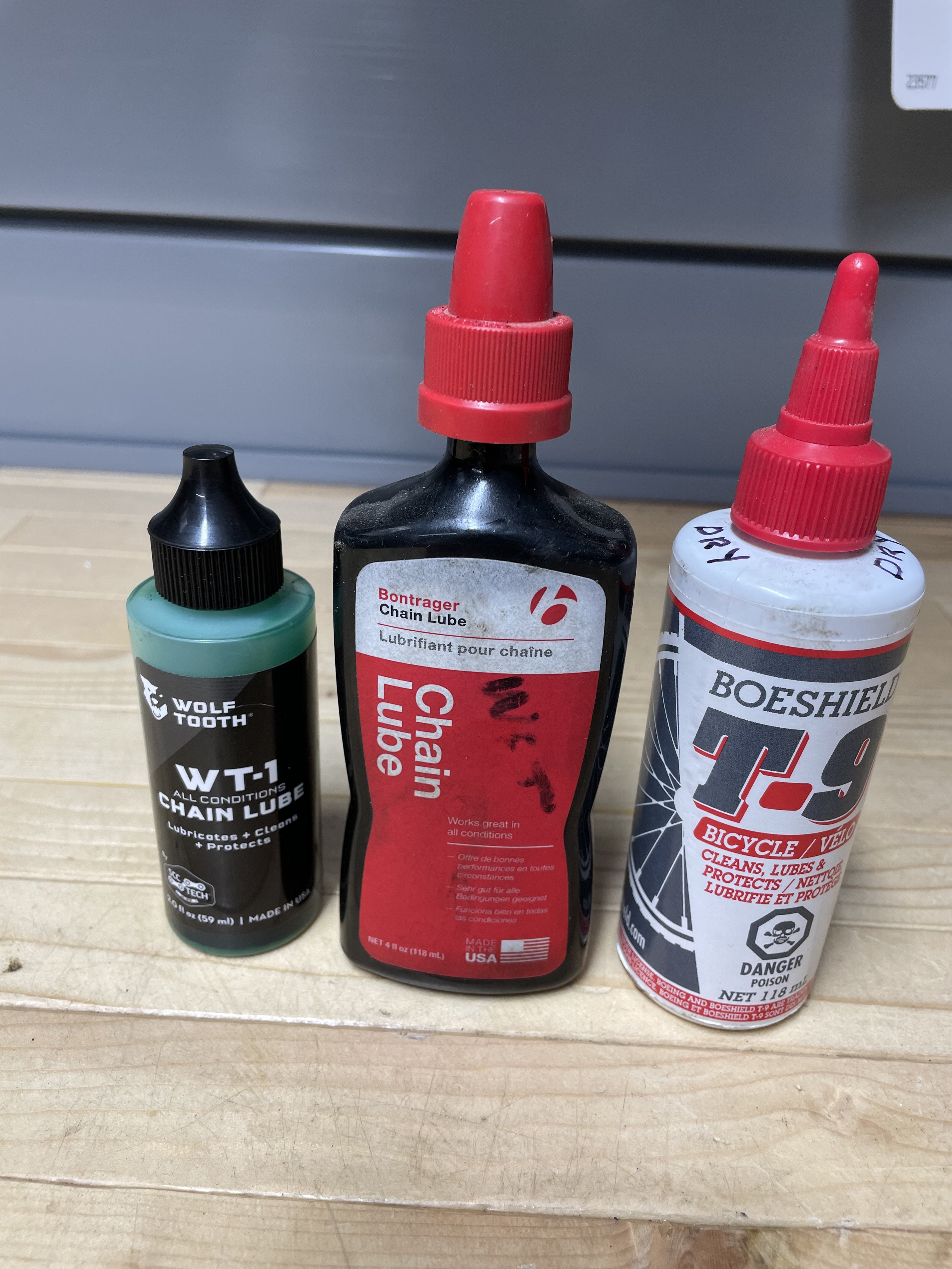

I use 3 types of chain lube. One of them is probably just olive oil …I wouldn’t know. XT cassette and 8100 Shimano chain.
But the most important thing I found was proper cadence. I’m mostly in eMTB mode and climb almost any trail. These motors can add a lot of stress to our transmission and motor components. I believe that I have extended the life of these components by using the correct cadence.
I haven’t tried the hot wax or chain-alternating method.

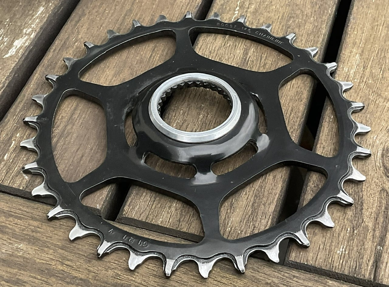

here’s my question: I’m still on the original SRAM X Sync2 chainring 34T on Bosch Gen 4, which just seems to keep working, even though it is a bit shark toothed. I asked the mechanic at the LBS whether i should change it and he said no keep going with it until it starts to feel rough. What do you think?
I think as long as you ride current chain, keep the chainring, since they match and ride everything until worn. When you install new chain, replace chainring (and cassette) to prevent chainsuck considering you’re noticing a bit shark toothed. 10.000 it had a nice lifetime.
Chain advice: take the X01 or XX1, wil last so much longer and give you more out of cassette and chainring. My XX1 is currently at 650km and still a measured 0.00mm of wear.

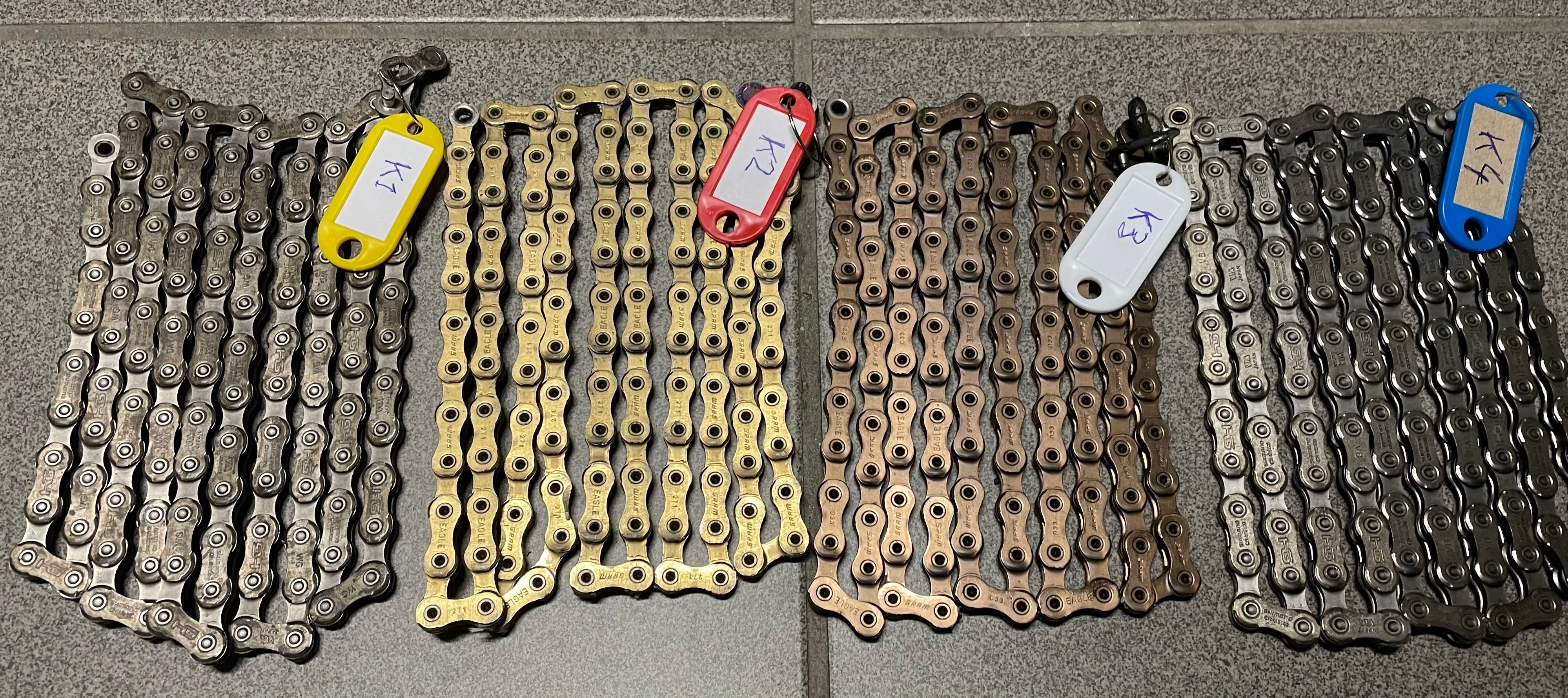

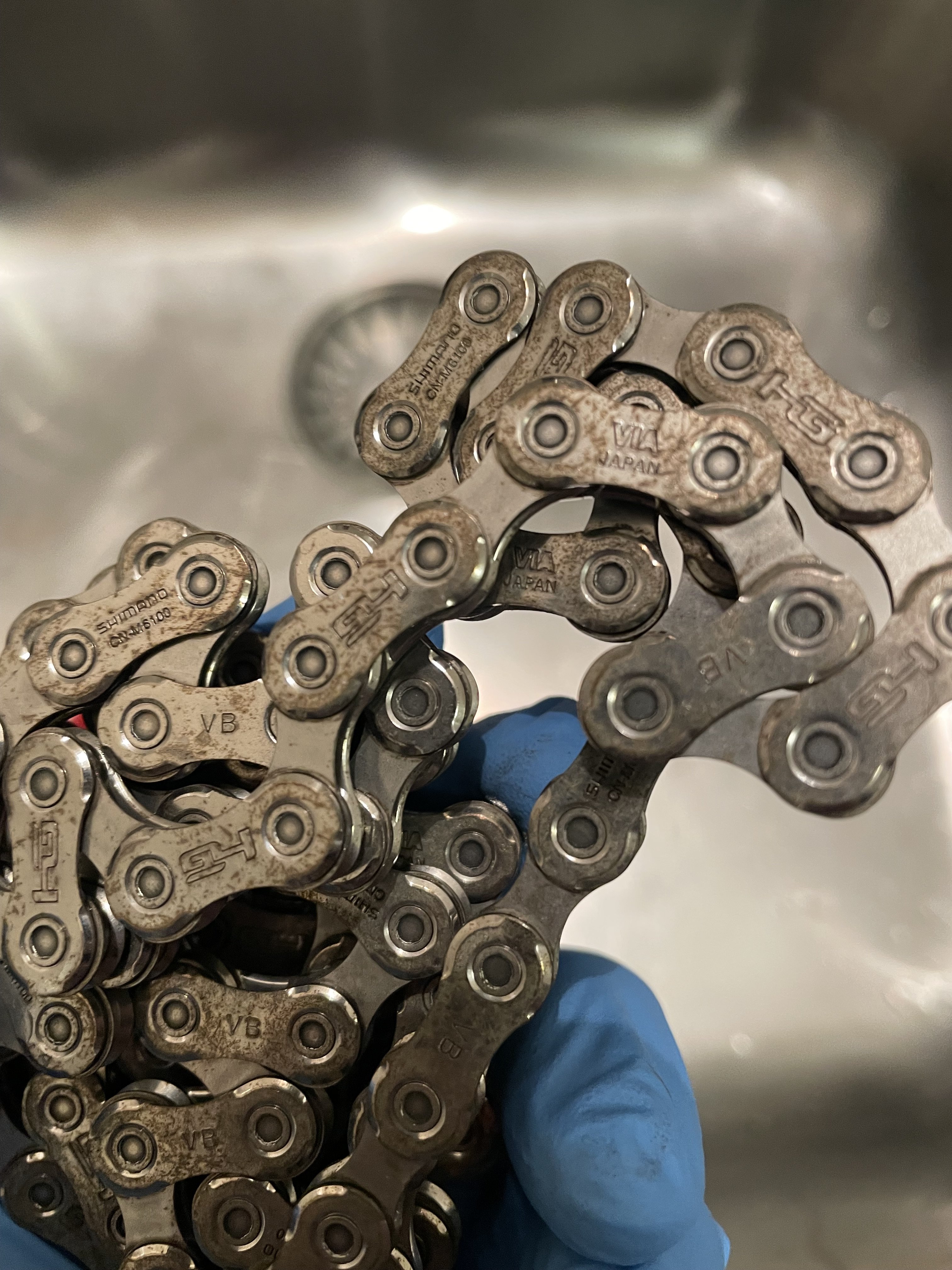

Today prepping participants K3 and K4 of my experiment. A 2nd XX1 and a Deore M6100. From the last one my hopes aren’t really high, especially considering the looks of it after 10 mins of UFO drivetrain cleaner and 5 flushes with hot water. This came new out of package, bright and shiny. The XX1 which had the same treatment and still looking as new.
I’ve hot waxed it anyways and will give it the first kms soon.
Any similar experiences on corrosion during initial degrease and prep? Guess we witness the difference between the high-end chains and the cheap entry-level chains, where the surface treatments show their benefits.:
Though I must say the XT M8100 also showed slight similar surface corrosion after last boiling water reset at 400km (the K1 on the picture below). I don't remember this from my previous MTB with 2x X01 chains (metal color), they didn't show any corrosion at 1500km each. This makes me curious how an XTR M9100 would do. Will take one in next round of experiment.
K1=XT 8100, K2&K3=XX1, K4=Deore M6100
This picture from 1500km X01, no surface corrosion:
I'm sure that I remember correctly, but not when I read it, but....
Sram designed the 12-speed ring to be a bit shark-toothed from new. They were chasing chain retention (and maybe also longevity), and they took a new approach to tooth profile. After all, initially it was a 1x system (is there even a 2x 12-speed set up?)
9,411
10,001
I’ll see if i can find any old pics of e bike, but it’s true that it’s been shark toothed for a looong time

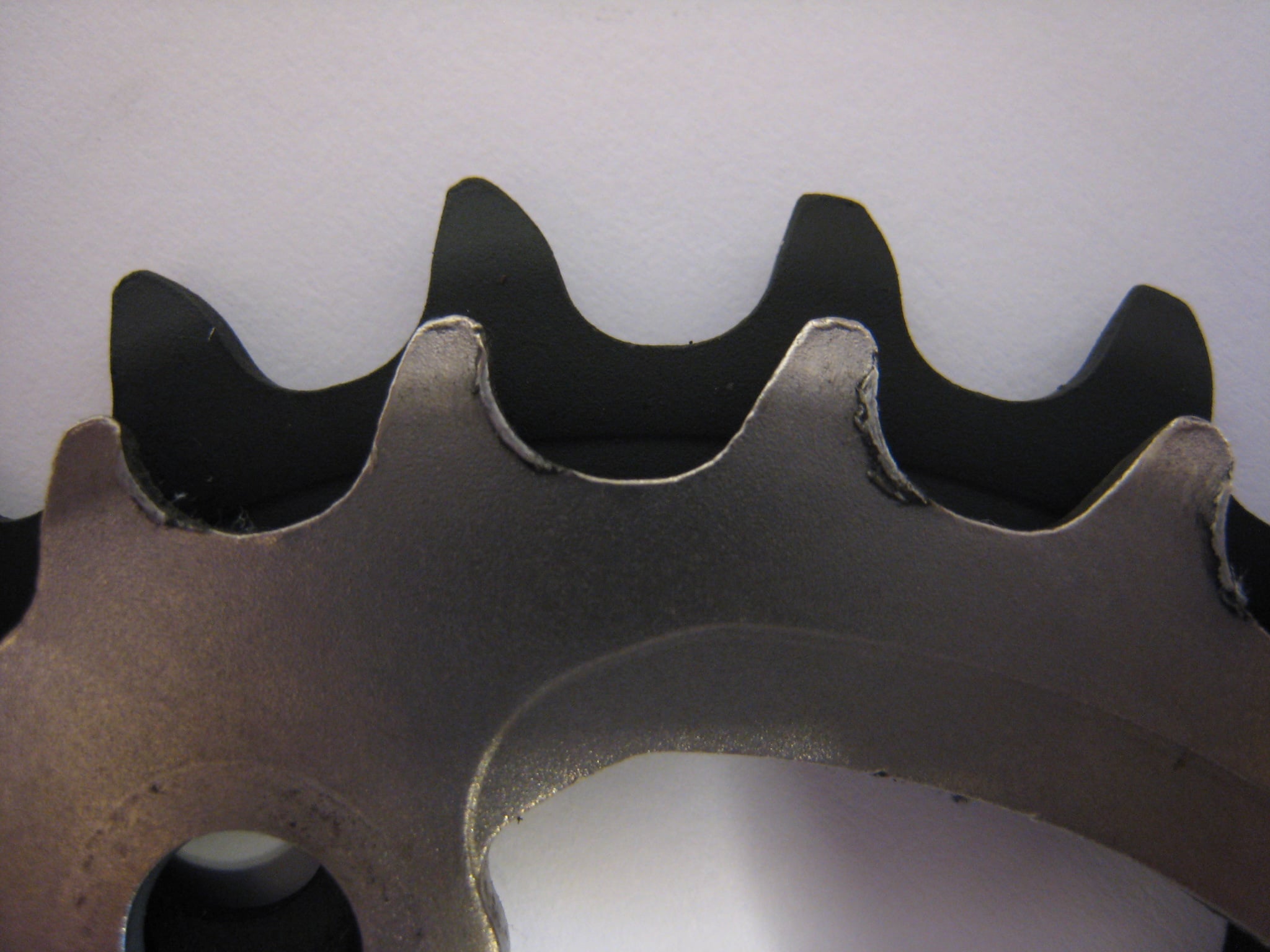

I have just been looking at pictures of my 12-speed chain rings and I can't find any shark toothed ones at all. Maybe I was remembering incorrectly and it was 11-tooth that Sram were on about. It could be that it was a development that didn't stand the test of time? Or my memory is making stuff up! :eek:
9,411
10,001
This is shark toothing!
New one at the back.
You can also see the burring of the teeth casued by pressure from the chain deforming the teeth.
The 11 and 12-speed rings I have pics of look nothing like either of those!
9,411
10,001
Now those look exactly like the ones I was describing when I said "Sram designed the 12-speed ring to be a bit shark-toothed from new".
I have just checked on both my last two 12-speed bikes and they were both Shimano! That would explain the difference! Doh! :giggle:

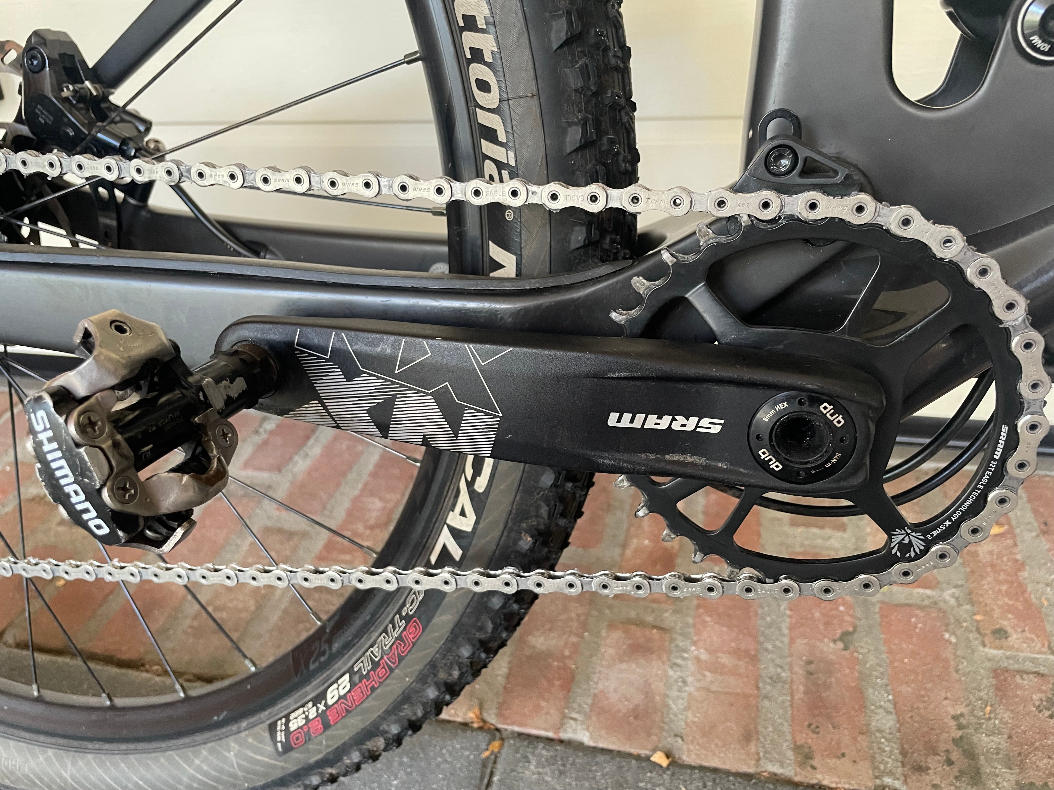

I replaced the quickly wearing NX chain by a XO1 and find this tooic interesting. Being curious I found on SRAM website details for the link surface treatment.
Is it known if the base material of the links is the same steel or if there are different grades with different elongation properties used?
Shimano uses for inner / outer link besides chrome plated descriptions like brown and grey, what does not mean anything to me with regard to steel or steel surface.
This is what SRAM indicates:
NX
INNER LINK FINISHPolished
OUTER LINK FINISHPolished
WEIGHT (G)252
WEIGHT BASED ON114 links
GX chain
INNER LINK FINISHBlack Oxide
OUTER LINK FINISHNickel
WEIGHT (G)244
XO1
INNER LINK FINISHChrome Plated
WEIGHT (G)239 (Hollow Pins)
XX1
INNER LINK FINISHChrome plated +PVD
OUTER LINK FINISHChrome plated + PVD

Yepp, it is the SRAM X-Sync 2 Eagle 34T for Bosch Gen 4 of my bike, engine side up.
During service and taking chainring off the centering ring (small silver conus) got loose (there is some soft adhesive only) from the chainring and I had checked with SRAM if this is a problem. It is not as the ring is just for leveling out chainring on motor axle and to make sure the conic side goes towards engine side.
