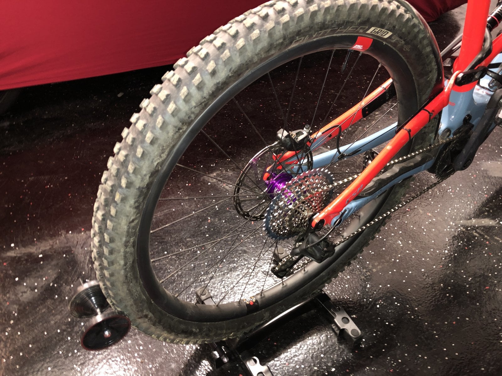

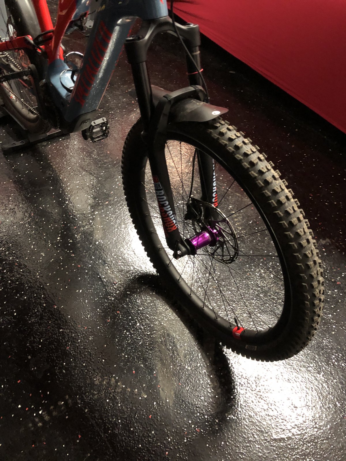

I'm running Reserves on Chris King's on my 19 Comp Carbon. The reserves feel absolutely fantastic and appear to be bomb-proof. I came from carbon Rovals which suffered a catastrophic failure. The DT Swiss hubs should be up for the job, great hubs.
Go for the 30’s.
View attachment 12020 View attachment 12021
