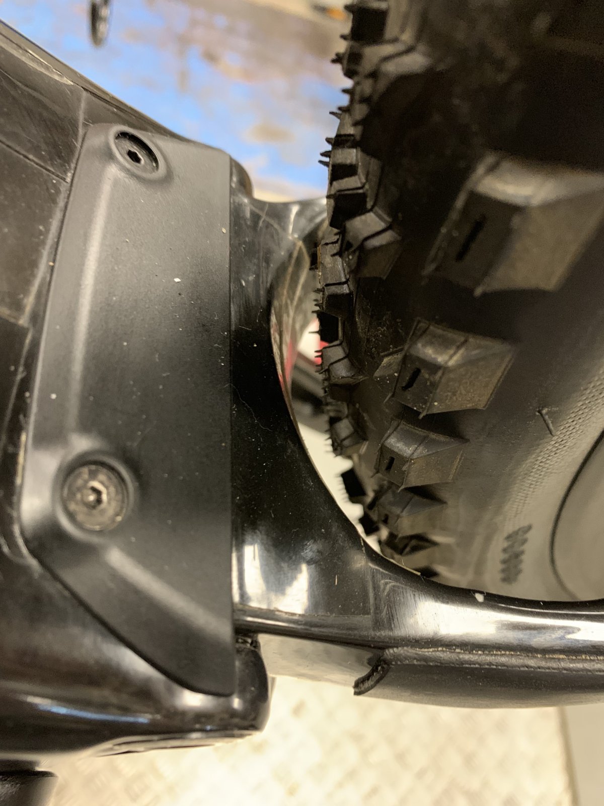

Hello
I owe everyone who contributed to this thread an ending to the issue regarding the 2018 Levo FSR and running a 29" at the rear. The solution was that specialized offered me a free set of Roval Aluminium wheels including tires. After a bit further conversation I paid a little bit more myself and are now the happy owner of a set of Roval Traverse Carbon wheels.
When I finally got in contact with a support minded person within Rider care, the dialogue was outstanding ad I did receive the kind of support you kind of expect when you have just paid a lot for a brand new bike.
Does it work now and the answer is yes but not absolutely perfect. It turns out after testing with many different wheel sets that the way the same tire sit on different rims can make 2-3 mm difference in side wall height. When you have only a couple of mm clearance 3 mm more means a lot and that is where I am right now. At the moment I'm running a Butcher Grid 2.3 at the back and a DHF EXO WT 2.5 up front and must admit that the Butcher is a bit scary at times when it is slippery but the DHF up front is brilliant. Running a 30 mm inner width rim the Butcher is actually only 2.1" wide where as the DHF sits perfectly at 2.5". I also got a 2.6" Purgatory and that is a bit narrower than my 2.4" Maxxis Ardent - Not that it matters that much but I simply don't understand why Specialized is not honest about their tire width.
This is how it sits now, picture shows a 2.3 Ground Control but 2.3 Butcher sits exactly the same:
I'm considering to write a review/comparison between the £1.300 Roval Traverse and my £400 wheel set consisting of Chinese Asymmetric carbon rims paired together with one af the strongest hubs(Novatec 462 with 5 pawl steel free hub/axle) and the strongest Sapim spokes. Some will find my verdict quite surprising.
Karsten

To be honest a 29” DHF 2.5 will not fit on a 2018 Carbon Comp in the rear, my experience is that you can only run a 2.3 rear tire and even that is very close. For example a 2.3 Butcher I have to let all air out before I can get the wheel out of the frame...... That 2018s with alu frames have a bit more space but I don't have any actual experience with them. Don't do the same mistake as me, buy a real 29” bike from the start.
BTW the Roval Carbon wheels are not worth the money, my 1/3 of the prize Chinese wheels are actually better in every aspect.
