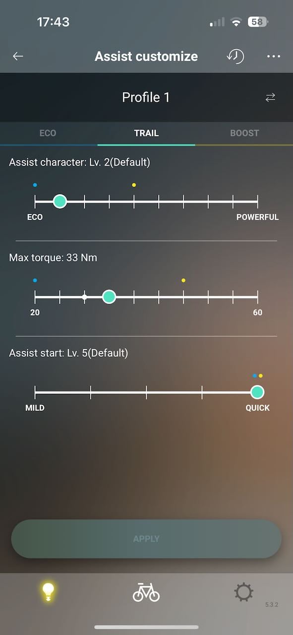

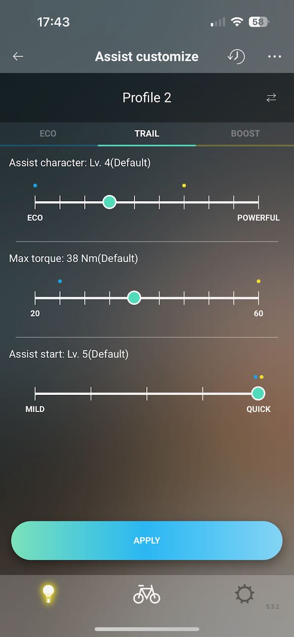

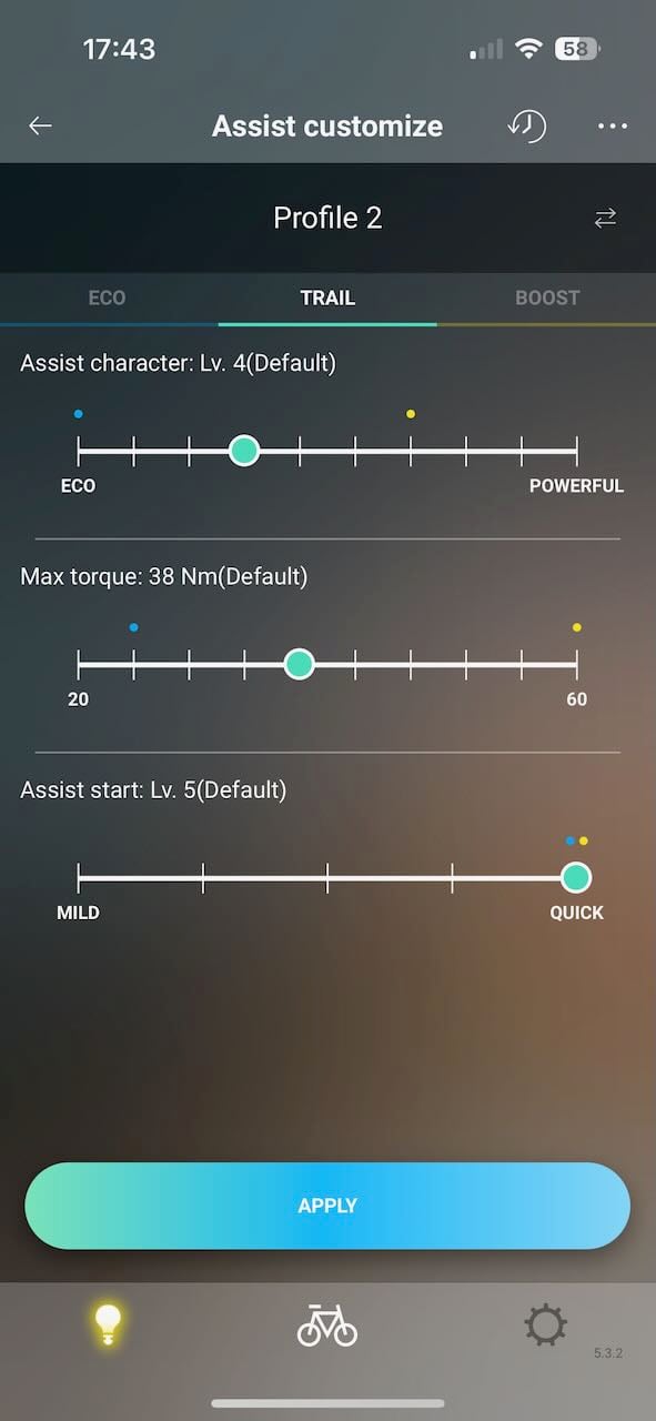

Here you go.
As I'm sure you already know the coloured dots show the position the other modes are in and the white dot shows the default (looks like I've upped the Trail power by one notch on profile 1)

View attachment 143377 View attachment 143378
Thank you so much. That's interesting. My app shows 15 settings now instead of 10 for assist character, I'm not sure how to convert or compare.
So it looks like perhaps the 85nm unlock does more than just simply unlocking the torque values. Unless that's an ep8rs vs ep801rs difference.
