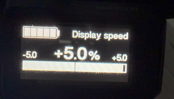

For sure there is a difference if you will change the display speed adjustment value!
However, the only difference is the speed which is shown on the display, but as @Backflip already wrote, the real max. motor support speed of the bike does not change at all.

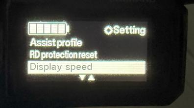

You even can change this display speed solely with your bike display – you don´t even need any smartphone or app!
Just enter the display menu and change the value and you will see that the motor support speed will not change at all:

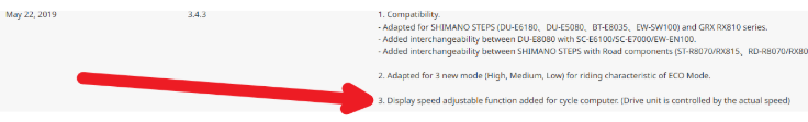

The functionality of the display speed adjustment was integrated from Shimano already in 2019 to the motor firmware of all Shimano STePS drive units (see the first picture in this forum post) and down below again.
See ""Display speed adjustable function for cycle computer" and also see the note: "Drive unit is controlled by the actual speed"):
BTW.: "cycle computer" is the wording convention from Shimano for their displays, "drive unit" is their wording convention for the motor.

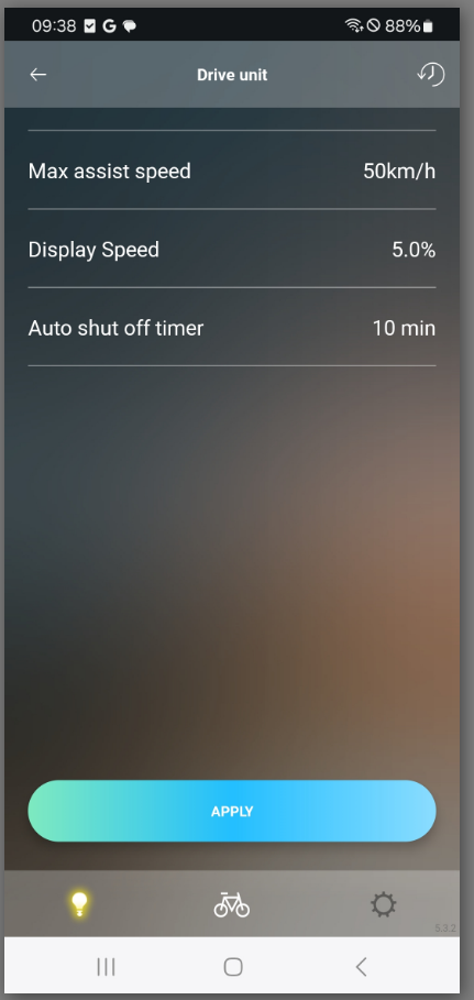

Also you can use the same functionality in the official E-Tube-Project-software from Shimano (Bluetooth based Cyclist app and Windows based Professional program), see e.g. here in the E-Tube-Project-Cyclist app:
The shown parameter "Display Speed" will exactly represent the value which you also can change in the EMAX software.
