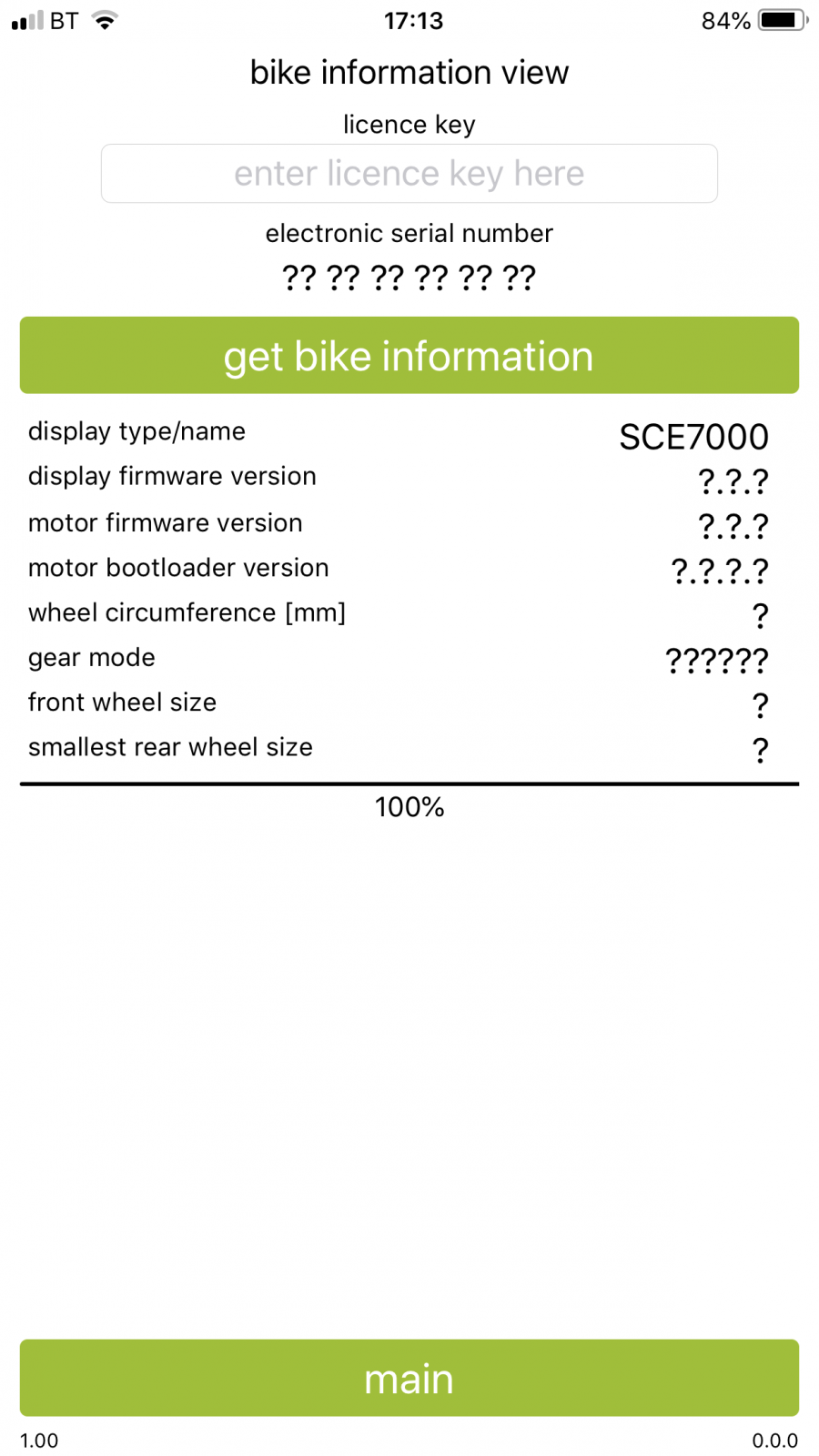

The mobile version of emax-Freemax has been released yesterday. It's only for iOS, for now (the Android version is coming later this year).
No PC/interface needed :)
Search "emaxmobileapp" in the app store and then you can find it.
It costs 1.09€ and without the license you can modify all assistance levels including Eco

Worked on mine. without a licence , connect, you need to bring back the bike information, once this has loaded you can change the power settings.

Did it connect and you requested the app to get the bike information?
It won't to anything till you do that.
