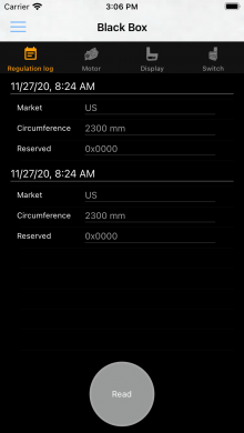

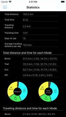

The iOS App got the same features as Android version (Statistics, Black Box and Regulation log (EP8))
The 1.11.51 posted to AppStore...
