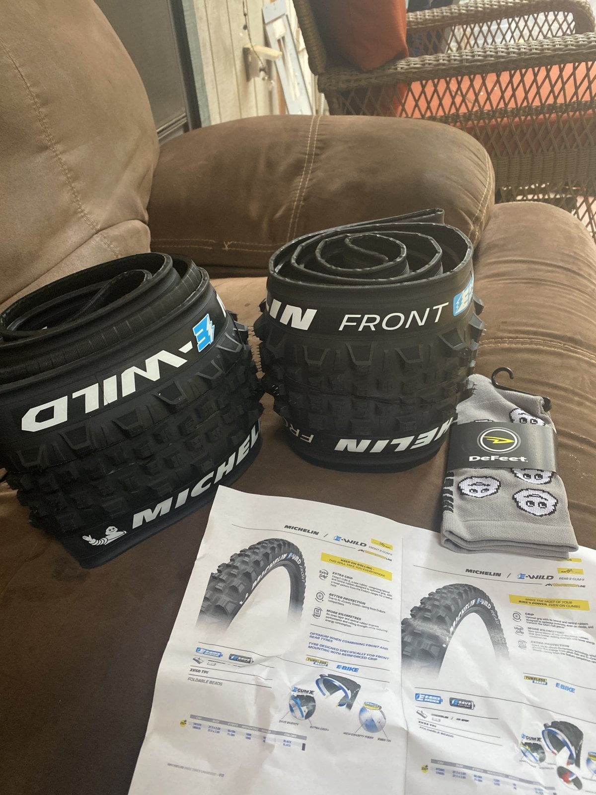

Michelin has supplied me with two 29x2.6 E-wilds to throw down the mountain and write a few reviews on. They just came today so i be mounting them up on two different rim widths. 32 internal and 35 internal to start!
I don’t ever run any type of cores up front so they just be tubeless installs. even got a set of socks to go with them.

First glance. There is a front and rear and the rear tire shares the same tread profile but the tires casing is considerably stiffer and heavier tire. for the weight weenies
Front tire is 1058g
Rear tire is 1318G

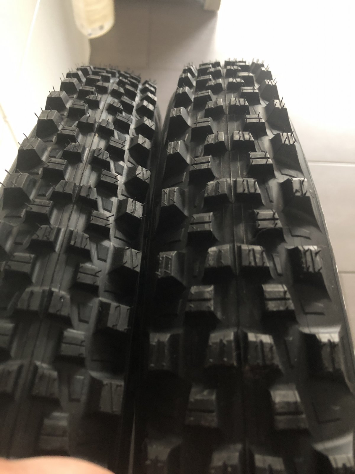

They shipped me the normal Wild Enduro’s 2.4. The patern looks 100% identical to your e-wilds to be honest. Only my front tyre middle patern looks thicker?
Left is rear, right is front.

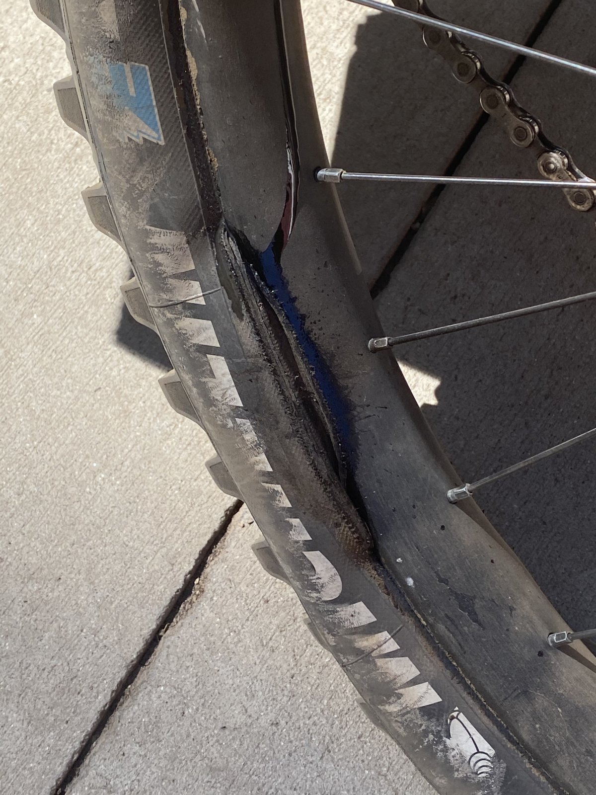

Both the DHR2 evo vase tires tore on edge of rim as the rubber ripped from the threading and wouldn’t seal one cut through on rim edge.
DHR2 evo case failed as a suitable ebike tire and that’s the oem tire to the bike.

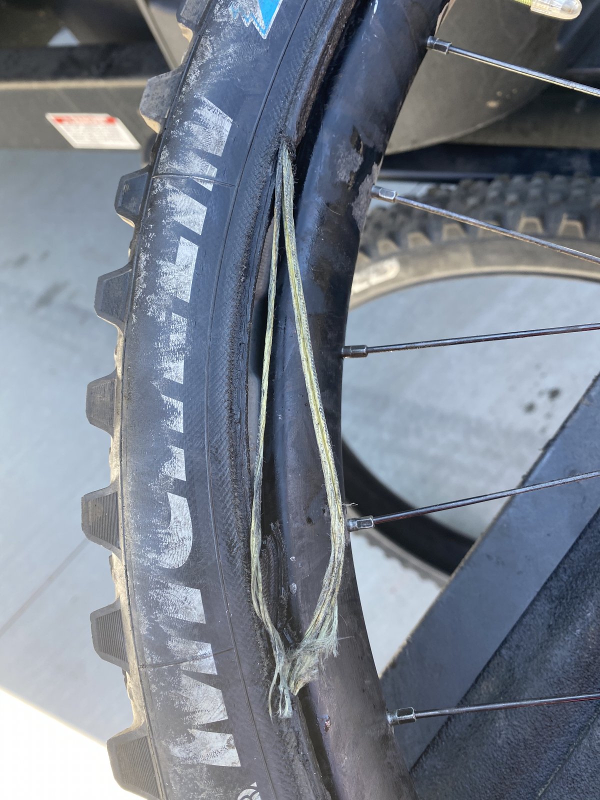

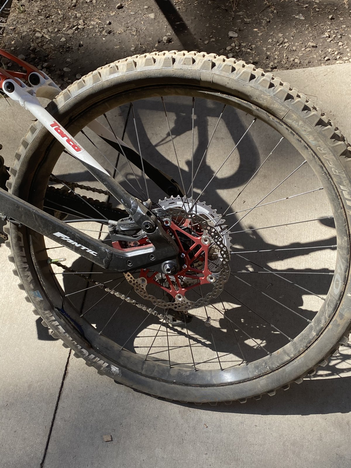

spoke to soon, yesterday at SkyPark just blasting berms and rear tire let go with a bang and pulled the bead cord right through the tire.
the tire is a year old and has 50% tread warn and has had a pretty tough life and was at 40psi when it let go. She was a loud one.

Well done! I think what we're putting these heavier emtb's through is asking a lot from kevlar beads. I notice mine weep sealant out of the bead/rim interface after every day in the park. You can feel it in the corners. Not so much with the wire bead on my dh34's. Wish they made the dh34 and dh22 in 2.5 and/or 2.6
