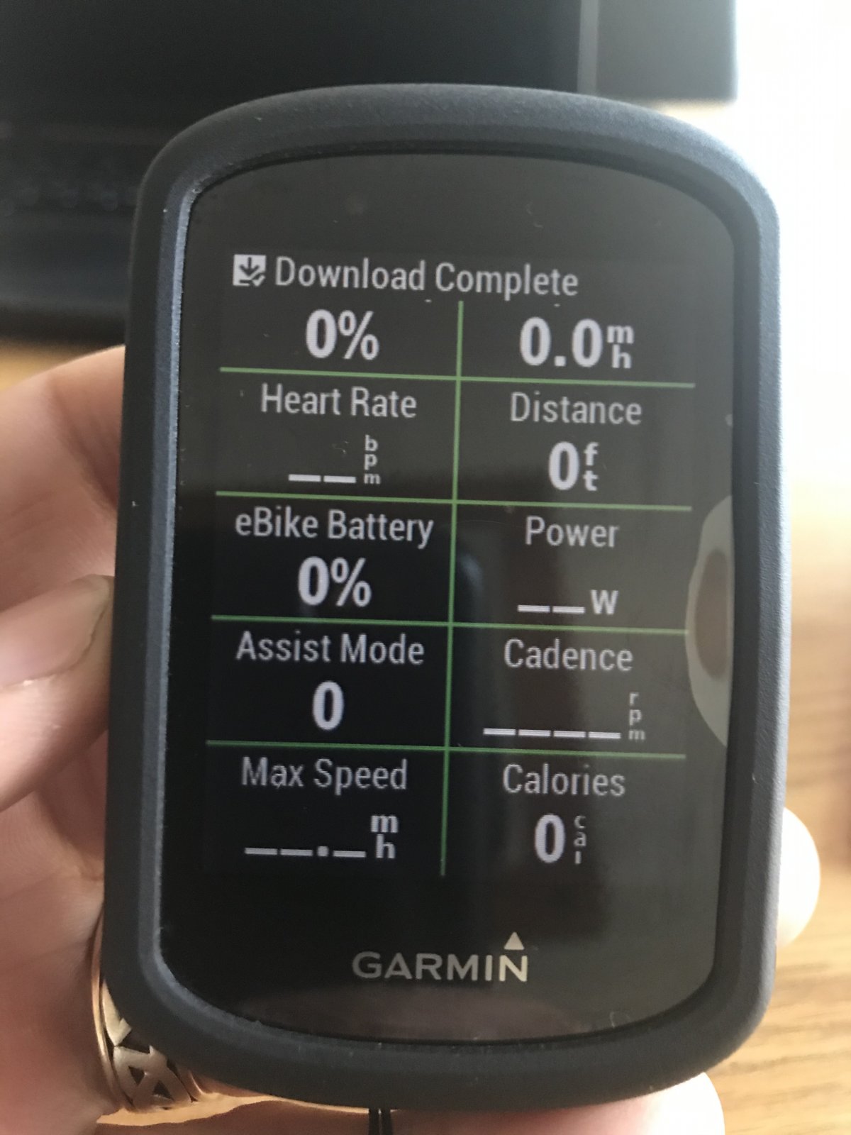

this is great, just binned off the Specialized computer and bought Garmin 530, I set up the main points, but I can’t figure out how to add the support levels (like above 100% ECO). Also how do I volunteer a donation?

Hi @Funkeydunk, so what "main points" did you managed to set up? I need to know in which state you app is in order to help you.
Do you see Ebike Field already on your screen?
This is what I see at the moment
JanCapek, I can see the ebike field, bit it won’t connect to the ebike, I get the speed, cadence and power sensors connect but not the ebike witch gives the battery status and mode, what am I doing wrong

@Funkeydunk : which Edge and which firmware are you running?
It seems, Garmin broke the ebikefield for 530, 830 and 1030 again with their last firmware from last week.
BTW: Ebike Battery and Assist Mode you show on your picture seem not to be Jan Capeks ebike fields!
Did you download „ebike field“ from the Garmin IQ-store?
Ebike Field
Sure did, it’s now showing and intermittently showing the data. If I turn off and back on again it might not show output from the bike. But this looks to be a known bug on the garmin site.
