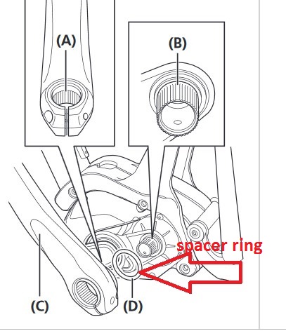

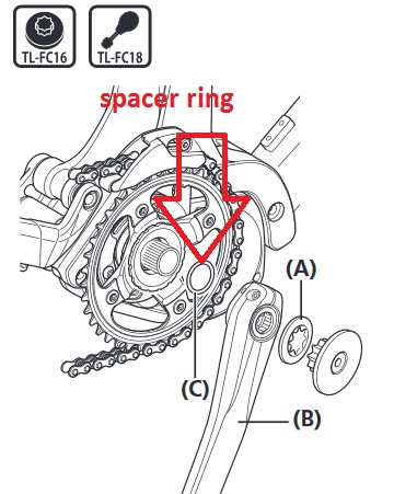

cz
Hello. Do you have pads under the cranks as shown? I don't have them there. Could it affect center clearance and clicks?
