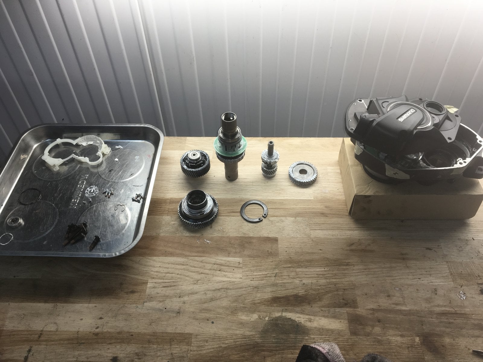

Are the bottom bracket bearings a serviceable item ie. you have to change them regularly as with a conventional bike, or are they manufactured to last the life of the motor?
Nothing on the motor is serviceable if you talk to Shimano, however, if it's just bearings on the bottom bracket worn, they can be changed. I think they will last longer than conventional BB bearings as the seals are much better quality. I've got a motor in bits right now.
I have been wanting to pull a shimano motor apart for ages, but they wouldnt let me keep the shagged old motor when i got a new one. Why did you have to take this one apart?

If mine went once out of warranty I’d definitely have a crack myself before sending it away.
Be cool if you posted the bearing sizes for future reference.
Also wondered if it would be worth opening it up to top up the grease to try & quiet things down a bit but it looks like there is plenty there in your photos.
I stripped this motor specifically to get bearing and seal sizes so I can fix them or supply bearings for folk to do them for themselves. Most people take things like this back for shops to do but I'm not like that plus it's taking weeks to get repairs and replacement motors done and it's only going to get worse in my opinion. I'm not going to say it's an easy job to change the bearings because it's not. There's a lot of tiny wires inside so I'm making a jig to hold the casings steady so I don't break them.
I don't think adding more grease will quiet it down much, depends what's worn if it's noisy.
You'd have to be careful what type of grease you used as well. There's two sorts in there and some greases will weaken the nylon gears. I'm getting the grease spec. sorted so I should be able to let you know what to use.

You will know after taking it apart, but I understand there is a sprag clutch in there. If it is anything like my Onyx hub you cannot use anything with 'dry' lubricants (PTFE, moly, etc) in the lubes as they can allow the clutch to slip. They only endorse Kluber Isoflex LDS 18 special.
If you are planning to turn this into a venture I can understand you wishing to be tight lipped. All the best and I hope it goes well.(y)
Yes there's a tapered sprag clutch on the main bottom bracket shaft (under the narrow green circuit board you can see in my photo). I've passed some grease onto a supplier I use in my job to see what I need. It looks expensive stuff whatever it is. I'm not sure if I have the time to set it up as a venture. I race enduro KTM's, do up road motorbikes, race and ride the E bike and look after all my mates E bikes as well. Oh, and supply Merida bash guards that I make in my limited spare time. I may just let folk know what bearings they need to do it themselves.
