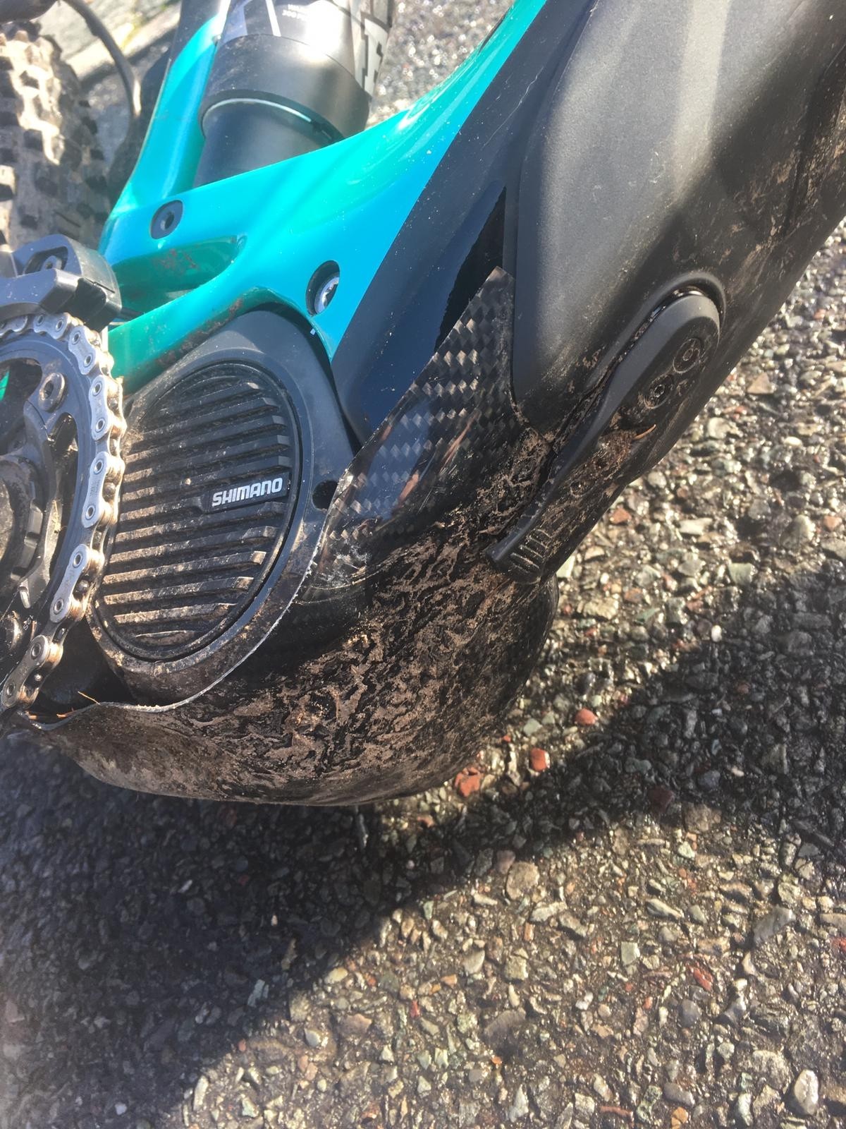

I often ride where there is a lot of loose rocks getting thrown up by the front wheel, I have damage to both sides of my Shimano motor from this and also to the cranks, if the rockguardz was a bit thicker and slightly wider it would probably be ok but as it is I don't think in the long term it will work mainly because I can't see it surviving the rock strikes

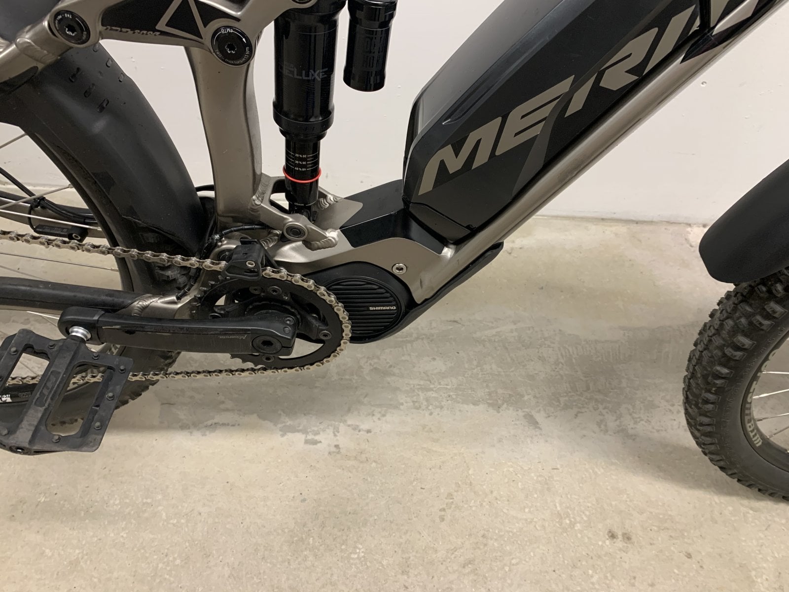

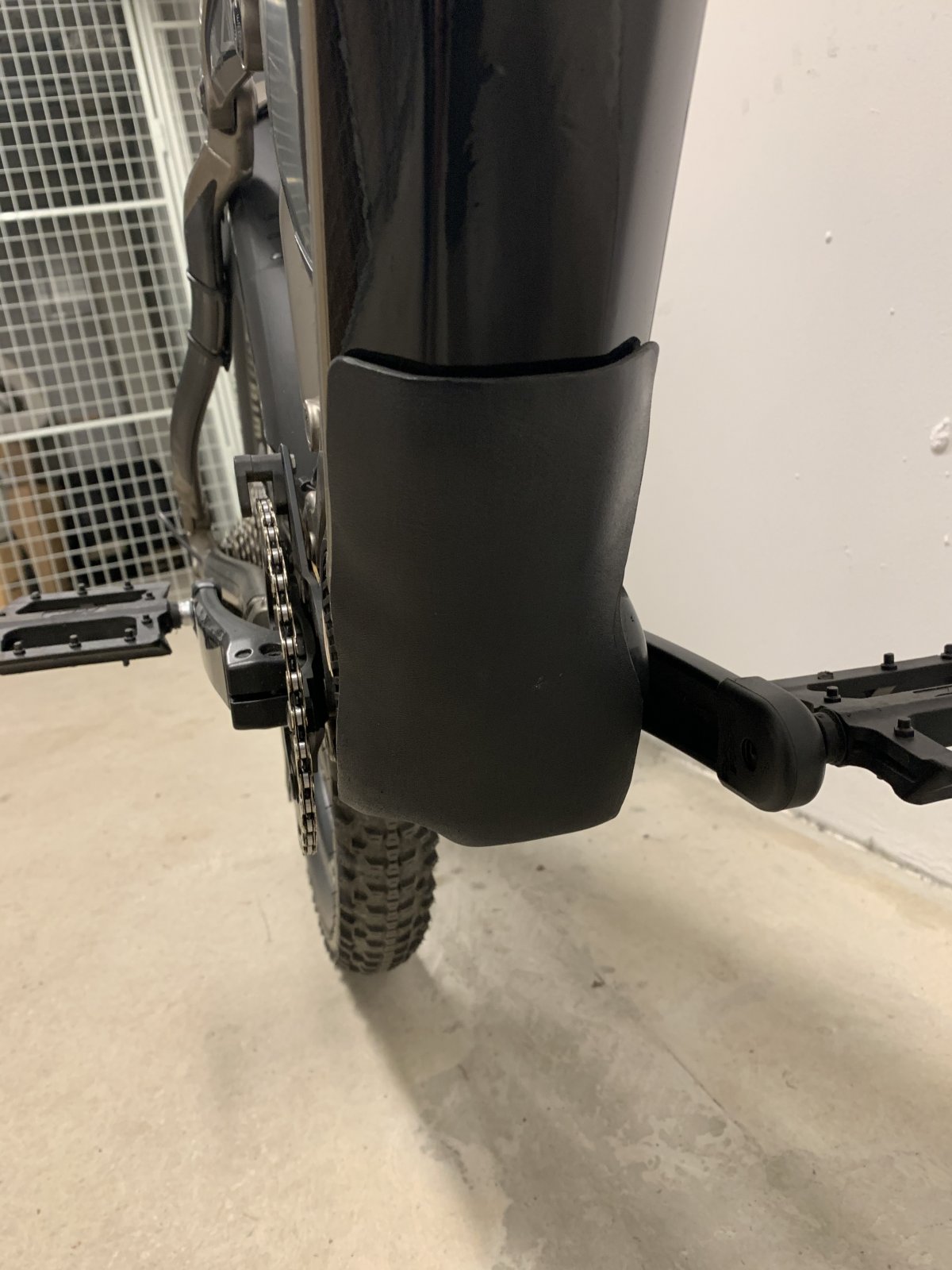

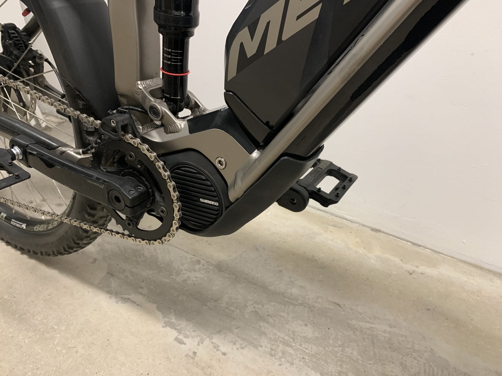

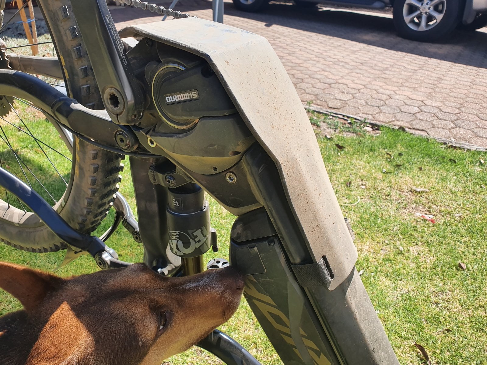

Knocked this up over the weekend. A mate had some leftover 6mm nylon type stuff, so a jigsaw, hairdryer and some heavy duty velcro plus a couple of hours of fiddling and I reckon it turned out ok.
A dozen runs down some rocky trails and it held on like a champ.
A dozen runs down some rocky trails and it held on like a champ. View attachment 24489 View attachment 24490 View attachment 24491 View attachment 24492
Nice job, I've got one of rallysaloons ones on my Merida and yours looks just as good. How have you mounted it at the back under the motor as can't see in the pics. A mate up here in Qld looking for one ATM, any chance you make more and start yourself up a side gig. Otherwise you have been inspirational and might give it a go myself for him, cheers Steve

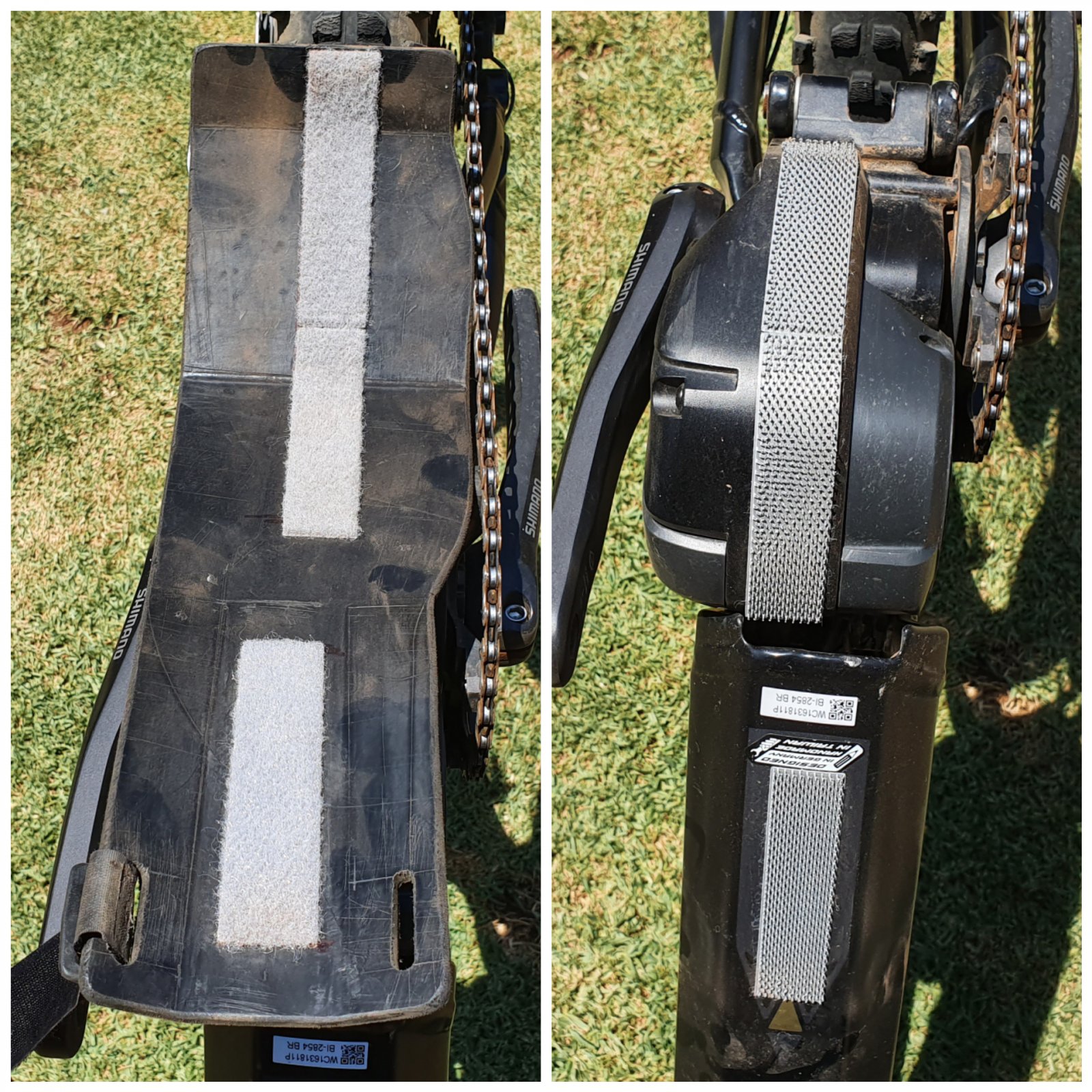

Just using heavy duty velcro. Sticks like shit to a blanket. Straps just a backup safety really.
Seriously dude, if you can get the material ( still trying to find out exactly what it is. A type of nylon) just make a cardboard template to get the measurements. Cut out and mark out. Vice and a hairdryer. Job done.

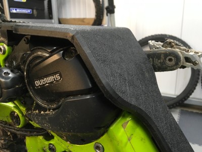

My experience from MX is that carbon fibre deforms with impact. What this means is that impacts to the guard are sent through to the (exhaust header) part behind...The carbon cracks and the metal is dented anyway ! Ouch...

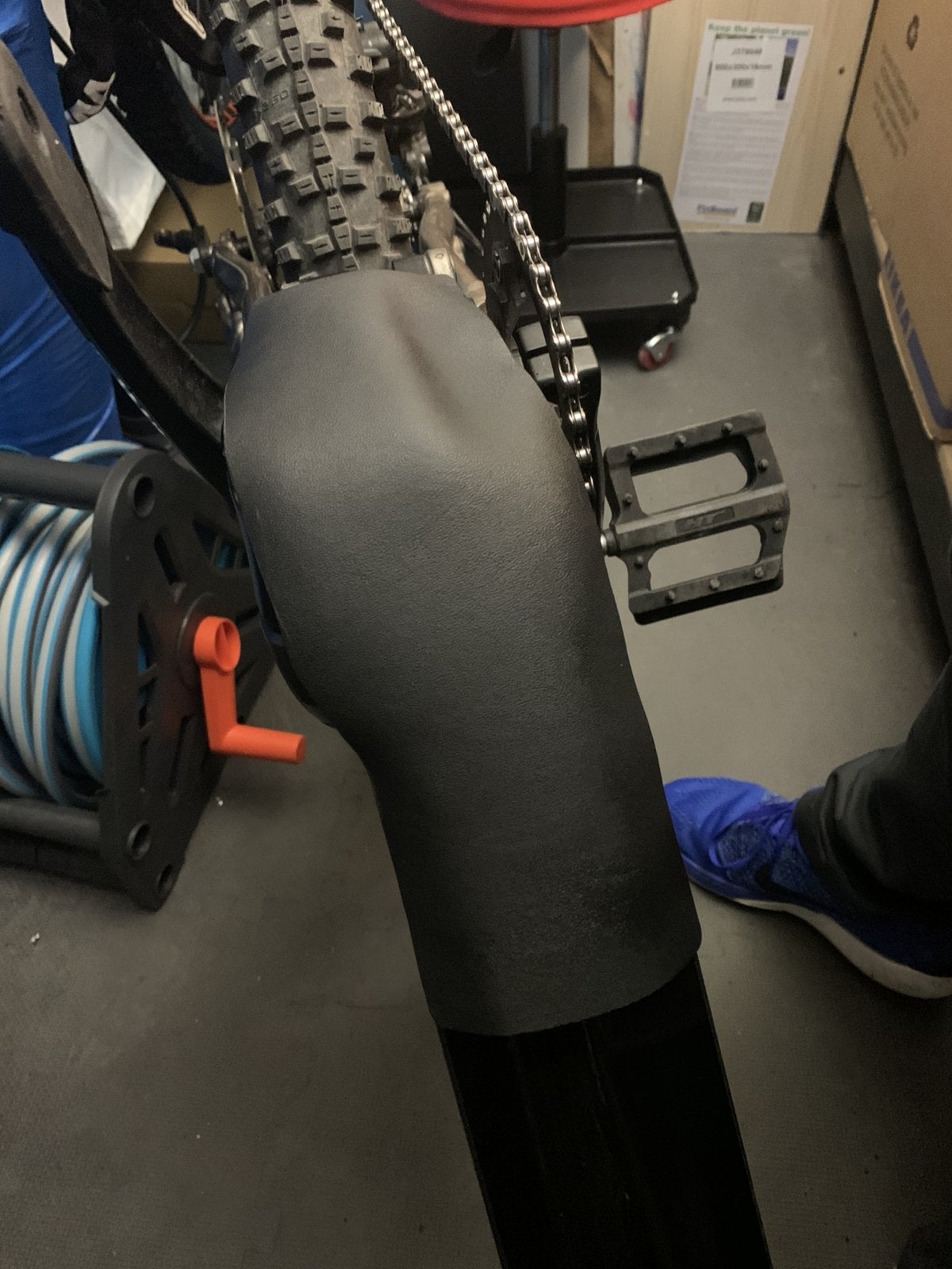

Its a shame @Rallysaloon that you didnt explain it more clearly in the description for your gaurds...I had no idea that you had engineered a bracket, let alone had it anodised , and couldn't justify £45 +P&P when its basically just recycled ABS, cut and formed with heat....
Chain ring protection is definitely a thing- in fact, it needs to be an entire "skid plate", which I think you have achieved.It might be overkill for some riders and terrain. I have a plastic ABS skid plate on my Husqvarna 2T as standard and an aluminium one for heavier duty situations- depends where you are riding!?
Like all these things, they will get very dirty behind and damage the paint/frame..so need to be removed and cleaned thoroughly on a regilar basis from my experience...but perhaps Im a bit OCD !!?!
@Husky430...Its just (recycled) ABS plastic...
ABS Plastic Sheets | 1.0mm - 6.0mm Cut To Size In A Range Of Colours

The velcro holds superb too, 63 runs of our local rocky stuff and i still had to pull hard to get it off this morning for measuring.

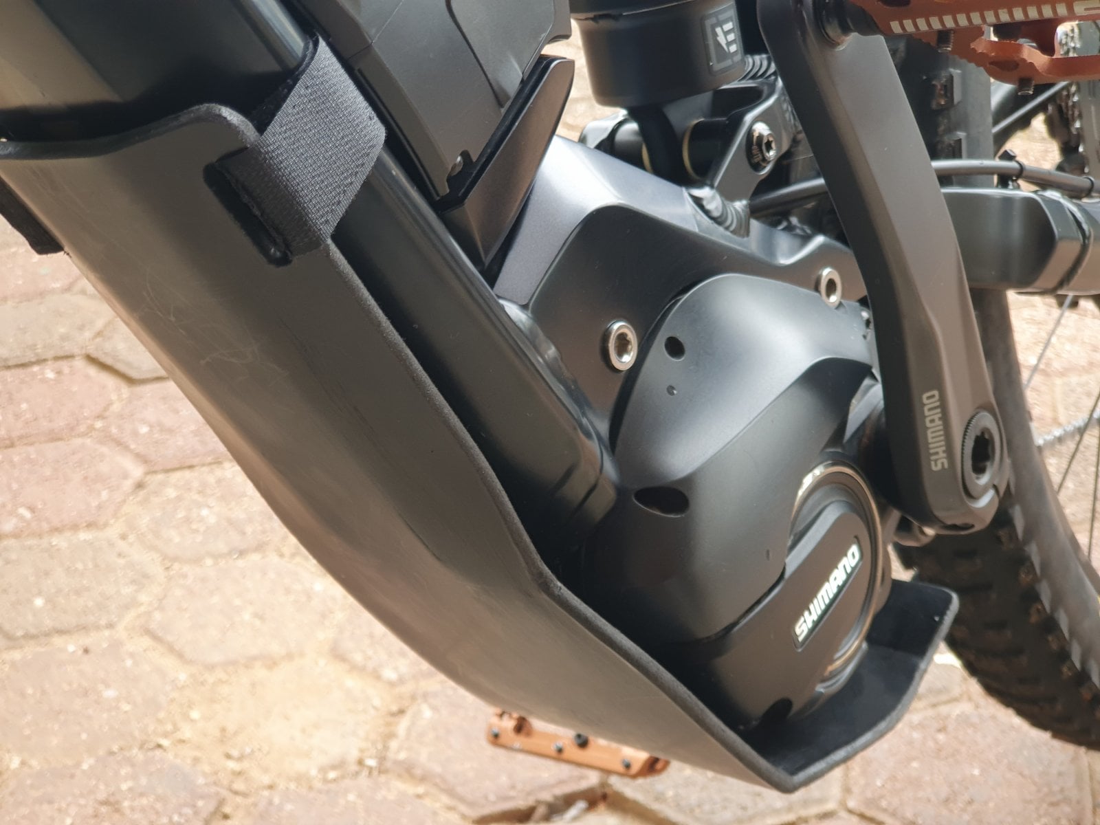

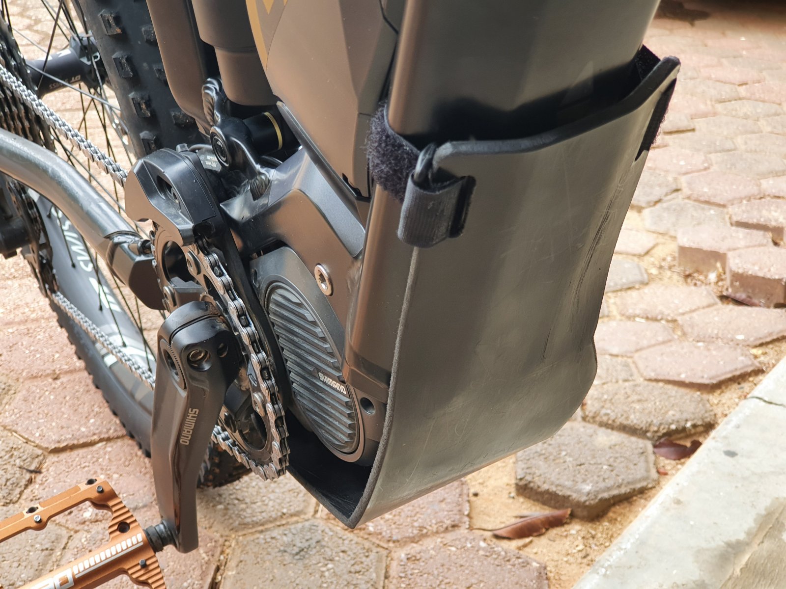

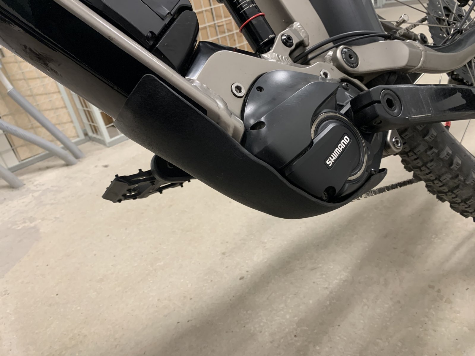

I followed Pinned's design and modified it a bit. Really satisfied with the snug fit and discreet looks. I used 3.2mm Kydex, stronger and more impact resistant than ABS. Also easier to find online. Very easy material to work with. A heat gun makes the job easy. Used heavy duty velcro to attach it to the frame and motor.

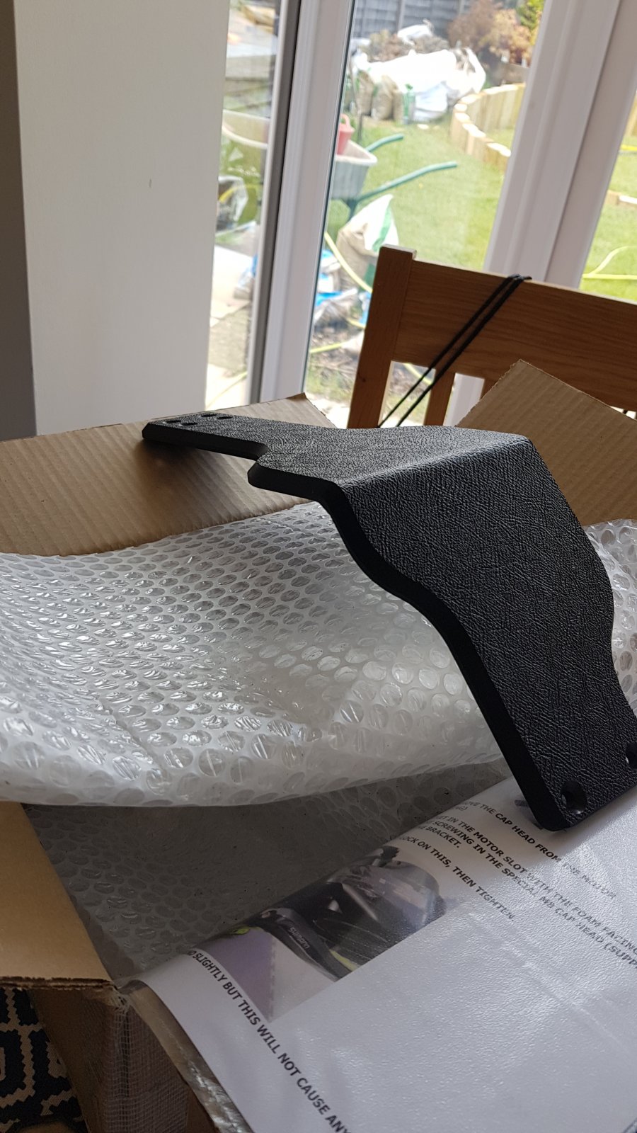

Ordered yesterday and arrived today! Will get it fitted tonight and hopefully for a ride over the weekend if an injury clears up.
Cheers to RallySaloon. Really didn't expect it to arrive so quickly.
Nice job in making that bash plate. Nice look and surely it will give plenty of protection..
