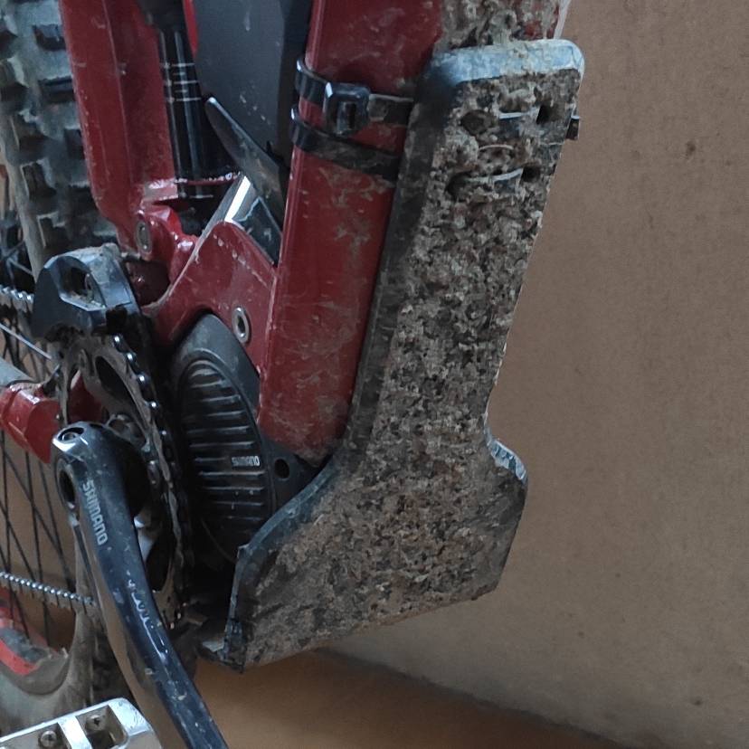

There is another type on eBay Here. I think the design of this one & yours is superior to the rockgaurds as there is space between the bash & the motor, obviously it will become a shit shelf but it will offer more protection.
Cheers.
I bought one of these a few weeks ago. Fairly easy to fit and remove if required. I've ridden a couple of hundred km and all well

I fitted mine today, TBH I don't think this is going to help in the way I thought it would, I was hoping it would act as a proper bash to allow say hitting a fallen tree with with the motor if I failed to hop it. Looking at it I think Rallysaloon's guard is better but I've not seen one in the flesh, I would also like to see it slimmed down to look more like the Husqavana which I just think looks 'right'.

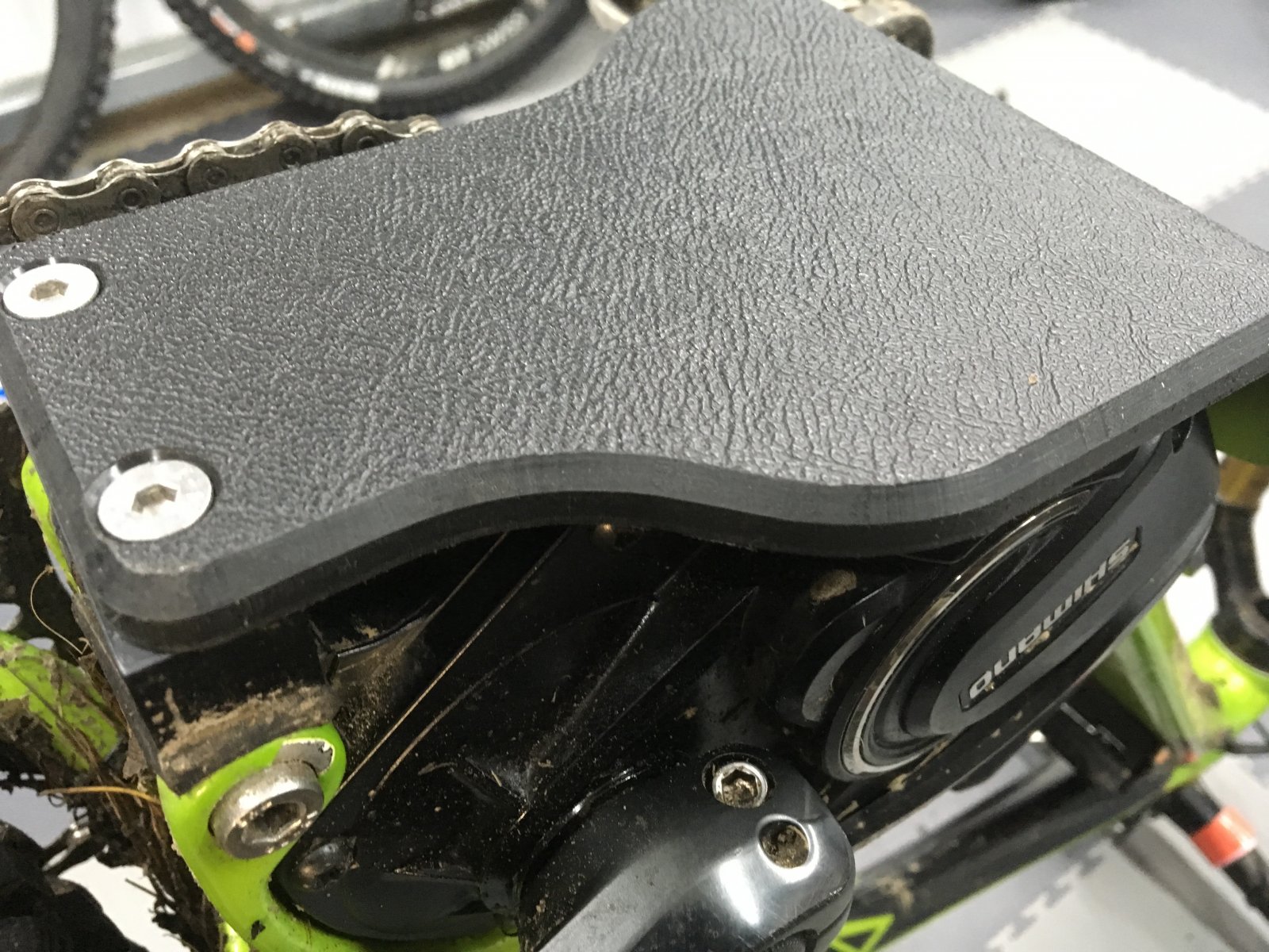

I can trim one down if you want, no problem. As for hopping over trees etc, that's what it's designed to do. Just let me know how wide you would like it and I'll cut one down, fit it and let you see a photo.
I wouldn't ask you to do that unless I was certain I wanted one, I also have a E120 & don't know for certain it fits the same as it does on the 160. What I would like to know is if your guard gives clearance between the motor & the bash, if so how much, & what its made from & what it weighs (last one is moot but I would still like to know)

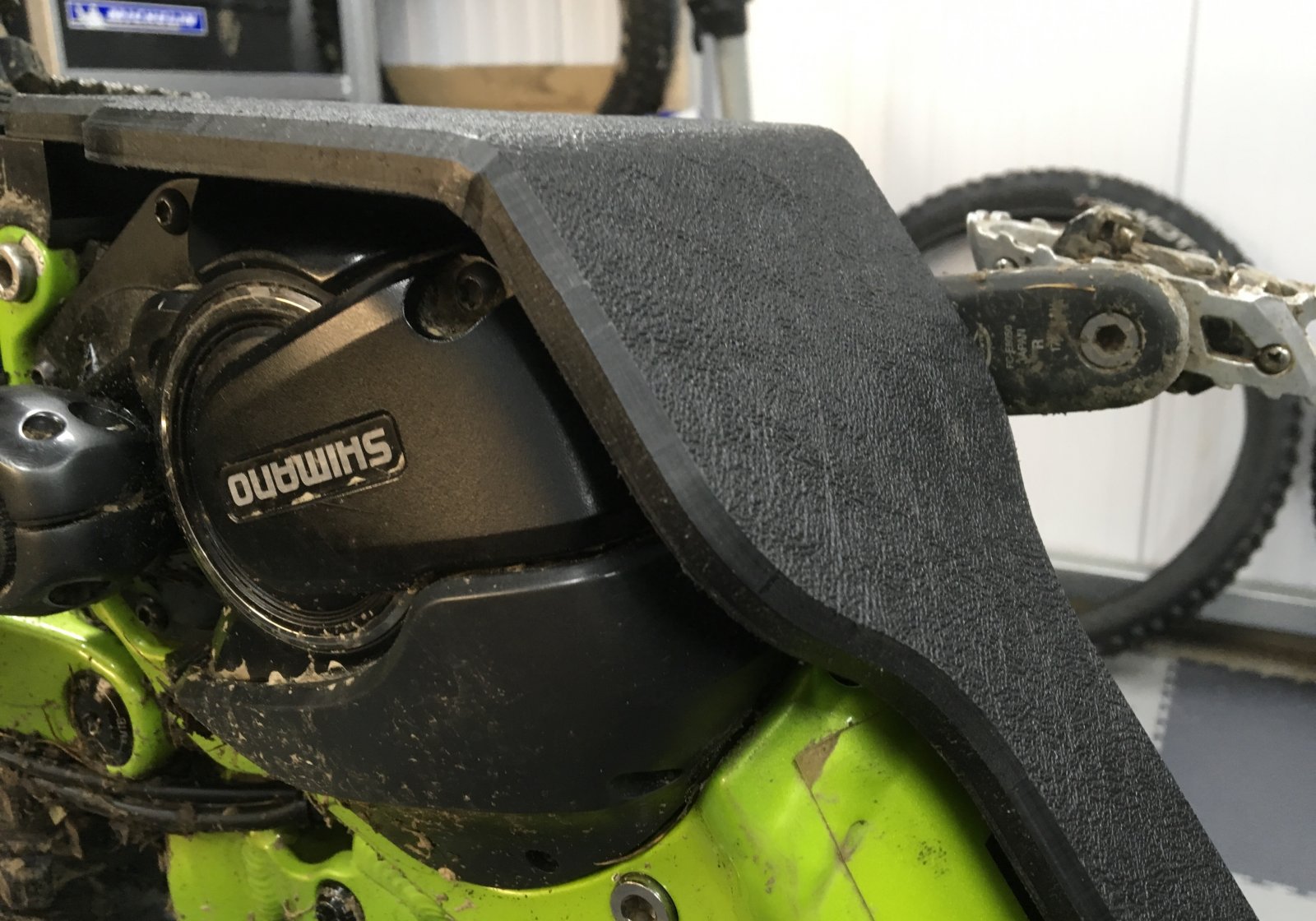

It fits an E120 (my misses has one). There’s little or no clearance between the motor and guard. It’s made from a heavy duty type of plastic and it weighs nothing, relatively speaking. Less than one pedal. I’ll weigh one but it’s really not heavy at all.

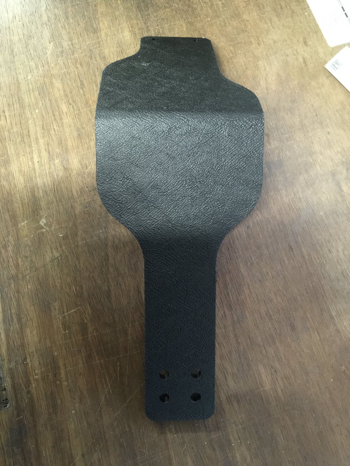

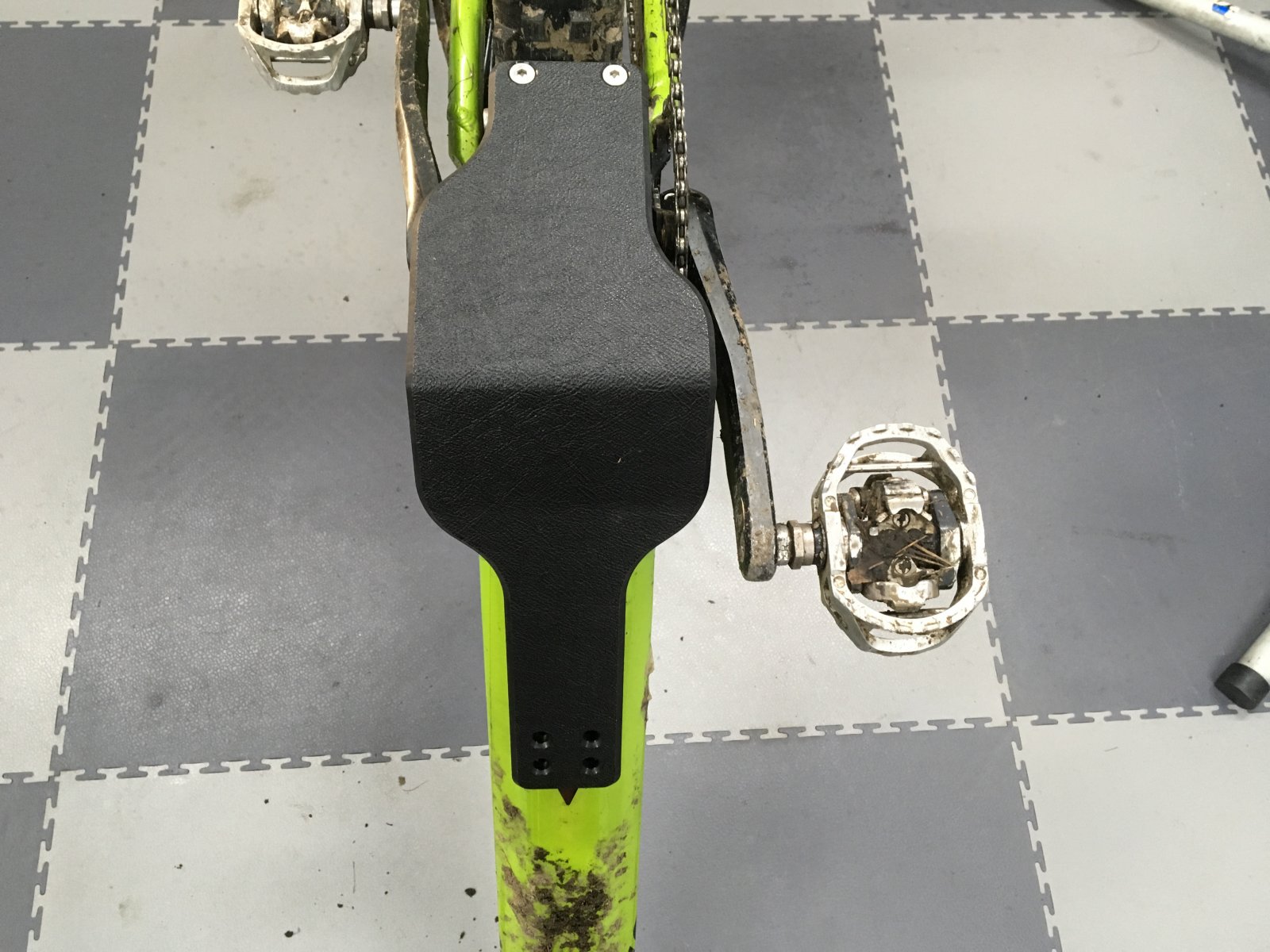

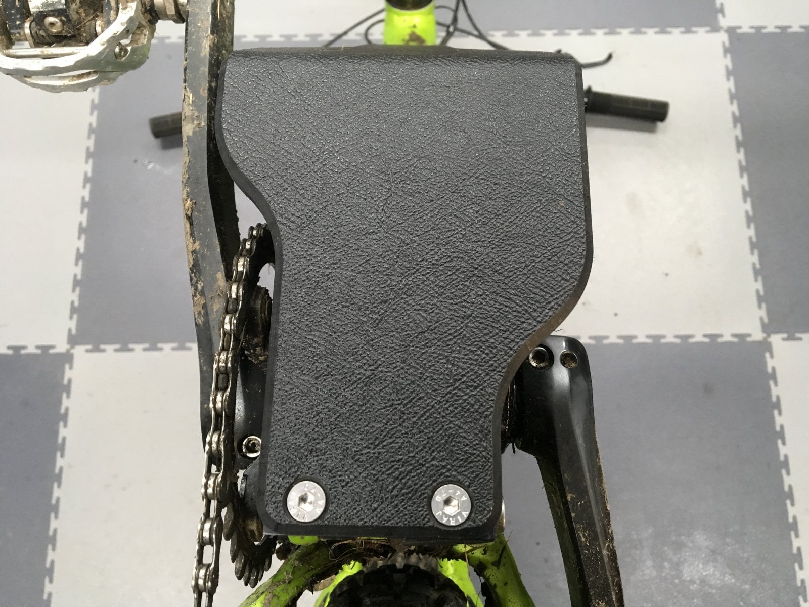

New guards are as in the above photos. All bolts brackets etc supplied. No drilling or mods to the bike required. Just need a 6mm Allen key and fits in a couple of mins.

Great thanks, sorry but I cannot see how/where the 6mm allen key bolts will screw in as no holes i can see on my bike to accomodate. I have a 2019 e160 900e. Also, looks like to place an order with you is best done via Ebay as per the like carra1969 posted correct ?

You take out one of the bolts already on your bike and replace it with a special one I supply. The bracket I supply is fastened in wth this bolt. You then use the two countersunk bolts I supply to fasten the guard to the bracket.

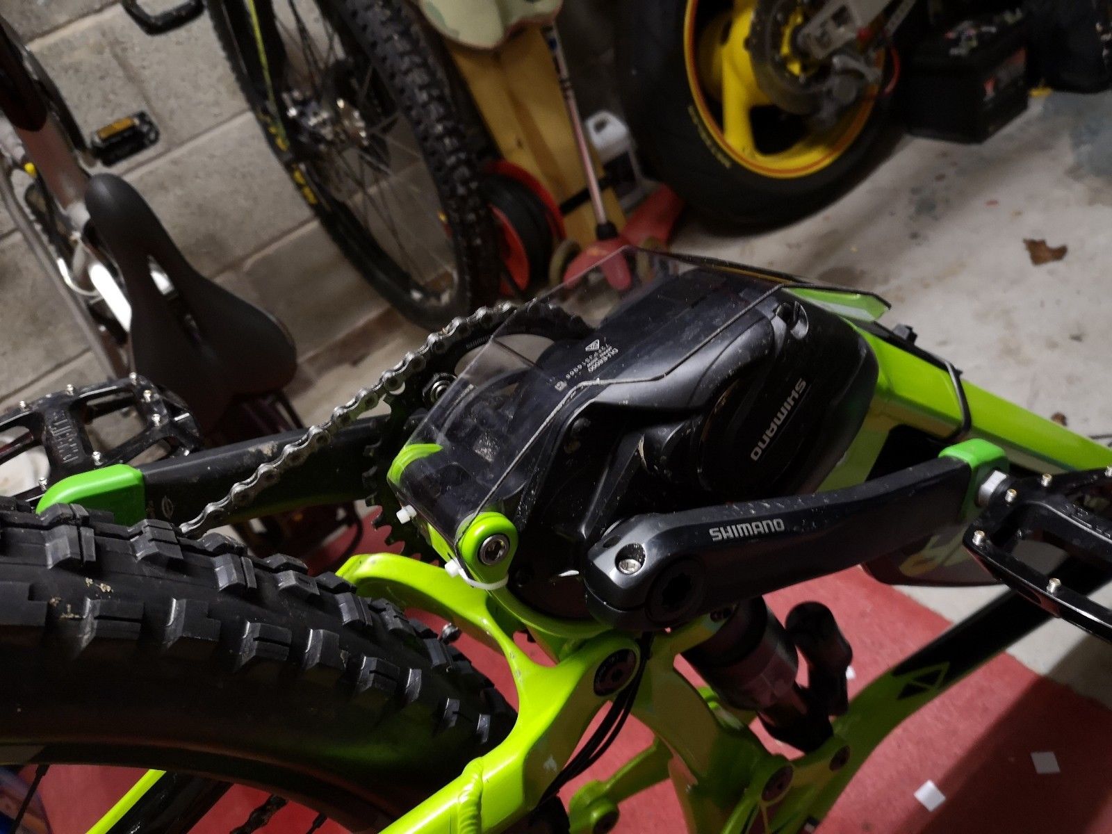

Hi. I have been riding with mine on for a while on my e160 900e and have found that it rarely impacts on clearance and when it does its not an issue as you have piece of mind that your frame, motor and chain ring are protected. I had some concerns about paint rub at the front and wrapped the frame with a 3M film first before using the supplied velco strips and cable ties which securely mount the guard to the frame. As for the appearance I think the guard enhances the aggressive style of the bike.
I've had Rallysaloon's bashplate on my 900E since new (approx. 6 months - 800+ kms). It was easy to fit and fitted perfectly. It gives robust protection to the lower frame, chain ring and most importantly the motor. It gives me confidence over rocks and logs if I don't clear the obstruction without scraping (I'm not an expert rider). It's well designed and manufactured and worth the price including postage (mine arrived in Australia four days after ordering it from the U.K.).

Ditto what QZIAU said, fitted like a glove and so easy to install. You can hear when rocks, sticks etc hit flicked up from the front wheel and it gives you the confidence to try stuff that you know will hit whilst riding over logs and rock gardens etc. IMHO worth every cent just for the piece of mind.
