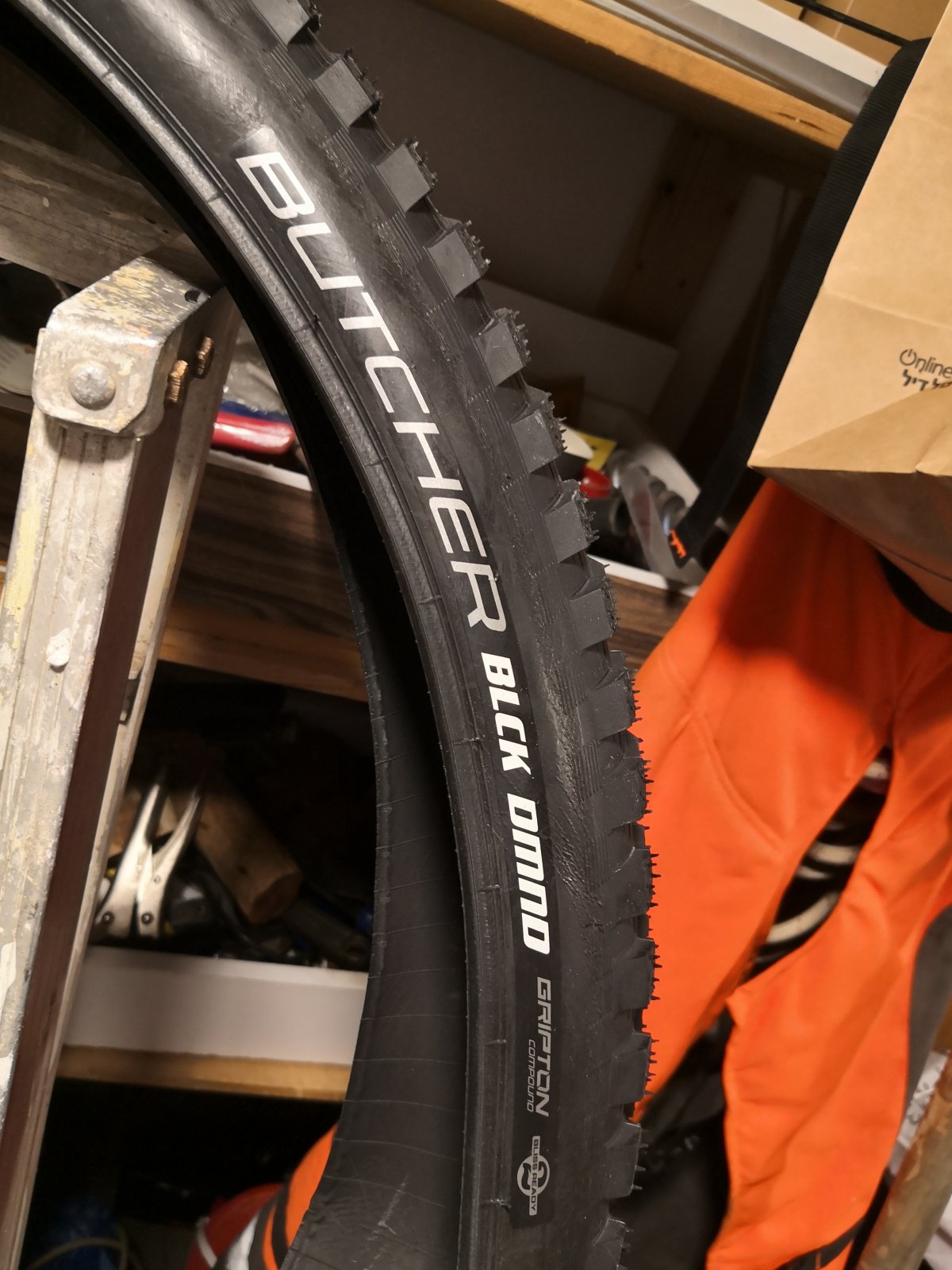

I'm sorry to say, after trying time and again... The minion 2.8s are crap! Their sidewalls are way! Too weak! Even cushcore couldn't save them from snakebites! When running low pressures that are totally needed in the dry powdery rocky terrain here.. for grip.
A DD or downhill casing would be great! Unfortunately Maxxis does not make them! In 2.8... go figure...
Before wasting my money, by trying to switch to minions, I ran the only DD tire available in 2.8 - the Specialized butcher black diamond. With pressures as low as 14psi! For over a year... Never! Had a pinch flat ( with the aforementioned cushcore inserts)
So I've given up in Maxxis..
Gone back to the spec. Black diamond! It's a great tire! Feels great! Stiff sidewalls! (Especially with cushcore) so you can run it safely down to 15-18psi, without flats or squirmy feeling.
Unless you are racing the extra weight and slightly "slower tire" will make no difference..IMHO.
I'm running these on my Enduro (well, the 2.6, not the 2.8) and have so far been happy with them. So taking into account my test ride (above), I think I may just get some more 2.6s for the E160 and just run the same tyres on both bikes.

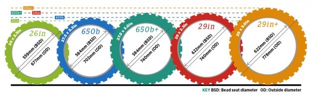

You will drop the BB height by 12.5 mm by going to a non plus tyre due to the smaller diameter (705mm v 730mm). I wouldn't recommend that on the Merida E160. I have the same bike and turfed the Minnions for a 29er front wheel/tyre (Eddie Current 2.6) and an Eddie 2.8 rear. Epic combo and raises the BB by 5mm on an already low BB. I am on Sydney's Northern Beaches, so yes rocky as!
Where did you get those figures from? I'll have a measure when I'm at home, but I'd be surprised if the difference between the two really was an inch.

It's not. The difference between a 2.6 and 2.8" minion on the same rim width (30mm) will be less than 6mm in height.
The Merida also doesn't have a particularly low BB anyway

Is the 2.6 a plus tyre?
No idea if it's classed as one or not.
But I've just done a rough measure of a 2.6 Maxxis DHF on the E160, a 2.8 Maxxis DHF on the E160 and a 2.6 Butcher Grid on the Enduro. All 3 are close (around 720mm) but if anything the Butcher is the tallest - possibly because it's mounted on a 30mm rim rather than the 35mm of the E160, so maybe stands a little taller.
But I couldn't measure a difference between the Maxxis 2.6 and 2.8. Maybe doing a proper rolling distance measurement would show something, but it's certainly not going to be more than a few mm.
Where did they pull those numbers from?
That chart seems to indicate all 650B tyres are the same diameter???? Hardly!
My bike dropped maybe 5mm going from 2.8 to 2.5/2.6. Maore than made up for that by putting on a longer travel fork....
