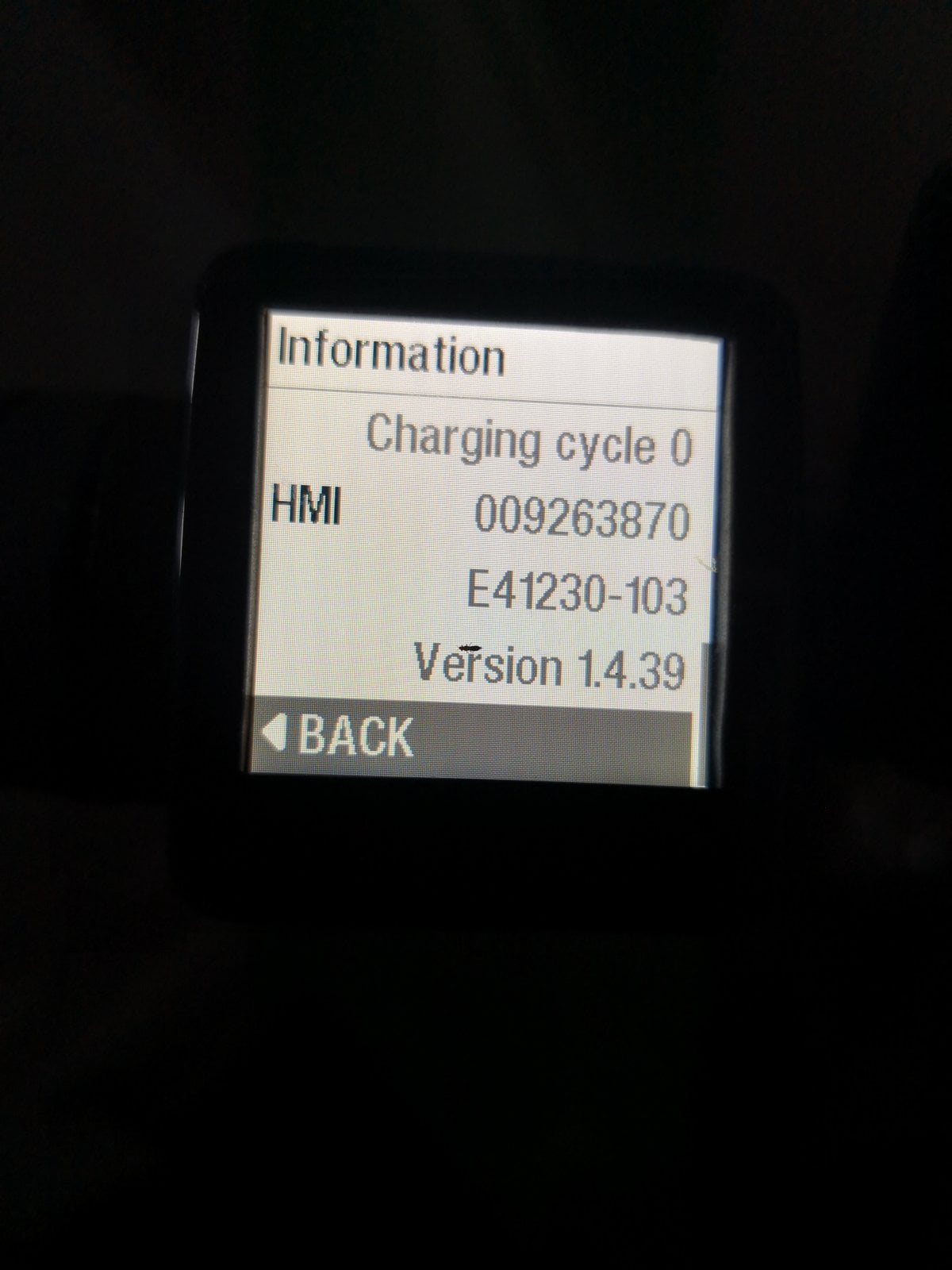

It is a Brose controller and I bought the bike early this year.
My controller has stopped working on the mode rocker switch for motor assistance dead. Is this like your one July was when I received the E bike. With new Brose controller.
