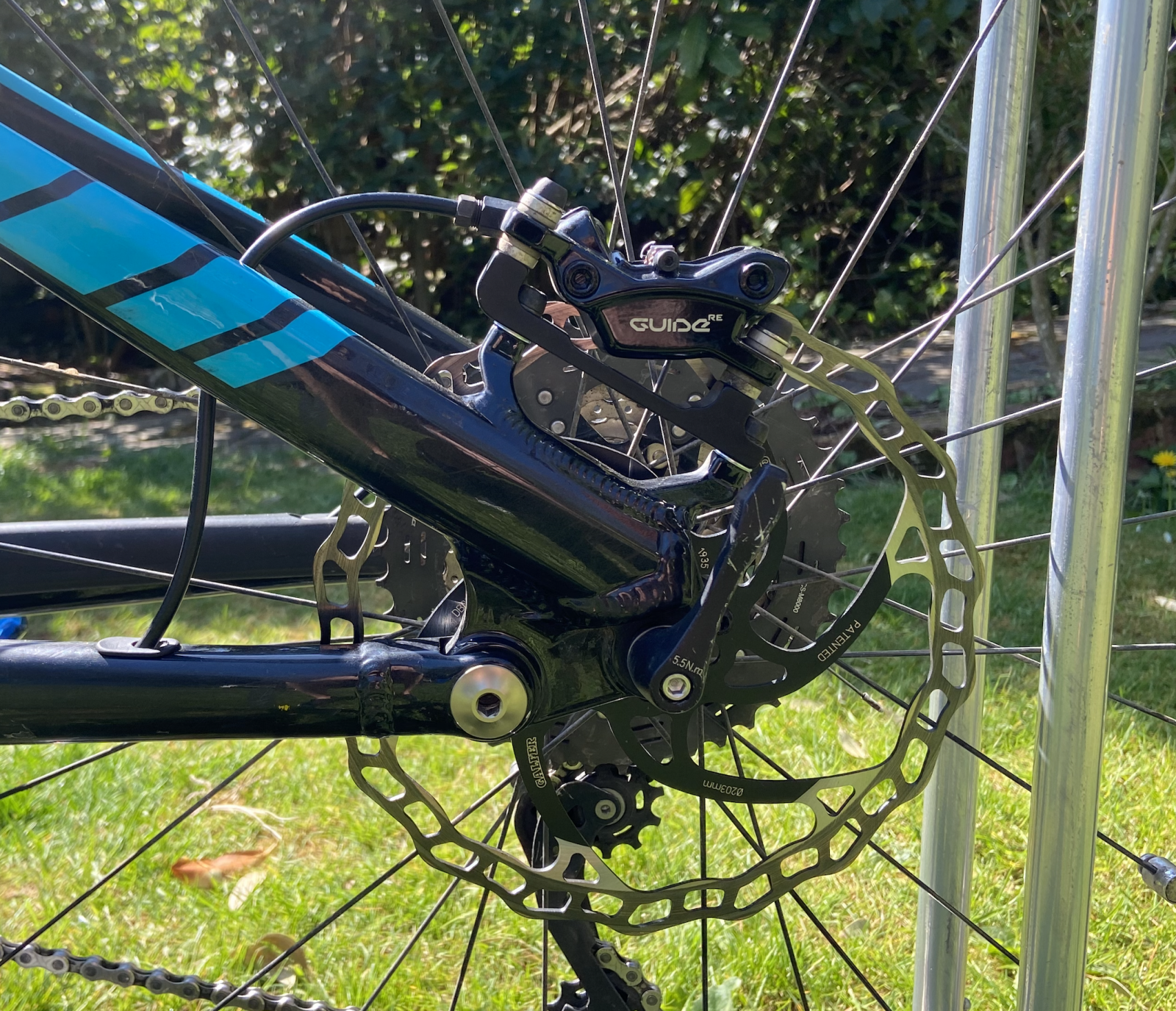

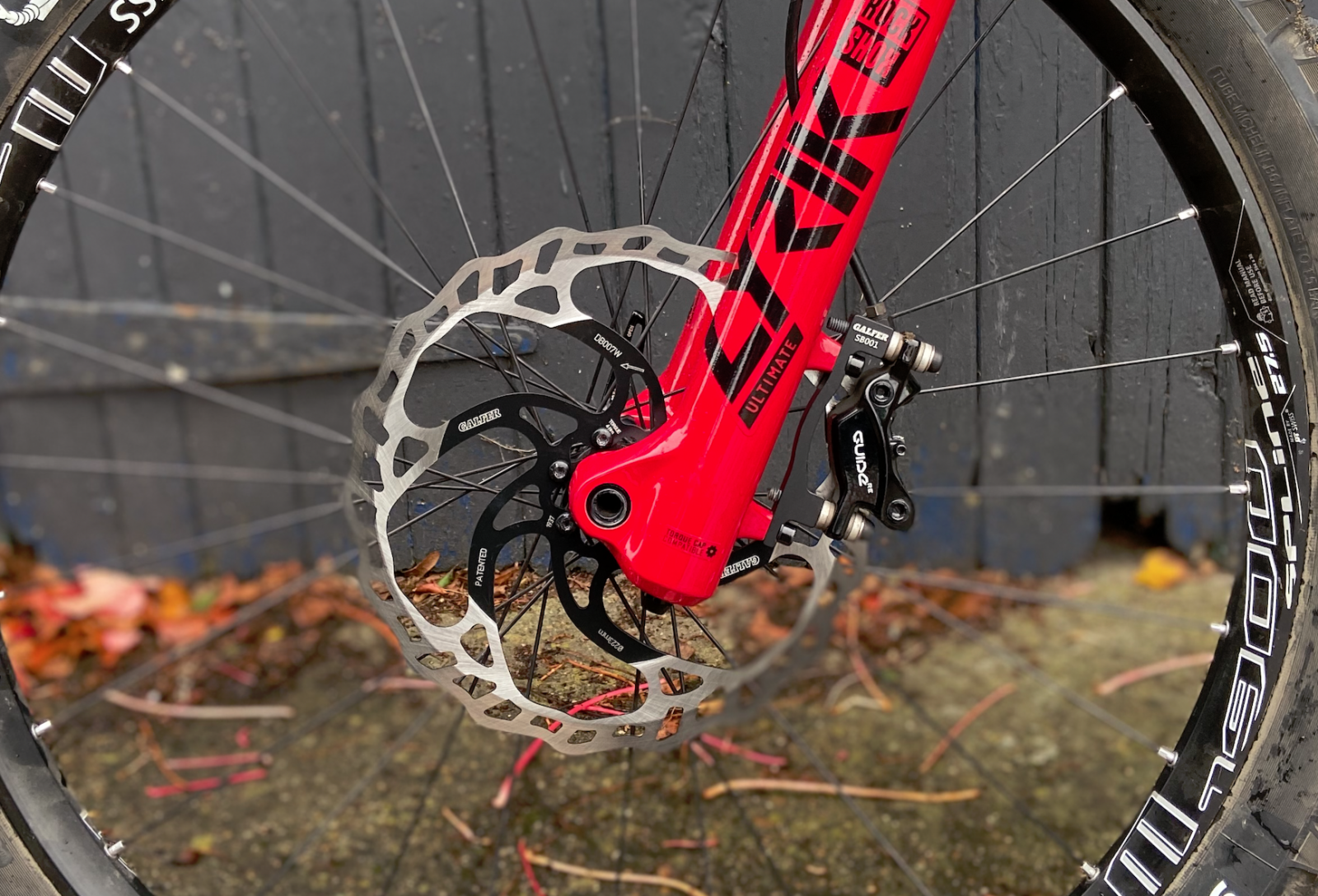

@R120. Where did you buy the Galfers from, and what spacers did you use for the front and rear? Thanks...
I got them from Dirthut on eBay
For the front, includes adapter:
Galfer Disc Brake Rotor & Adaptor 223mm Wave Fits Front Discs 180-223 SB001 8400170076881 | eBay
I didn't put a 1mm washer on like I did on the rear as it clears fine, and has worked well even though the calliper is close to the top of the disc. I reused the stock calliper bolts in the adapter, I should swap them out for shorter ones but haven got round to it.
On the rear I put a 1mm spacer/washer under the OEM calliper mount as the disc is 203mm vs the stock 200mm Sram one.
Looking on his shop now he doesn't appear to have the matching 203mm rear, just the floating version, but worth sending him a message as I remember him being helpful when I was confirming what bits I needed.

Thank you?. I don’t have a problem with rear brake power or fade, did changing the rear make a noticeable difference to power / feel? This being a 2.0mm versus standard 1.8mm rotor, did you have to sand down new pads?
9,190
TBH on the rear (which is 1.8mm) it feels really good, but how much of that is just down to it being a new disc and pads vs being better than the stock SRAM disc I dont know, but I am definitely liking it.
On the front you need to make sure your pistons are pushed right back in, and I also spread the spring/retaining clips quite wide when installing the pads. its a very fine tolerance but once you have bedded in everything its all good, maybe a bit of rub to start. I do find I have to recenter the clipper every so often.
Master Link
Dec 7, 2018
161
63
Isle of Wight
Thanks. ?

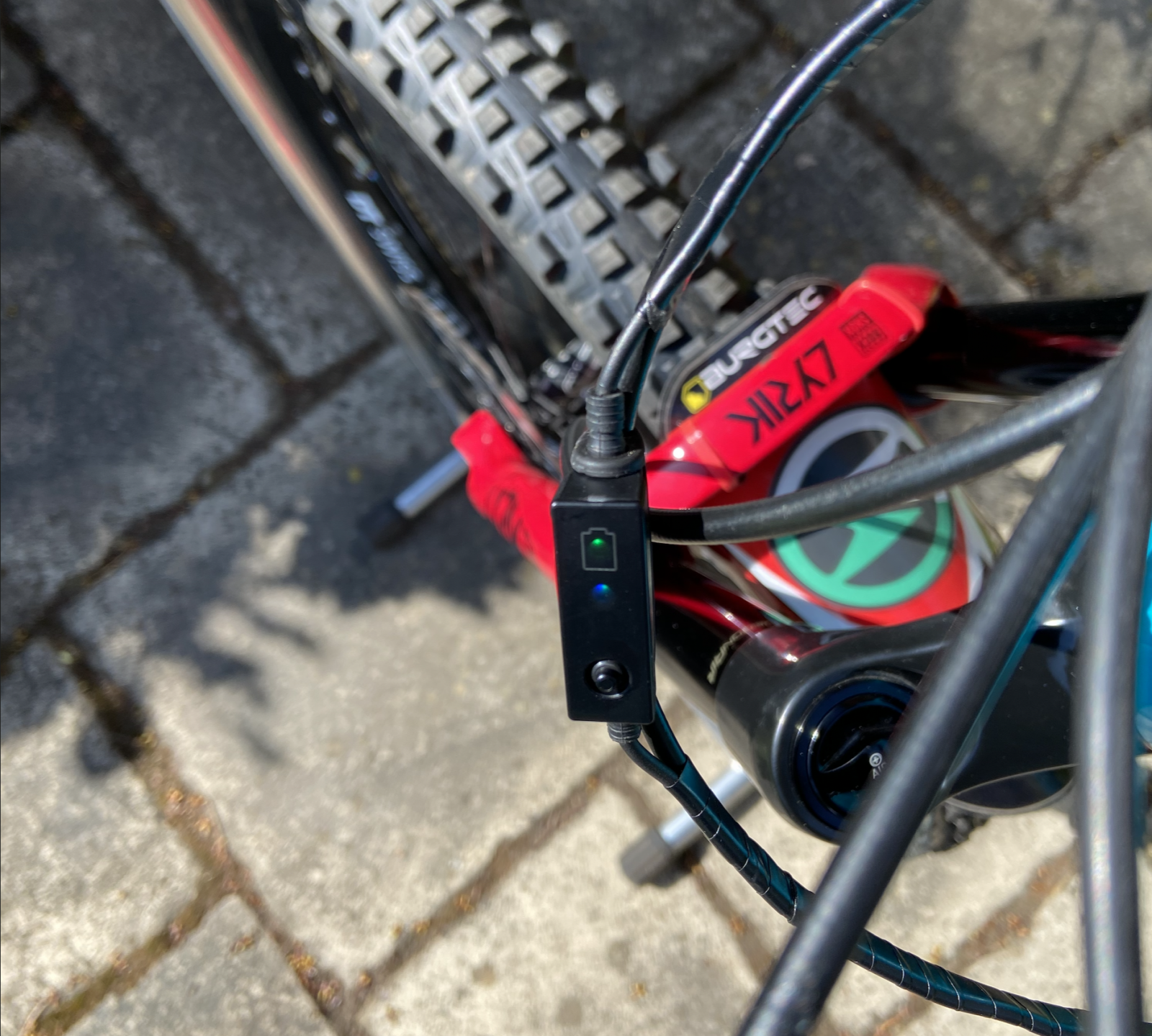

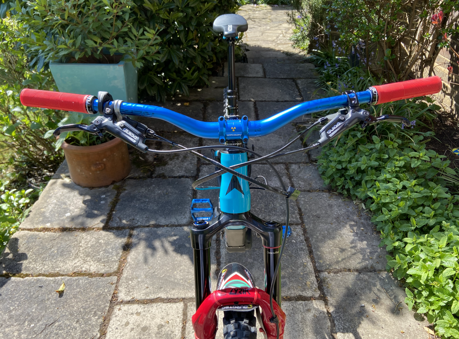

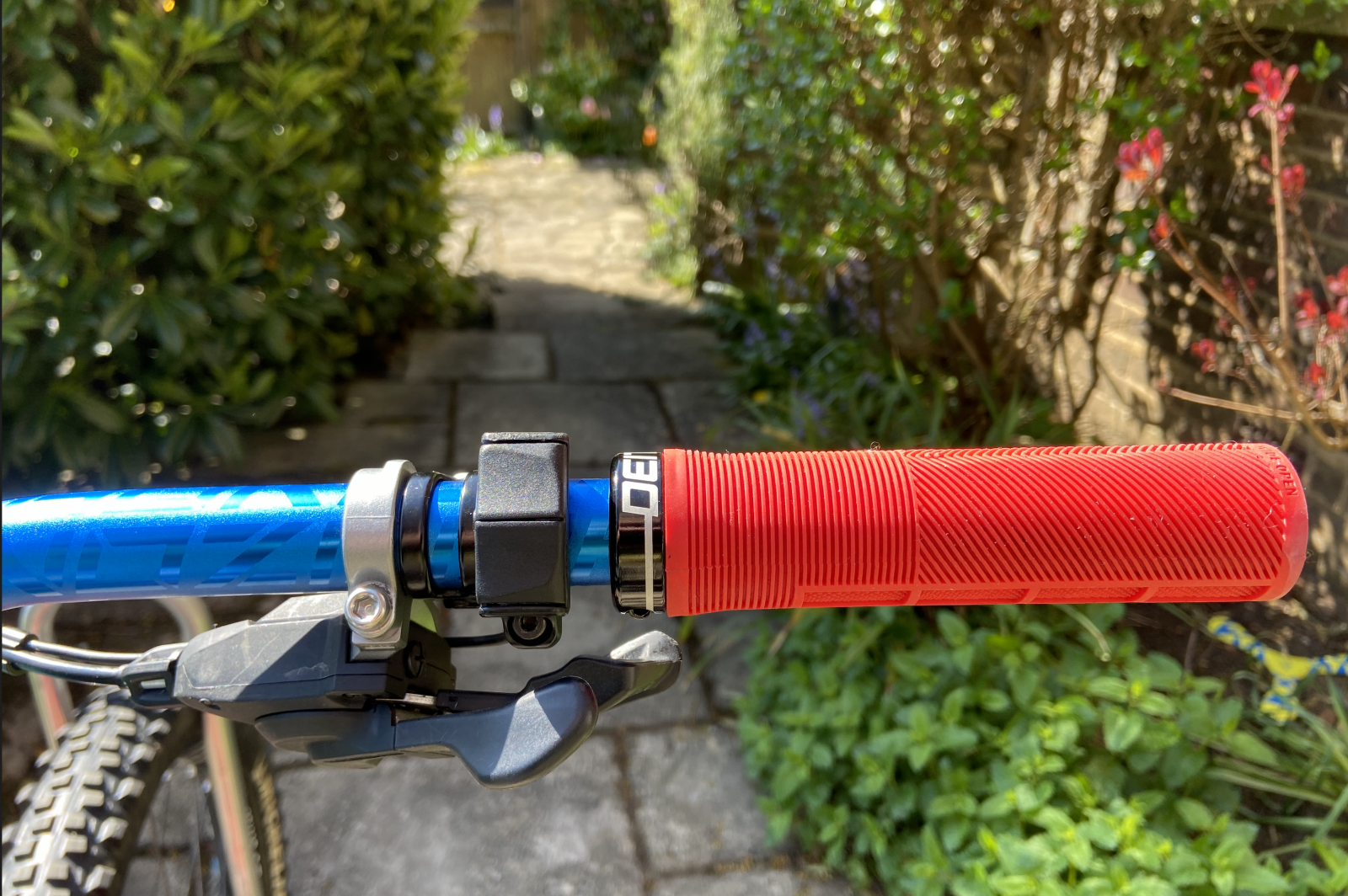

Bored last night so I refitted the EW-EN100 Junction A, and took the time to tidy up the cables.
I have also swapped over the e7000 switch to the right hand side, as this enables much cleaner routing, and after a bit of testing it doesn't get in the way of the shifter paddles either.
Trawled the internet for some deals, and got an XT shifter with a Problem Solver mismatch kit and mmx clamp on the way so I can mount it to the brakes, which will clear up the handlebars further. I rarely use the switch and I think mounting it on the right hand side works pretty well.
That's actually way neater than Di2 bars would have been.
I have mine on the left next to the grip. But I do use it loads, and often in the middle of fast/tech trails so still prefer it on the opposite side from my gear shifters.
What tape did you use, is it self amalgamating or just electrical tape?
Shrink wrap would be awesome but you'd have to seriously care about looks to be bothered disconnecting all your hoses and cables to do it properly.
you could colour co-ordinate tho ;)
https://www.amazon.co.uk/Heat-Shrink-Tubing-Sleeve-Various/dp/B07R57TJMD/ref=sr_1_4?
9,190
I have shrunk wrapped before but its a PITA to do. I just used some electrical tape I had lying around
