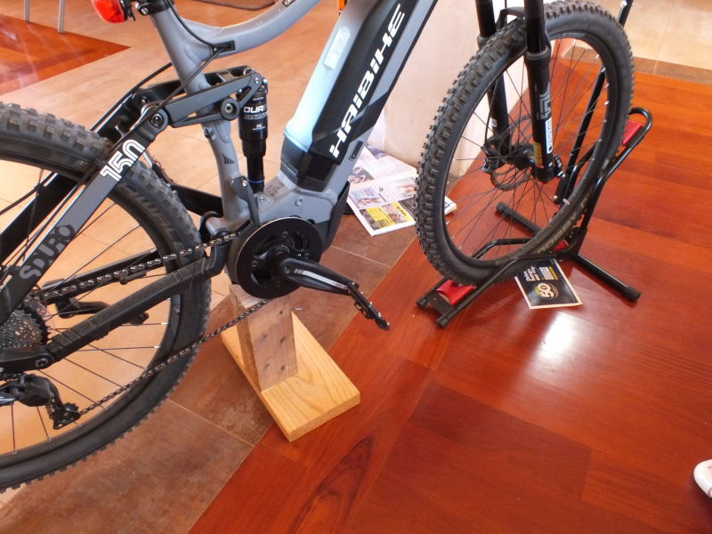

Hi, a newbie here with a recently acquired 2019 Haibike FullSeven LT3.0. I made a simple wood floor stand from scrap wood so that I can service the chain/drivetrain. Not a complete solution since I discovered that the Yamaha mid-drive motor cover does not sit stable enough. I have to use a wheel stand to keep the bike upright. The wheelstand came with the bike, so it's free so far.
