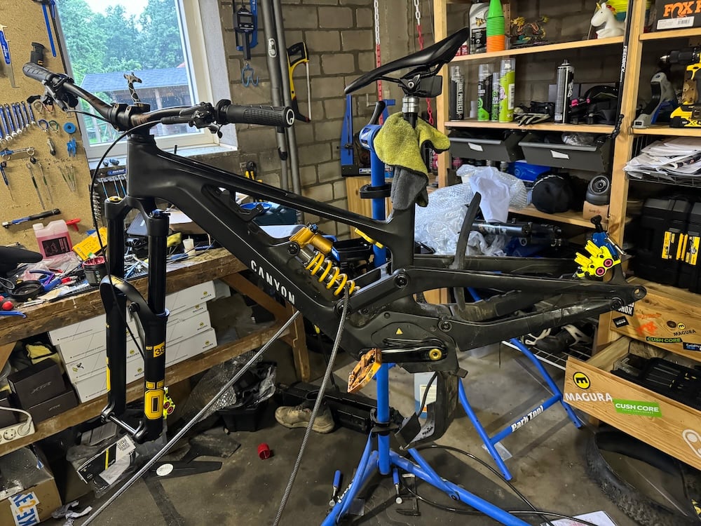

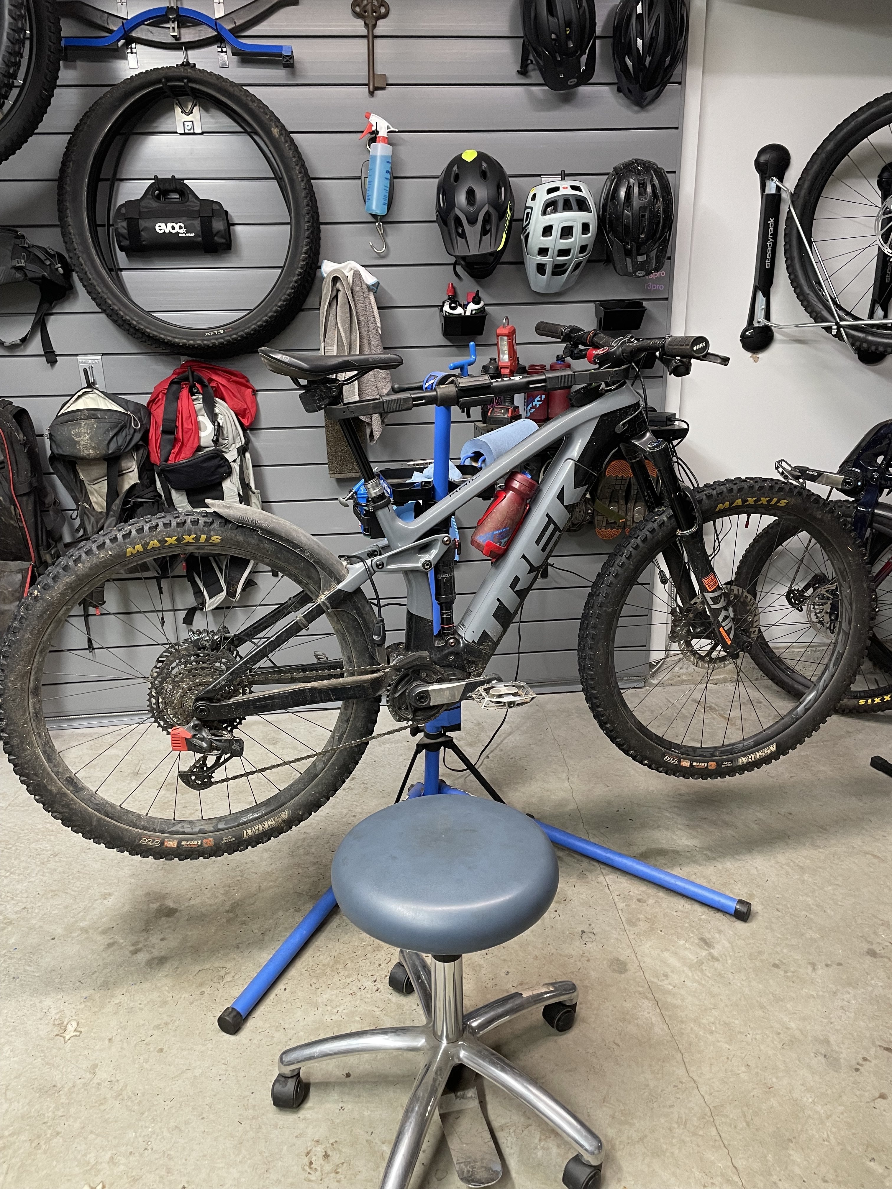

I’ve been using the Park Tool 9.2 stand for several years now …but not without a fake cross bar for the carbon Rail 9.7.
I attach the fake bar under the stem and an extended Reverb dropper. (That’s important imo).As you can see in the photo, both wheels are suspended. The bar is easily positioned so the weight of the bike is not placed on the Reverb battery. This is reasonably stable and allows for regular maintenance. My bike lives here while the other bikes wait their turn in the Steady Rack “Spa”.
However, one morning when I entered the bike cave, I found my bike and the stand laying on the floor. The clamp on the Park Tool stand had slid and caused my precious bike to crash to the floor. (Nothing or no one was hurt, just my feelings for a few moments 😉). I tightened the clamp a bit more.
I added the small tool tray that attaches to the post later. I can hang the fake bar on it and place some tools and parts in it. I also charge the battery in this position.
The fake bar I use is a Saris. These bikes can be heavy and the fake bar helps distribute the weight between the stem and dropper. Takes about 7 seconds to mount my bike in this position. 🤷‍♂️

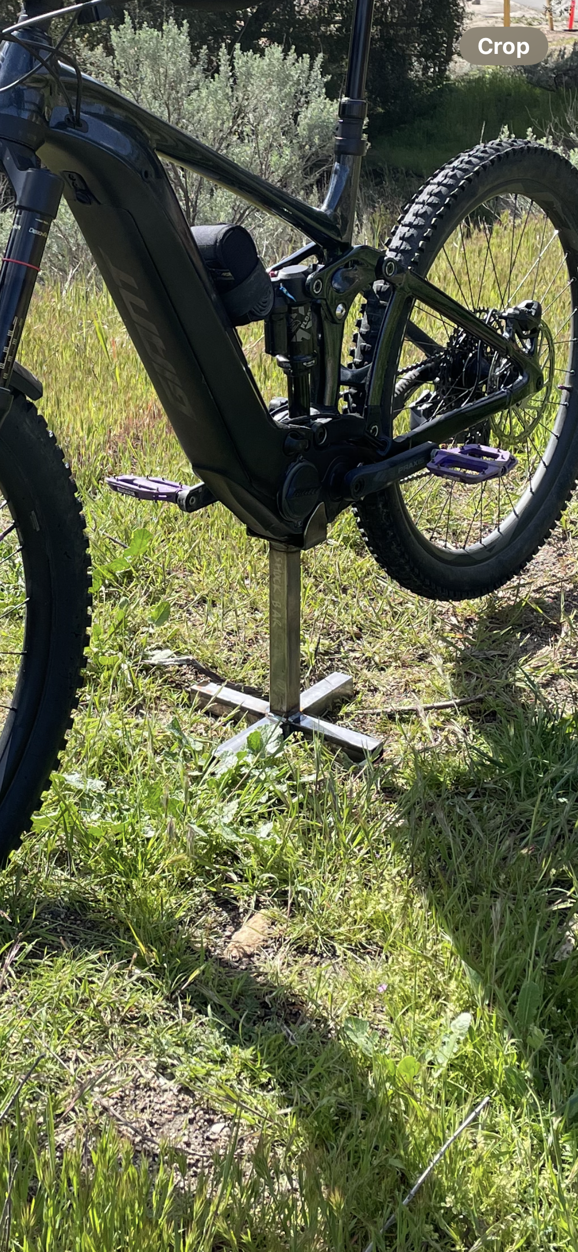

I use this one. Light Aluminum chassis. Sturdy enough. Easy to fold up and lean in a corner when not in use.

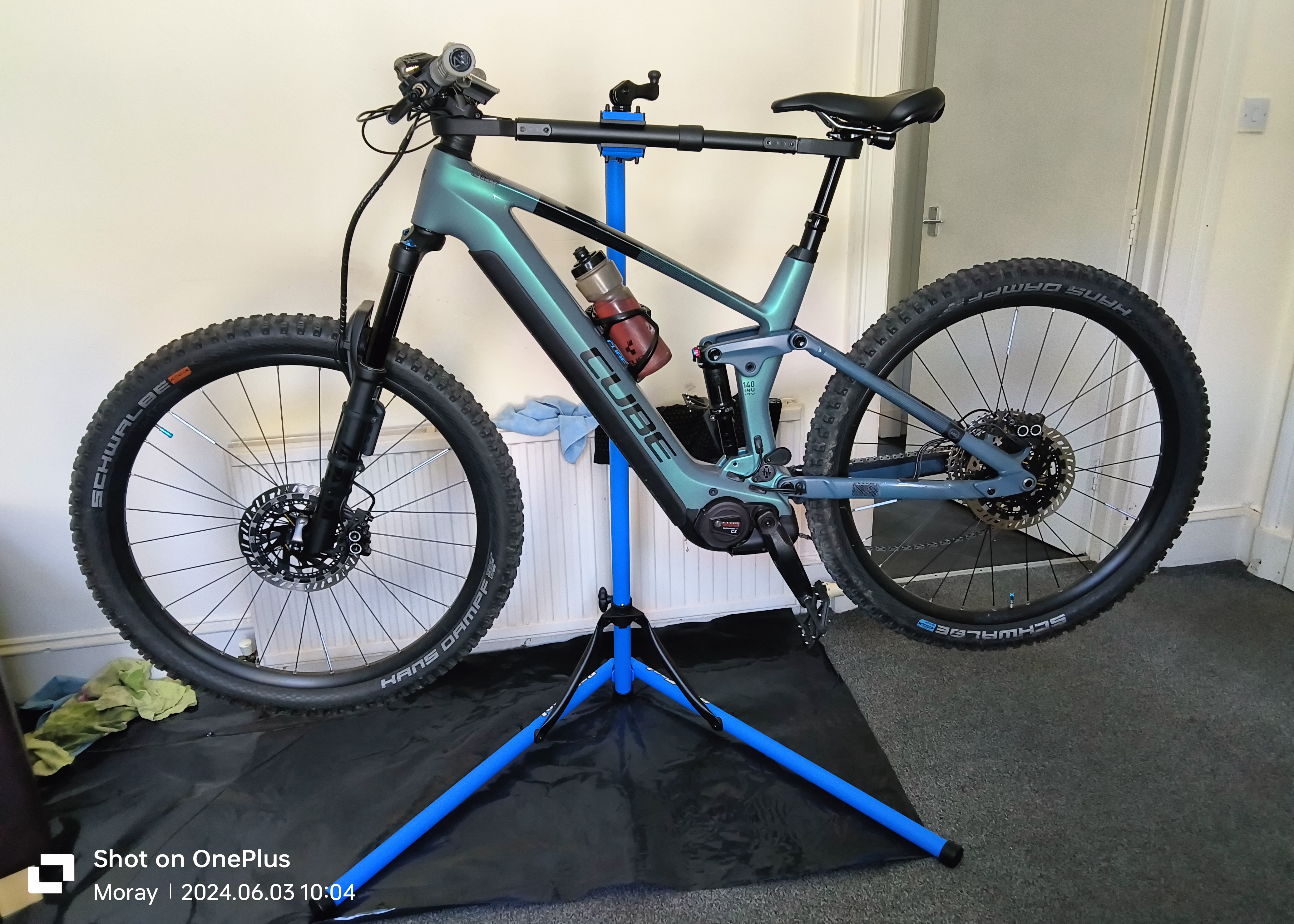

Thanks for all the advice , went with the park 10.3 and the Halfords fake crossbar. My Concerns about the cross only being rated at 15 kgs ( when my cube is 24 ) were unfounded. The bar is beefy and takes the weight of the bike easily. Thanks again all , I can now maintain my bike properly View attachment 141536
I think that weight limit is mainly for when the bar is used for transport on certain types of vehicle carriers that utilize the bike's top tube...or in this case, the fake top tube bar. Used in a static bike stand, I don't think that limit is a concern.

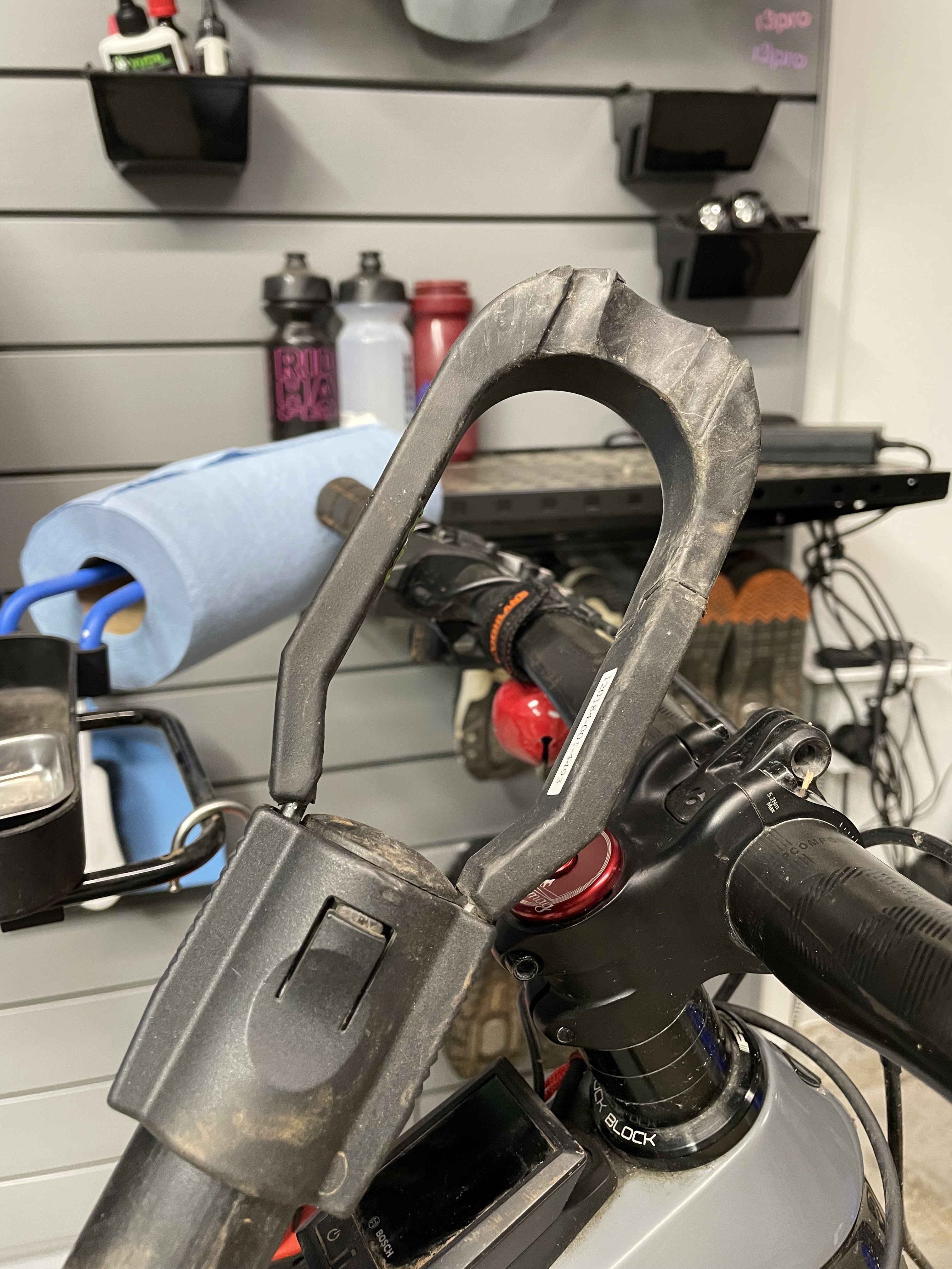

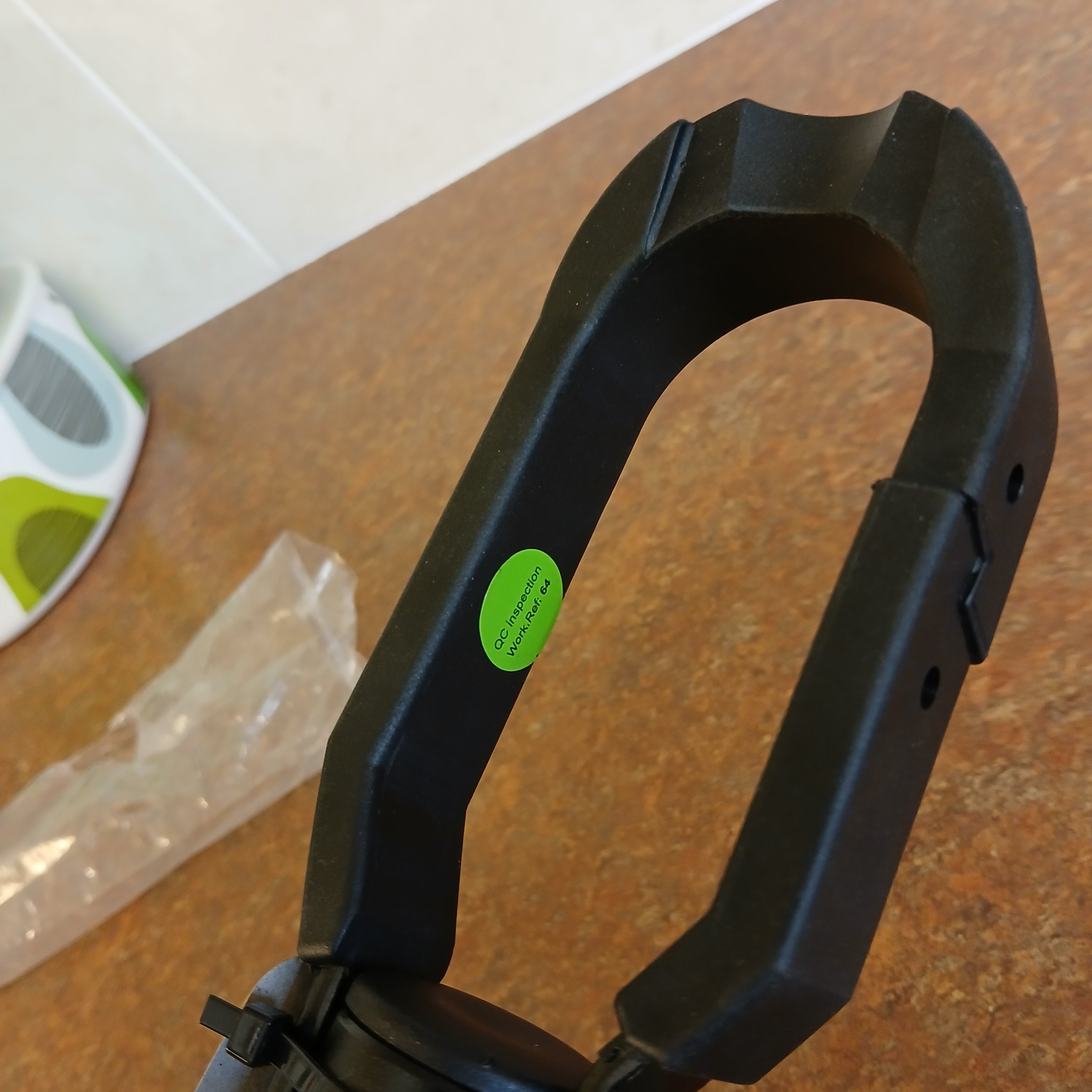

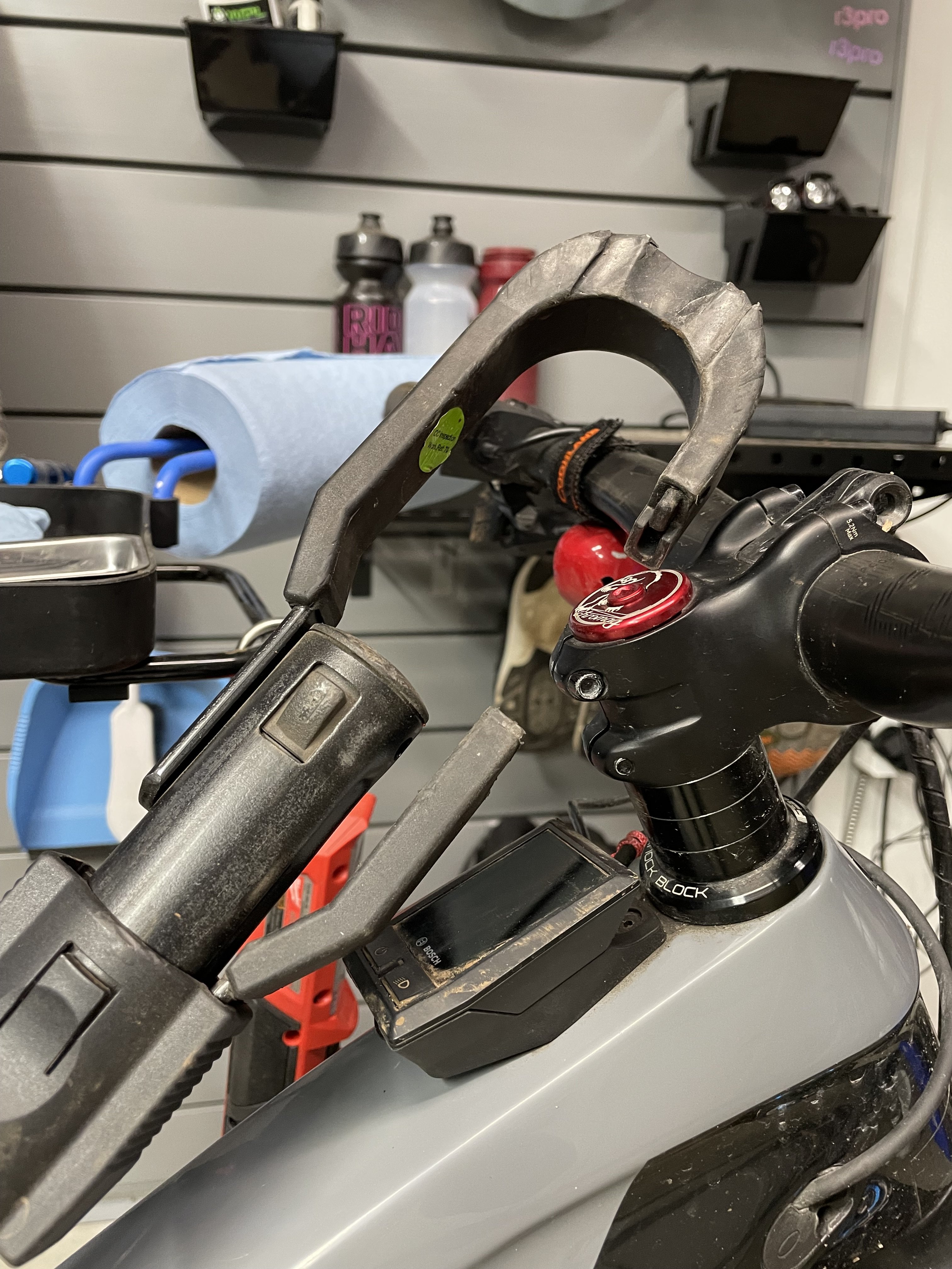

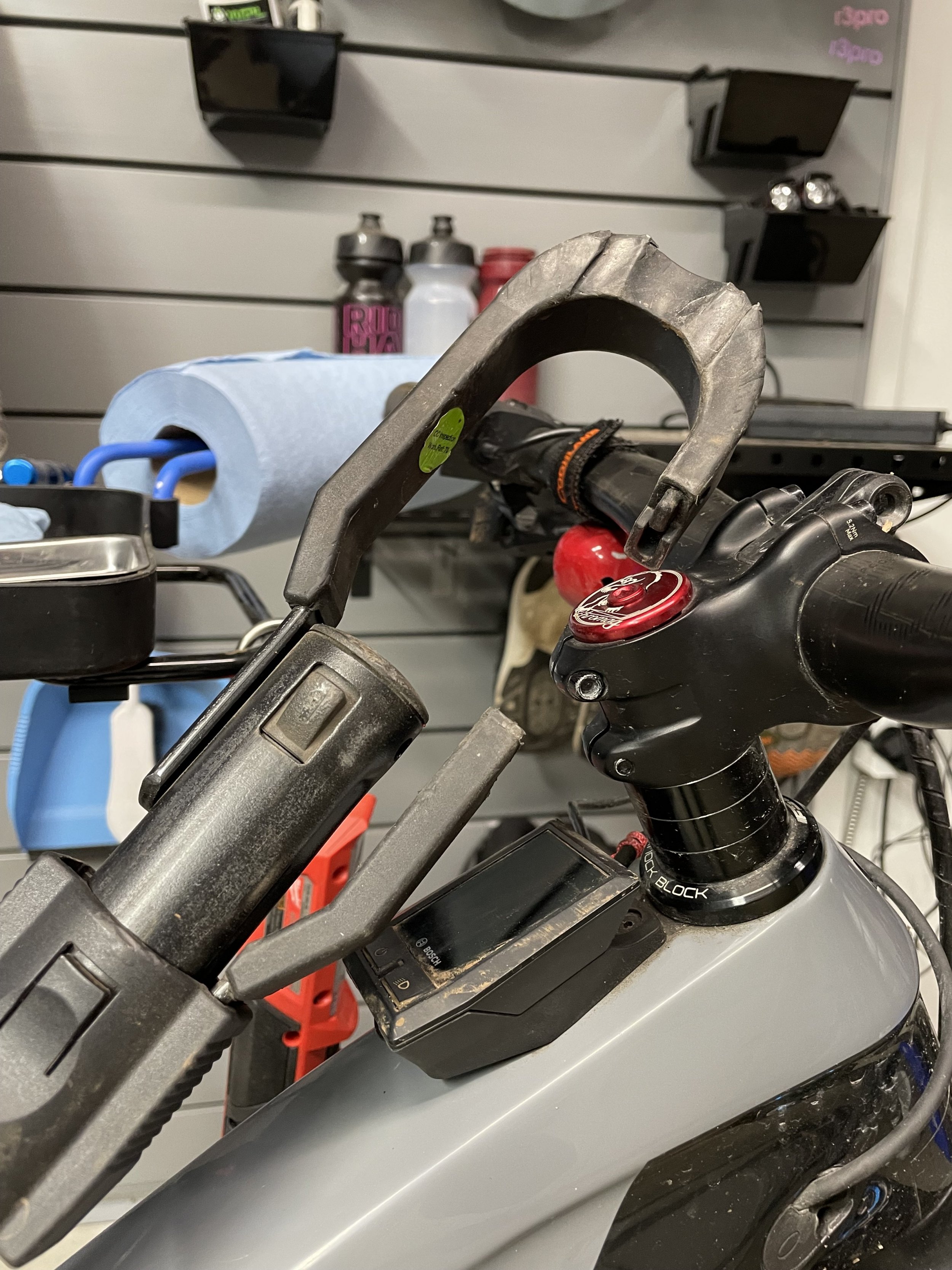

I collected the Halfords False Crossbar today and it looks and feels like a solid and well-made piece of kit. :love:
The trouble is that it doesn't fit my bike!
There is plenty of length adjustment, easy to do. The hooked ends are wide enough. It is obvious which end goes around the seat post and which the other end. The flip open side bits that allow you to hook over the tubes are solid and well-made as well. It's all looking good! :)
The end that goes around the stem is too thick to fit in the space under the bars and above the top of the head tube. I tried looking at it all sorts of ways, but there was no way I could make it fit without using a hacksaw.
So I'll be dropping back into Halfords tomorrow to get my money back. It's a good job I opened the packaging very carefully! :)
My wife is going to have to think of something else for Father's Day!

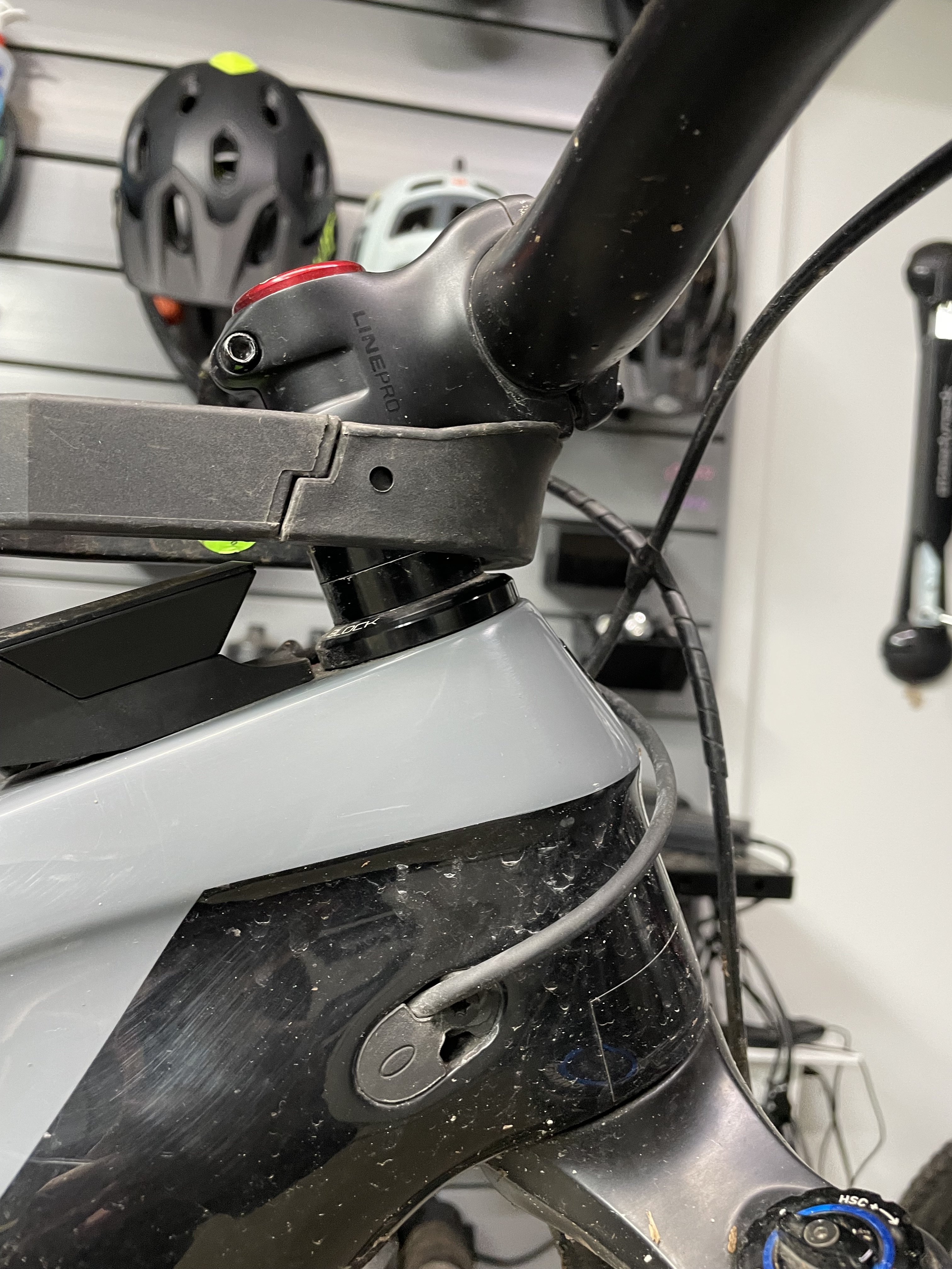

The trouble is that it doesn't fit my bike.
Not sure how many stem spacers you need for clearance or maybe the fake bar shape is wrong.
I use the Saris fake bar …maybe it’s slightly different?
You can see the number of stem spacers I have …and it just barely fits.
Stihldog
Handheld Power Tool
Jun 10, 2020
3,540
4,964
Coquitlam, BC

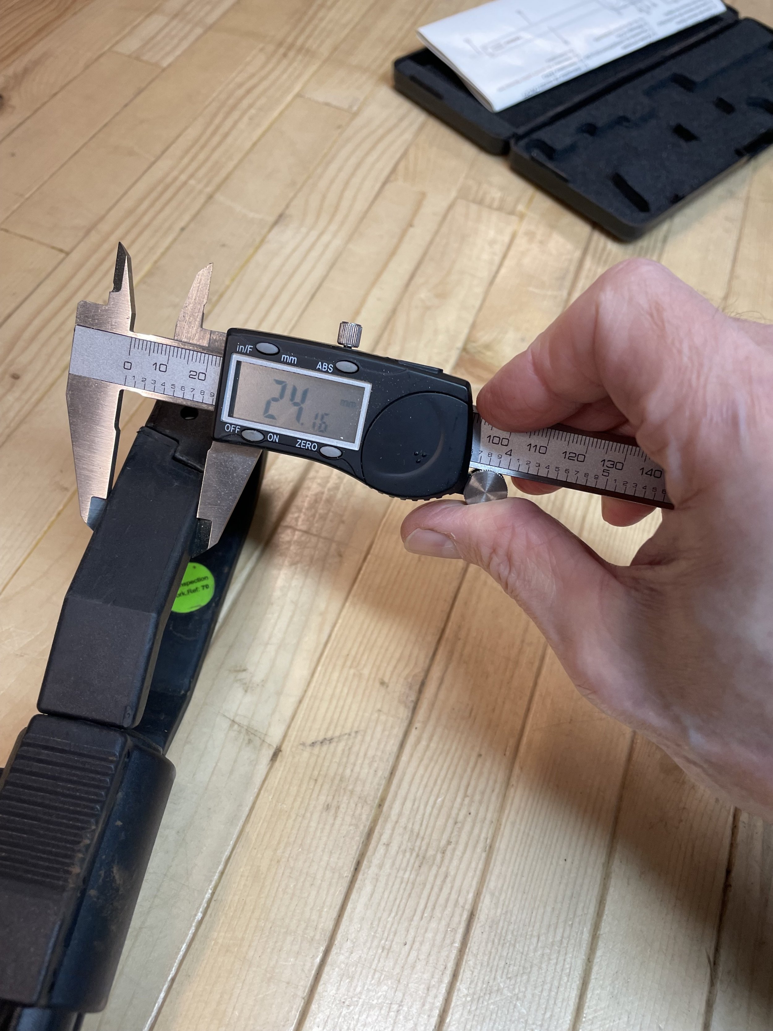

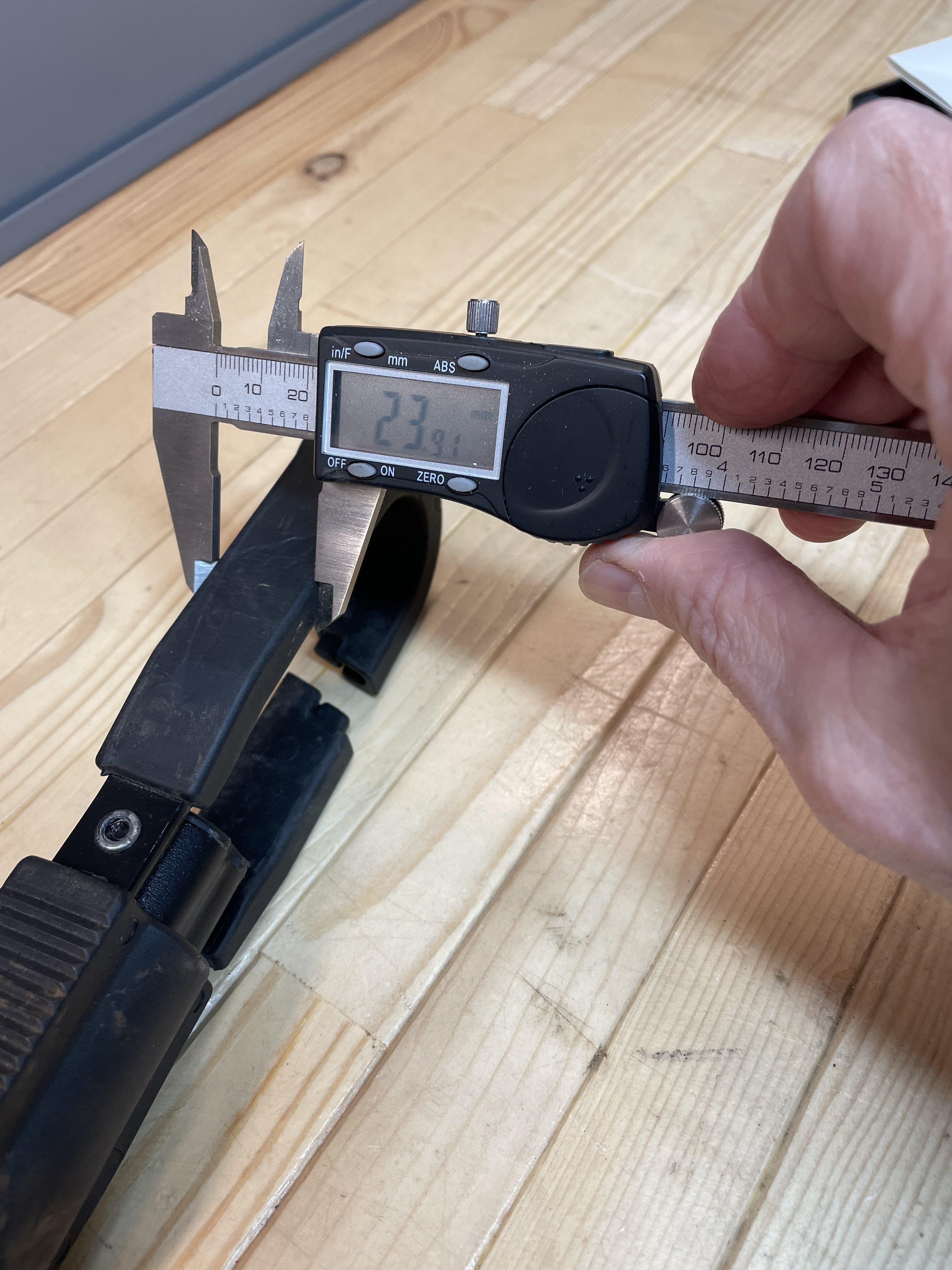

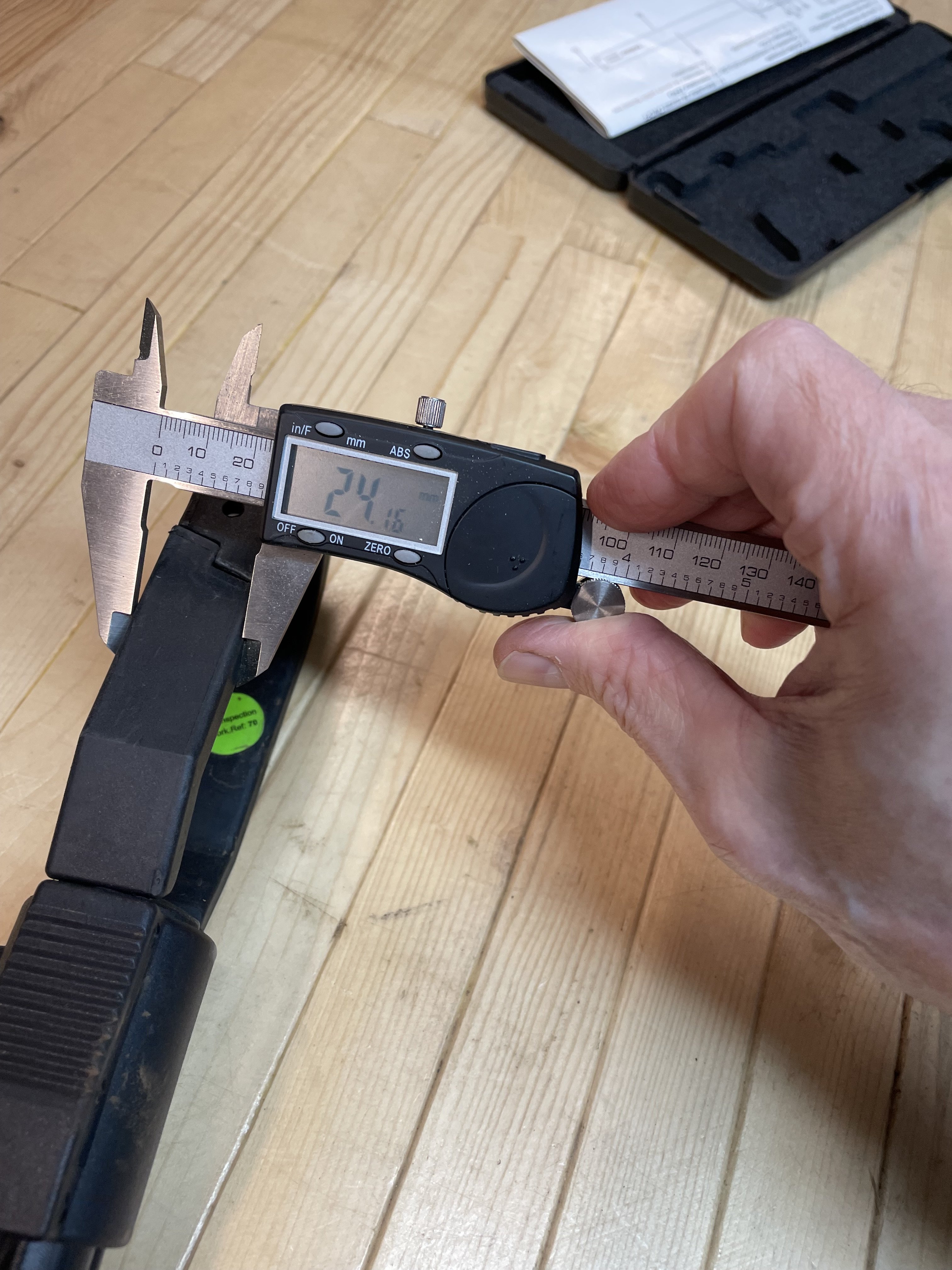

The Halfords one looks virtually identical to your Saris.
But I don't have three spacers under my stem. The end of the Falsie is mostly 23mm thick, but it increases to 30mm at the end.
The spacing between the top of the Knock-Block washer and the under side of the stem is 31mm.
They basically look the same.
Stem end.
Dropper end.
