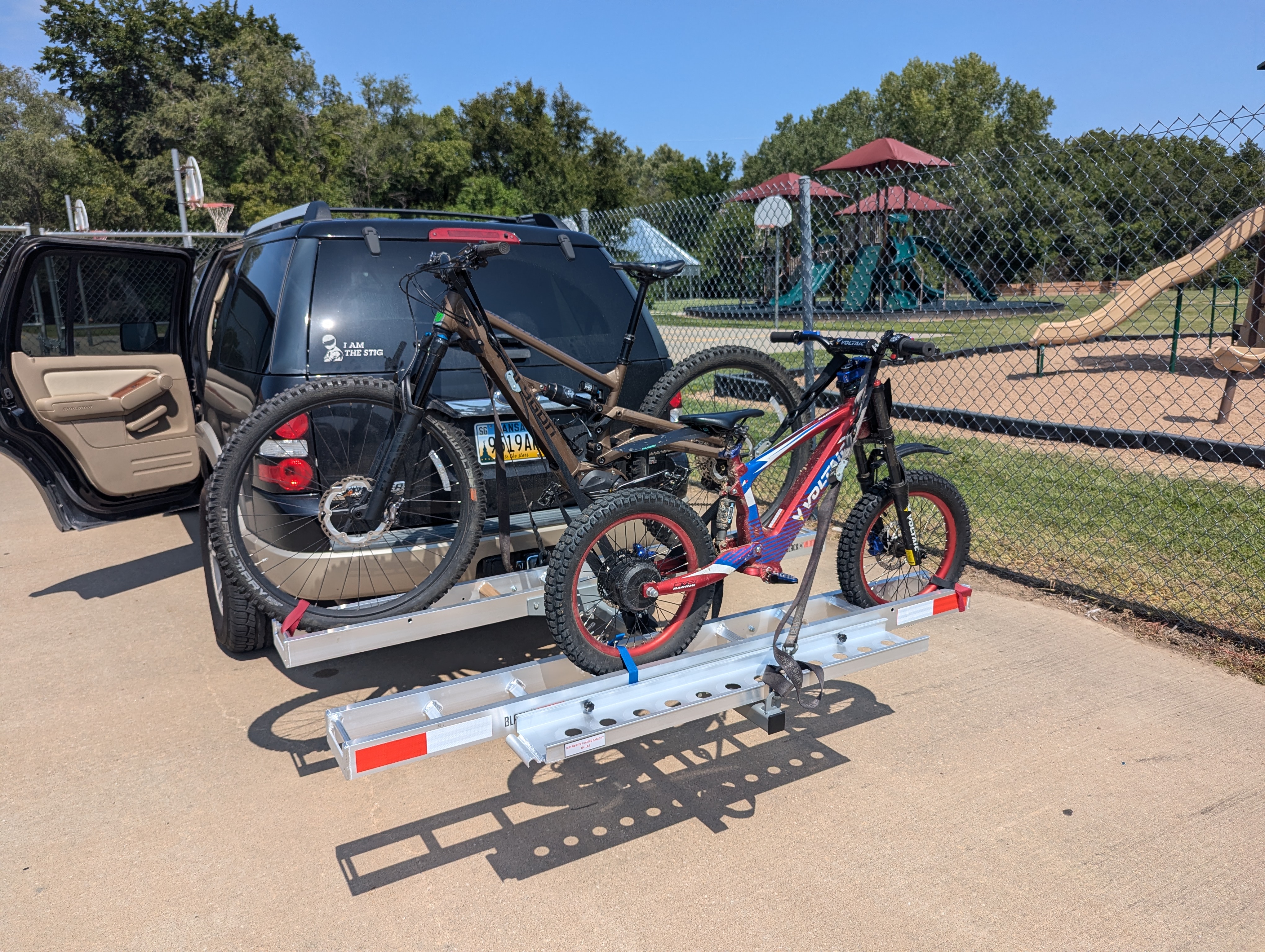

Late response, but if anyone is just needing a 2 bike rack, you may look for a double motorcycle carrier. They're considerably cheaper than a bike specific rack and have loads of room. Drawbacks are, it's huge, no folding option, and since it's rated for 600lbs it's pretty heavy. But in Kansas we have room to spare, so no issues with the size here.
