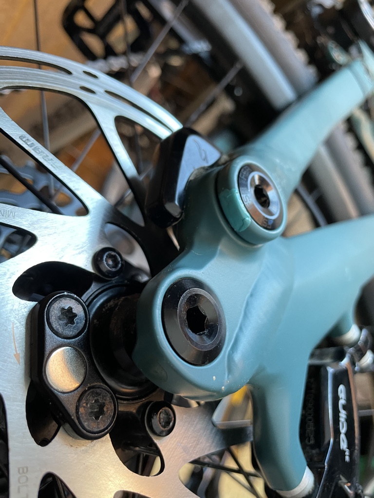

It's far from a perfect match - but considerably closer than raw aluminium. :)
and for less than £7 delivered it will do until I find something closer.

Thanks. That is just about the same spot where I have scrapes!

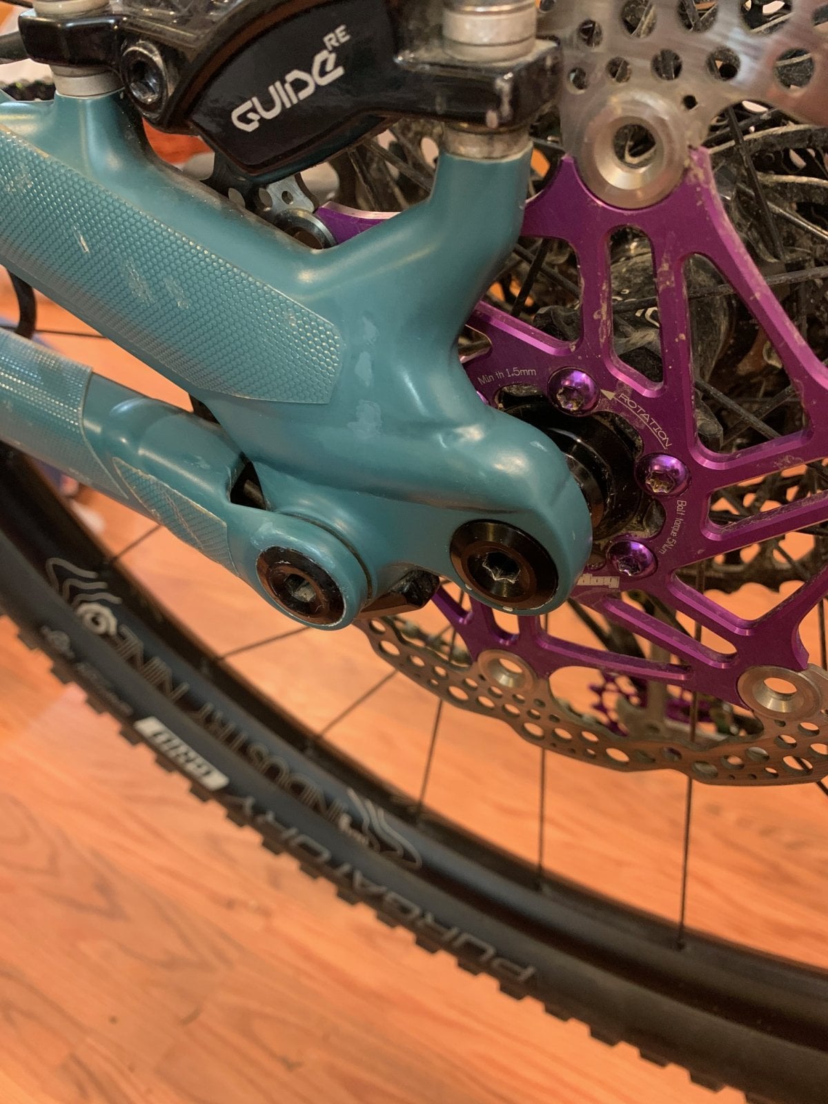

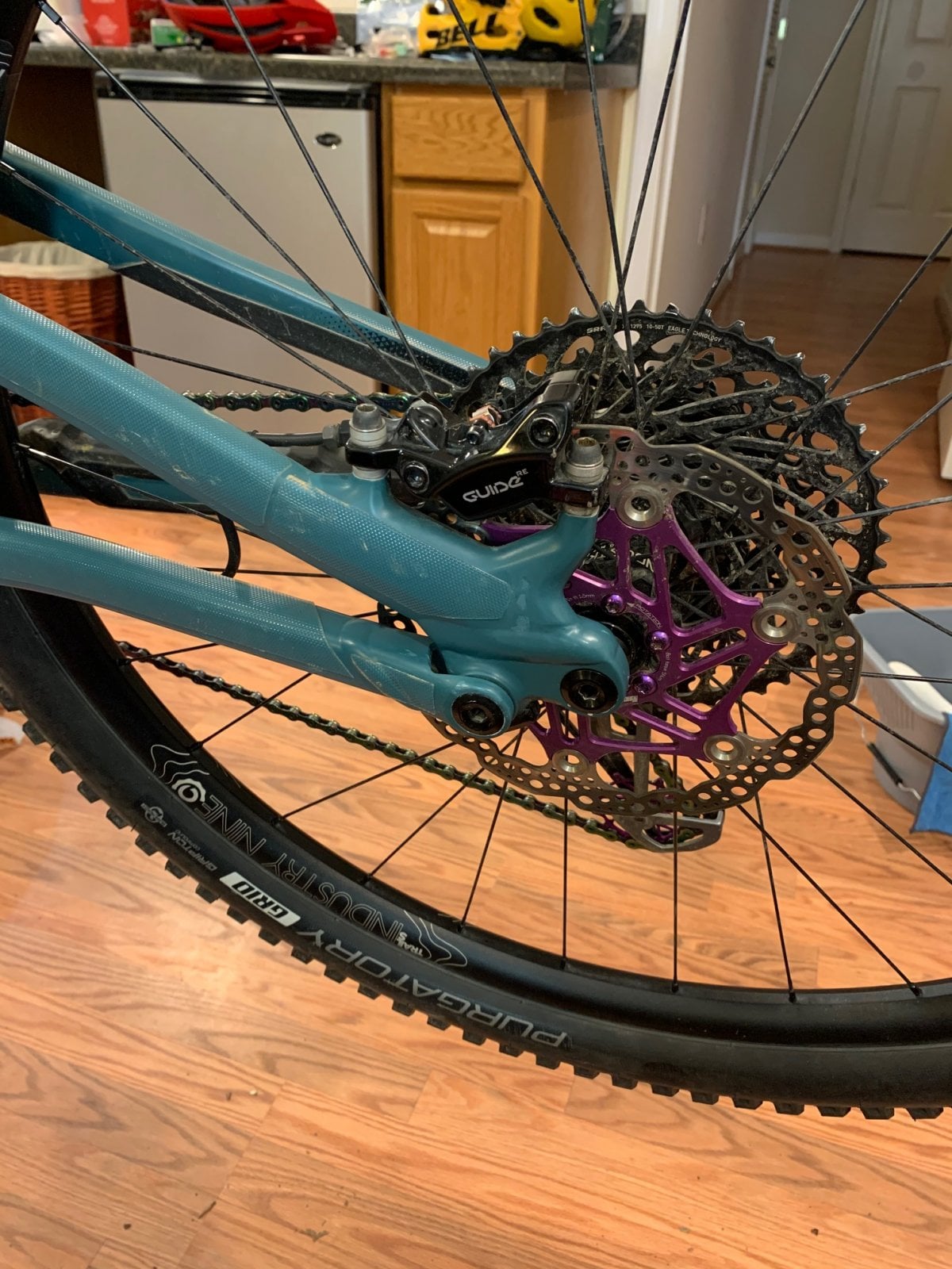

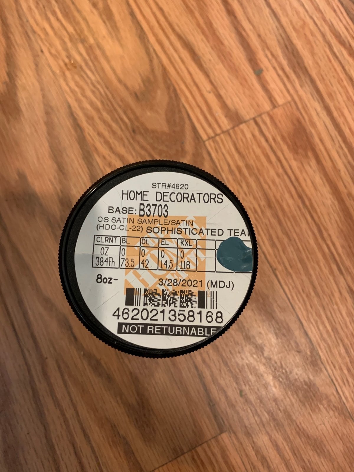

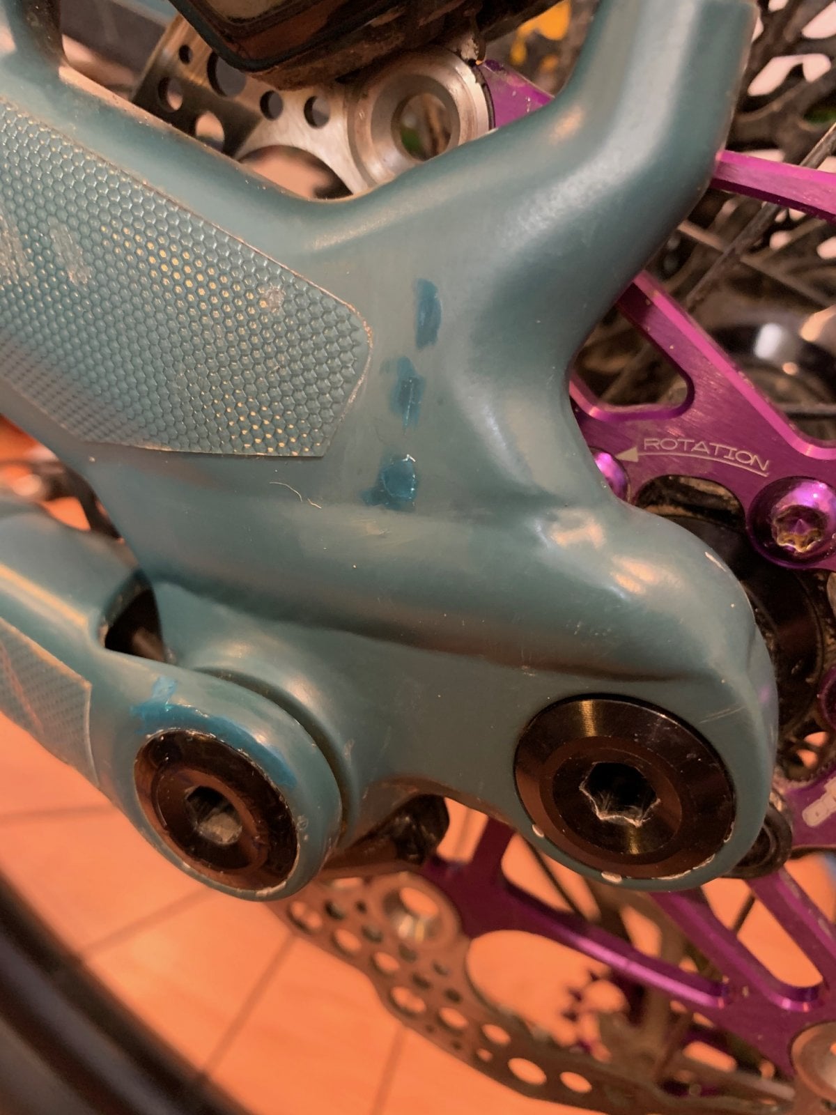

I got some Behr satin paint from Home Depot. It is Sophisticated Teal. Photo of the can lid below. There were three chips in the paint on the seat stay and the paint had been scraped off around the bearing mount on the chain stay. I first dug out the old fingernail polish I had used, which was too blue. Then I sanded with 800 grit sandpaper to knock down the rough edges. I painted with a fine tipped brush, waited 2 hours, and wet sanded with 1000 and then 1500 grit paper. Finally I buffed it using 3M automotive scratch remover, which leaves a finish similar to the original paint. You can see the results below. Not perfect, but better. The paint is just a bit too light.

Thanks. Anyone know where we can buy using this code? I’m not knowledgeable at all when it comes to paint. I’m in the UK if that helps…?
