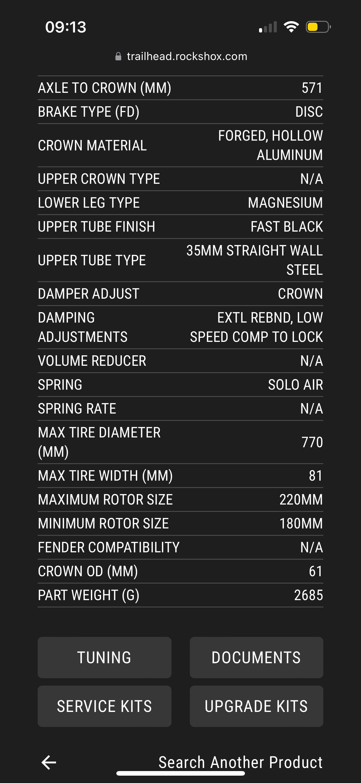

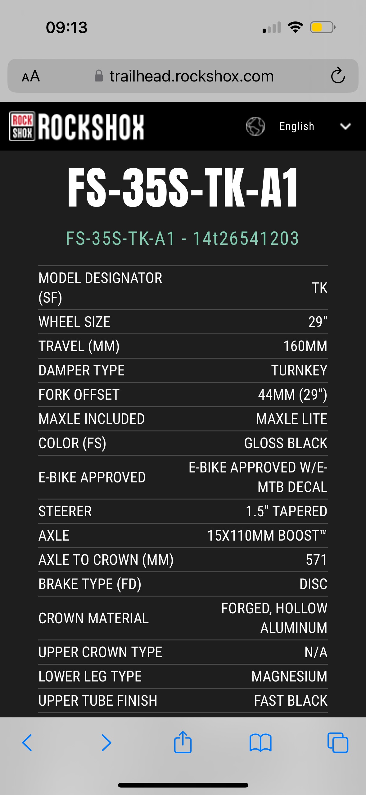

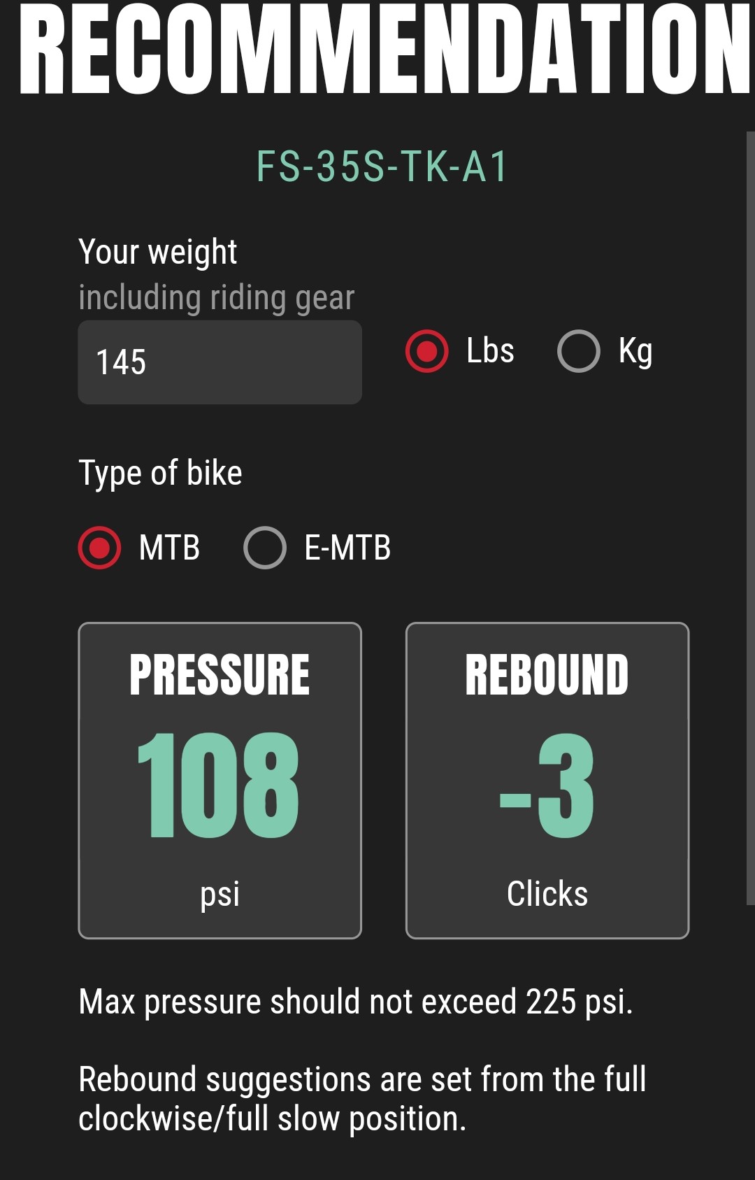

No tokens. I ran my fork serial number through the Rockshox website. This is what I have:
This is what Trailhead recommends for you (don't use EMTB pressure, it's generally far too high). In any case, you now know what you're doing setting sag, so if you do decide to buy a new fork you know how to do basic set up - none of this messing around is wasted, we've all been through it!
Rebound at 3 clicks is a starting point.

ok I will try 30/30 today. At 108psi there was barely any sag. I had to drop to 65psi to get 30%. Another question, fork says 160mm travel, but when I lift the bike and extend the fork the measurement is 150mm from top of lower leg to spot to top of upper. Should I be calculating 30% of 160 or 150?
