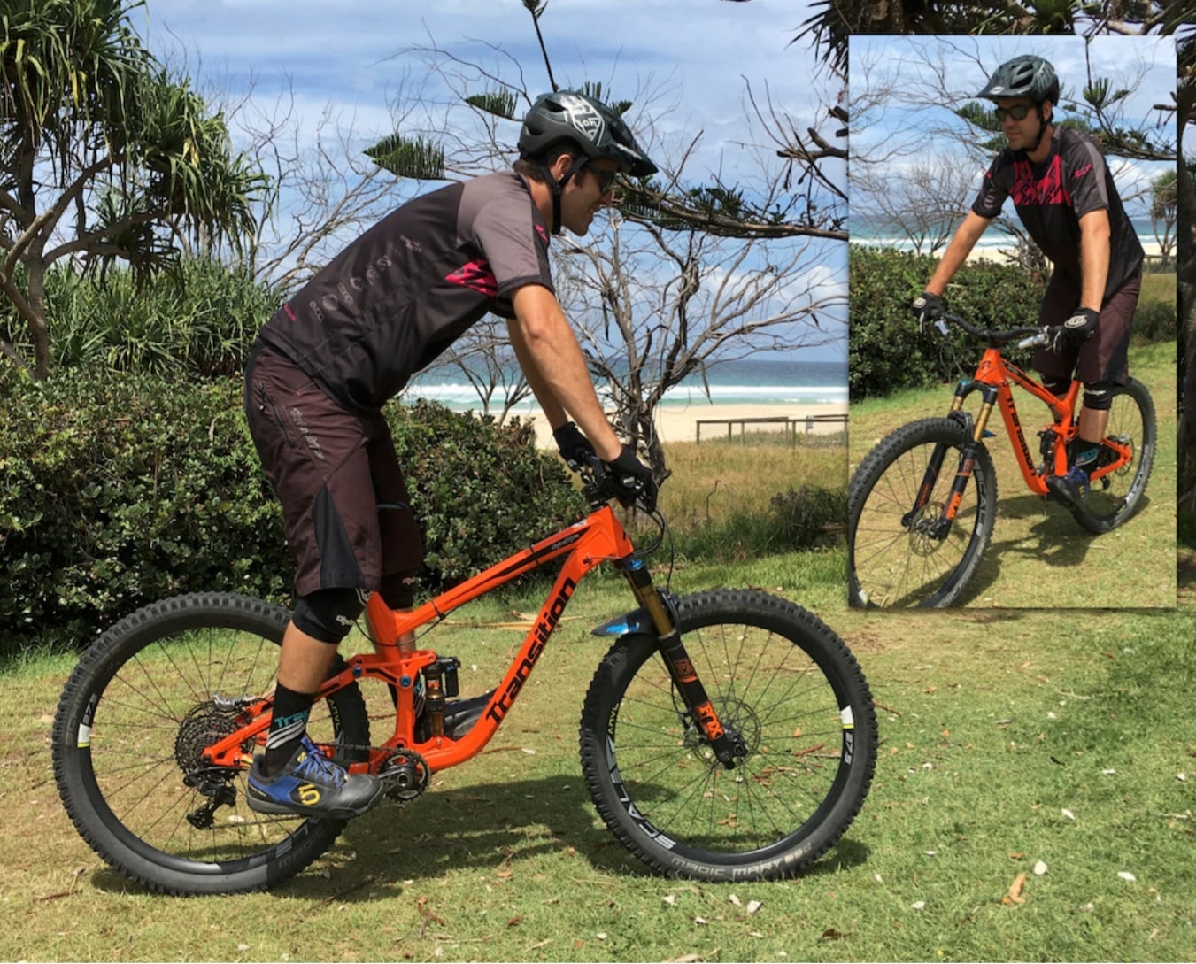

I just sat on my bike and checked fork sag.. it only dropped 10mm with the recommended psi! This must be the culprit! Shock spot on at 30%
Are you setting sag while seated? If so, that's contributing to your issue.
You need to be an attack position when checking sag.

Yep. My attack position varies wildly. Probably not a good thing. I usually get a good initial sag on the shock in the basement. My bars are higher than my seat, so that has an effect as well, for me. Then I just make adjustments to optimize my "Brownian motion" (random, mostly unpredictable motion of a particle) on the trail.
Because attack position is standing on the pedals with hands on the bars seat height has no influence on attack position.
Correct. Seated position is not consequential for setting fork sag in the attack position. However, since you are connected at the feet and at the hands, if the bars are 3" higher, it has an effect since your hands, shoulders, chest and upper body are now canted up by that amount and it will move your CG aft and up, taking weight off of the fork and affecting sag.
