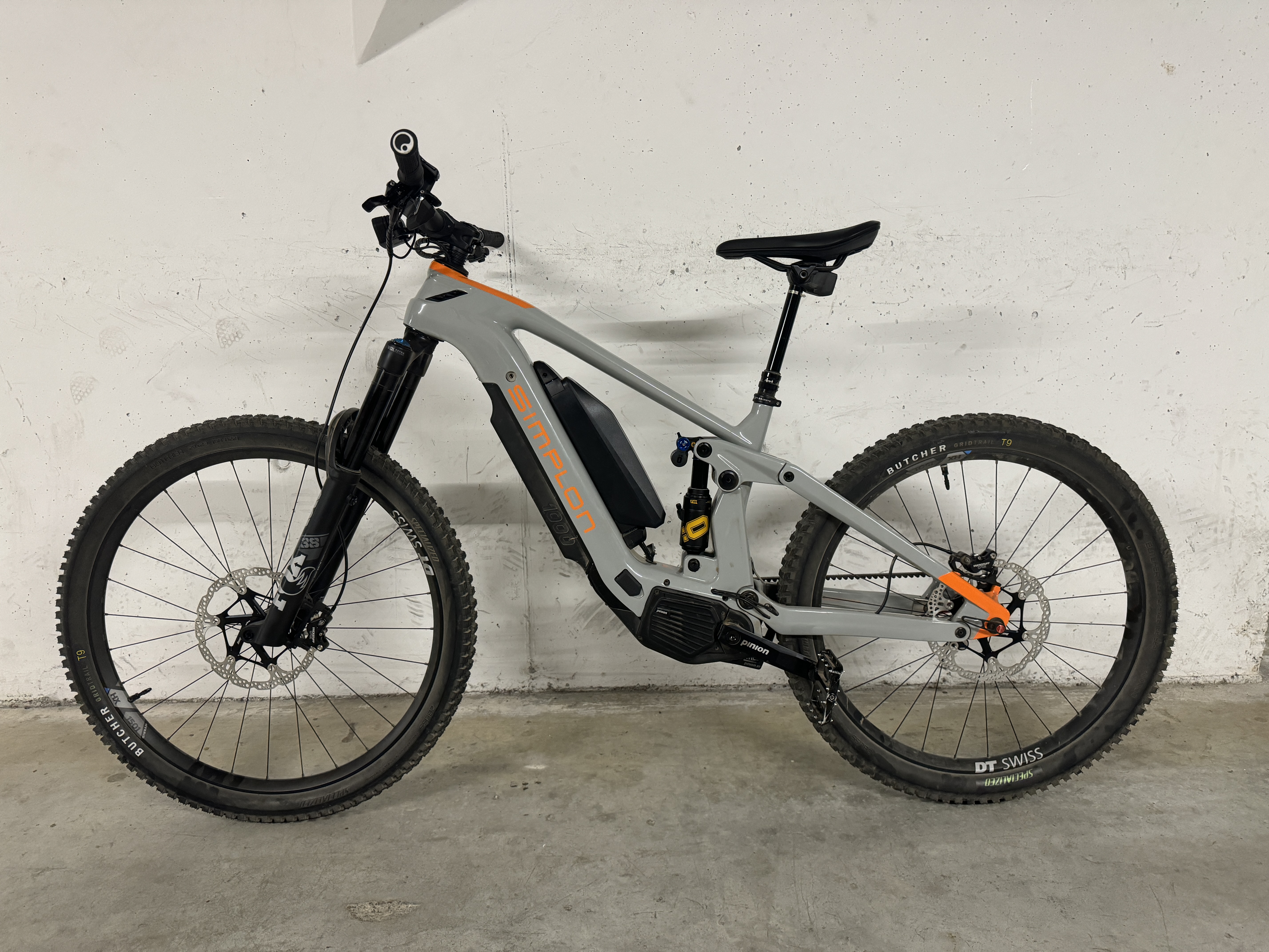

FWIW......I love the idea of an MGU but a 25+kg bike is NO from me as we have too many gates to climb over/through where I live and ride.
My commuter EBike is a belt drive with internal hub. The near zero maintenance is awesome. I'm at 9000km on the same belt, and I have never serviced the transmission. Nothing. Just changed tyres and pads.
And being able to change any amount of gears instantly, even when the bike is stationary, just makes life so easy in traffic, and stopping at traffic lights.
I'd never buy a derailleur again in a road bike.
But on trails and travelling to remote locations. The simplicity, ease of finding parts, and weight reduction of a chain, derailleur and cassette, just works.

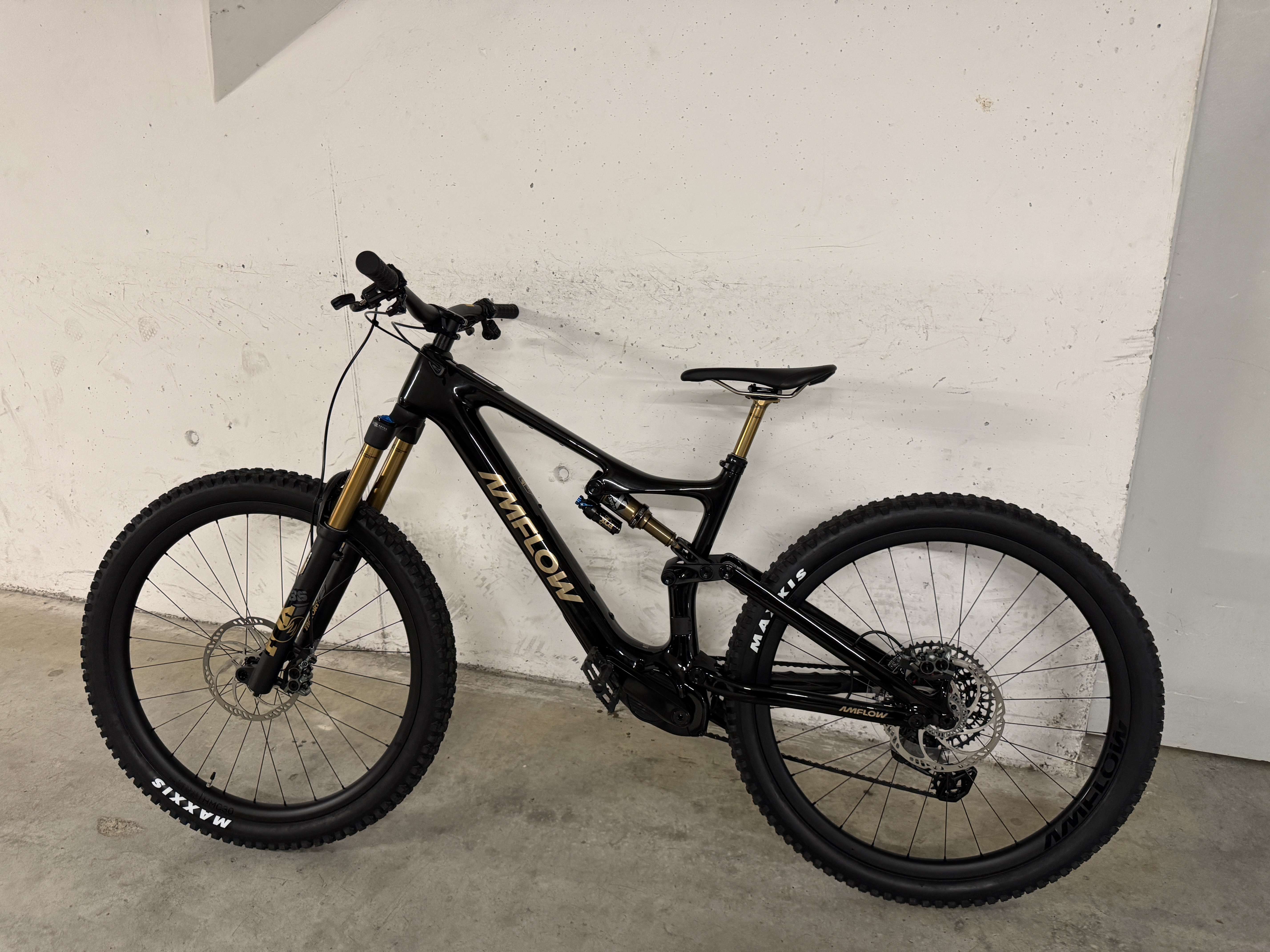

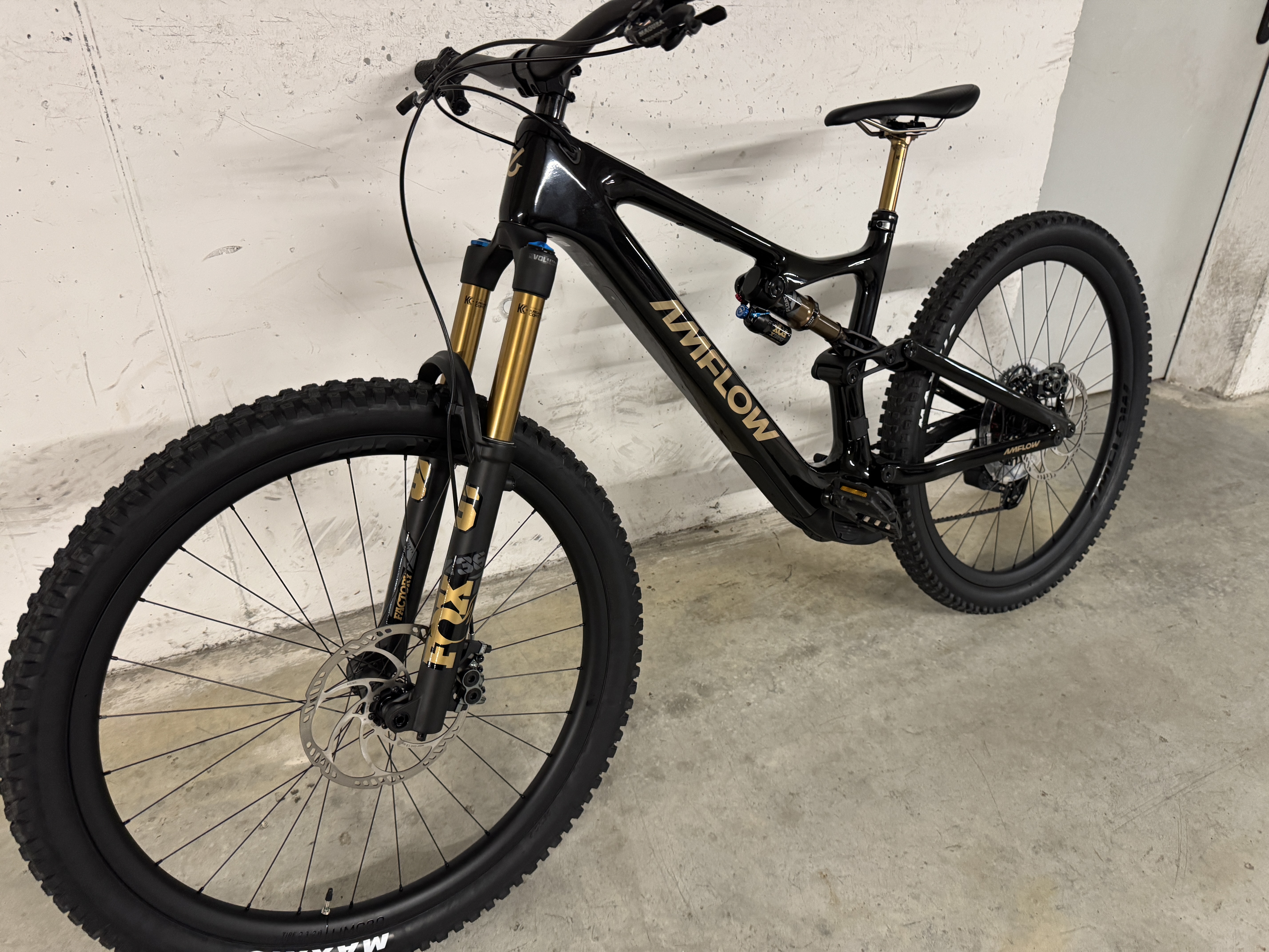

So looking at the Fox Transfer spec total insertion length is 288mm which is longer than the max of 270mm stated in the Amflow manual. Presuming the frame is a size L.
Out of curiosity can you measure BB centre to top of seat tube?
Exactly 450 mm like in the Specs..
Yes, it is an L..
Perfect for me

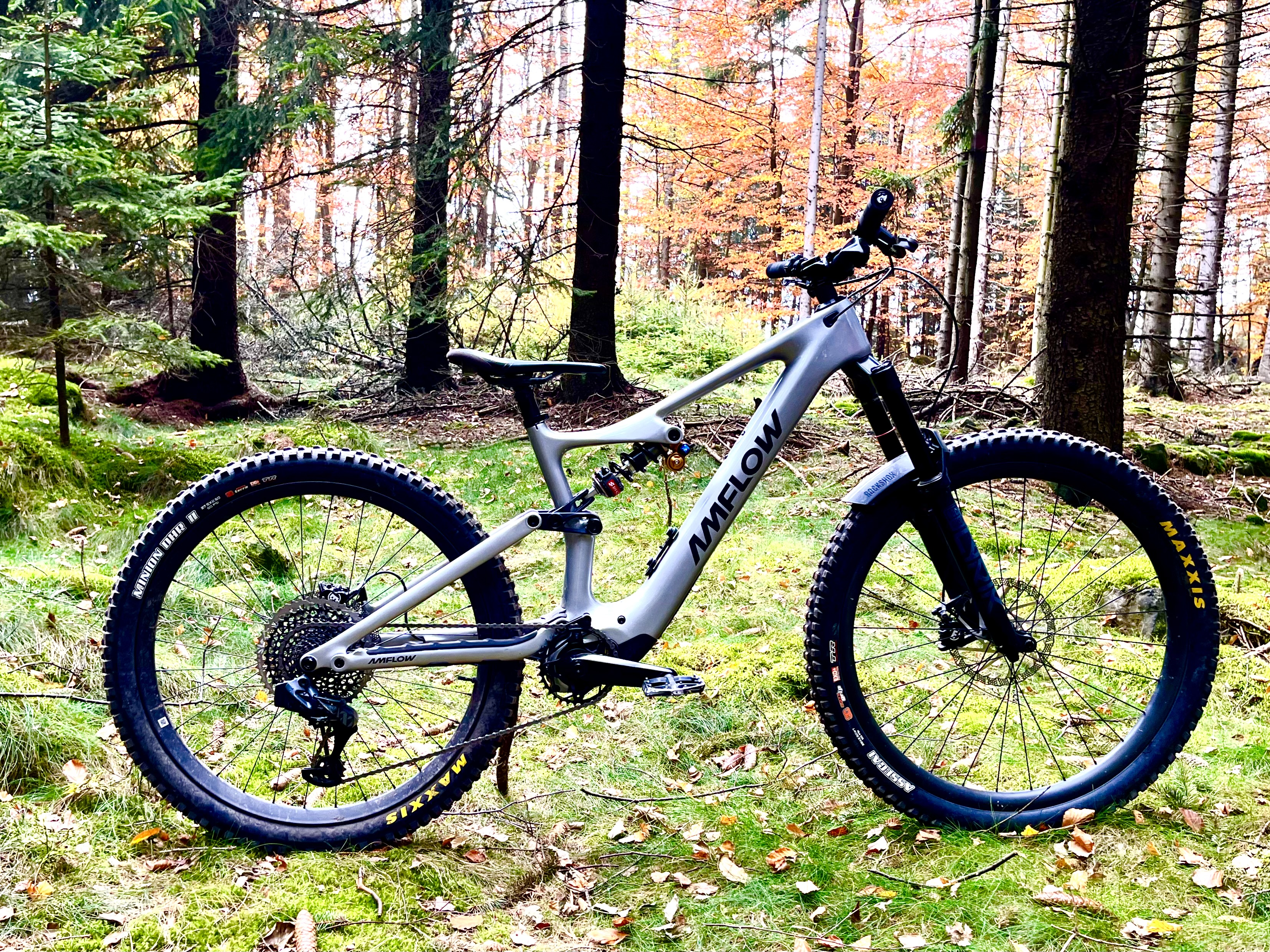

Yes I own one. Came from Germany to me, Slovakia, originally box packed. Bike shop made for me account on Amflow web side. Have no idea why, can ask. But bike works, app works. I changed shock, wheels (mullet), shifting, dropper, seat, handlebar, fork and will brakes as well. Only complain is that adjusting of custom power levels is possible just within narrow window, means preset modes are set and my custom changes are not as I would like to have them. In settings you can change region, so I am almost sure that there is no prob to buy it anywhere and ride anywhere.

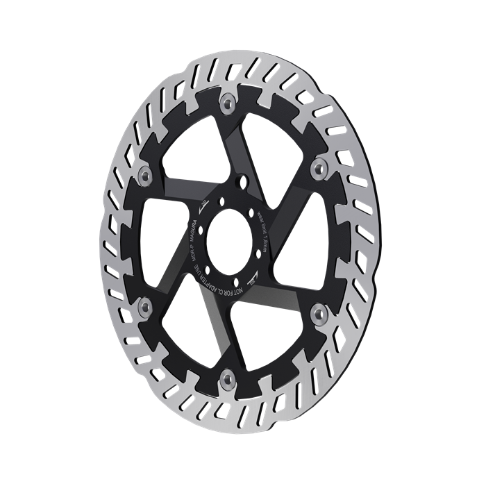

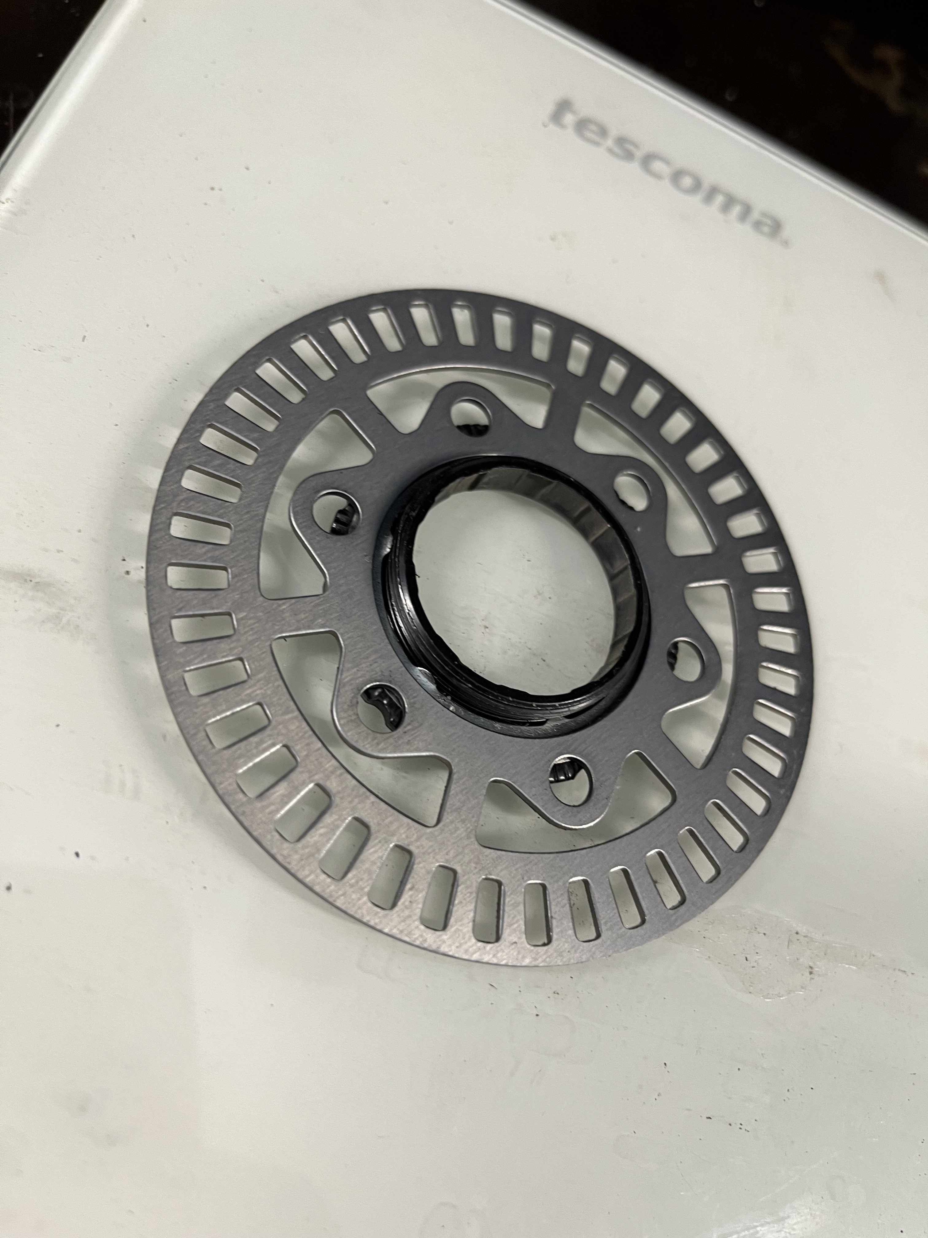

I will try it later with a Swissstopp brake also with a Spider. At first glance it looks having enough space between sensor and speed sensor disc..
It works with swissstop Discs, and I‘m pretty sure also with the MDR. Still a lot of space between Spider and sensor
