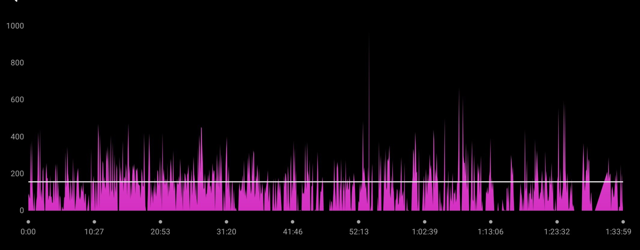

The numbers don't fit the EU law limits, unless DJI found a loophole...the 1000W peak power are probably only the top power spikes, I see 900+ W spikes on my Syncdrive Pro 2, that's nothing unusual, just smart marketing like in the 90s when speakers had that stickers on them in the shops 6000 Watts P. M. P. O., when in reality it was just about 100 Watts, this is probably the same.
Power = Torque x Cadence
There is a balance in this, you can't have all maxed out, something will suffer...also as seen it's a 36V system which is a downgrade imo, higer amps = heat = lower efficiency = high battery consumption.

Watts can be measured in different ways, the 250W u mentioned is a power rating that has not much meaning for the consumer it's complicated to explain easily, but it's the legal limit at least in the EU, the power number that really has meaning is probably somewhere around 600W +/- as all the rest of the mid motors, just because it's theoretically impossible to keep a legal limit of 250W and go much over 600W nominal power, and as said the 1000W are just occasional peaks. In the snapshot you can see my cca 900 Watt spike on the Giant Syncdrive Pro 2.
