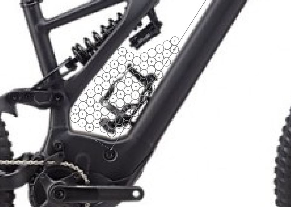

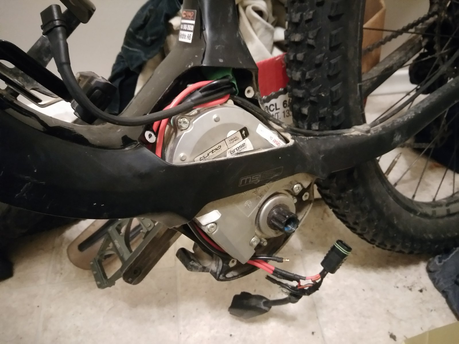

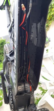

Here is the battery inside the frame.
The cable going from the battery to the diodes which are above the motor.
And here we can see a very small part of the diodes which are installed vertically above the motor inside frame.
Then cables are going below the motor, nothing to say here.
Once the main battery in place its absolutly impossible to see anything about the range extender .

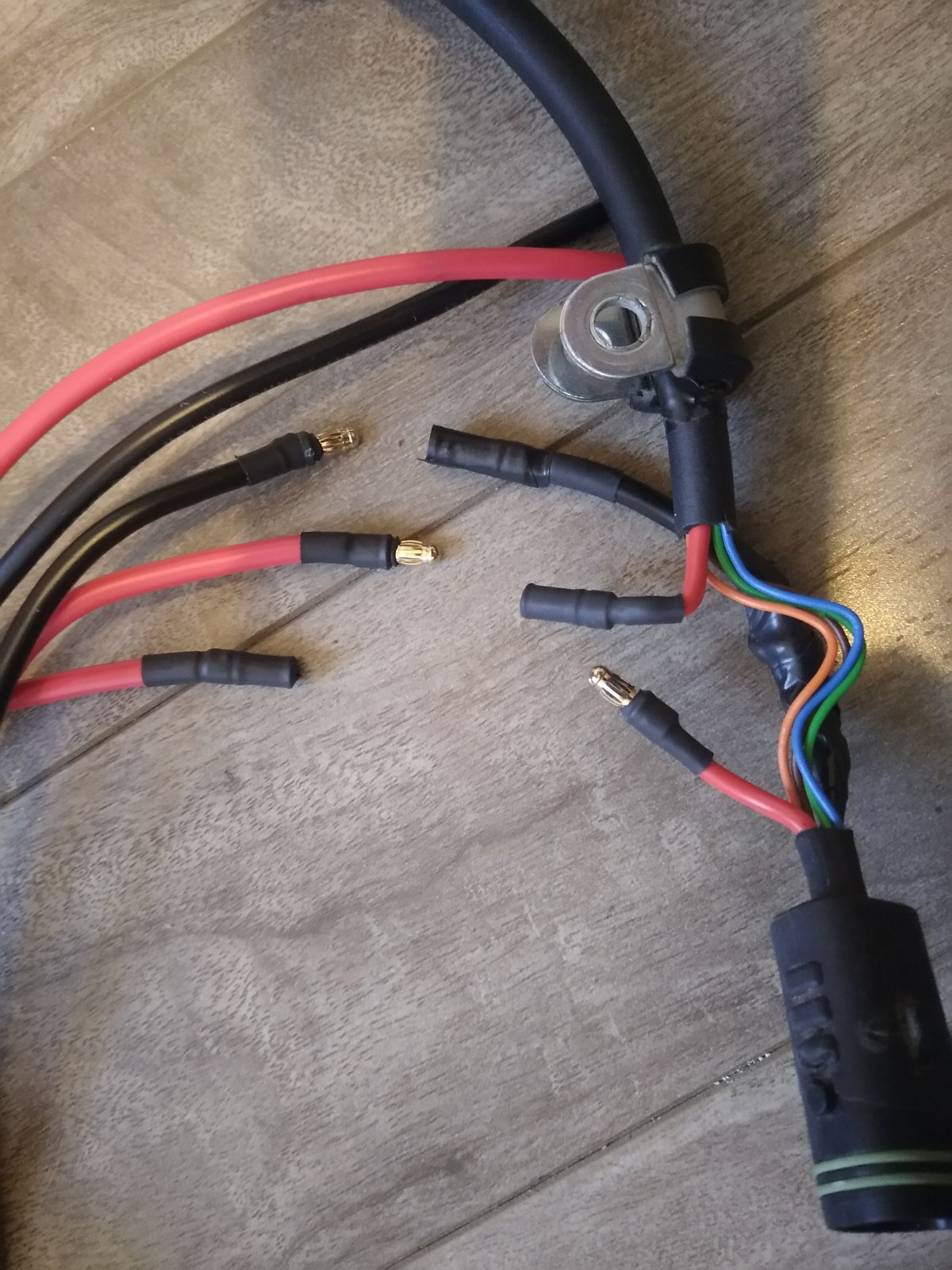

Maybe you got photo of the other side of plug (or connector) than rosenberger? The one that plugs into the egnine, Maybe it will be easier to rebuild that connector instead of cut orginal wires?:rolleyes: I mean make a by-pass? But then ill need a plug and a socket.
May it be it below?:
images
nyx
Oct 10, 2019
25
60
France

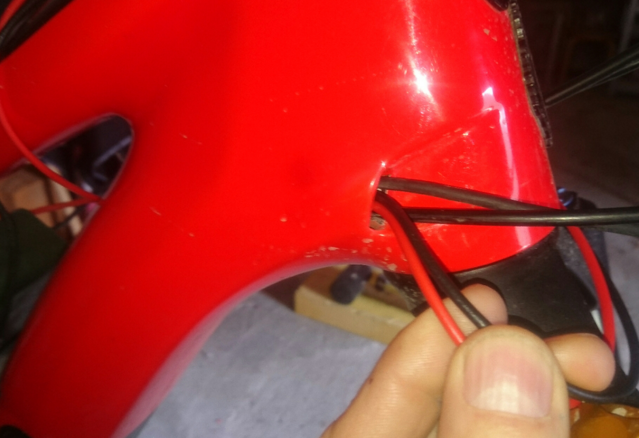

Hello,
I'm sorry I do not have any photos of this and you wouldn't see anything as everything is protected by some heat shrink…
I could have rebuild a cable, but it's pretty expensive to buy. So I just took my Levo's cable, the same as on your photo, cut and naked the bigger red and black wires (the power) and then rewire. It was pretty easy and quickie.

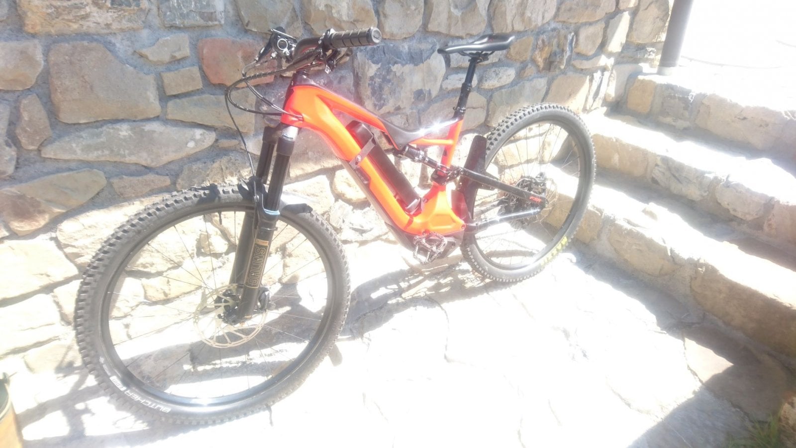

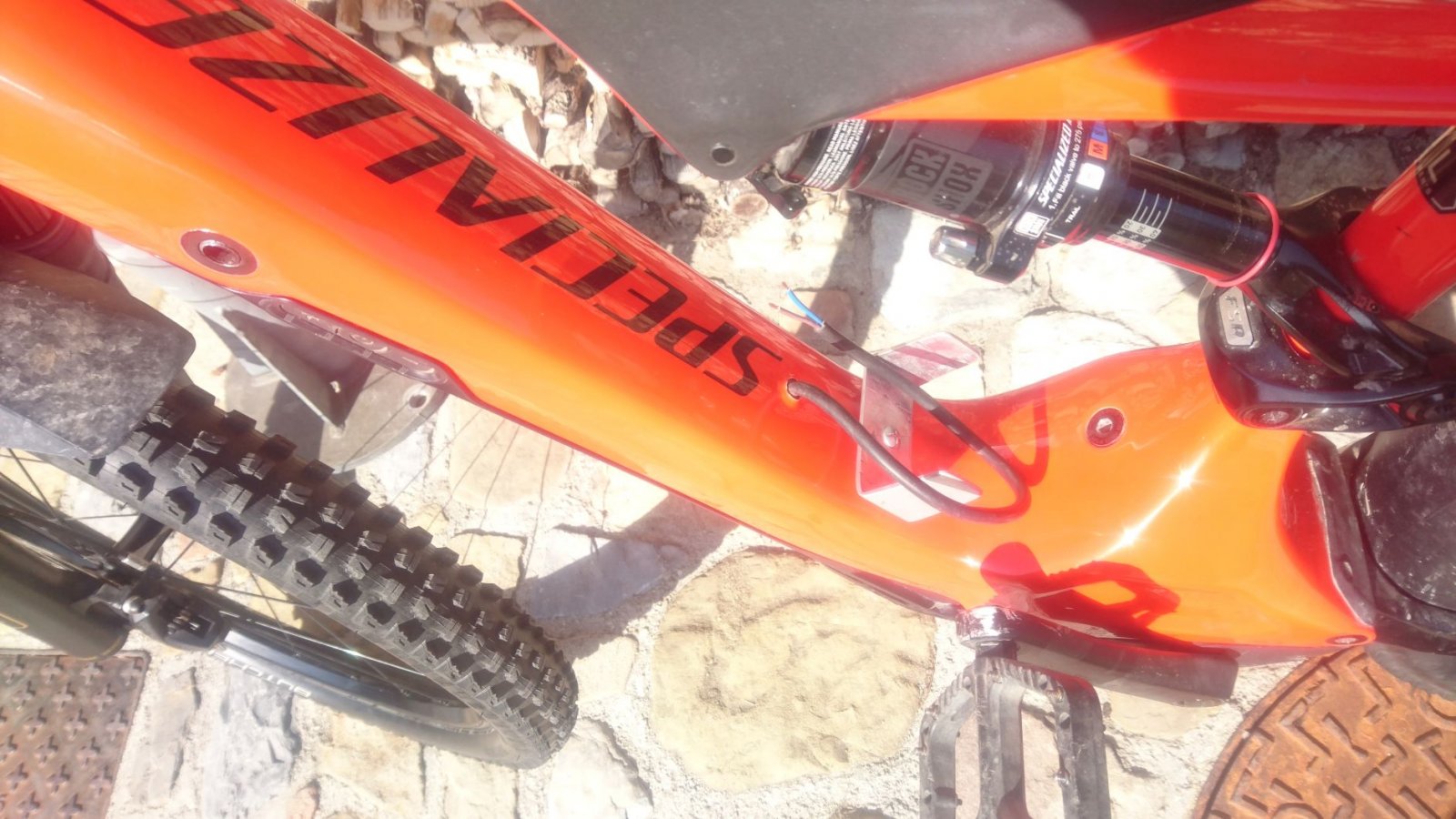

Also thinking here about build a DIY range extender for the kenevo. I'm thinking of use as many cells as possible. I am thinking than 70 cells are possible, 10S7P, 900Wh using 3500mAh cells.
It can weight about 3.5kg, I think it is not problem to carry with 3.5kg in this position

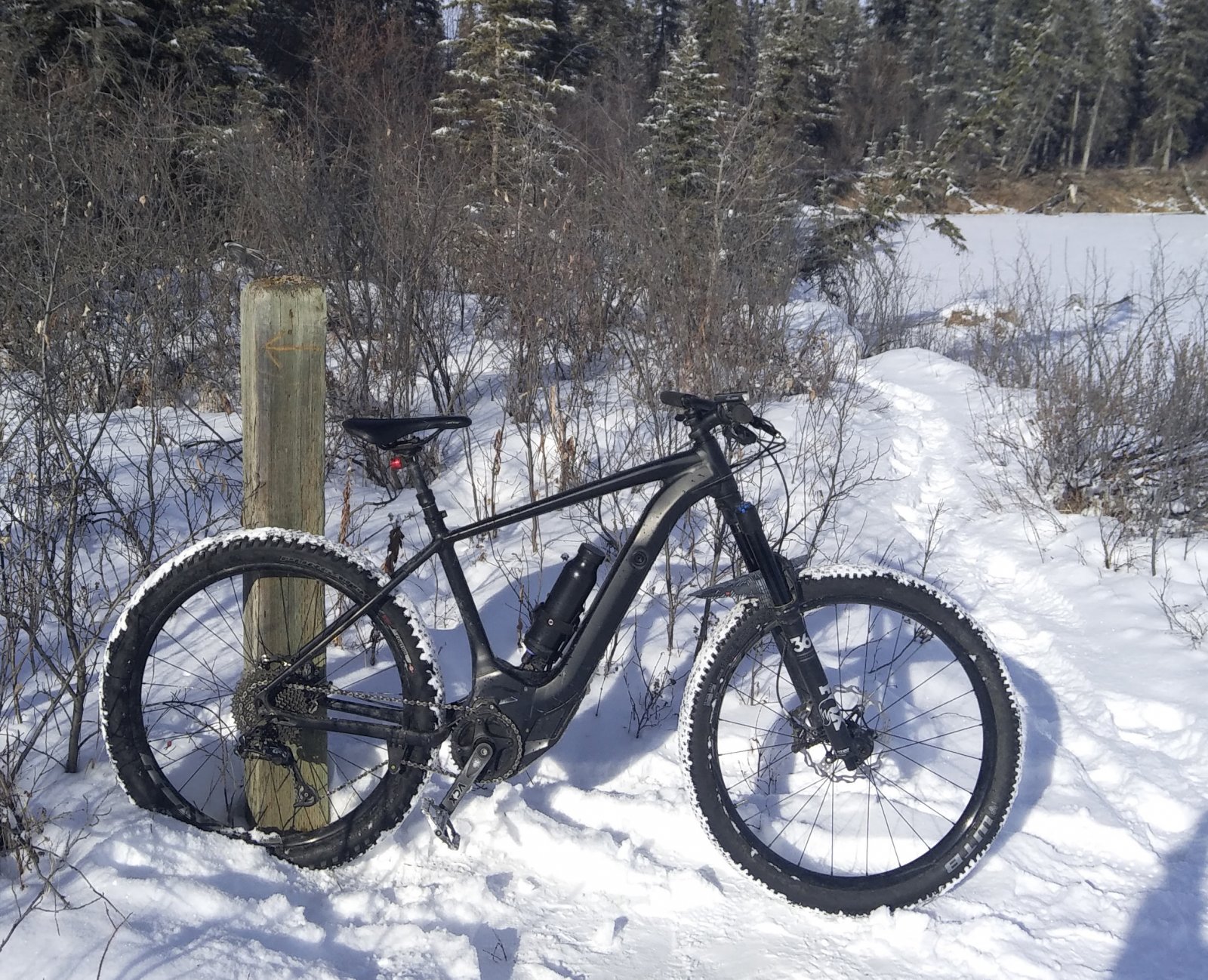

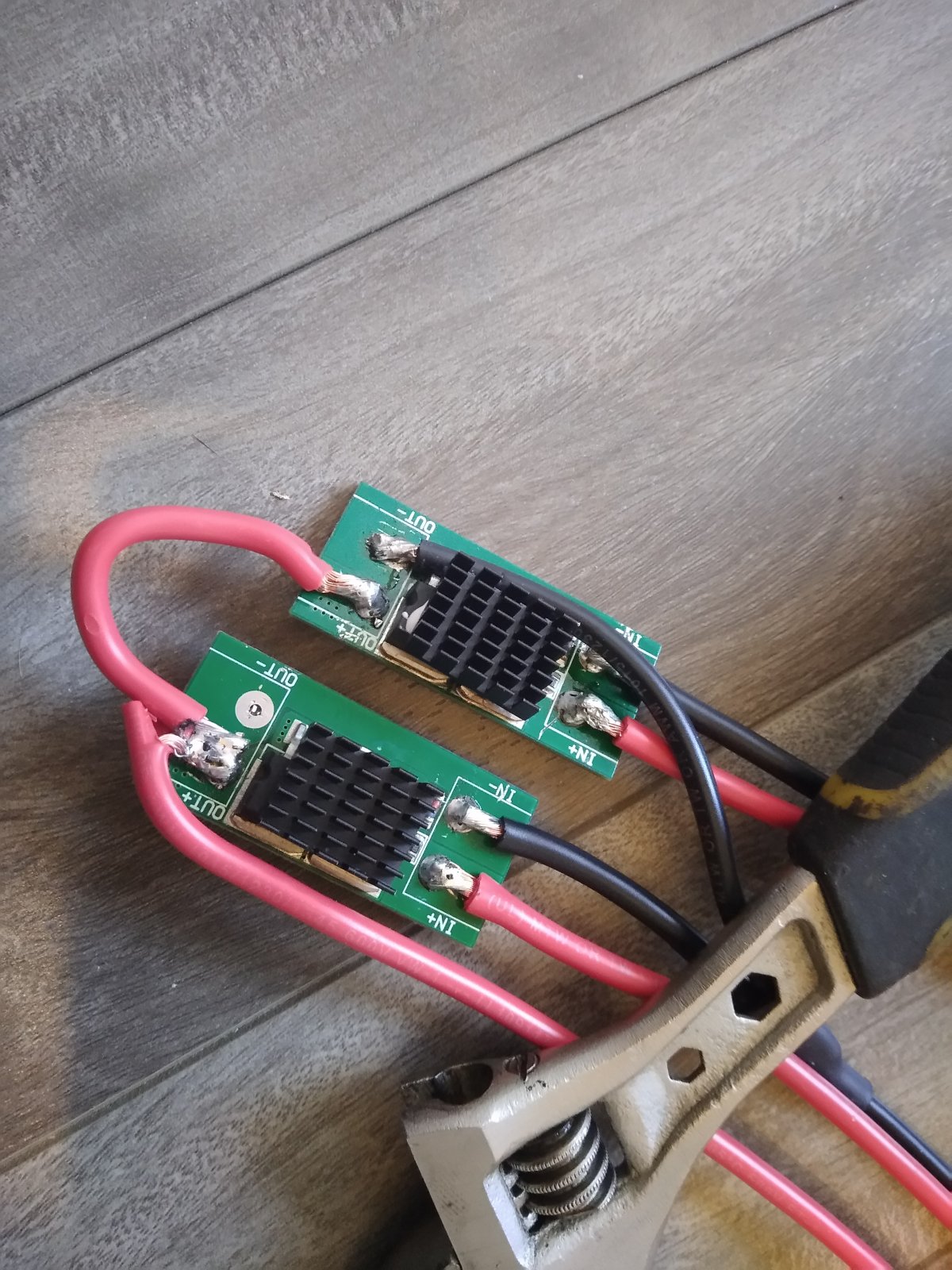

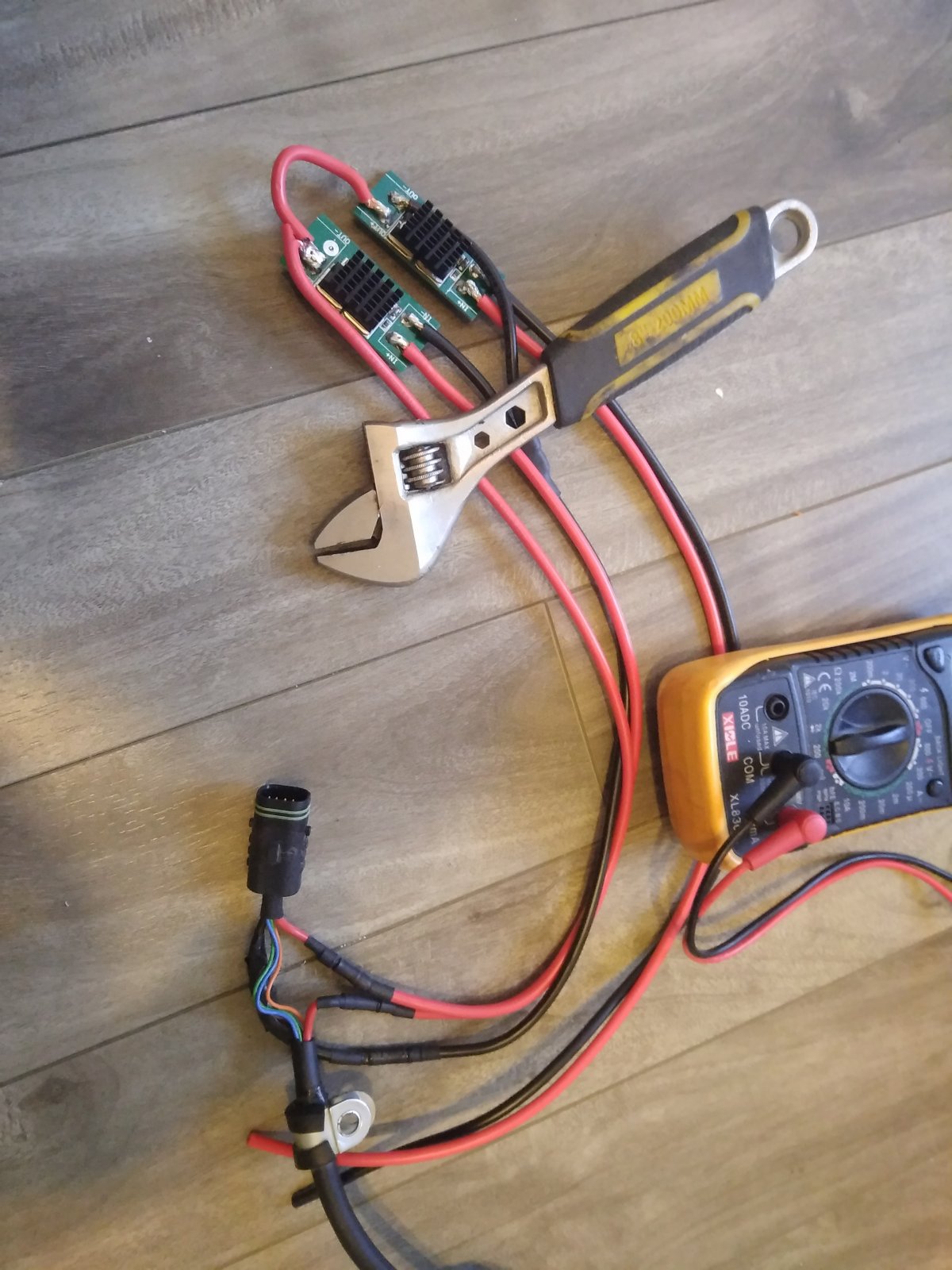

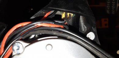

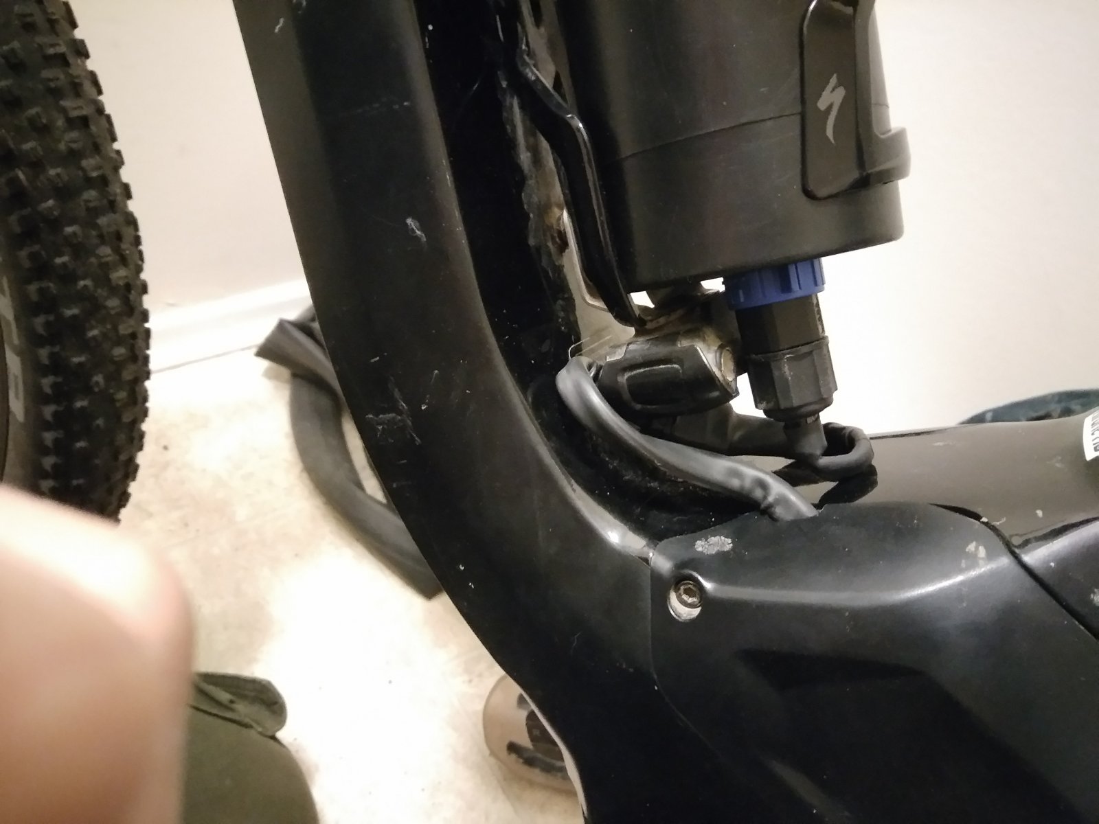

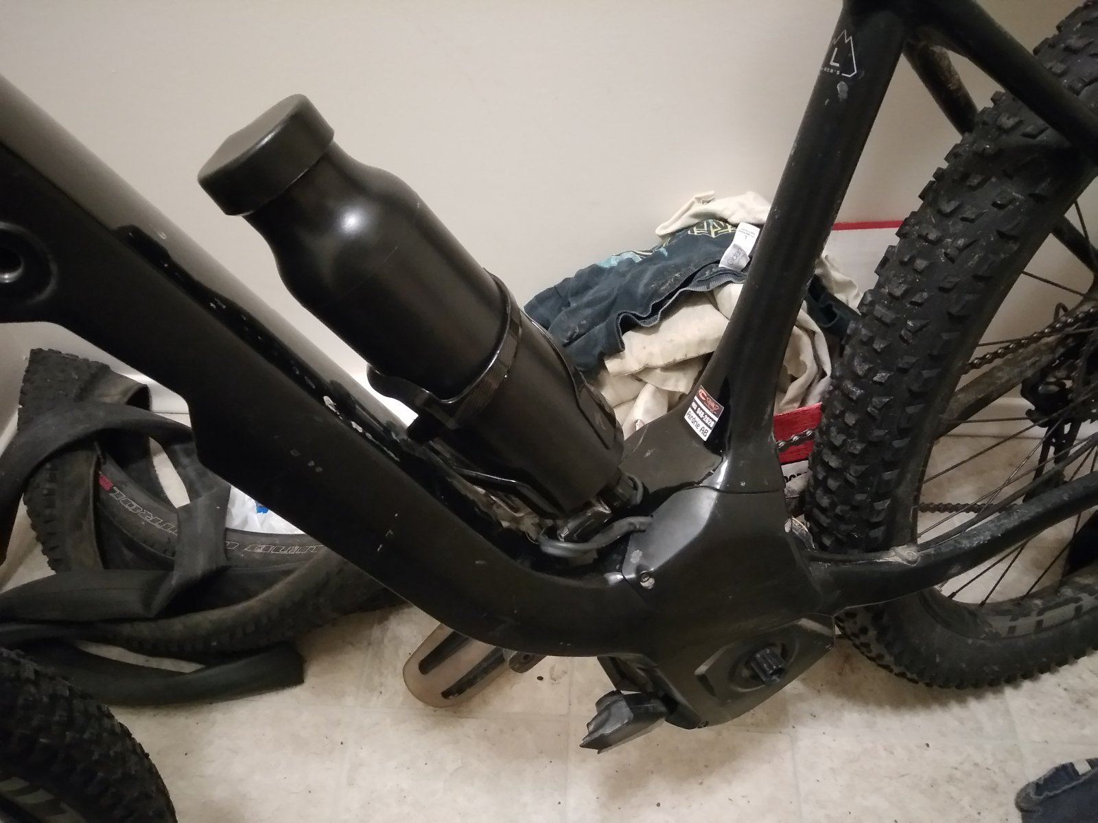

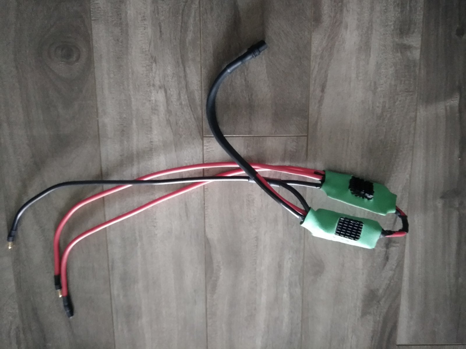

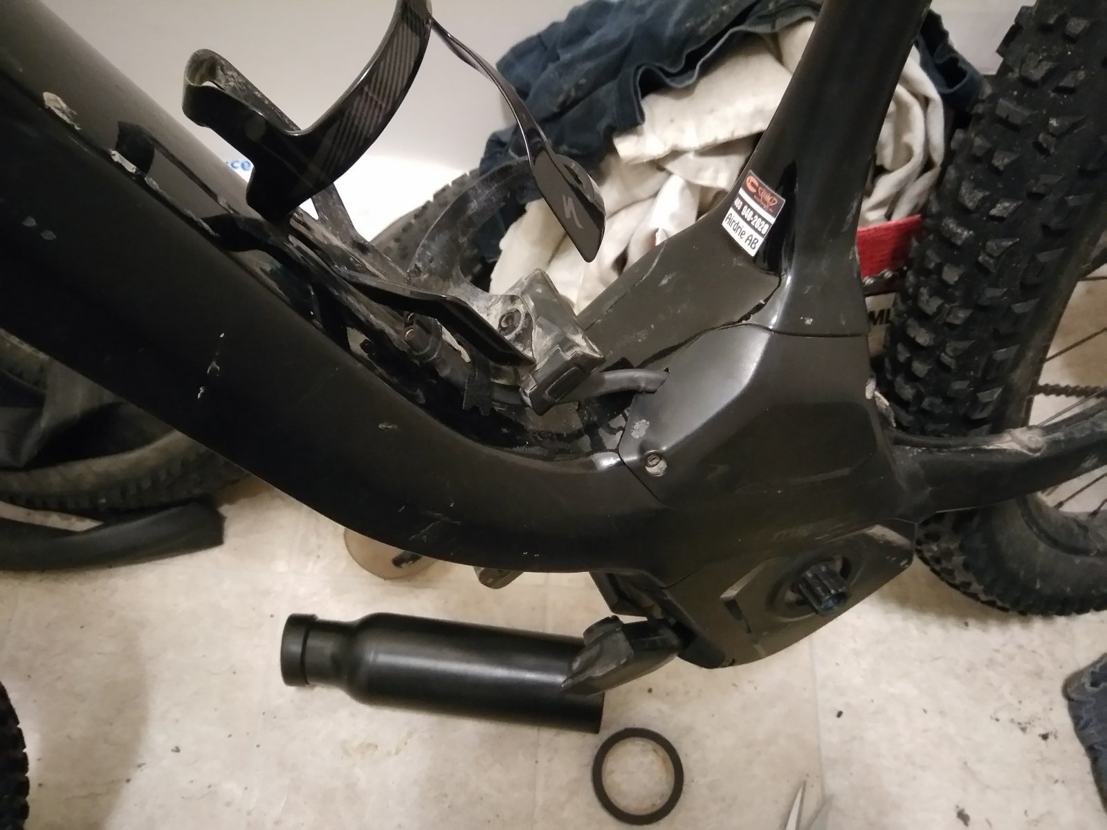

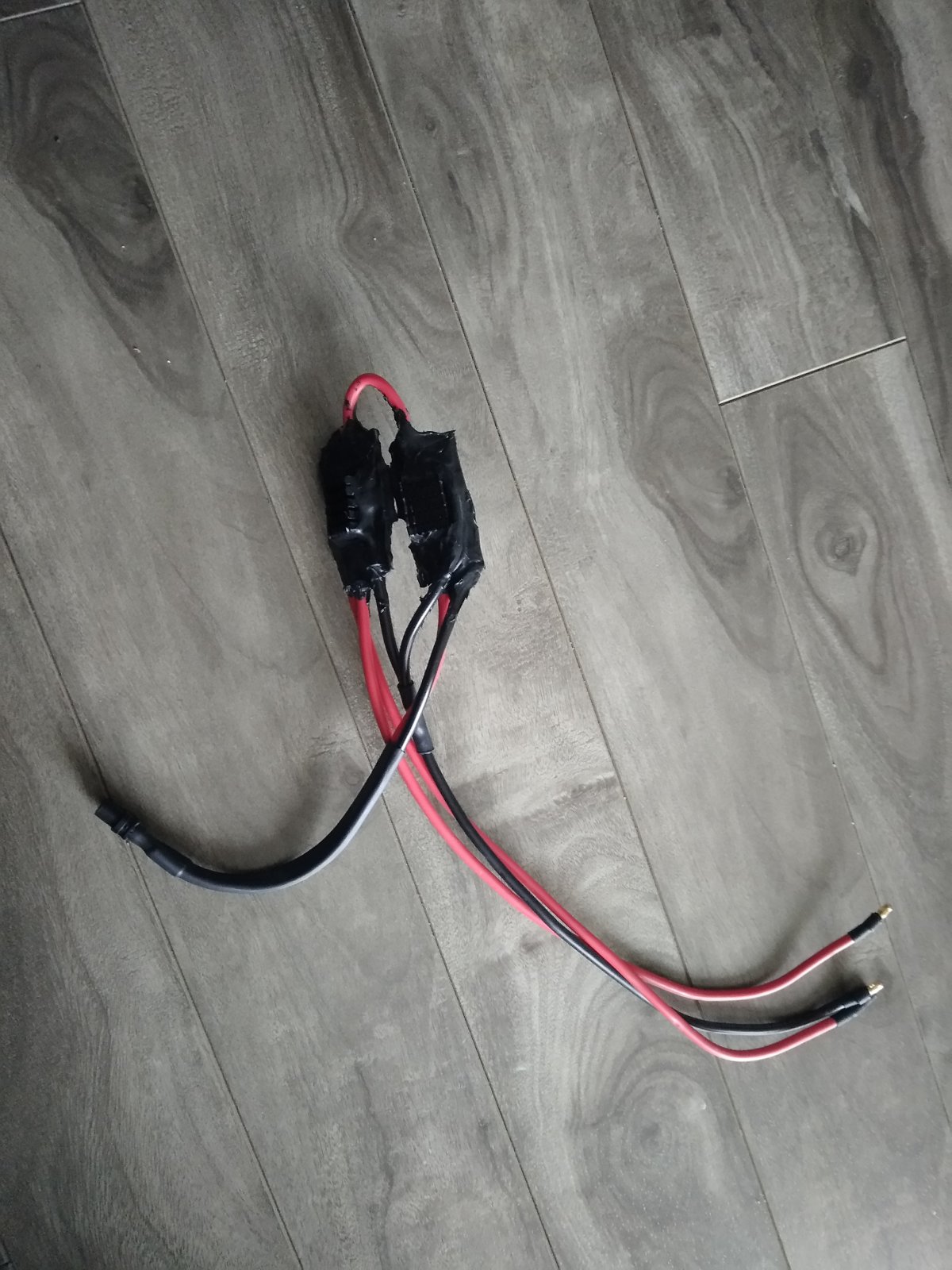

Couple pictures from my little project
Bottle battery 5Ah - 120$ - alibaba
Quick Shipping 36v Ebike Water Bottle Battery With Usb Port - Buy 36v Bottle Battery,Water Bottle Battery,Ebike Bottle Battery Product on Alibaba.com
Two ideal diodes - 10$ - aliexpress
US $3.22 31% OFF|15A Solar Panel Anti Reverse Irrigation Ideal Diode Battery Charging Board-in Solar Controllers from Home Improvement on AliExpress
Cables (12awg) - found in office
XT60 connectors had home and pins- 5$ - aliexpress
Heat shring 5$ local shop
140$ tolal
Thank you for this thread very useful informations here .
Now enough range for me and I can continue with future battery updates .
Pcb is sealed with silicone
and heat shrink
Planning update whole connector on bottle and than shorten cable even more
Dremel for smal hole in motor cover
Cable is almost unvisible (if extender not needed)

Hi cool system thinking of doing this myself have u had any problems with diodes overheating if ur running just the main battery by itself so all current is going through a single diode
Thanks
freerider85
Dec 20, 2018
41
20
canada
You have two diodes one for each battery so batteries can't affect each other .Yesterday I did 75km in combined terrain and no single (overheat) issue - dioes are cool maybe because I live in Canada :) but I belive they will perform great in 35C+ weather as they come already with heat sink .

I am dealing with a project of the same kind but with the purchase of the bottle already with the cells, my question is the following:
I can use these ideal diodes: 50A Ideal Diode Controller Solar Battery Anti-backflow 9-80V Protection Module
link: 50A Ideal Diode Controller Solar Battery Anti-backflow 9-80V Protection Module | eBay
thanks for listening
freerider85
Dec 20, 2018
41
20
canada
Hi yes you can use this 50A is even more than enough .They are little wider but it probably will fit under seat post just look there if you have enough room for this type of diode.

the original battery is 460wh and i will put another 252wh in bottle mode. Won't I have problems with heating on the diodes that I mentioned when I'm just consuming the original battery?
thanks
casco
Mar 4, 2020
19
9
arouca
I'm even good with 10 bucks Chinese cheepos they work well not single issue (I have 300km after battery mod) .Its just diode not big deal .
I have one more question:
there are diodes that have in + and out + and in- and out- others have in + and out + and only one gnd, is it the same?
thanks

The Turbo levo motor pulls up to 20A in peak on it's last firmware update, so your 50A Ideal diodes (I guess it's 50A continus) won't warm at all in my opinion…
RCDallas
May 28, 2019
152
153
Italy
Resistance over a PN junction should be the same for both the 15 amp and 50 amp diodes so the approximately the same amount of heat will be produced by each diode for a given current. The 50 amp diode has a larger heat sink and should dissipate the heat more rapidly therefore should remain cooler. Having said that, IMHO 50amp diodes are way overkill unless they are to be enclosed with little airflow for heat dissipation.
casco
Mar 4, 2020
19
9
arouca
in the case of the turbo levo, the diodes have to be there next to the engine, and consequently they take with the engine heat too ... being that with the original battery it has a peak of 20A, with the diodes of 50A (continuous) it will be more make yourself comfortable. does this perspective make sense?
thanks

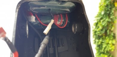

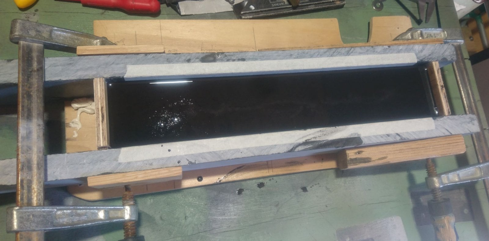

Some update on my extender project ...
Finished and tested.
works fine.
the battery pack and the BMS are moulded in black epoxy which needed some more sanding afterwards
the battery holder and cable coming out of 1 of the bottle holder wholes.
Extender installed and ready to roll … 504 + 432 = 936 Wh
