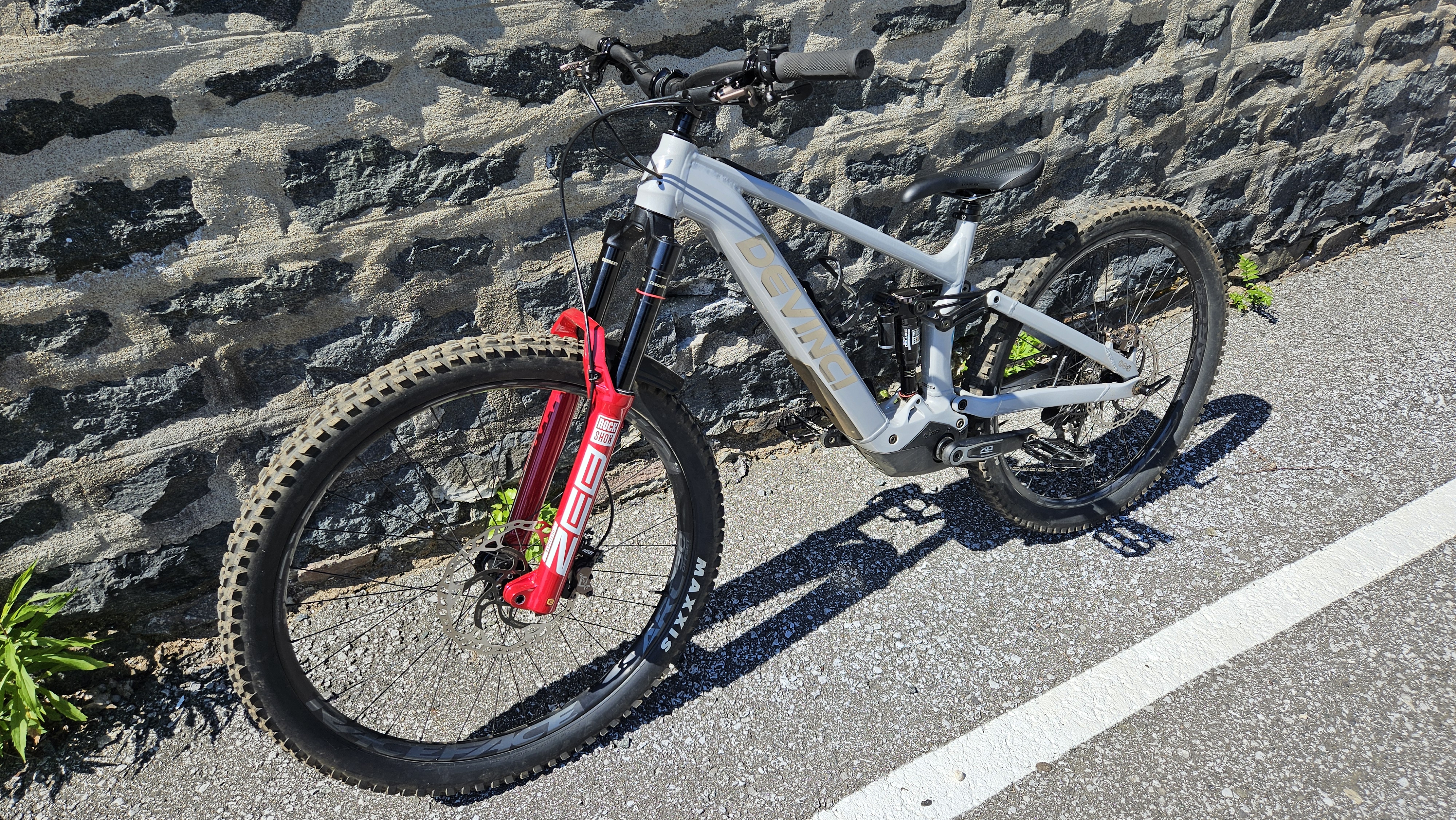

Has anyone tried a 170mm front fork yet? My dealer only had the 170mm Zeb Ultimate in stock, they told me to test it and if I did not like the geometry change, they would swap the air shaft for a 160mm. They informed me that the 10mm travel bump in the front would not affect the frame warranty.

I havent tried the bike but you should know the zeb is 10mm more axle to crown ,if both forks are equal in travel, plus the 10mm in extra travel.
That will slacken your head and seat angle .8⁰. Your head angle will be 62.8⁰. Thats a dh bike head angle. Definitely fun on the downs. I guess it depends on how you'll be riding the bike. Seat angle will be 76.8. Still relatively steep. Your reach will shorten 4-5mm and your bb height will raise 6mm. Head angle is probably the biggest decision maker. I rode my mullitized commencal meta 29 enduro bike around with a 63⁰ head angle and it was a lot of fun. Definitely had to pay attention on steep tech climbs and switchbacks. A motor does ease that though. Mine saw a lot of bike park gondola laps though. Depends on your usage. Zeb isnt much heavier than a lyric/yari (100ish g) so itll be more geo dependant IMO

I just checked the specifications, and the Zeb has a 5mm higher axle-to-crown measurement than the Lyric for the same fork travel. So, going from a 160mm Lyric to a 170mm Zeb would result in a 15mm increase in axle-to-crown measurement. I had not considered the axle-to-crown variation before, so thank you for bringing it up, I appreciate it!

Oh 5mm diff. Good to know. Maybe the 38 that varies 10mm.
Personally, the zeb at 160 would be my choice knowing i get 5mm axle to crown diff. 63.6⁰ ha sounds about perfect for what id want, and the SA is still more 77+

I am primarily looking for a stiffer chassis. I have a Fox 38 on my regular bike and have noticed a difference in the fork flex. I do not think the 5 mm with the 160 mm air shaft will make a significant difference in how the bike feels and handles. I will still try the 170mm fork and see how it feels, if I do not like it I will go with the 160mm travel.

A quick update on the new fork: the fork feels great right out of the box, with the sag properly set and the rebound and compression settings recommended by Trailhead.
The 170mm travel up front is noticeable on slow turns and technical climbs. The bike feels better on the downhill sections, but I am not sure if that is due to the new fork travel, the Lyrik vs Zeb, the new 3.1 damper, or a combination of the three. So far, I have only one ride on the new fork.

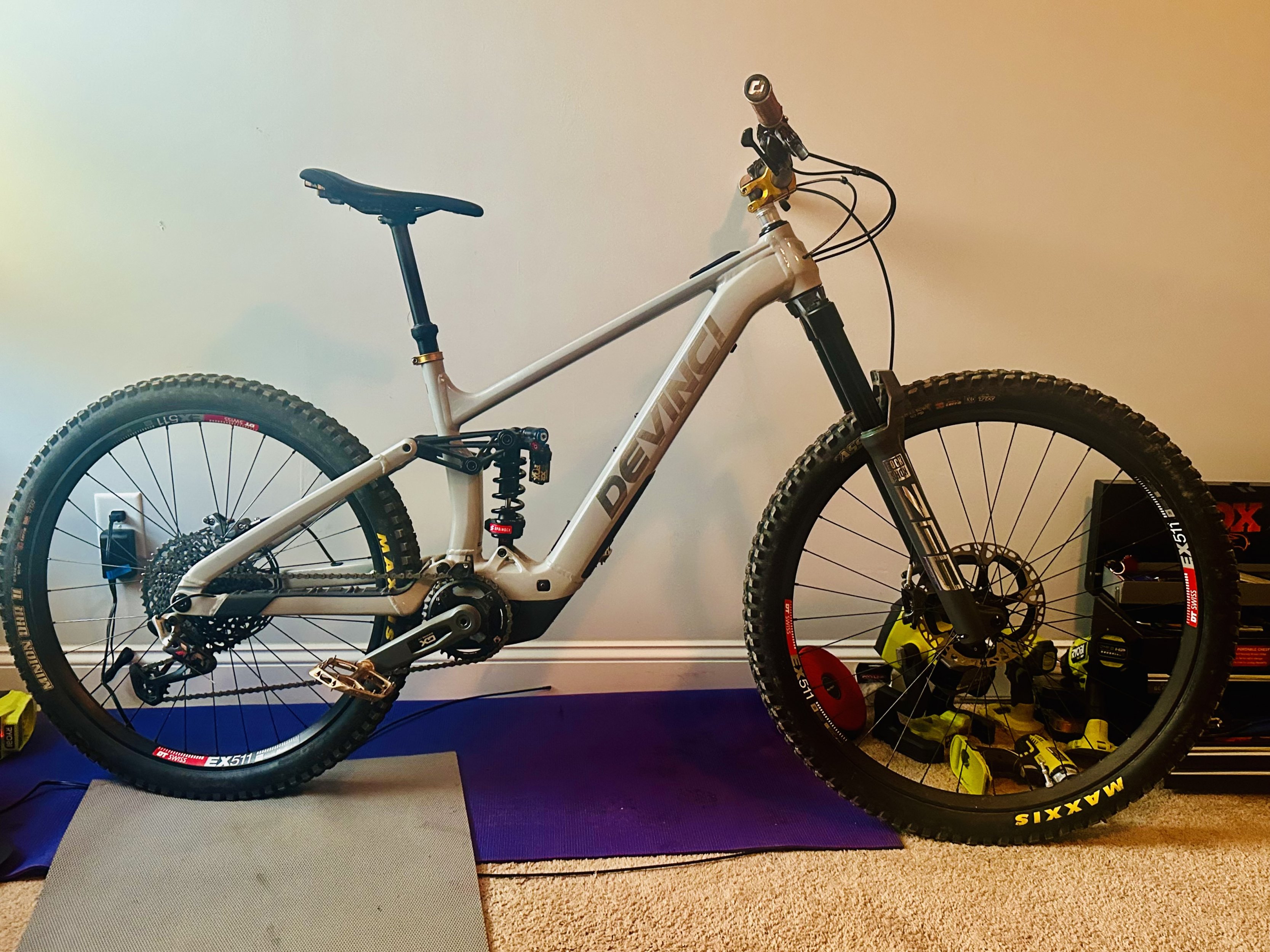

I was hoping to avoid regretting my purchase, but after searching for hours, I need help with a couple of projects. I'm looking to replace the brakes and wonder if I have to remove the motor to route the rear cable. Next, I want to remove the SRAM crank arm. Is this a standard SRAM crank removal, or do I need a crank arm puller? Finally, for battery removal, do I have to drop the motor to access the battery? Thank you for any help. It would be great to have a more detailed manual for DIY bike riders.
Removing the motor would make the job ten times easier, I learned this the hard way by routing my brake hose the first time without removing it. It only requires two T40 Torx bolts and three wire connectors, which are easily removed. The torque specification for these bolts is 30 nm. At the same time, I recommend that you inspect the motor bushing and grease the bolts properly to eliminate some noise.
I removed it with the Park Tool CWP-7 crank puller with the larger end, remember to remove the small washer in the crank arm before attempting to pull out the crank. My chainring retaining nut was not properly tightened, I had to torque it back to specification.
You must remove the motor to gain access to the battery.
If you have other questions, feel free to ask.
jayx4
Sep 5, 2024
9
8
North Caroline
Thank you for the advice it is impossible to find any diagram online. I did find a diagram on Whyte website which seems close https://cdn.shopify.com/s/files/1/0...Owners_Manual_V01_Rev_B-comp.pdf?v=1709030955
For the cranks I was hoping the Sram cranks would self extract so then I'm guessing I wont be able to use my 5dev cranks that were Dub compatible ?
again thank you !!!

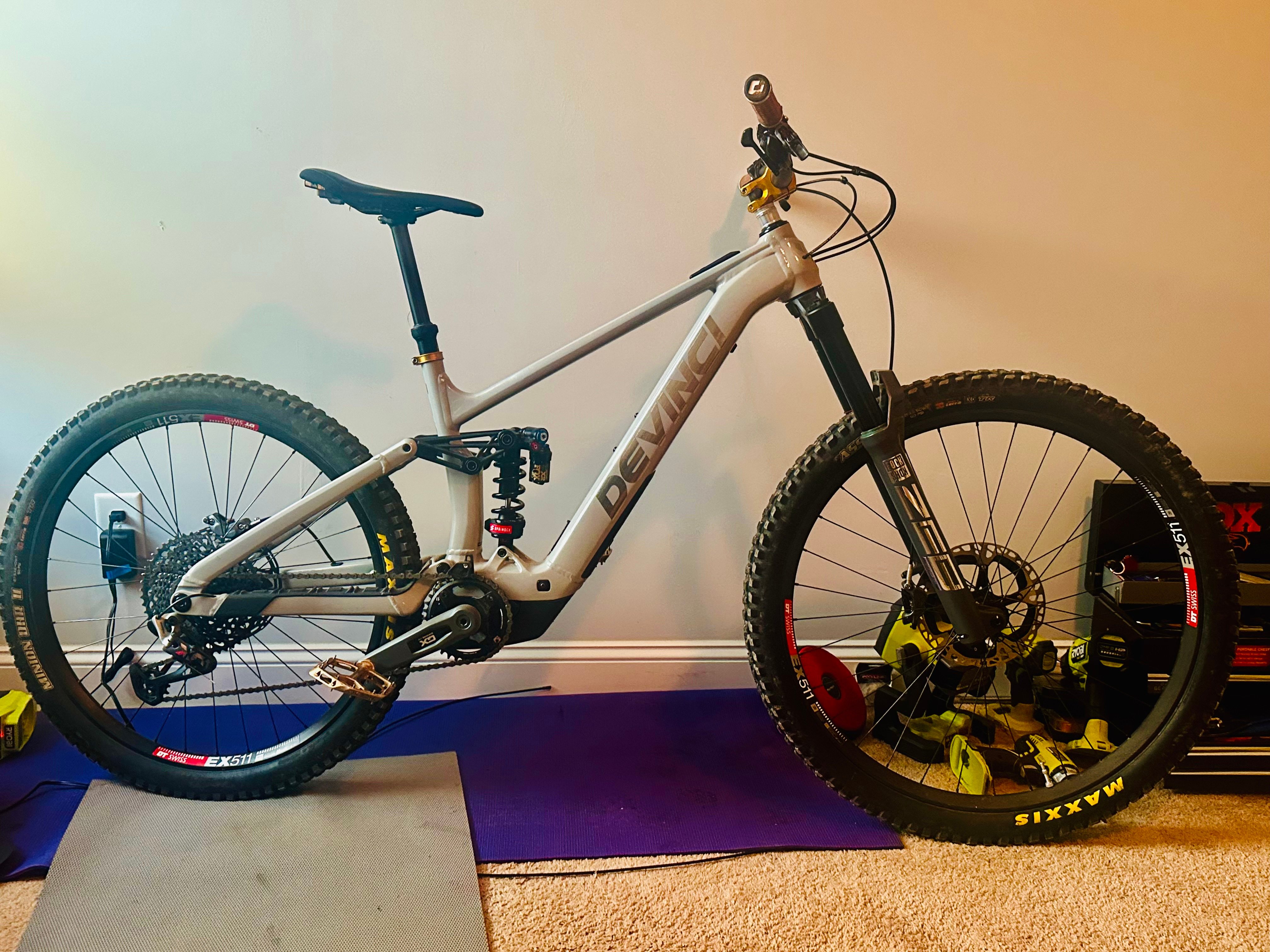

Sorry about all the questions the website doesn’t offer any info on if I can run a coil on my E-light . My gut tells me yes any feed back would be great.
fredmotokx
Jul 13, 2024
13
17
Canada
I have not yet tried the coil on the E-Troy Lite, I considered getting the new Vivid coil, but the SDU that came with my bike performs well.

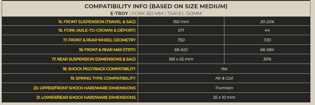

Has anyone long stroked their shock? Id be curious if the bike can run 57.5mm or 60mm stroke for 155 to 160mm rear travel
