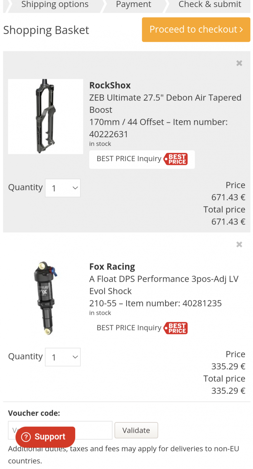

Dengfu E10 is this the right fork n shock before I buy?
Apr 22, 2020
22
Lancashire
Please excuse the question but I just want to make sure before I pull the trigger, can anyone confirm that these are correct items for my 17" frame I've ordered?

Yes to the rear shock.
Yes and No for the fork.... The E10 was designed to run with 29" wheels, but the ZEB fork you have shown is for 27.5" diameter wheels. It will fit the frame and work with a 27.5" front wheel, but I wouldn't recommend it - the geometry of the bike will be off and the bottom backet height will be waaaaaaay too low, causing pedal strikes-a-plenty! Also if you lost your mind and fitted a 29" wheel in the rear, you would have a VERY strange ride indeed, but it might catch on...

Yes to a 29" ZEB, but I think 180mm is getting pretty long and the balance front and back with a 55mm stroke shock will be off. 170mm is long, but people have fitted them without too much issue.

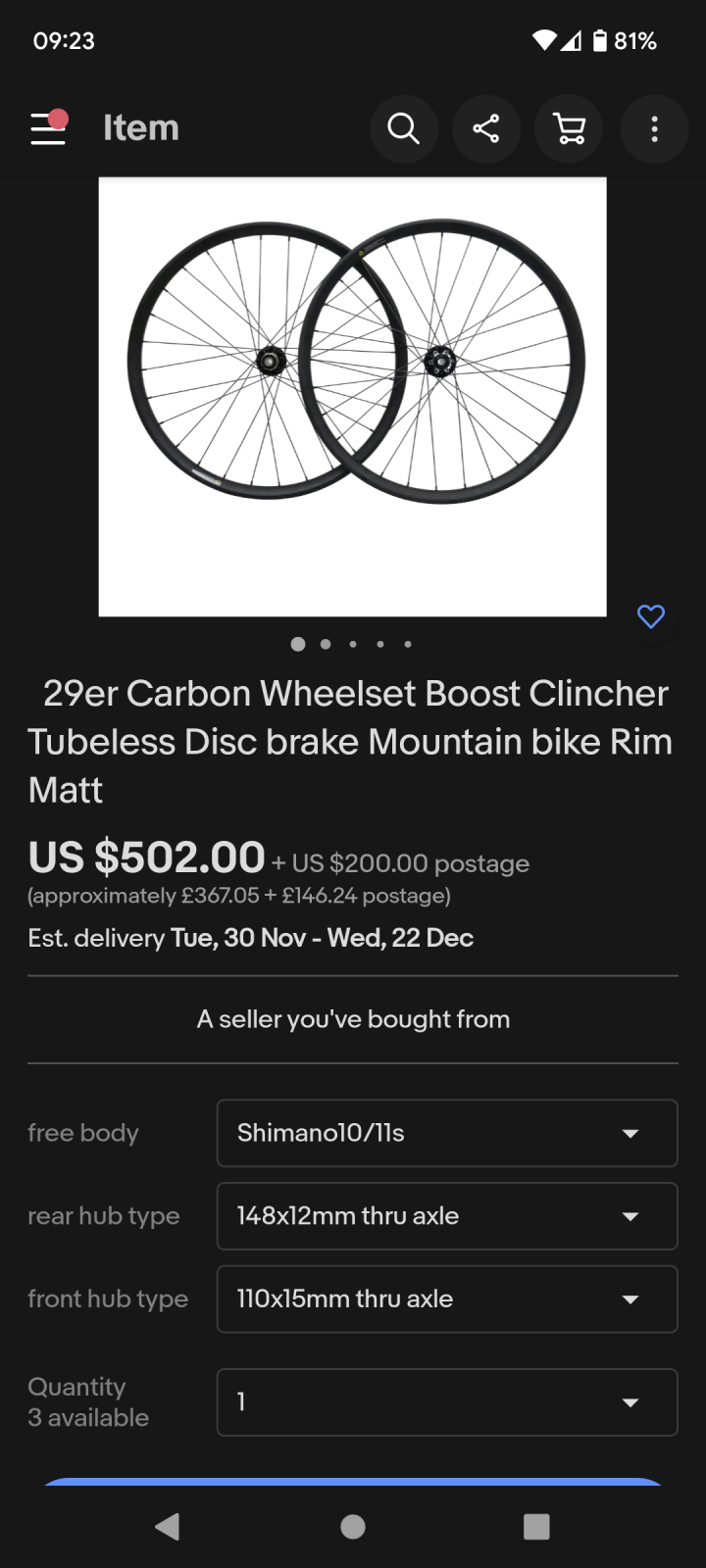

Incidentally the people who supply my frame also supply wheels and have these, wondering if you have any advice. They will supply 27/29 of these wheels

Personally i found that expensive (can find DT 1700 for lower price for exemple on RCZ). In add carbon wheels are valid for road, but i find it less confortable than aluminium rims on rock garden and the gain of weight is imperceptible in regards of the 25 kg of the bike

Thanks mate , I will look into this. Thanks for the advice. Your bike looks brilliant by the way wish I was near those mountains

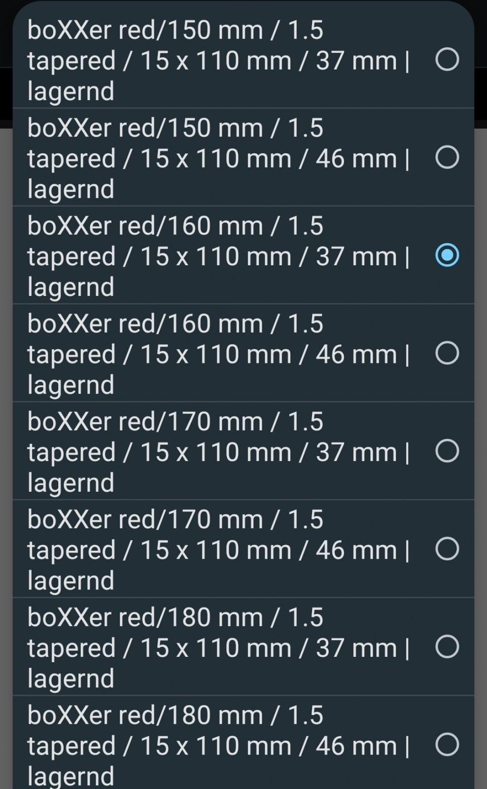

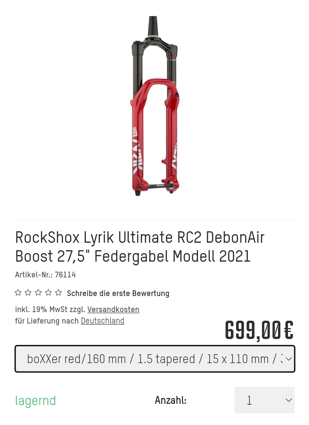

Can you please help me choose the right fork for my dengfu size M?
I will be using a 27.5" front and rear wheel.
View attachment 85904 View attachment 85905
Looks right. Luna X2 variant and I think Dengfu full bike come with 160mm travel (can't locate E10 dengfu full bike, maybe b/c from US, or it's just down again - from Dengfu full bike may be 150mm). Some have also gone to 170mm fork travel...

Thank you, do you prefer 37mm fork offset or 46mm in this case?
Not familiar with the Boxxer, but most use the shorter offset for 27.5 and the larger offset for 29ers. 37mm offset looks low to me though - my Yari is 46mm offset running 27.5". I think DVO forks are like 40-42mm 27.5 or 44mm 29er.
I know at least one person in one of the M500/600/cheeb threads swapped between different offset forks and pretty much came to the conclusion they adjusted to either one pretty quickly, but that 37mm offset sure seems low to me. It's probably worth the time to read through some of the 'cheer'/E10 build threads to see if anyone's running a boxxer. Which size wheels are you going to run?

I'm going to run 27.5" front and rear wheel.
