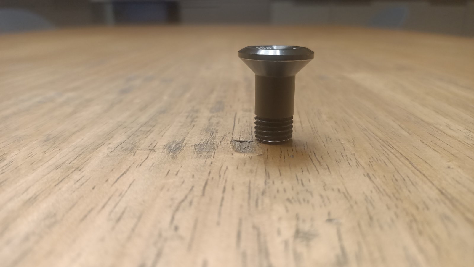

Hi guys,
I started my First DIY build, so far so good.
I had a problem with my torque wrench, and i tightened too much the screws around the rear shock.
I have to buy 2 new screw (see photo) do you know what type Is It? Where can i find It? Is the M10x1x18 the right measure?
Thank you so much

If it helps, the thread pitch on those bolts is, 1.25mm.
Measure the length of the bolt. You should be able to find a compatible one online.
If you struggle, I can try and guide you to an outlet location in Italy @Mattia 👍🏿

Got to Betterbolts.com Give them the specs for the Piece you need and they can custom make you a new set for cheap but you could even choose to get them colored if you wanted. Just an idea.
