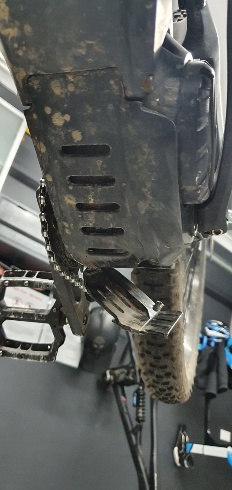

I've put about 200kms on my dengfu e10, and the bashguard that comes with it it kinda crap...I feel like every time I hit it, which is often, it makes a huge bang and I'm about to break something.
I had an iscg05 mounted one on my old bike and that worked really well. Has any one got a more hardcore one on theirs than the factory one?

Do you mean the large plastic skidplate on the bottom of the motor? I've already broken one bolt hole on the plastic bit. I'm thinking of making something from kydex as some of the levo guys in the other forums have.

And now it's broken completely :D
What to do?

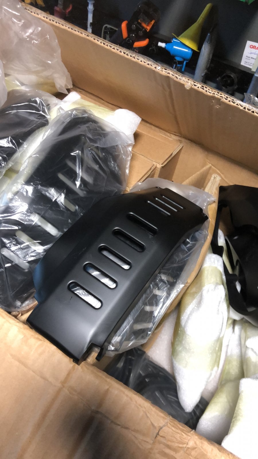

I Have just reciveded engines with bash guards doesnt look very strong I will take dimesions from new one and try to 3d print from flexi (TPU) material or laser cut formed and weld alumnium version .

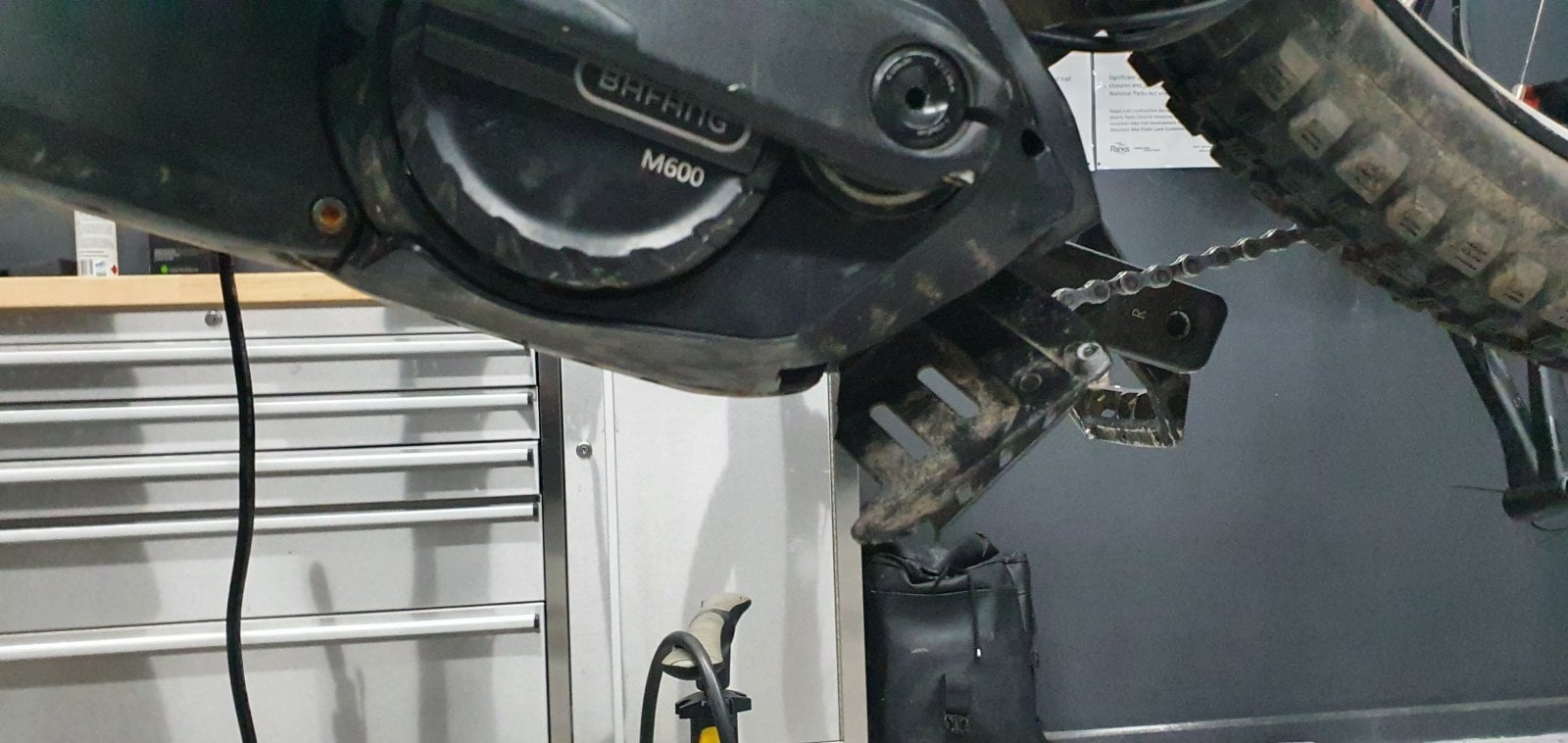

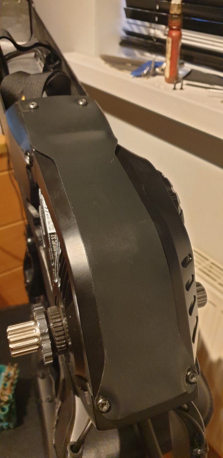

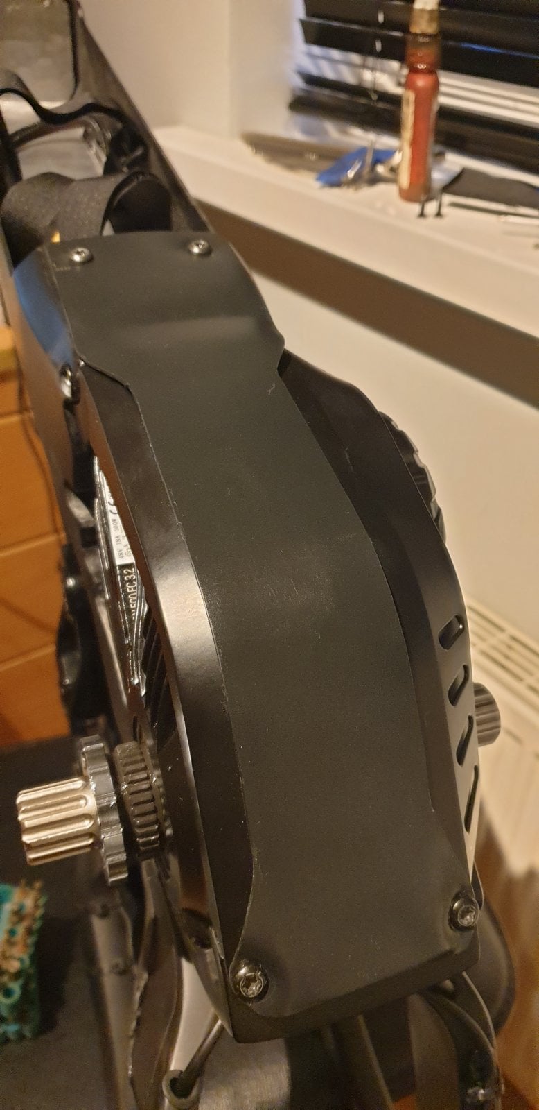

This is my effort.
Its made from 1,5mm Kydex (used to make knife / gun holsters) which can easily be cut and moulded with a heat gun / oven.
Tough as old boots and relatively cheap to buy. Mine sits over the top of the Bafang original for extra protection and is mounted via the existing bolt holes in the frame.

That's similar to mine, except yours looks way better hahaha
Mine goes all the way around the back into the insert where the cables come out the rear, and then bolt into the same spot. I did mine in three layers.

Ah didn't realise you had already tried the Kydex route! I haven't tried mine in anger yet so can't vouch for how it will perform...

This is my effort.
That's looks quite durable, I was thinking of some kind of thick plastic or rubber. Do you think the motor needs any holes in the guard for cooling. noted the original one has some. Not such a concern in English weather tho'
You can't see it from the photo but there is a small gap between the original bash guard and the home made one.
The motor runs relatively cool and the sides / top are exposed to fresh air, so I wasn't too concerned (especially in the UK climate!)
