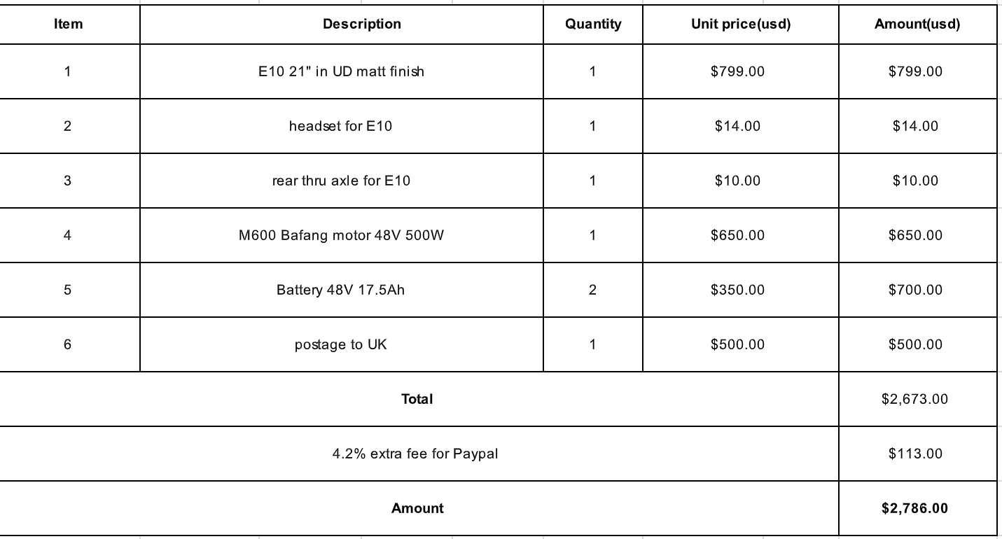

Hello everyone I'm new on here.
I ordered E10 a couple of days ago. If you don't get a reply from Dengfu first time then try again, my first email went unanswered for a week, then I resent and received reply following morning. Melody said they will ship out my frame at end of April, Dengfu are prioritising shipping in order of when you pay, apparently a lot of people ordering right now, probably due to Rob's YT videos, hope you're on commission Rob:)
I ordered extra battery, which incurred additional $120 shipping charge, so second batt not quite the bargain I expected but still less than half the price of main brand batteries.
Going to call mine a 'Clevo'. People have done some gorgeous paint jobs in this thread, but I'll leave the matt UD finish because it's easier, looks stealth and doesn't collect stone chips like paint, I'll make up some nice decals.
I've done a couple of China carbon XC builds before which went very well, but this will be my first e-bike. Been looking around for forks, shock, wheels etc, not seeing much cheap around right now, and prices likely to rise as we come into Spring. I think Rob got some nice prices, he got in at the right time.
Thinking to order carbon 29" wheels on DT Swiss 350 hubs/Sapim CX Ray spokes from Carbonal, I already have a set from them which have been rock solid but they're not boost, PITA to have to buy another set.
Please hit me up if you see any good deals on components :)

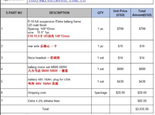

To be honest from an Australian perspective you already have a good deal in the Luna cycle. We have a company here "pirez" I believe is a re-badged Luna cycle complete bike with aluminium frame older style for $3995au. I have already spent $5036.53 for the cheeb. I still need tyres, brakes, handle bars dropper post, saddle, pedals and a bell. I'm sure thats not everything. I guess the piont is if we could by a Lune cycle here (we can't for the moment covid issues I guess) it would work out close to the same price as it is costing me to build. (Except for shipping)
I just contacted Luna and they sell the complete bike only, no frameset kit :-(. I'm still looking for any vendor willing to ship E10 frameset to CA, USA. Please ping me if you have a contact. thanks much!

Hi has anyone received there bike yet in the UK I payed on the 11th January and all messages were sent on Skype not email just wondering if anyone else has done it through Skype and not email

Ordered mine on the 25th Jan, frame delivered today, battery + motor should be end of March. Ordered through eBay.

Hi wxcopsey,
May I have a link to motor and battery items on ebay? And does the frame come with the battery case/container? Thank you for the info!

In the UK, and you'll need to message them to provide a link for motor and battery as stock seems quite limited.
She told me the frame was not available 2 weeks ago started to think I've been scammed as I did it though Skype I'll give it another week and start a PayPal dispute. What do you think??

I have a friend who lives in Shanghai, the eBay company selling the E10 tell me they will ship the frame,motor, battery to Shanghai at a cost of £1500, of course I then need to get it from Shanghai to the UK, So I imagine with shipping, VAT & import duty I am looking at £2000 plus.
HI Howz, I'd like to check out which Ebay company is selling E10 shipping to Shanghai. This might be a possible way to ship to USA afterward. Please help. Joe
