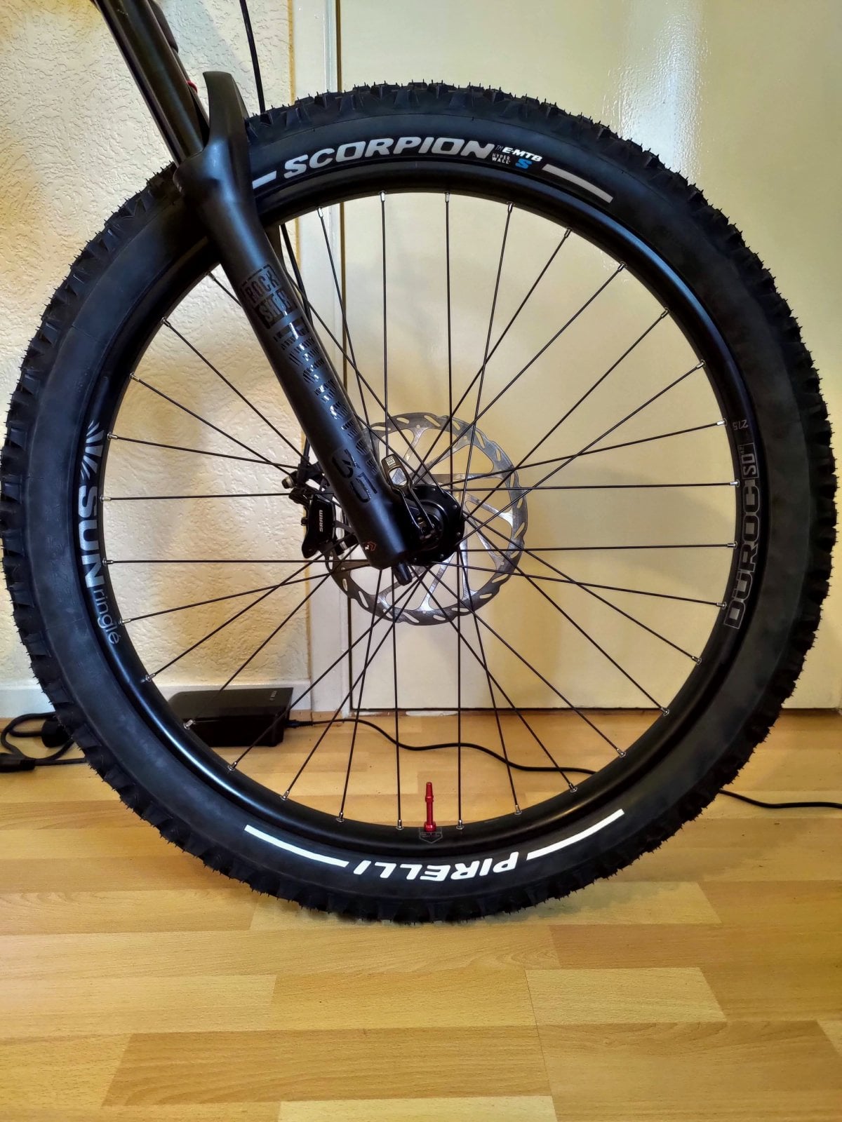

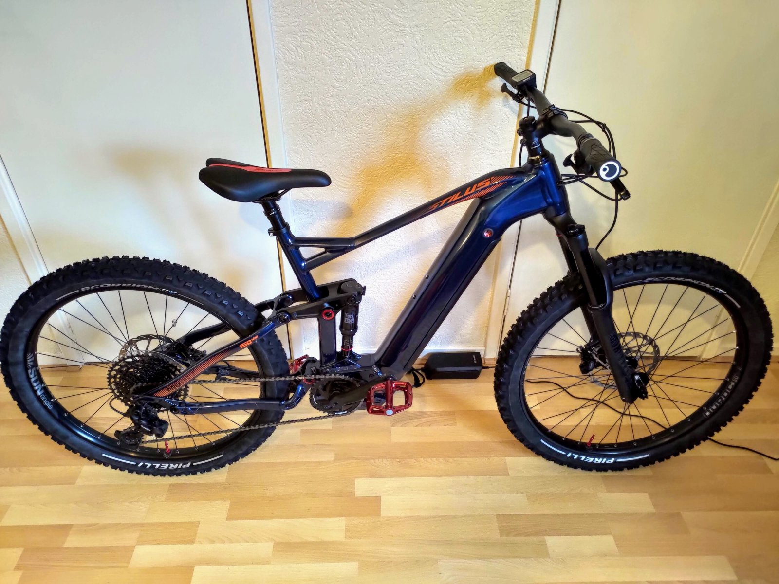

Changed the grips, went tubeless with new tires and it's just like I needed/wanted it to be (apart from some purely visual details I'd change in the future)!
No wonder why some where saying they had to stand on the Smart Sams to get them off the wheel, I never struggled that much to change some tires!!!
For those who changed their tires on these wheel, did you guys hear the expected pop indicating that the beads set properly? Didn't get that pop, on neither of the wheels but yet it's inflated, no leak and the bead line is showing as it should... Rides normally, no issues but I don't know if I should expect an issue or not.

"No wonder why some where saying they had to stand on the Smart Sams to get them off the wheel, I never struggled that much to change some tires!!!"
Thanks for the pcitures and review.
I have also ordered a XL Stilus last week. Planning to go tubeless as soon the bike arrives..
How did you get rid of the tires? I own just normal tools for changing tires. Is there any specifc "trick"w working with the SmartSam ?
Get all the air out the tube. Move tyre into the centre of the rim so its off the wider part of the rim and sitting in the middle, this is the narrow part of the rim. Then get a tyre lever, move one side of the tyre to the outside of the rim, get your tyre lever under it and pop the side of the tyre off the rim. Then use the tyre lever to remove the rest of the tyre by sliding it round the rim, forcing the rest of the tyre off. Once you've got one side of the tyre off you can just pull the entire tyre off.
It is honestly pretty easy with this tyre and rim. The tyre is so flexible its not a hard job compared to some heavy tyres.
That’s strange mine was relatively easy to get off a bit of soapy water helps ??
I should have specified: I first tried to remove them without a tire lever, as I've always easily managed to do so with other tires and wheels (and I have slightly damaged/scratched cheap wheels before with a lever, not sure how good these Duroc ones are tbh). But with this one I couldn't, that's what I meant.
The Smart Sam is really flexible indeed, except for the bead. In fact it's the only part that's actually quite rigid (seems to be a metallic wire inside the tire all along the bead) so yeah, definitely needed that lever, which I ended up using.
With a lever it was a quick job, but I lost a lot of energy trying without one in the first place.
