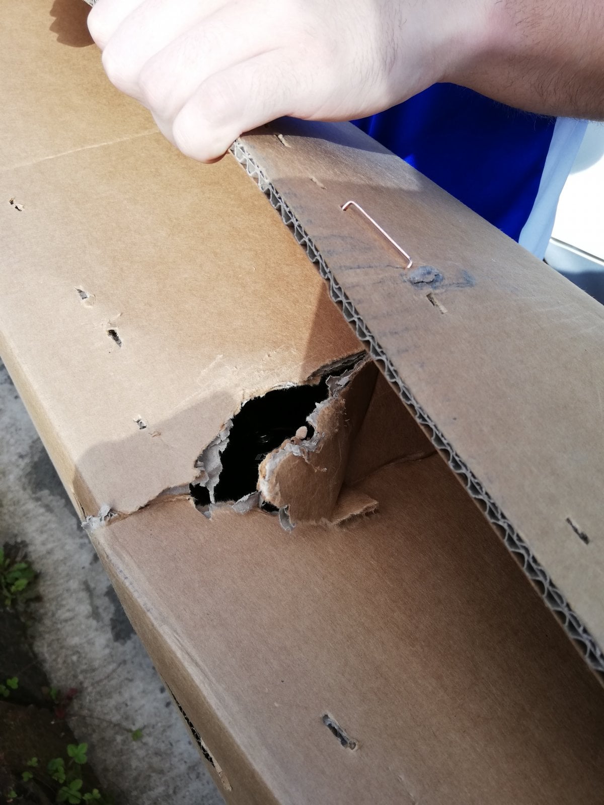

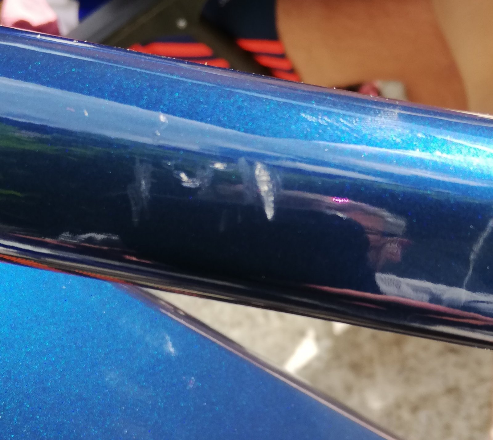

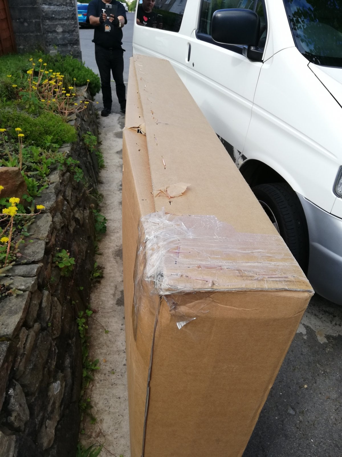

Interesting to see how returns are to be packed, maybe Decathlon should watch their own videos.
This was my arrival. The damage is annoying and I am in discussion with customer services as we speak. I did manage to polish some of it out so its not as bad as the photo now, but still not acceptable when you part with nearly 3 grand.
I have decided not fo return it as that faff would probably break me ?, but I expect some sort of a good will/compensation gesture , however small that may be (not holding my breath tbh but feel its only fair).
I am. Assuming Panther courier did the damage but that's up to them for now.
Yes, that is bad, I am also in discussion with customer services, photos, and a complaint sent in, I am awaiting their solution, my solution is 10% refund or it's going back. Did you have any brake issues?

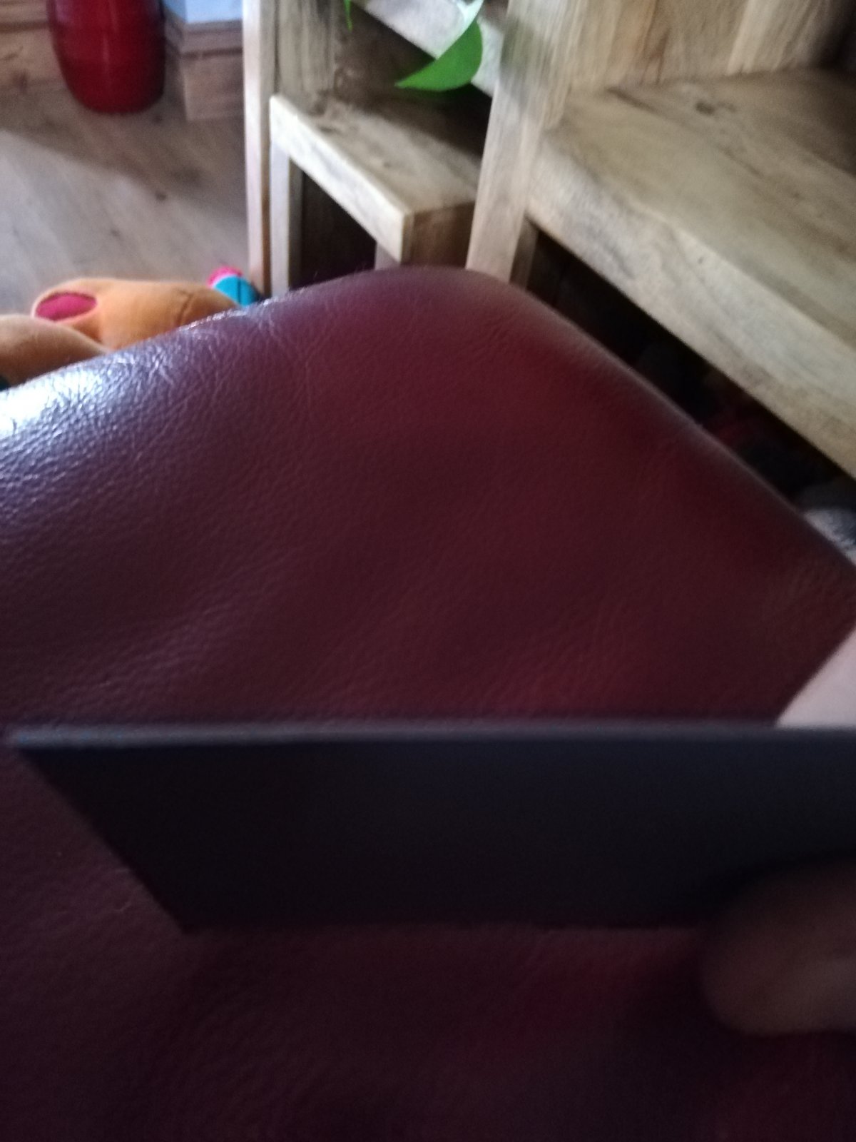

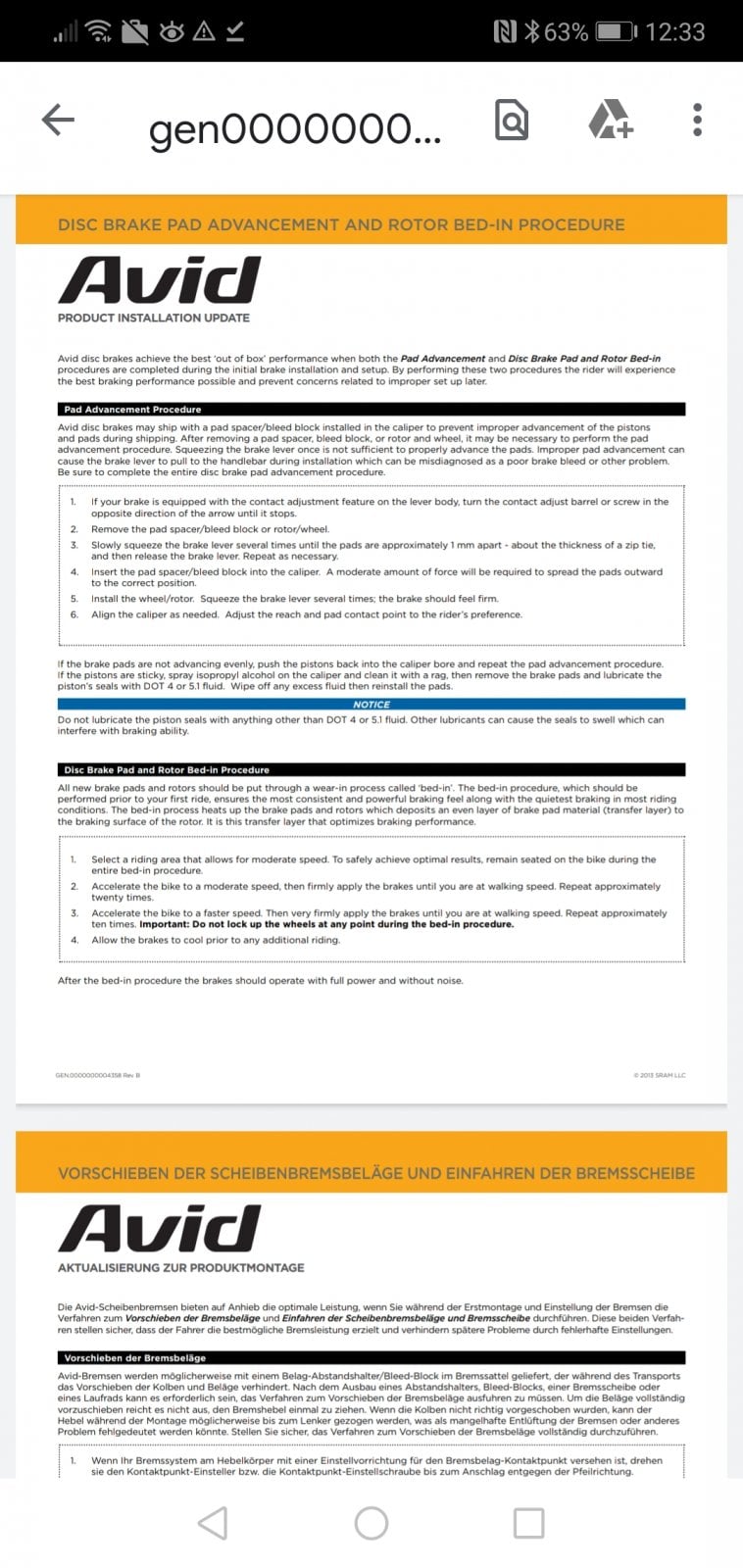

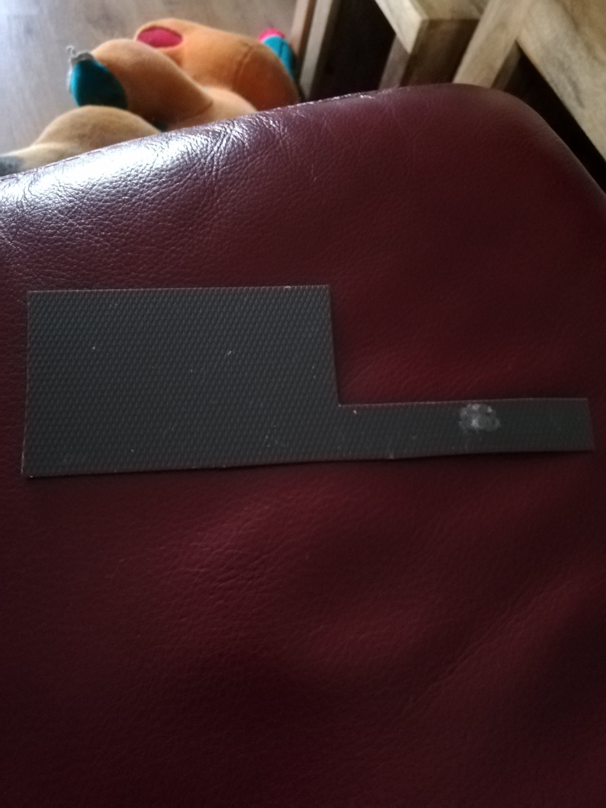

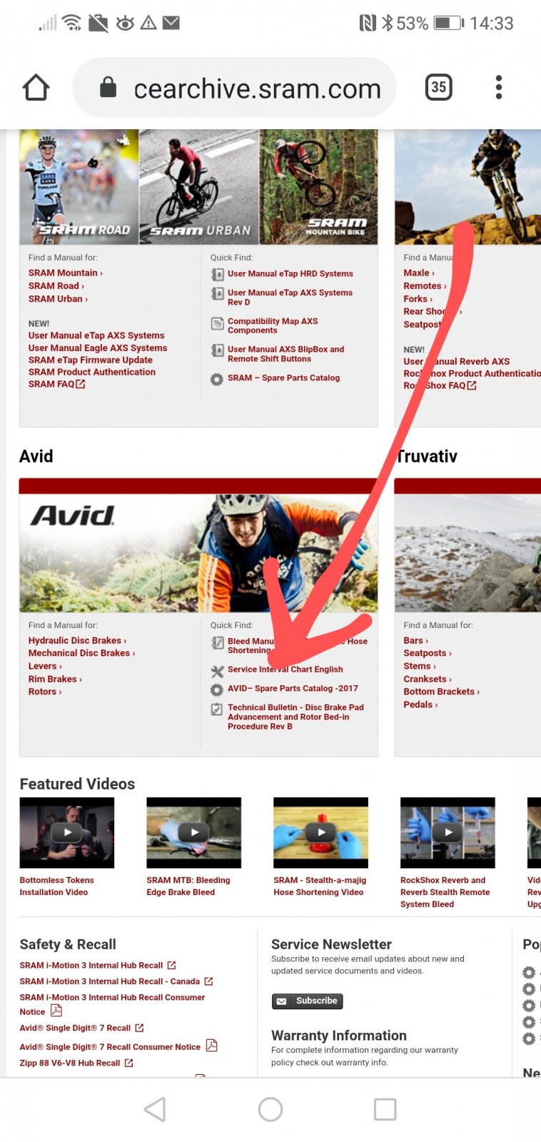

Right, I have sorted the bloody brakes and they are tremendous!. ?.
It's all to do with the pad distance in most cases (this was bothering me and I knew it could be air on mine totally).
Delved into some other forums and got this about needing to ADVANCE THE PADS/PISTONS AFTER TRANSIT. Its on a Sram/Avid site and is simple (takes about 30 mins for both and requires no tools-just a 1 mm spacer that I made from a cutting mat).
What a difference. Great bite point and adjustable lever is actually
Working.
Check out. www.servicearchive.sram.com/service
Or I have put a screenshot in the post of the instructions.
Good luck.
