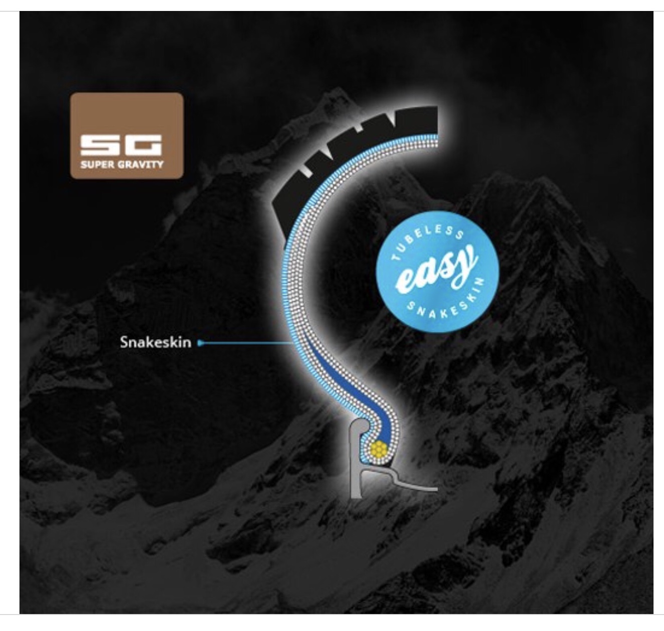

On one of my Levo’s I fitted a 2.35 Magic Mary SG (Super Gravity) casing on the rear and on the other Levo I went mullet on the rear and fitted a 27.5 Eddy Current 2.8 which also has an SG casing. Both running 28psi. Both have Stans Race Sealant.

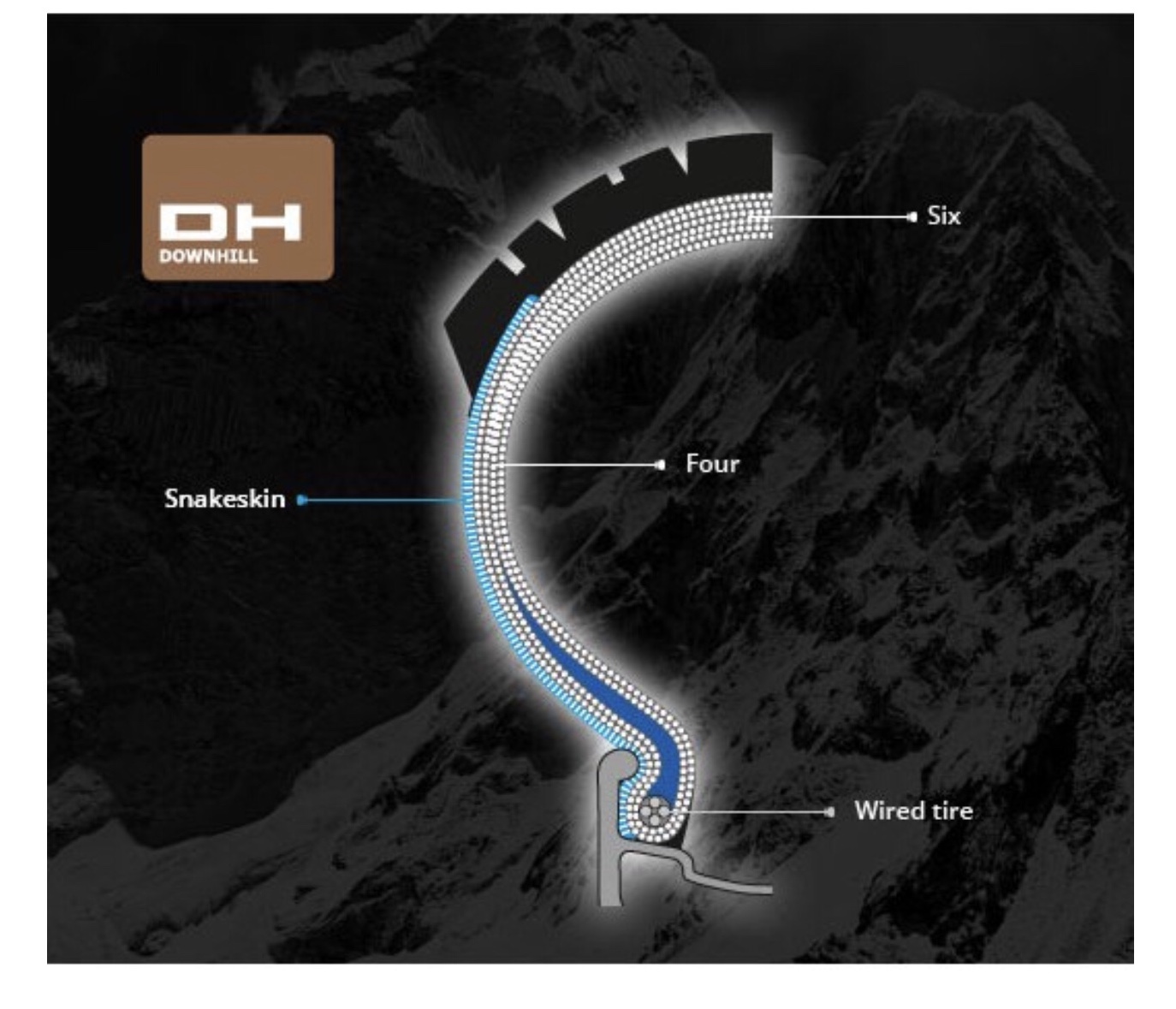

For me personally, inserts are not needed. If you want to go up another level re tyre protection get the DH version it has an even thicker casing.

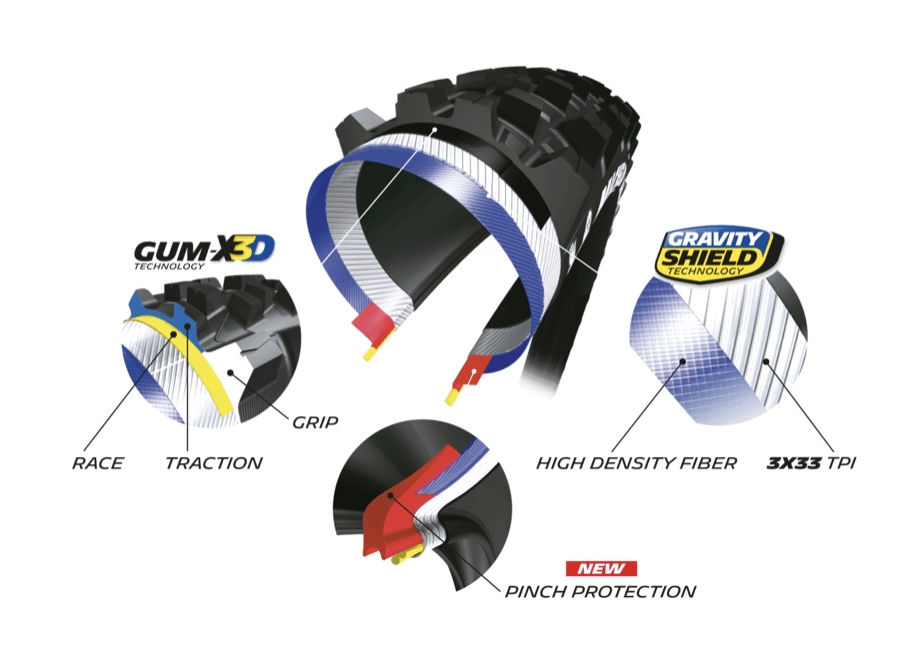

yea ive given up on the idea really, i like the idea of extra rim protection but the pinch flat i got were on the original tyres that came with the levo and they were crap.. the michelin wilds have been fine so ill stick with decent tyres and tubeless sealant.
