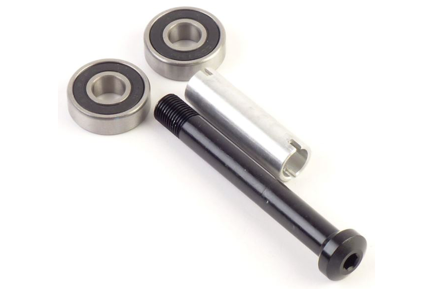

I was just wondering about the main pivot bearing / rocker bolt. I notice that there is only one access side (non-drive side). So how does one extract the non-drive side bearing? Is it hard to replace that bearing assembly myself? Do you have to poke/press it out from the non-drive side opening in the frame, which is only the width of the bolt shaft thread?

You knock each bearing out from the opposite side.
i.e left side bearing is tapped out from the right side of the frame.
A thin drift or flat screwdriver at a push is lined up in the groove in the spacer shown above.
Tap gently in one then the other and alternate until it pops out.
The spacer can then be removed so the second bearing is usually easier to remove.

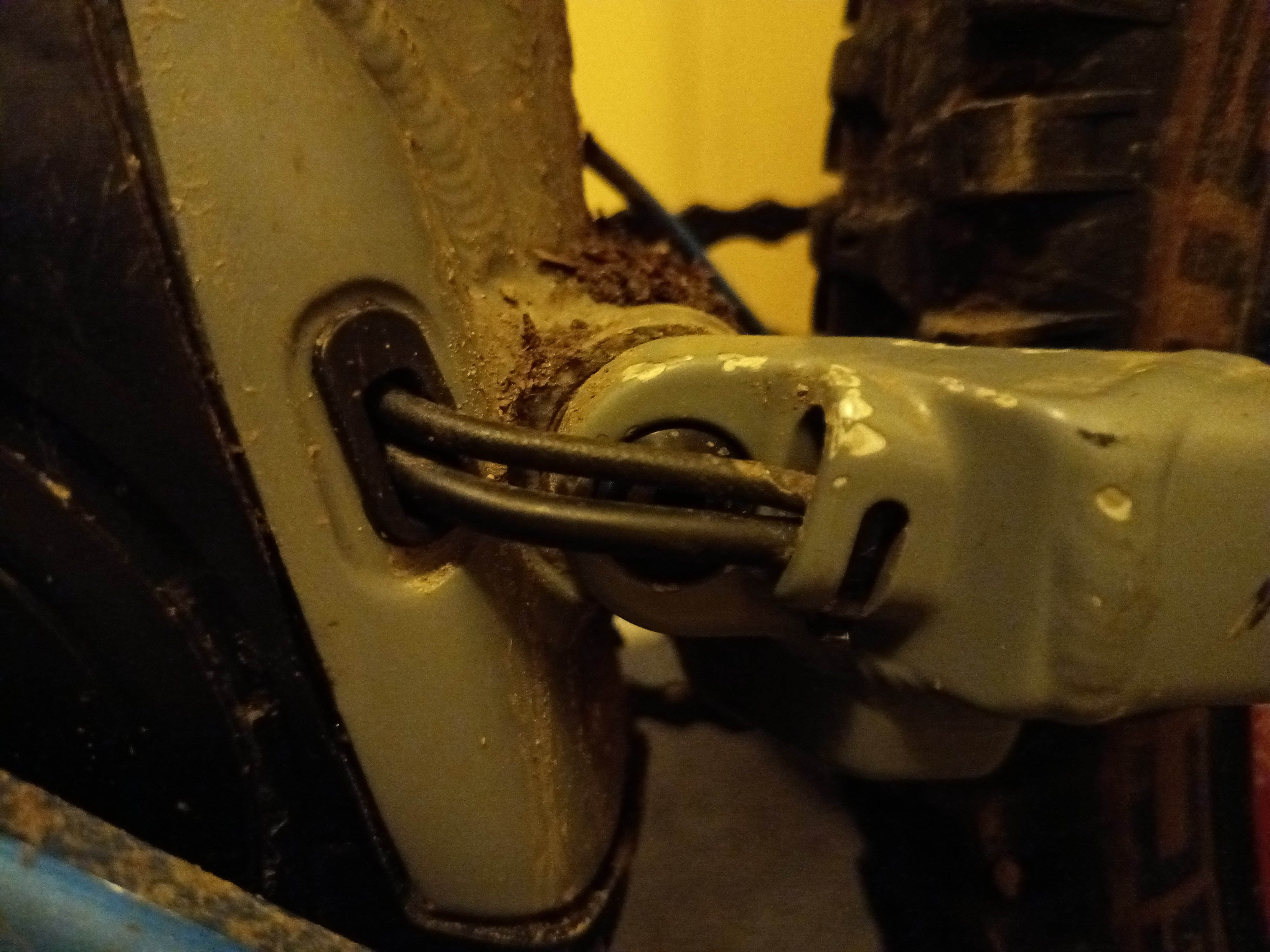

There's only one side open, like a Smarties tube. Open one end. Except, for a 5mm hole on the drive-side, behind the chainstay protection tape. Non-drive side is open.
Photos:
Non-Drive Side Access to Main Pivot/Rocker bolt, and bearings. Completely blocked by cable runs. Rear speed sensor, and rear brake cable. Poor design. (Photo #1).
Drive Side Main Pivot Bearing Access, nothing but a thread where the Pivot bolt threads into the frame (Photo #2).

I think its still as I described, but you'll need to do a bit more disassembly to get at the bearing 'carrier'.
The whole lower swing arm needs removing, and you'll probably need to remove the two cables shown in your drive side picture.
Unscrew the long bolt from the non drive side and either lift up or down the 'arm' and you should see a bearing on each side of the main frame. You'll also probably discover a shaped 'washer' that will fall out of each side as you move it.

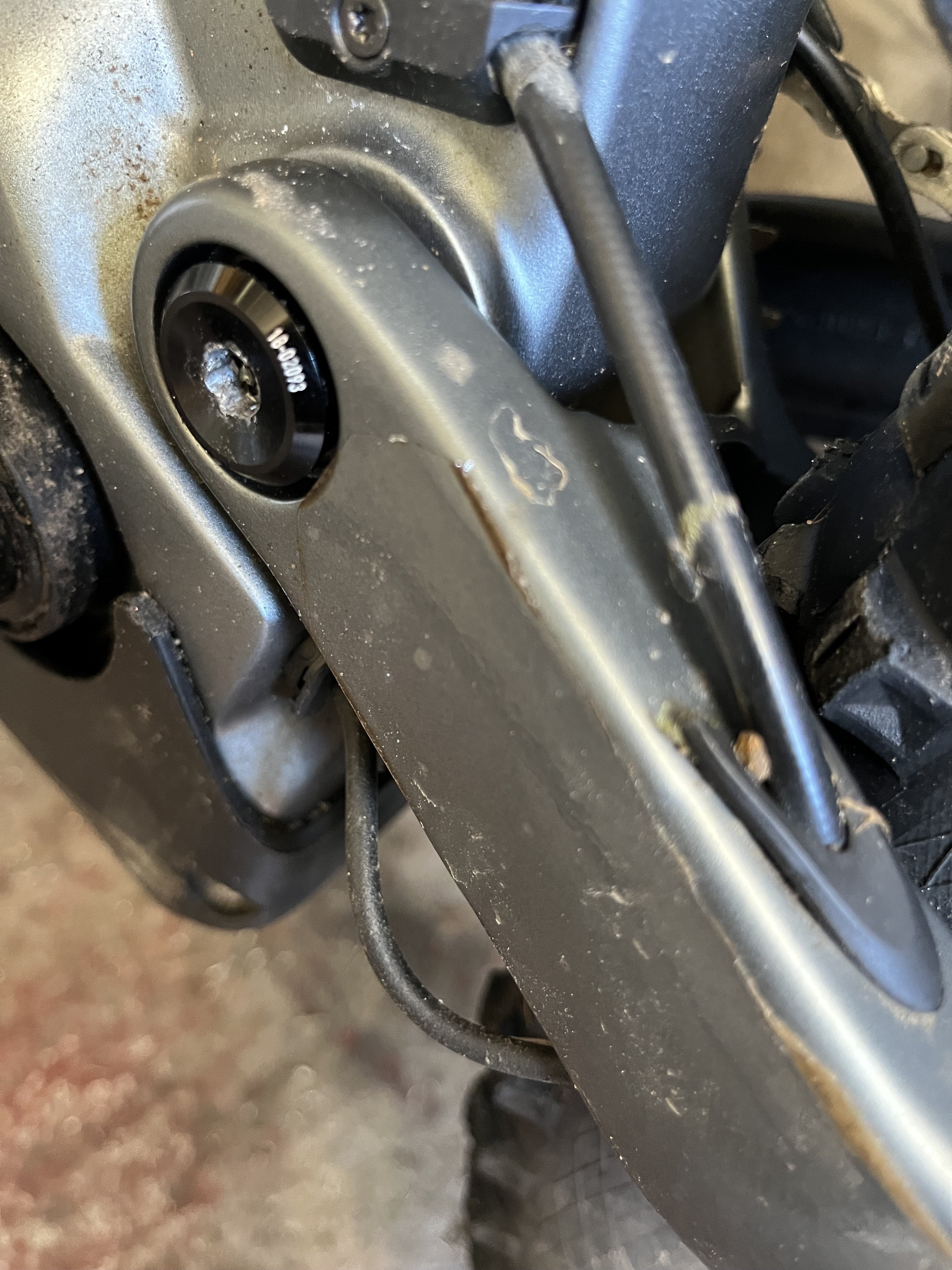

Hi, going to replace my swinging arm bearings and replace the bolts, where did you get the bearings and the bolts, can’t find the 18-02093 bolt online. Any pointers would help.
