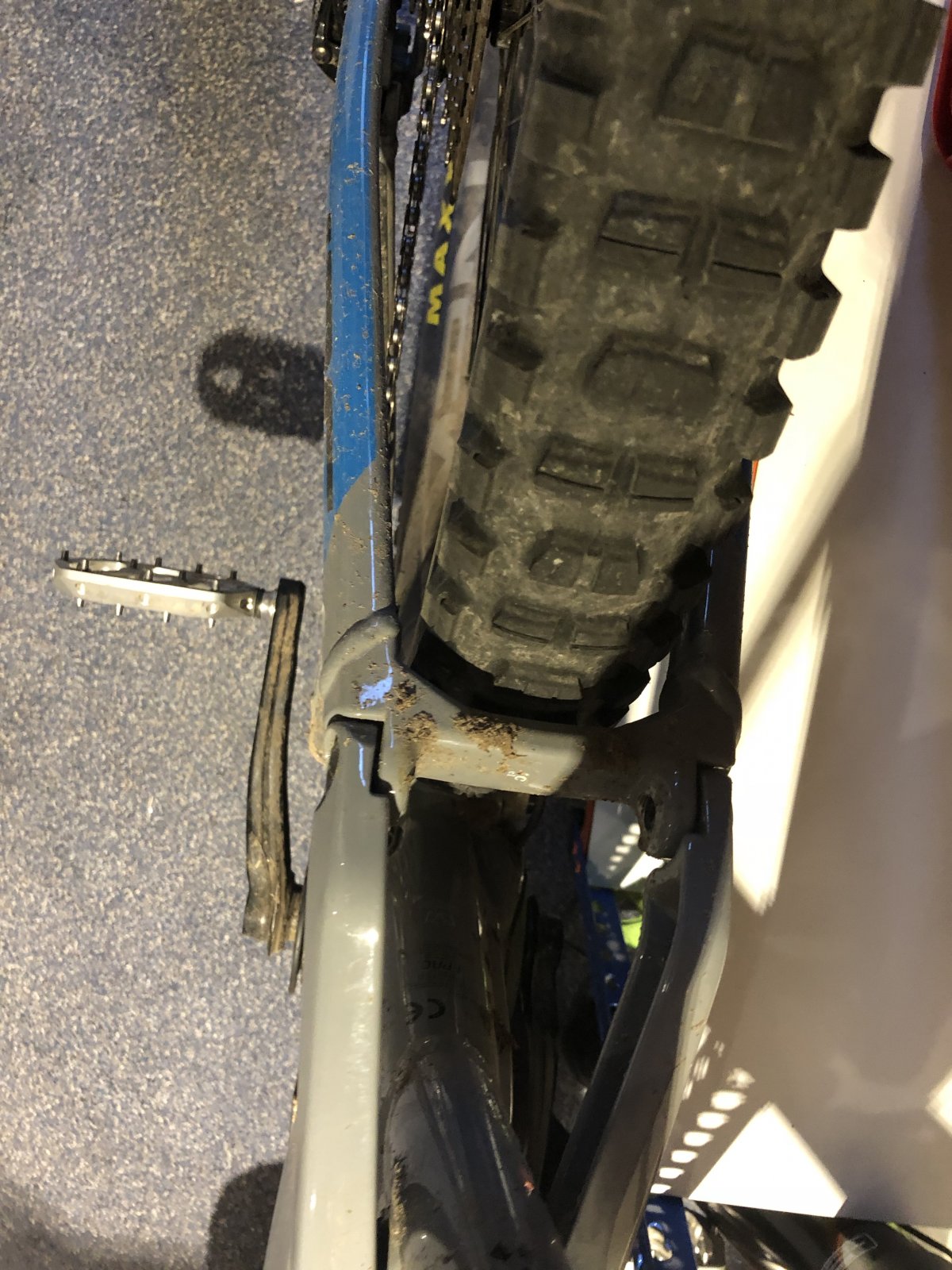

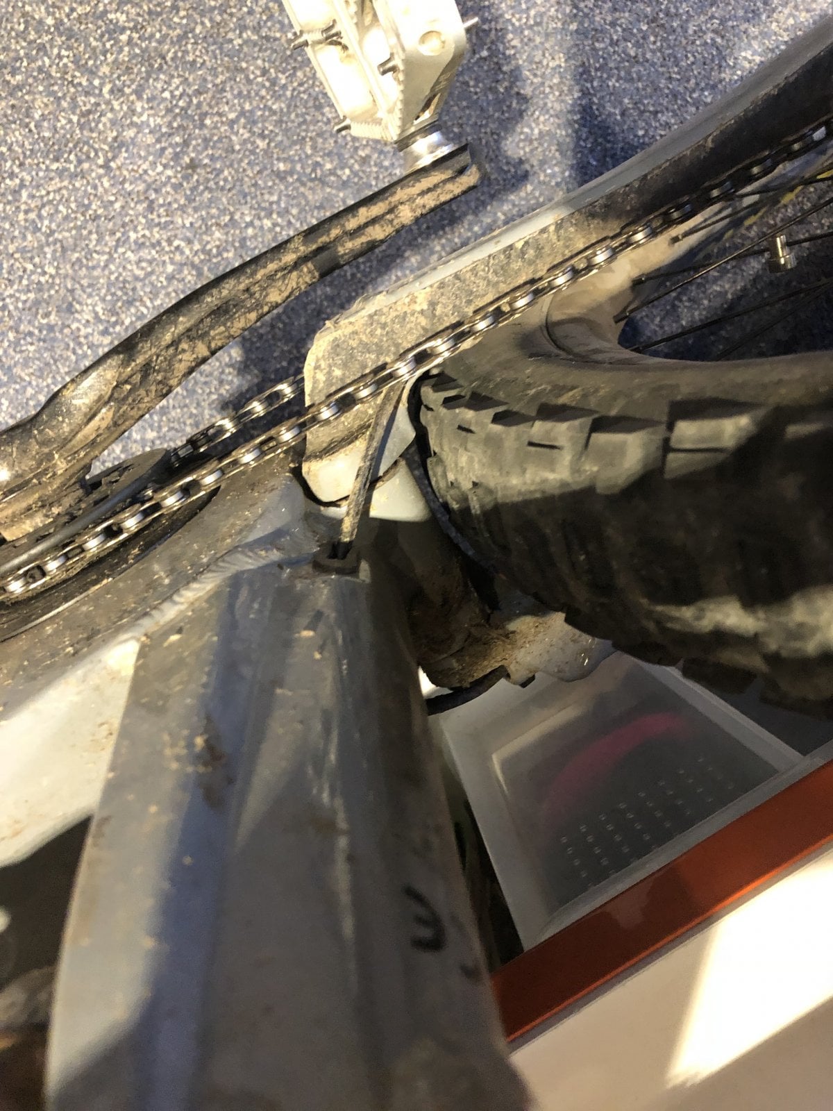

Really interesting. I can guess,no frame fitting issues. I spoke to Cube Europe and they told me,maximum tyre size on this bike was 2,60. Bike doesn't admit plus tyres they said.
Could you post any pic from the tyre housing? Thanks
Yes of course- will take some pics in the morning

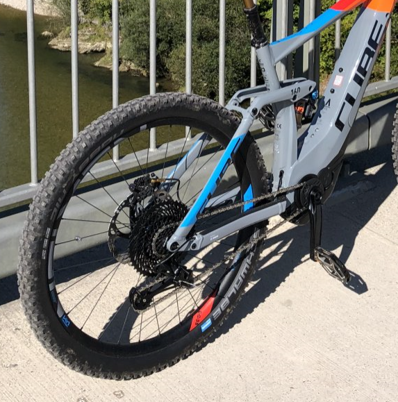

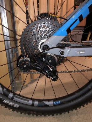

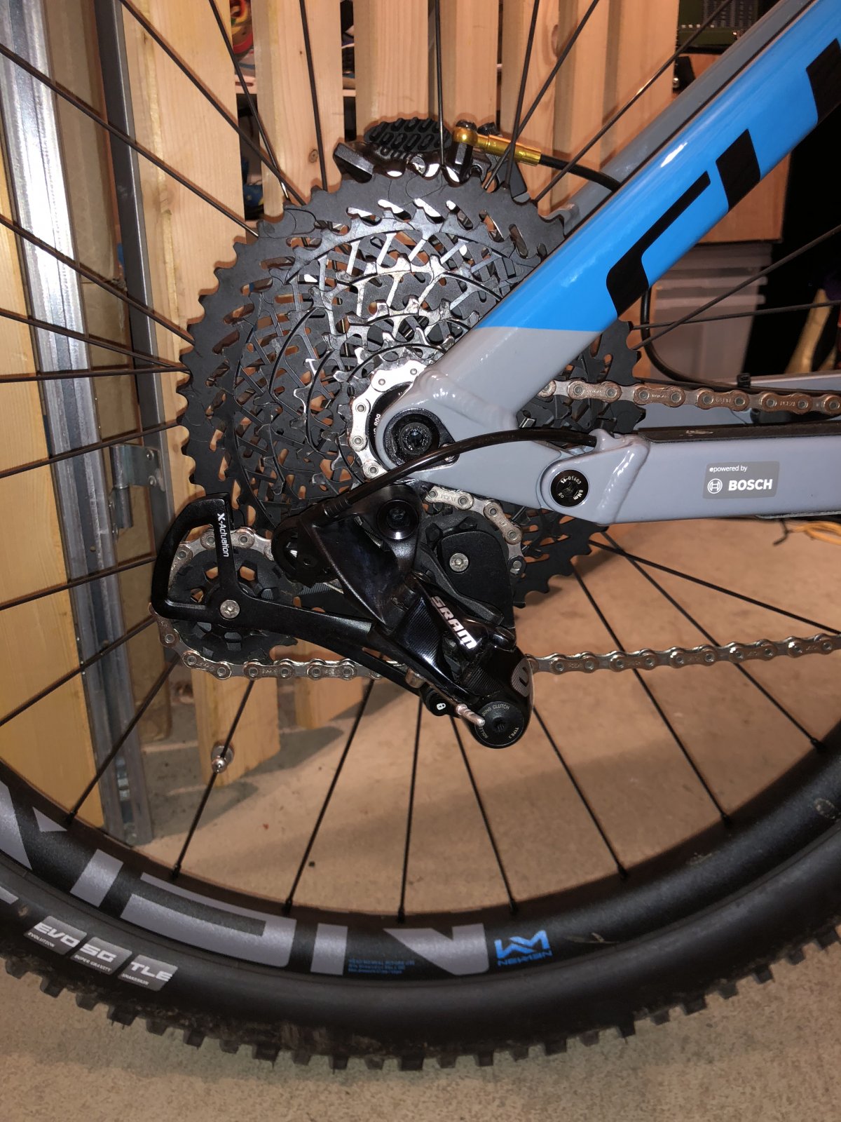

Maybe you guys can help, I think I have a problem with the chain or drivetrain. When in the highest gear (8th) the chain is really loose and is hanging almost flat on the chain stay. Is there something wrong with the rear derailler or the casette?
Also the chain or the casette makes strange noises when in the 6th and 7th gear.
The bike is only three weeks old with less then 100 km.
mark.ai
Jul 10, 2018
828
594
Windermere
Looking at this pic of yours from above, it may be the chain is slightly too long - as the derailleur looks rotated a long way backwards already and it looks to be in 5th (?) gear only. Although hard to tell from the picture perspective.
It would be useful to see some pictures from the side of the rear derailleur when it is in 1st gear and when in 8th gear.

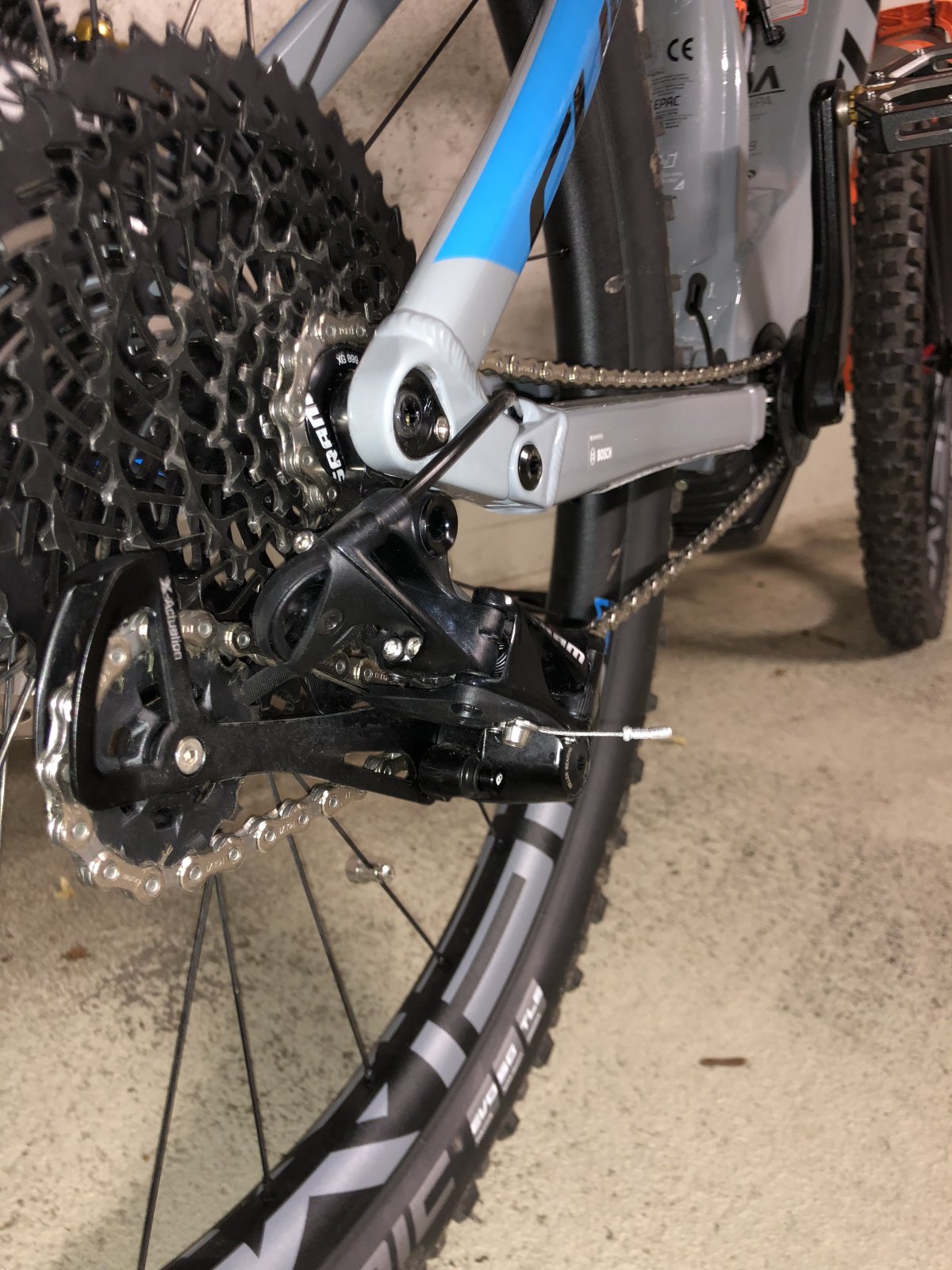

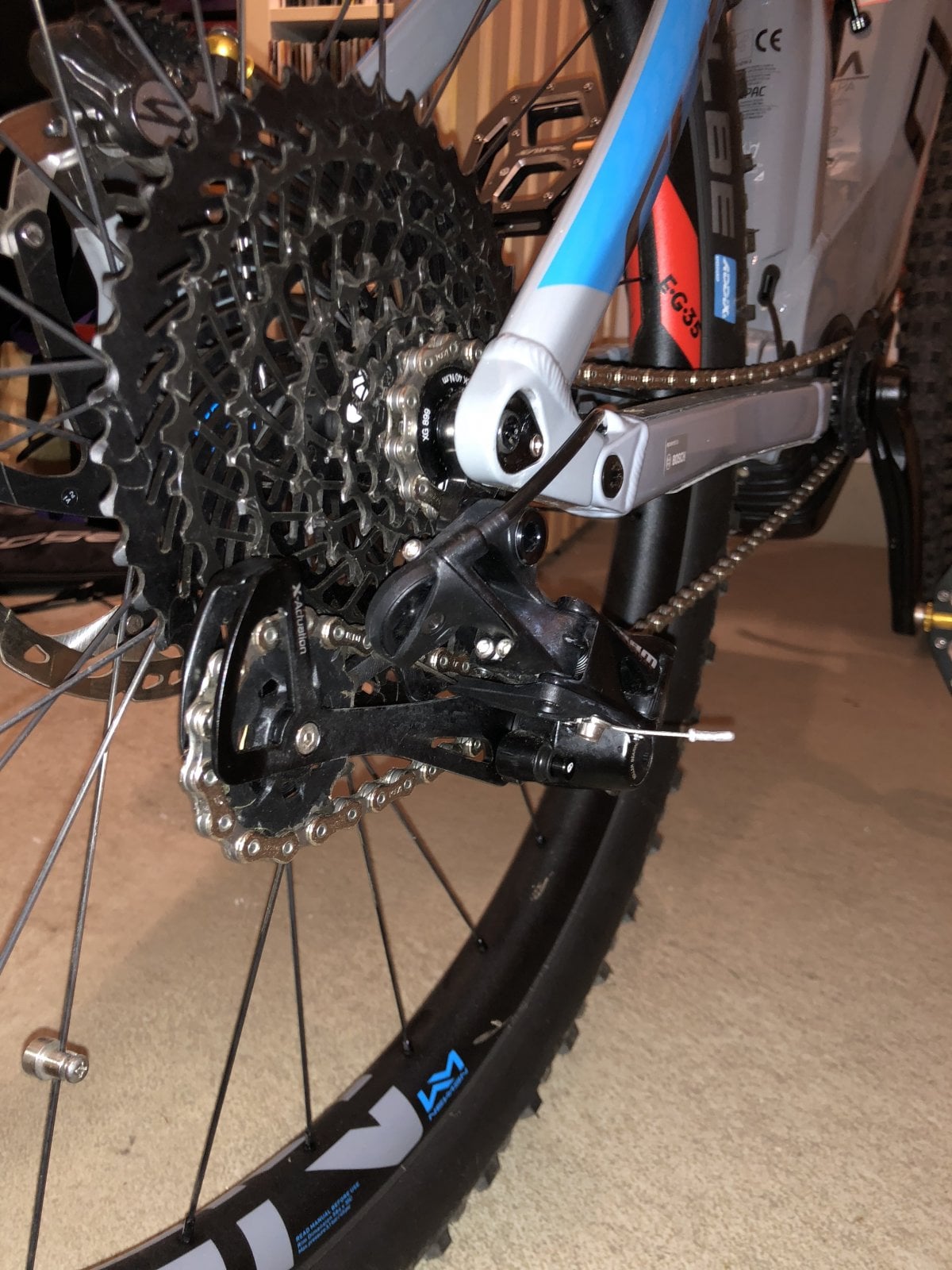

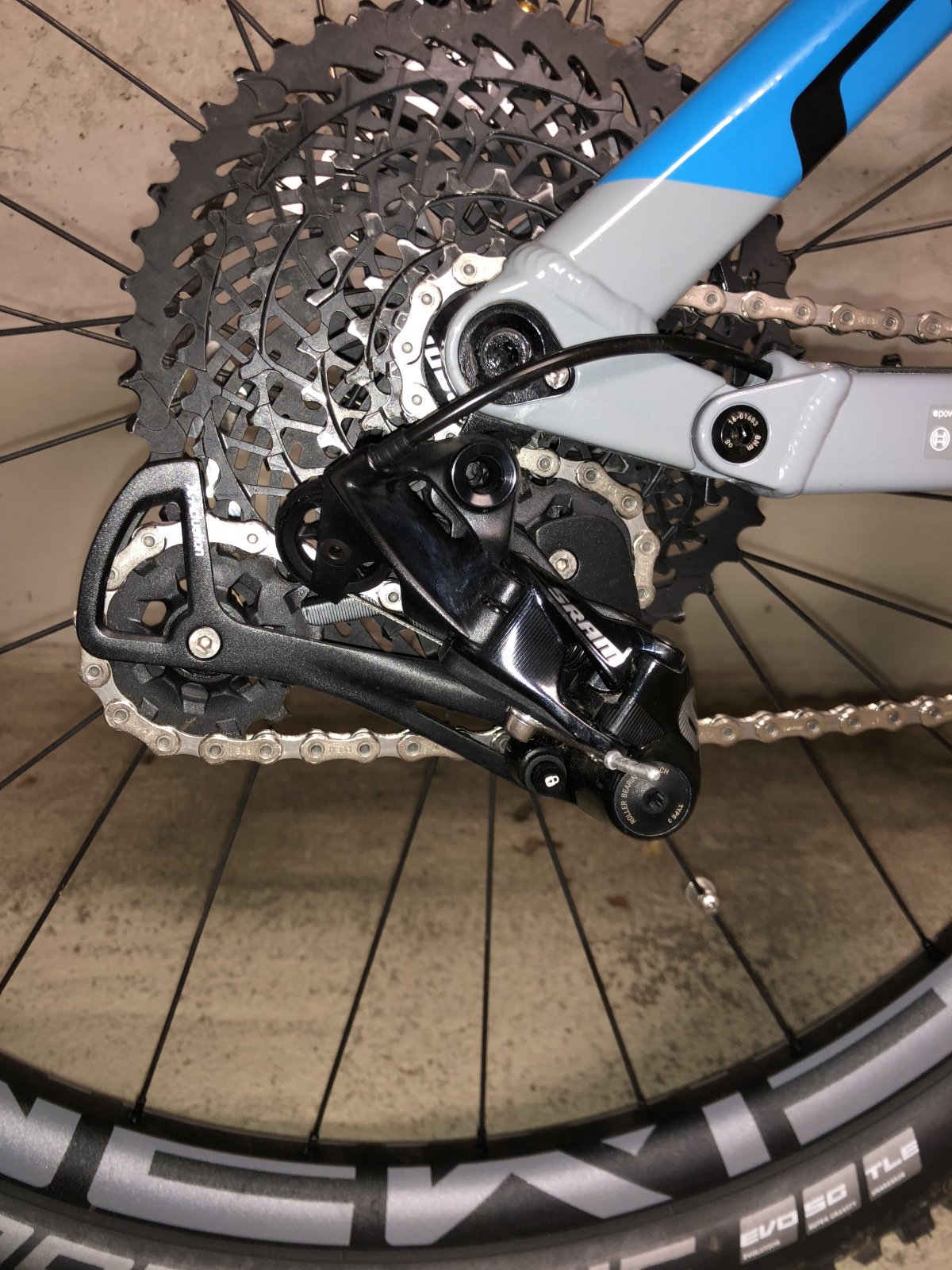

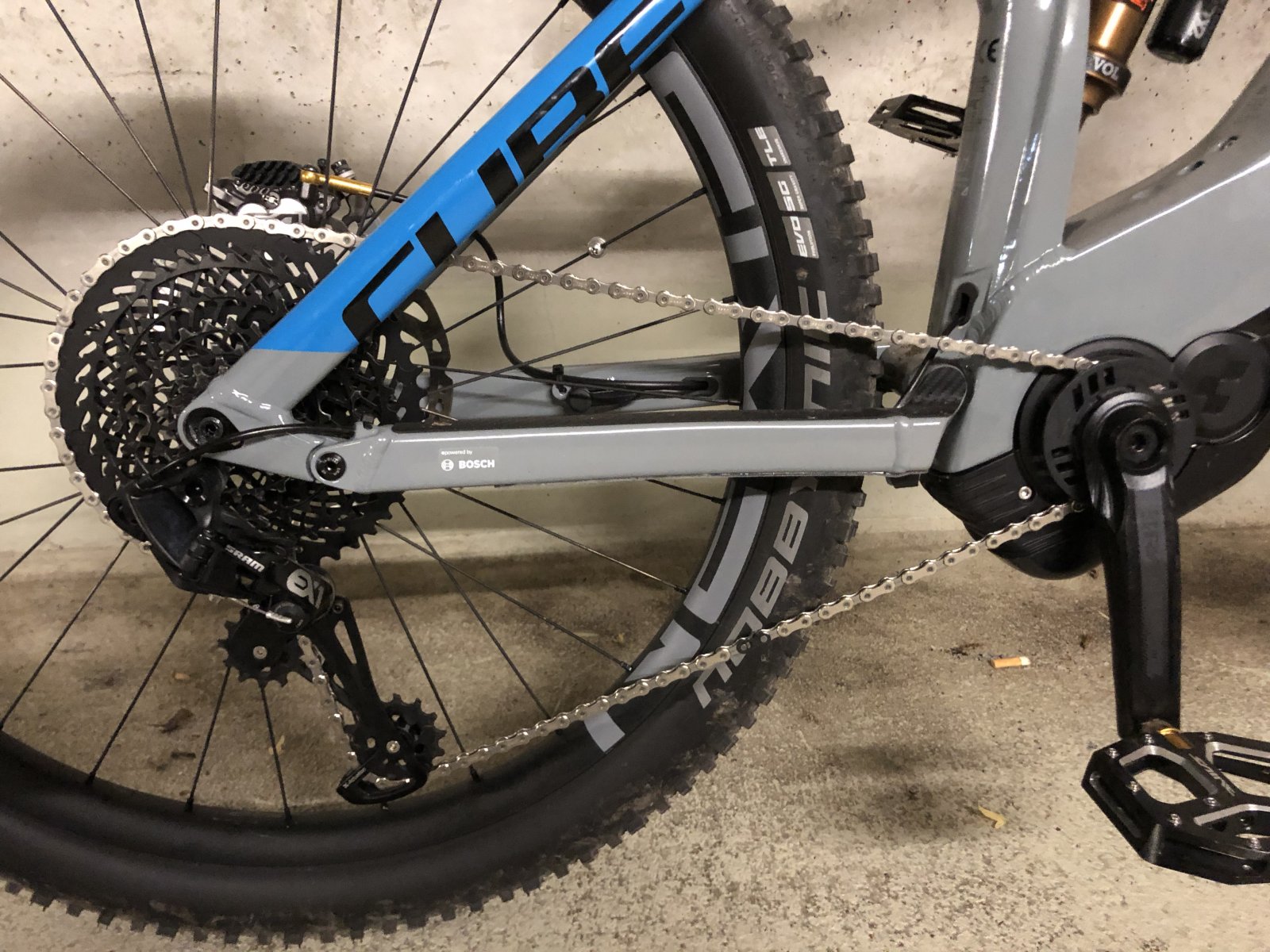

Agreed it looks like the chain is to long although a close up would make it easier to tell.
ikaramboo
Sep 21, 2018
74
77
That’s how it looks like. Seems pretty wrong and the gears also don‘t shift properly. I turned the knob at the shifter completely in one direction and now it works a little better.
