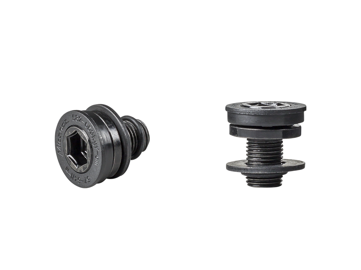

If you use these ( or the equallivant for your make) you can tighten your crank bolts and then screw these on the top of the bolts. The crank bolt does not tend to move when it has one of these on top pressing against it
Brand-X Self Extracting Square Taper Crank Bolts
Brand-X Self Extracting Square Taper Crank Bolts | Chain Reaction Cycles

Does anyone know the part# or how to purchase a replacement bolt for the Left side crank bolt on a Trek Rail 7 ? I lost both the bolt and the outer ring (dust cover). Thanks for any info!
I found this link to a bolt on Trek's website. Ordered it today and will let everyone if it works:
