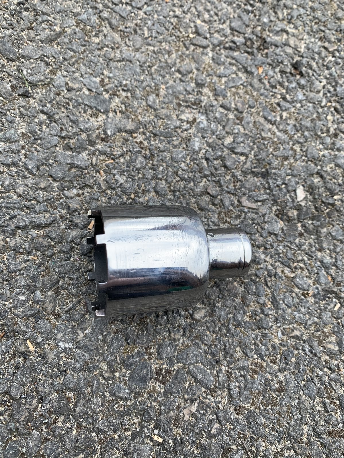

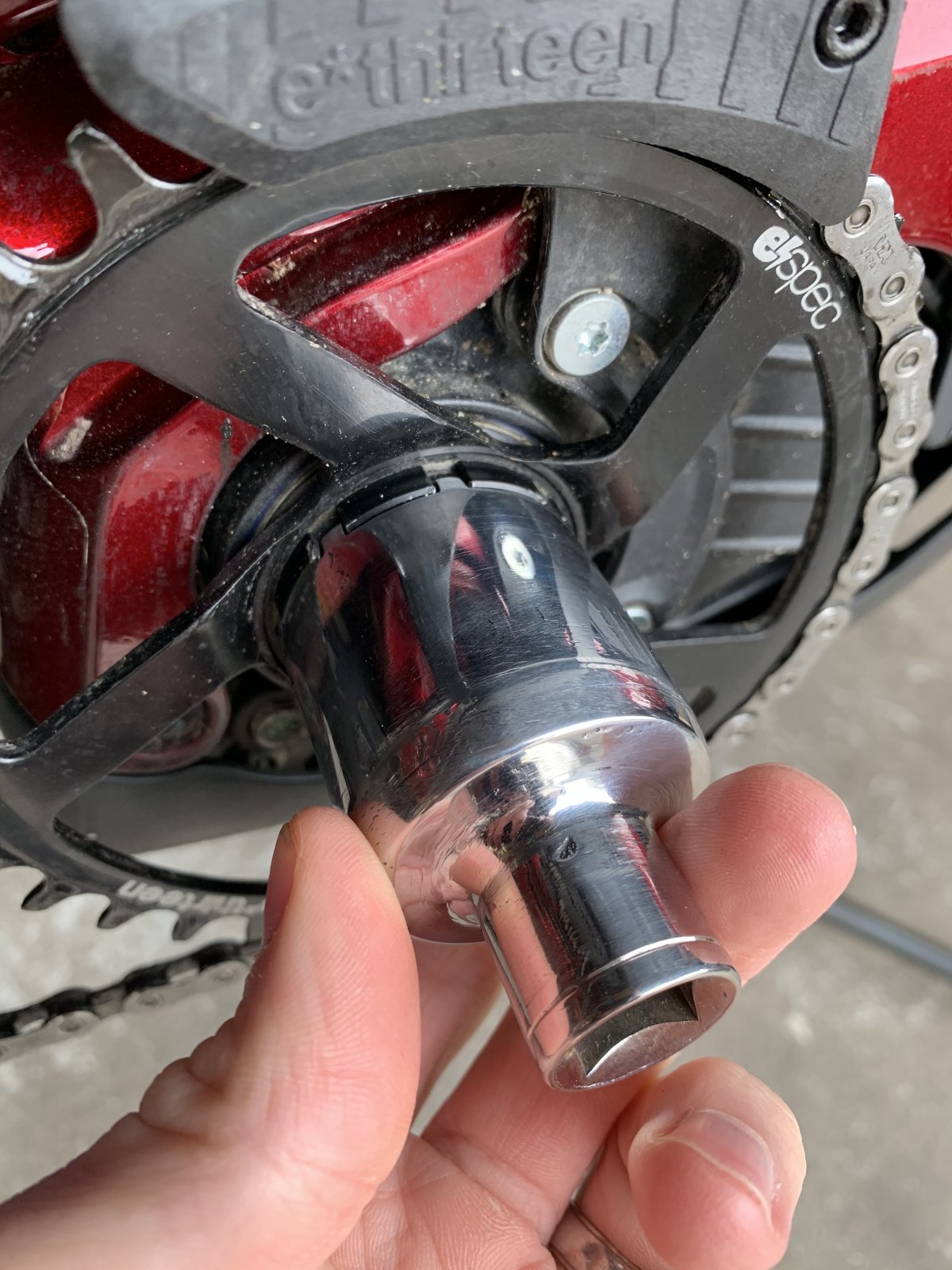

This is what I made, patent pending...

WilkyWay I don't believe you made that?
Prove me wrong and make another, then send to me for inspection ?
WilkyWay
Dec 26, 2019
120
104
Durham UK
This was the mk2 version. The mk1 was made from thinner wall steel and wasn’t up to the job.
It’s just a steel cylinder with The teeth cut in, welded to a 1/2” socket, then turned on a lathe to smoothen it and buffed.
Happy to take some more pictures for anyone who wants to make one.
