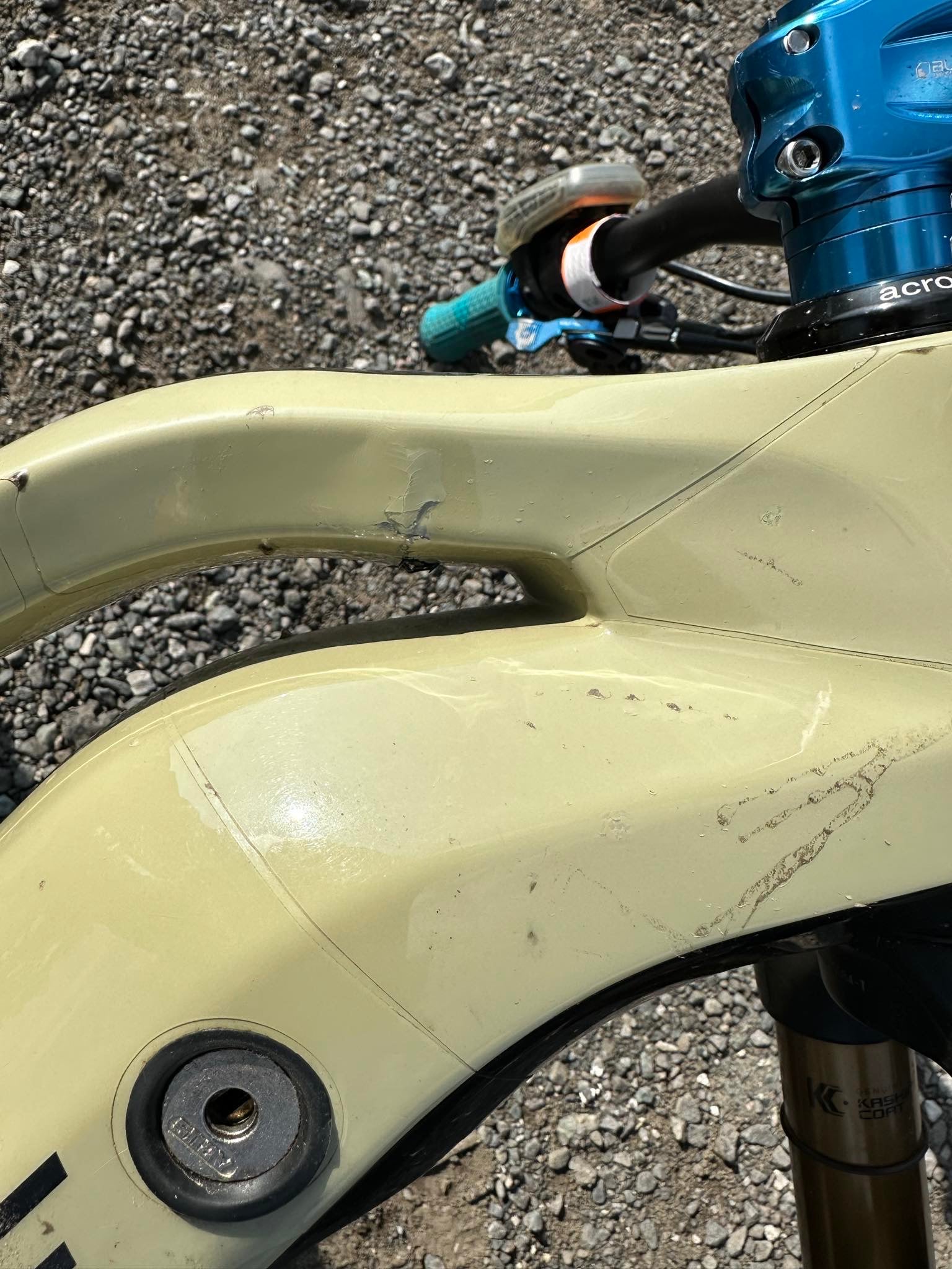

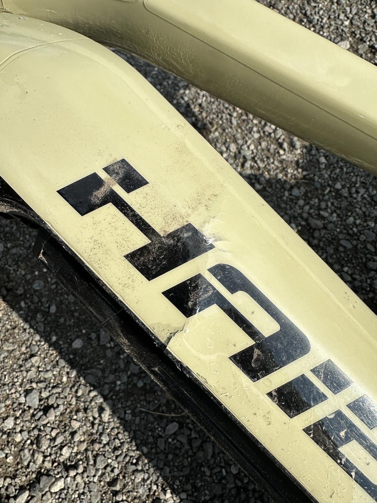

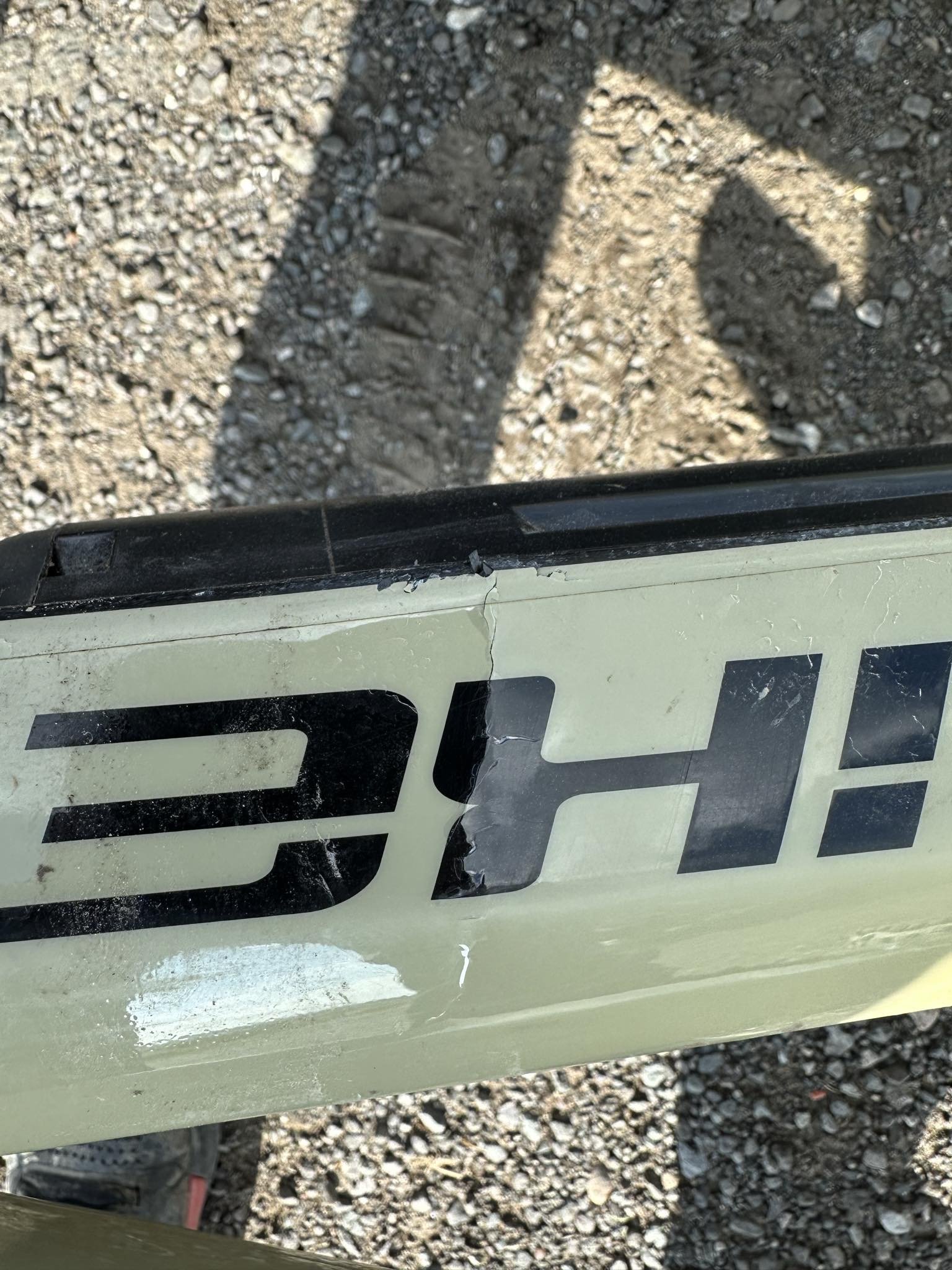

Can we see pics of what it looks like ? How did it crack ? Where did it crack ?
Was on a local trail went through a rocky section got to the bottom and my battery cover had come loose so when I looked to put it back on seen this

😮 Jaysus!
I can't imagine how much force would need to be applied to the frame to fracture it in not one but two places, both of which are strong areas too.
If theres no other damage on the bike I can't see how Haibike could possibly say this was anything other than a catastrophic warranty failure.

This is the argument I’m having with them now, they said it’s either been squashed or I’ve landed on my front wheel which has caused it to do this. But if either one of them were true then the bike would obviously have more damage on it ie bent forks wheels or bars. And even landing on the front wheel shouldn’t cause that issue not unless it was over a ridiculous sized jump.
I’m just going to carry on pursuing it and see what happens, it’s not even as if the bikes had a hard life it only gets used for commuting and a power hour round the local trails

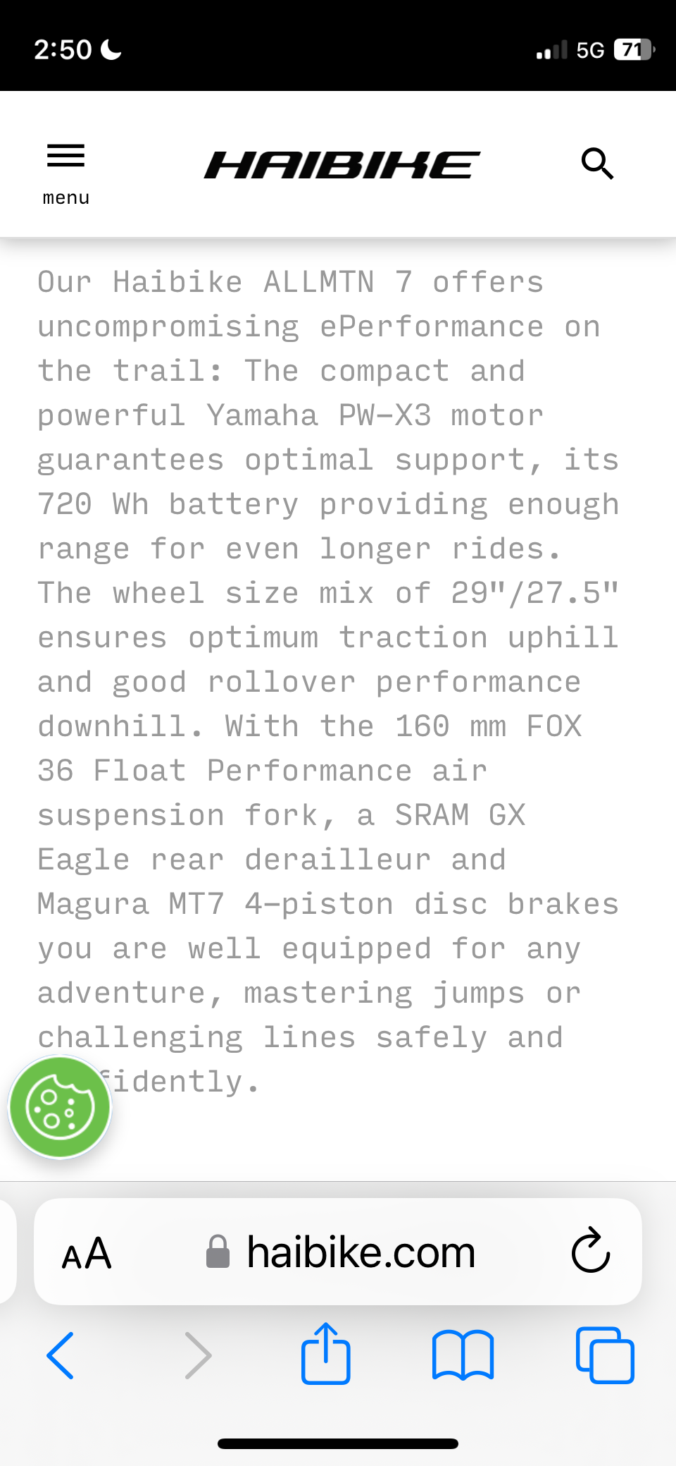

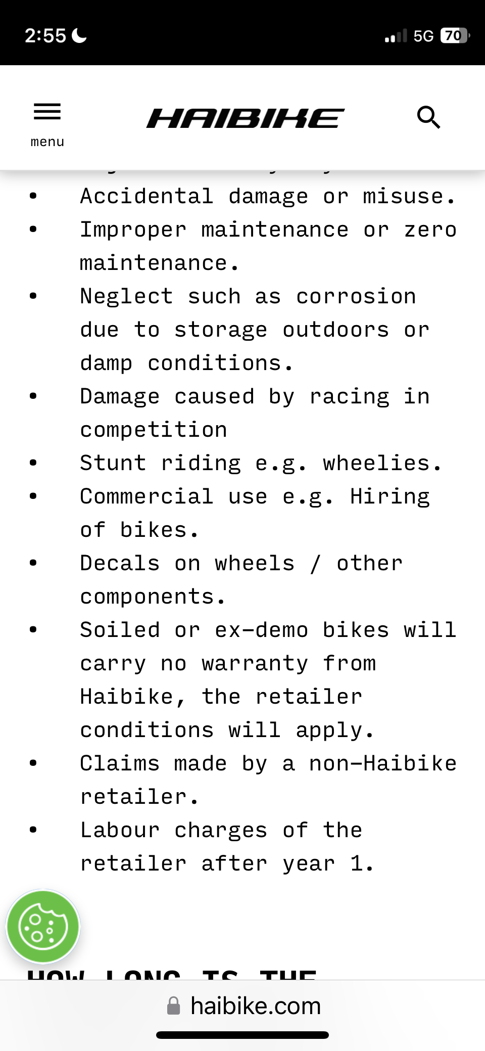

Seems odd to me that their description claims “mastering jumps…” and then whining about someone landing on front wheel, that’s just idiotic excuse, cause of course that will happen! In warranty exclusions they list stunt riding “eg wheelies”… are those clowns serious, have they never pulled a manual (wheelie) over obstacle?!
From your pics I don’t see a dent or signs of crushing, the photos just look like cracks from a weak frame.
