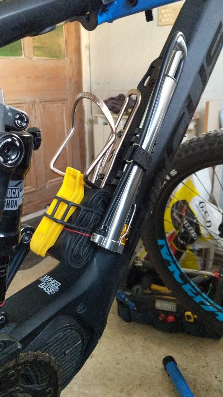

Look at you with room for a tube, levers and a pump and can still fit the water bottle! I cut the top off my water bottle and folded the tube up into it. Maybe I can do better?
