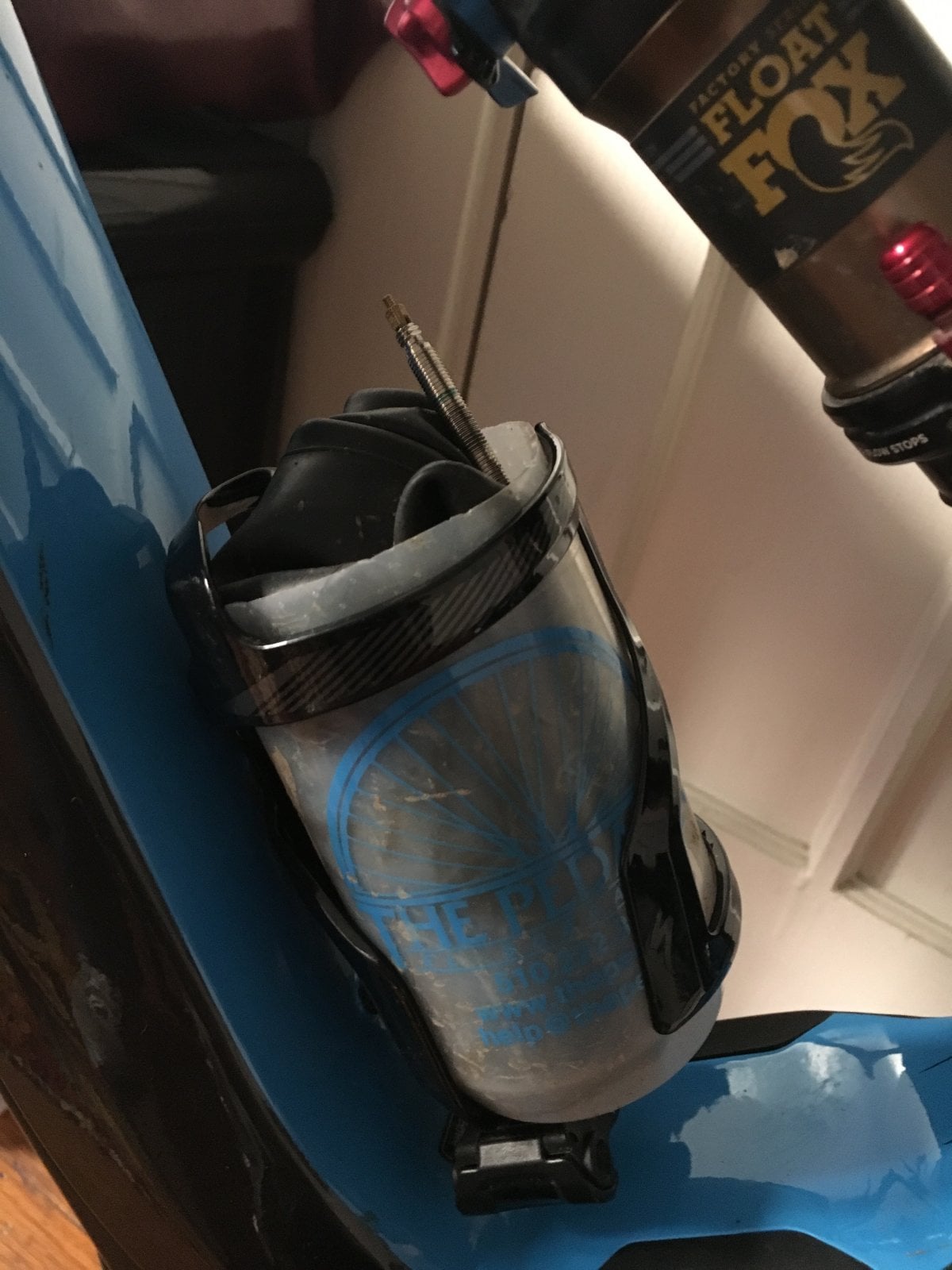

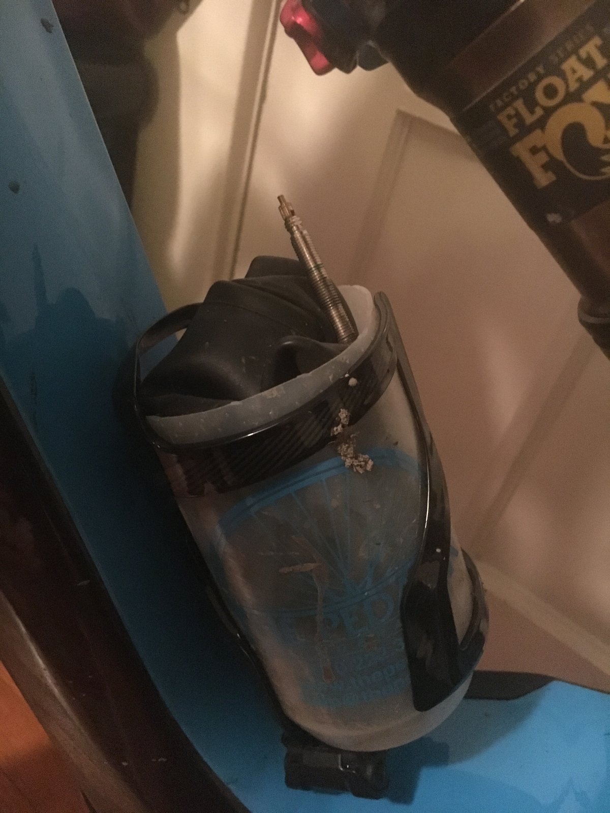

I've noticed that you have a Levo. You can store a light tube (not an heavy one) in the frame just above the battery ! Seen that somewhere on the internet, can't remember where, I've tested it and it works !
